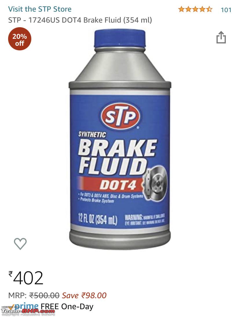

| ![]() Had a scary, heart stopping moment in my Civic 2010 V AT today, luckily I was not fast and didn’t need to stop urgently or it would have been an accident for sure. The brake pedal just sank to the floor with no effect, I pumped it a few times and the car stopped very reluctantly. It was close to my place so nursed the car home. Brake is getting applied but very lazily and at the very end of the pedal travel. The car was running perfectly yesterday and even today there was no sign of any issue till this happened. There was no fluid on the floor of my garage when I took her out this afternoon also. Please advice what I need to look into? I am not much of a do it yourself person, could it be a simple fix, something I can check/attend to temporarily before taking it to a garage or would it be advisable to call a mechanic home. I don’t want to take a chance driving it in this condition. Thank you! Cheers |

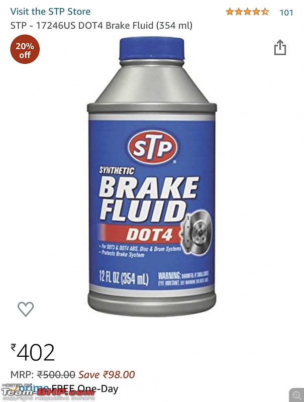

![]() I believe the correct fluid will be DOT 4, Amazon shows STP 17246US DOT4, will this be suitable? If the level is indeed low, can I just top it up, considering there is no leak of course. Last service was around ten months ago, but the car had hardly run 200-250 kilometres since then. ![]() Thanks again. Cheers | |

There could be other reasons as well for this kind of failure like a failing master cylinder but that should be step two in your diagnosis process. Please check level first and let us know. Regards. | |
