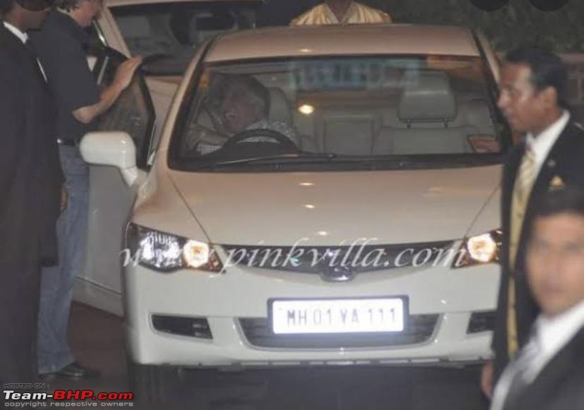

Hello everyone,
Honda Civic definitely was a success in our country, but now it is considered to be a more humble car as it has now gotten a little old and weary. This one might just be a humble Civic, but the person who used to own the humble Honda is a national treasure, Mr. Ratan Naval Tata.
Mr. Tata is considered to be the most humble individuals and yet his work sees no boundaries. This particular car was gifted by Mr. Tata himself to my sister's family for their invaluable support to Mr. Tata and their association with Mr. Tata has been from years. So in the end, whether it be a Honda or a Ferrari, the man who owned and drove these cars is just too valuable.
I am quite sure the Tatas might open a museum someday showcasing some of Mr. Ratan Tata’s memorabilia. This post is shared with a view of not garnering any unnecessary attention, but sharing it with like-minded people in the interest of provenance.

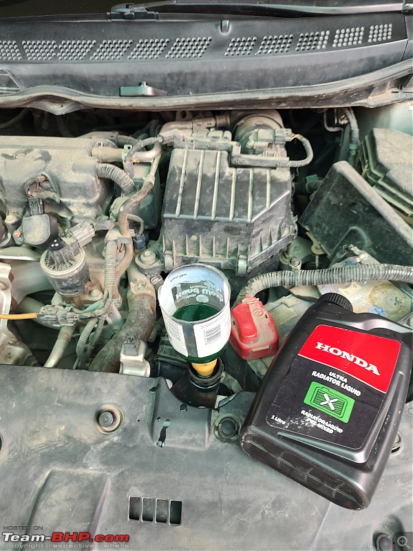

I replaced the serpentine belt and all four spark plugs considering car has done almost 1 lakh kms.
Changing spark plugs was a pain as boodmo sent me used spark plugs in damaged packaging and they were missing the protective cover. The grooves had some debris and also some rust. It's pathetic that we end up getting such kind of parts from a trusted website like boodmo. I returned those plugs and will get a refund soon. I bought new plugs from a nearby Honda dealer which were all packed perfectly and had the protective cardboard around them and then installed them myself.
The serpentine belt also had cracked ribs so it also required replacement. So bought new one from boodmo. The belt again was missing the original packaging but looked fine to me so ended up installing it.
Lastly I bled the cooling system to get rid of all the trapped air.
The car is now up to date with all the maintenance.
Serpentine belt - 3000 rs (OEM)
Spark plugs - 4800 rs (set of 4, OEM)
I am waiting for front rotors and brake pads to be delivered as they are also due replacement.
Just a quick photo of bleeding the cooling system with homemade funnel

Originally Posted by Kartik Deshmukh View Post
Hello everyone,
One of the number plates is VA 0111 and the original is YA111?
