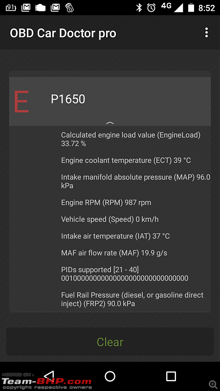

What is this error code. P1650?
Cracking the Da Vinci "TATA Safari 2.2l" ECU Code-screenshot_20151020085203.png

P1650 - Due for servicing.
