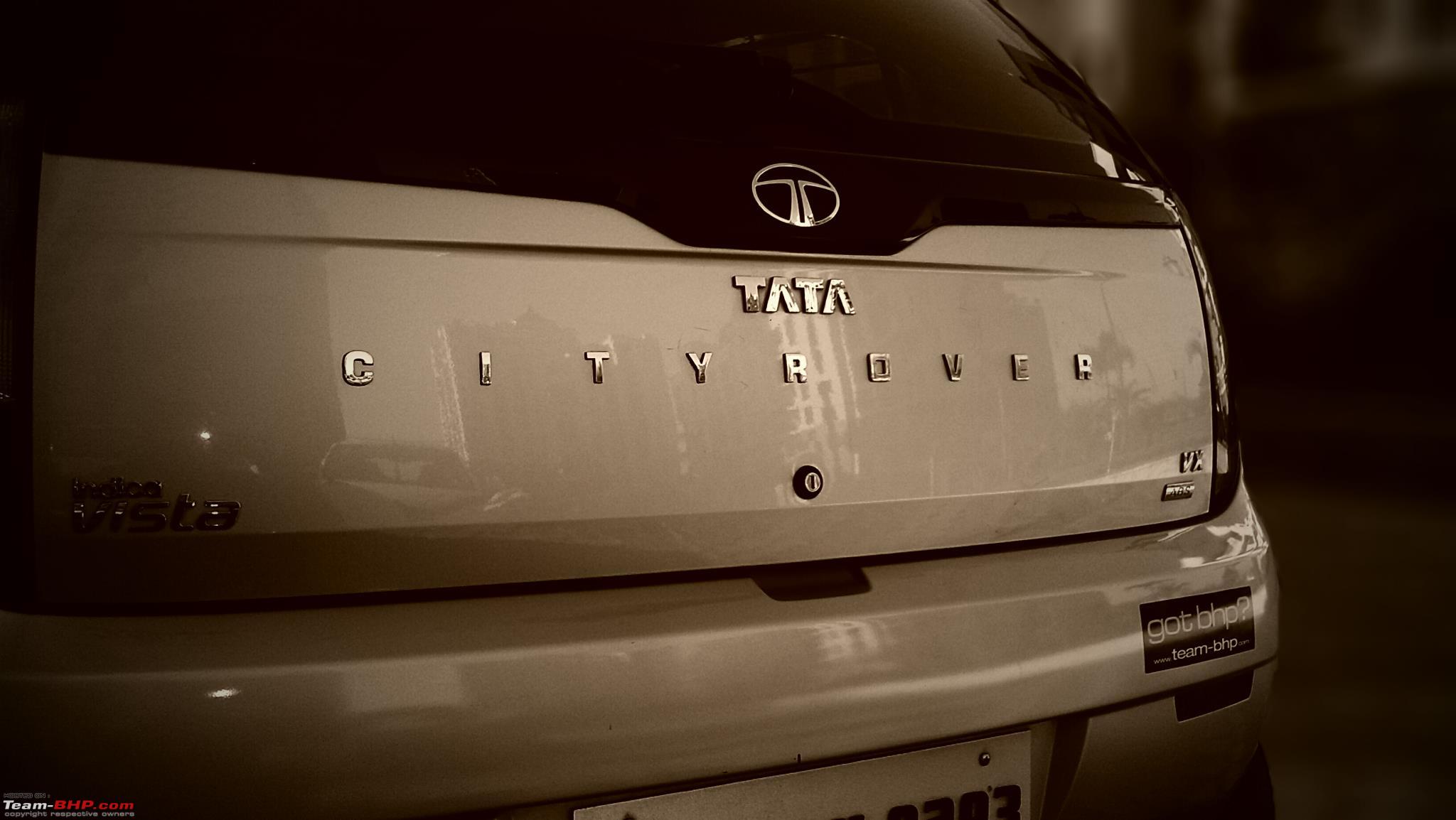

Hi friends, I own an Indica Vista and totally in love with my Car. I have purchased it Jan 2012 and it has completed 50k Kms on the ODO. From past few days I hear slight rattling sound from the front right hand side of the vehicle.
Has anyone else faced this issue?
Just to share the pic of my car. This was clicked last to last year.
Indica Vista - list of Known problems-883659_10152658532955647_62883097_o.jpg
