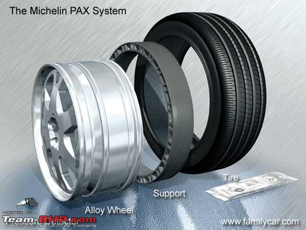

1) I saw in NatGeo program that there is another solid layer after the tyre surface in run flats. This layer is connected to the rim with spokes ( ofcourse very small ) and the surface is quite stiff. Dont know if this is true for all run flats or not.
Basically there is not a huge logic behind run flats being available in cars. They are good for emergency situations, but I am sure in case of a puncture in run flats, the ride quality will be reduced even further.
And if all the 60-80 kms are used after the puncture, the life of run flat tyre is already reduced. This means a new tyre will be required = business for many.
2) BMW designed the 5 ( or 3 ? ) series such that there is no space for spare wheel. I mean in the bodyshell there is space for spare wheel and this is where the spare wheel is located in all cars, under boot floor. But for the 5-series there is no such space. There was an issue reported in TOI a long time back that Indian norms require the spare, and BMW was not happy about it.
I dont exactly remember if it was 3 series or 5 series, but BMW was very unhappy.
Run flats are not required by owners that is observed internationally too, but in India they will not listen to customer.

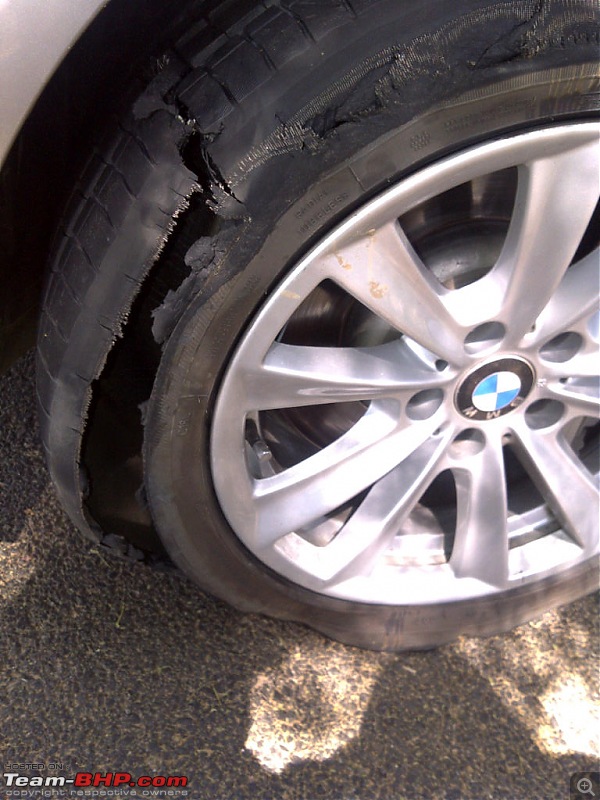

Well this happened Yesterday - I was driving to Hissar from Chandigarh and about 100 Km short of Hissar , front left tire went over a pothole & got an inch long cut , this was first time on my 530D which has much larger profile 55 ( 225X 55X 17 ) than my x6 on which its kind of regular affair .
Since my appointment was urgent , I continued at lower speeds <80 Km as advised by BMW , could do about 50-60 km without an fuss but after that I could go no further , had to park the car at friendly Toyota Dealership . Now getting tire of this kind about 200 Km away from BMW dealership is really a pain though BMW dealership offered to send Flat Bed but at costs since this wont be covered under Insurance . I was reluctant to use Flatbed not just for money but kind of wastage - towing the car for what a Tire burst
Eventually a tire with almost similar specs was found in Hissar & Toyota guys went out off the way to replace the Tire at there workshop without even charging a paisa - Thanks to Mallik Toyota
Now if the Tires can't last 200-300 Km after getting damaged - How can BMW India assure customers on this technology ?

That's an eye-opener. If 50-60 km can do that to an RFT, and BMW service wants to charge the owner for sending a flatbed to fetch the car (instead of just sending a tyre across to replace), it's no surprise that one doesn't see too many BMWs on the Indian highways.
They offered a loaner to my person at Chandigarh though .
rest of the car i.e. suspension and rim etc are all right
How about space saver wheels? You intending to pick one?
ya , fortunately rest everything is very fine , in fact these photos were taken about 1 Km before I found Toyota Dealer , by the time I parked , it had gone even worst - shall post photos soon . I think Toyota guys even did balancing !
I was able to buy a Michelin one with little lower profile and shall use this as spare , I have spare Alloy already .
Yes , this is an eye opener as till date I have driven with flat tires less than few Kms mostly with punctures & was able to use the Tire again . But given the road conditions we have more chances of getting the cuts more so if travelling to rural parts .
