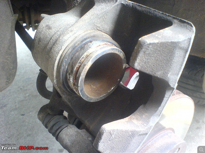

First the bad news.
We are not able to isolate the cause. There are multiple failures and we can only speculate as to what caused what.
Possible cause
As I've updated before there is a jammed caliper (left).
This was not there when the brakes were checked couple of days before the track day.
The caliper might have failed on the track (it would have eventually, there are too many unknowns here as I don't know if anything was done (or not done) by the previous owner. Considering the age of the car this is to be expected I guess).
The failure might have been triggered due to excessive heat. Excessive heat might be due to
- Pad fade or
- Fluid fade (possible but unlikely)
So natural thing was to stomp on harder. Which made it heat up more and made it worse.
Pad fade might have due to improper bedding in
Rotors were faced + new pads + 100% city driving = More chance of improper bedding in.

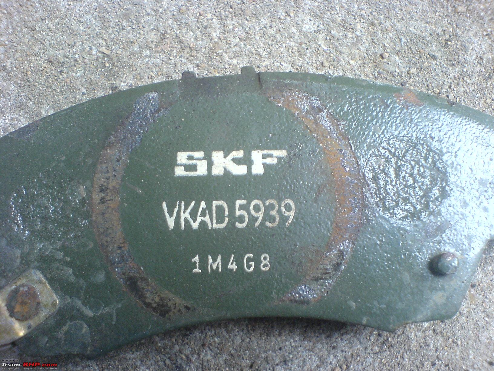

The jammed caliper had made the contact patch about 50% for the left pads. So this caused to improper heat build up and uneven wear on the pads. Pads are ruined now. Thankfully rotors are ok.
Blown Caliper

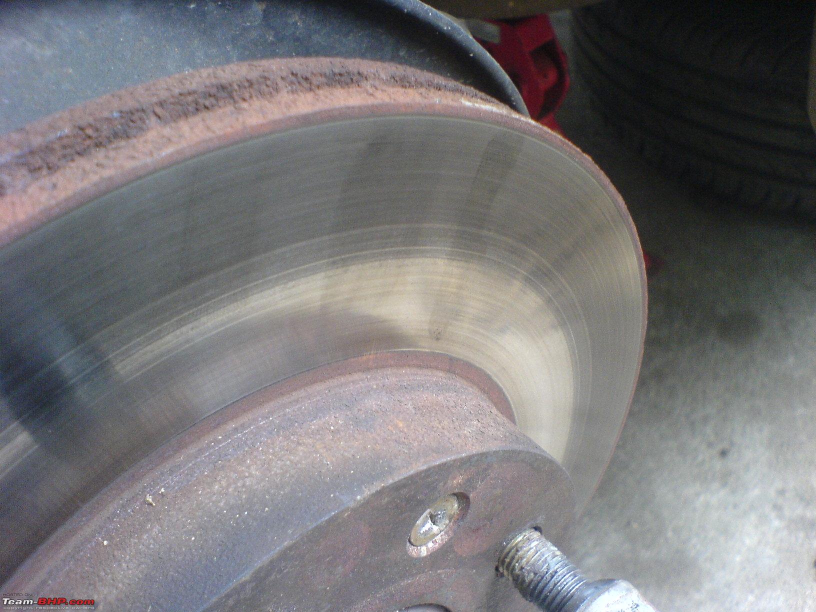

Rotor - The shiny area was the "contact" patch.
*Yikes* Brake fade / No Brakes - Cause and Solutions-dsc03082.jpg
Screwed up pad - See the uneven wear on the bottom
*Yikes* Brake fade / No Brakes - Cause and Solutions-dsc03083.jpg
Back side of the pad

Rotor (Right Side) - this is how it should be
*Yikes* Brake fade / No Brakes - Cause and Solutions-dsc03086.jpg

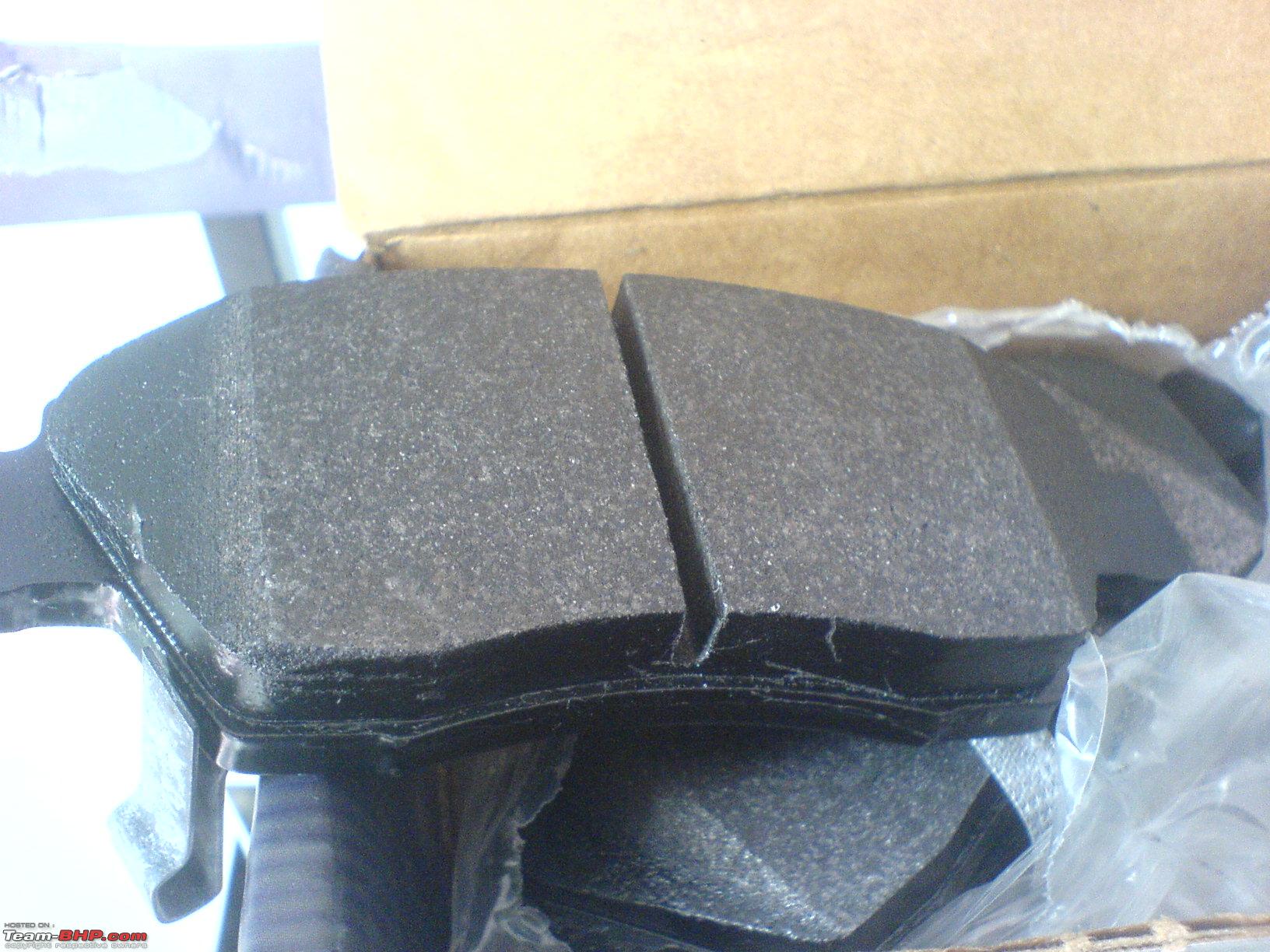

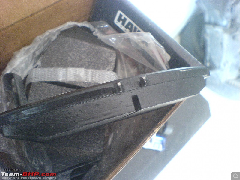

Plan of Action
Complete brake overhaul
Flush the system and new DOT4
Change Calipers both side
Hawk Performance Ceramic Pads
*Yikes* Brake fade / No Brakes - Cause and Solutions-dsc03087.jpg
*Yikes* Brake fade / No Brakes - Cause and Solutions-dsc03088.jpg
*Yikes* Brake fade / No Brakes - Cause and Solutions-dsc03089.jpg
*Yikes* Brake fade / No Brakes - Cause and Solutions-dsc03090.jpg
*Yikes* Brake fade / No Brakes - Cause and Solutions-dsc03091.jpg
