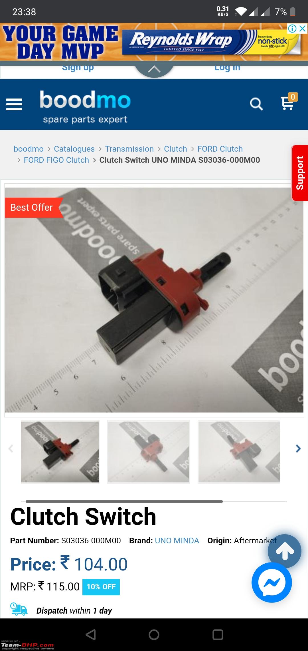

Here's a boodmo link for your perusal
https://boodmo.com/catalog/part-clut...tch-35944996/#
Figo TDCi: Dies occasionally while downshifting! Solved: Updated firmware by Ford-screenshot_20200217233821.jpg
Torq is offline   (1) Thanks
Thank you so much, really appreciate the link. I will just order it myself and get it exchanged. He reached out to it from under the dashboard so perhaps I could do it myself, need to check.
On the same page, I see other switches listed from 1500 to 2000 and they too are listed as aftermarket. Since this is a simple mechanical device, these prices seem like a big rip off, but should I be concerned about the one listed for Rs.100 on breaking too soon? I guess I can always keep the original as a backup, in case the car doesn't start.
