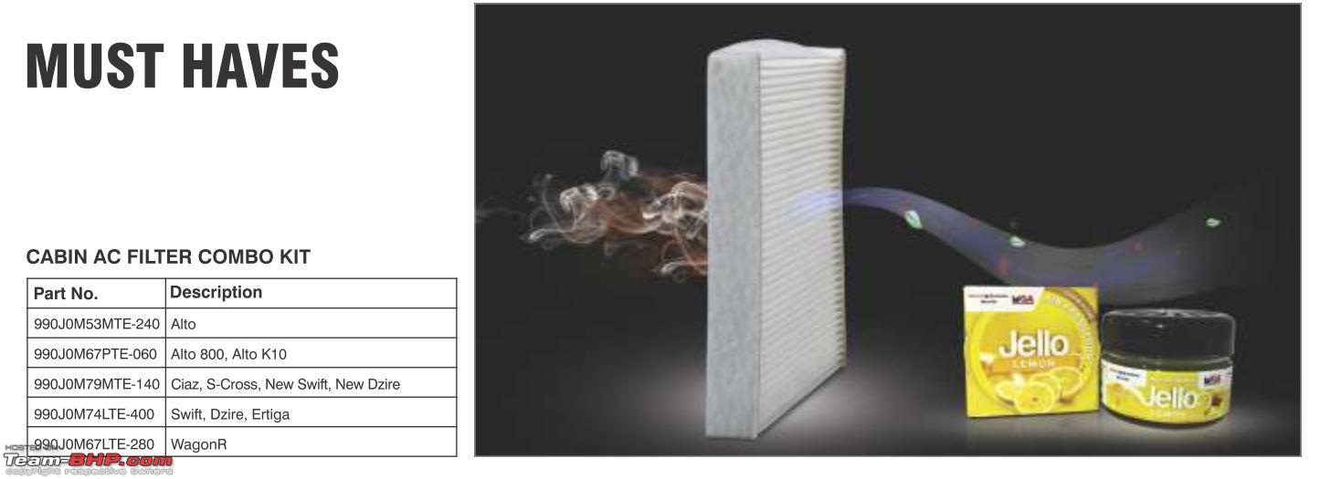

Realized a few days ago that my July'15 Swift VXi is not having in cabin AC filter. Surprisingly, my Sep'10 Wagon R LXi CNG had one from factory.
So I sent an inquiry on MGP site, got a call back from Swastik Motors (Maruti part distributor) that they have one in stock and it would cost Rs. 350/-. However, upon reaching Swastik Motors, they didn't have it in stock. Called up Amar Motors and they told me that car has to be brought in, they dont do counter sales of spares. Called up Maruti for this OTC sale of spares and the customer service executive on the line couldn't confirm anything.
Took the Swift to Amar Motors, they put the filter in place. However, earlier I was shown Swift's AC filter costing Rs. 499 and they take 10% of filter price as labor charge. SA told me car has to be in their premises for carrying out the installation as per rules, essentially. Gave go ahead. A few mins later, SA came back with another filter costing Rs. 549/-. Didn't realize that it was Ciaz. This filter came with a small perfume gel container. Should have read that it was Ciaz's filter. That perfume container is in parent's room right now as I frequently switch between Wagon R and Swift.
Not sure about this, but I feel that if Ciaz's AC filter can be installed in Swift, Swift's AC filter could be installed in Ciaz too. Knowing Maruti, part sharing can be definitely expected. Dont have dimensions for Swift's AC filter, but if someone can put it up, I would put up the Ciaz AC filter in my car.
My logic: In case Swift's AC filter and Ciaz's AC filter are similar, not only Swift's AC filter cheaper by Rs. 50/- (yes, not a significant amount, but still), but its more likely to be in stock that Ciaz. If any Ciaz owner can't get hold of AC filter, buy the Swift's and install.
Images attached for part number of AC filters.
No AC filter in my Jul'15 Swift VXi (image taken at night):
Review: 2nd-gen Maruti Swift (2011 - 2017)-no-ac-filter.jpg
Swift' AC filter:
Review: 2nd-gen Maruti Swift (2011 - 2017)-swift-ac-filter.jpg
Ciaz's AC filter:
Review: 2nd-gen Maruti Swift (2011 - 2017)-ciaz-ac-filter.jpg
Gel Perfume Container that came with Ciaz AC filter (as told to me):
Review: 2nd-gen Maruti Swift (2011 - 2017)-some-perfume-ciaz-ac-filter.jpg
What you have bought is the AC filter combo kit, consisting of the perfume gel, and filter. You have paid for both. Also, new Swift and Ciaz share the same air filter as its evident below(picture from Maruti's MGA brochure).
Review: 2nd-gen Maruti Swift (2011 - 2017)-capture.jpg
You can also buy only the air filter for your car, without the bundled perfume. Part details in that case would be:
Part Number: 95850M79M00
Name: CABIN AIR FILTER - CIAZ & NEW SWIFT
Listed under: MGA
Price: Rs. 395
