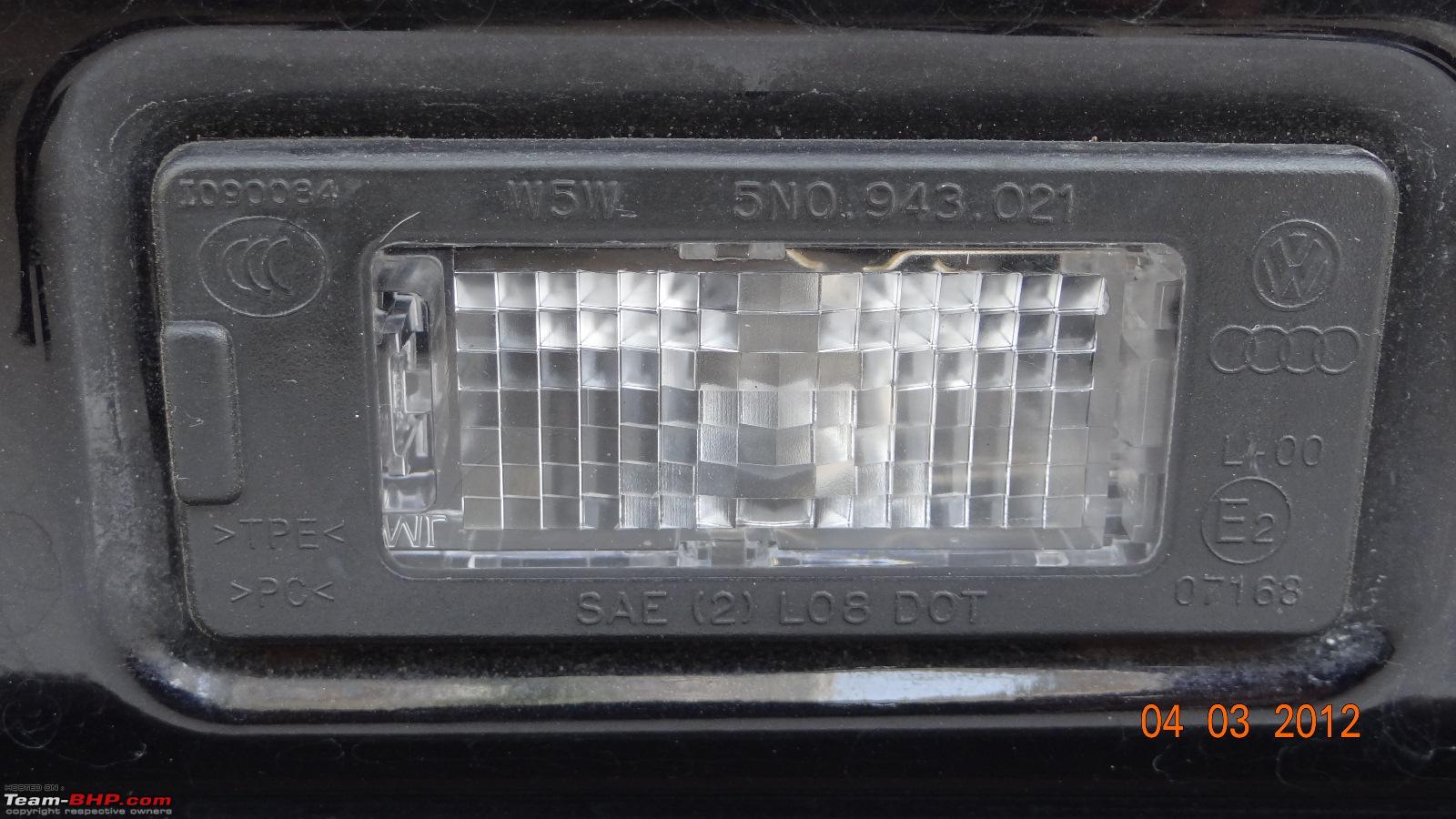

Rear Number Plate Lights: W5W type.
Started of with swapping the rear number plate with Philips Blue Vision W5W 4000K. Took a screwdriver and snapped out the rear number plate light out and changed them over. Easy work.
To confirm that they are working before snapping them in again, switched on the parking lights and voila. The rear number plate light are up and working.
Stage 1 complete.

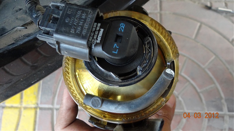

Next comes the fog lamps: HB4 9006 type for Vento.
I was first thinking changing bulbs in headlamp would be easier than fog lamps and fog lamps would be difficult to change. But it turned out quite opposite but not without a shock. Oh yes.
You need to use the Torix key(IIRC the name) present with the jack and others in thermocol box/structure in the rear boot, to pull out the cover of the fog lamps. First inserted it in the RHS(drivers side) fog lamp and it came out easily as I had earlier once pulled it out.
There are three screws and just unscrew them and fog lamp casing is out. Just snap out the cable and assembly is in your hands. Rotate the bulb in anti-clockwise direction and pull out the bulb. That simple.
But wait, I was still not confirmed about the type of bulb. So thought of verifying it through the bulb as I had it in my hands. But there was some paint on the number. Tried to remove it by my finger nail and off goes the bulb type with the paint. So what are the probability of the wrong bulb being purchased by me to be incorrect, 50:50.
Fine, lets not panic and open up the second fog lamp casing and verify bulb type through it, hoping that its clearly mentioned without any paint. Opening it up through the Torix key was tough as it was being opened up for the first time. Some muscle power and off comes the cover.
Unscrewed three screws holding the fog lamp and snapped the wire. Fog lamp casing was in my hands and hoping to find the bulb type finally. Turned the bulb anti-clockwise and pulled out the bulb.
Started to read the type of bulb it says H..HB...HB4 okay what next. 9..90..900, hoping last number is six and it is 9006 and I hit a six. Voila.
So finally I can change the bulbs finally to Philips Blue Vision HB4 9006 4000K type. Inserted the new Philips bulb, turned it clockwise and snapped the wire in. Screwed the three screws and inserted the cover finally. Left and right hand side done, what a sigh of relief.
Fogs lamps finally changed over to Philips Blue Vision HB4 9006 4000K after so much desperation.

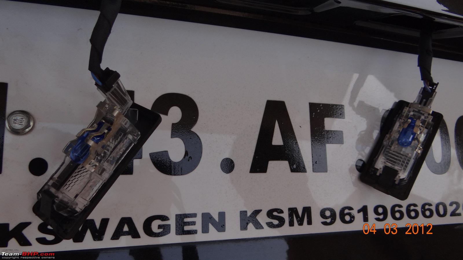

The rear number plate bulb casing.
Dark Knight has arrived! VW Vento TDi Highline. EDIT: 5th Service done-dsc03147.jpg
The bulbs Philips Blue Vision W5W 4000K for the rear number plate bulbs.
Dark Knight has arrived! VW Vento TDi Highline. EDIT: 5th Service done-dsc03148.jpg
First one to snap out.
Dark Knight has arrived! VW Vento TDi Highline. EDIT: 5th Service done-dsc03150.jpg
Both of them snapped out.
Dark Knight has arrived! VW Vento TDi Highline. EDIT: 5th Service done-dsc03151.jpg
New white bulbs Philips Blue Vision W5W 4000K successfully installed.
Dark Knight has arrived! VW Vento TDi Highline. EDIT: 5th Service done-dsc03153.jpg

Fog lamp bulb connector.
Dark Knight has arrived! VW Vento TDi Highline. EDIT: 5th Service done-dsc03160.jpg
Fog lamp casing removed by snapping out the bulb connector.
Dark Knight has arrived! VW Vento TDi Highline. EDIT: 5th Service done-dsc03161.jpg
Made in Slovenia, Hella.
Dark Knight has arrived! VW Vento TDi Highline. EDIT: 5th Service done-dsc03162.jpg
Off goes the bulb type with the paint.
Dark Knight has arrived! VW Vento TDi Highline. EDIT: 5th Service done-dsc03163.jpg

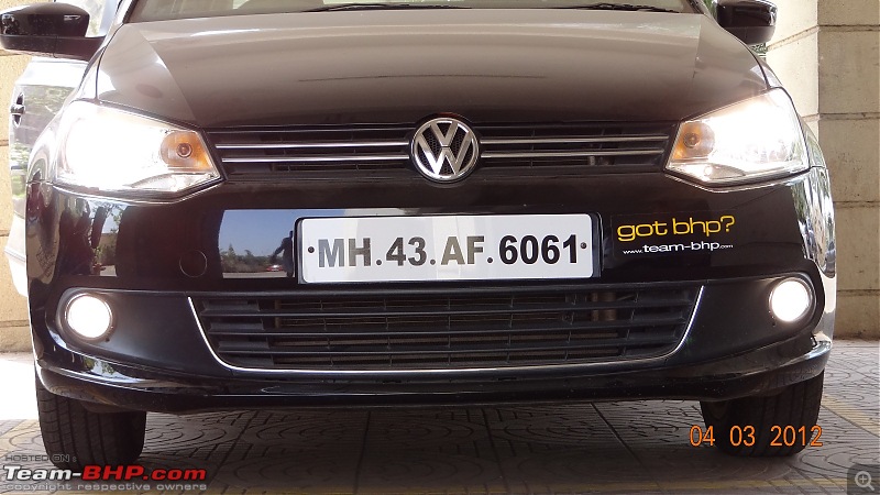

Dark Knight has arrived! VW Vento TDi Highline. EDIT: 5th Service done-dsc03165.jpg
Another shot, but in daytime. It is white light finally.
Dark Knight has arrived! VW Vento TDi Highline. EDIT: 5th Service done-dsc03166.jpg
Just the new fogs with old parking lights, up and bright.
Dark Knight has arrived! VW Vento TDi Highline. EDIT: 5th Service done-dsc03167.jpg

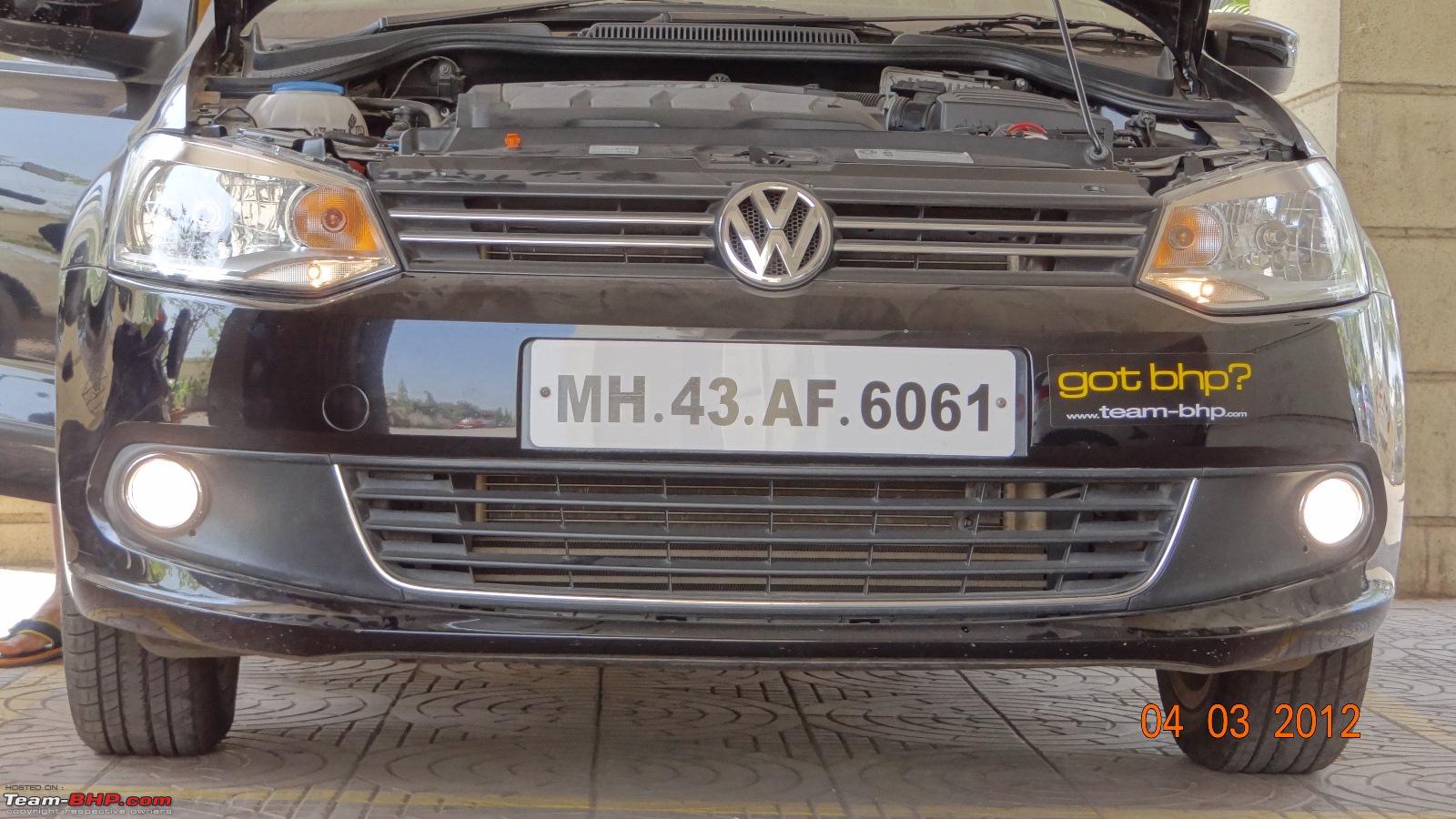

Fog lamps with new bulbs close up.
Dark Knight has arrived! VW Vento TDi Highline. EDIT: 5th Service done-dsc03168.jpg

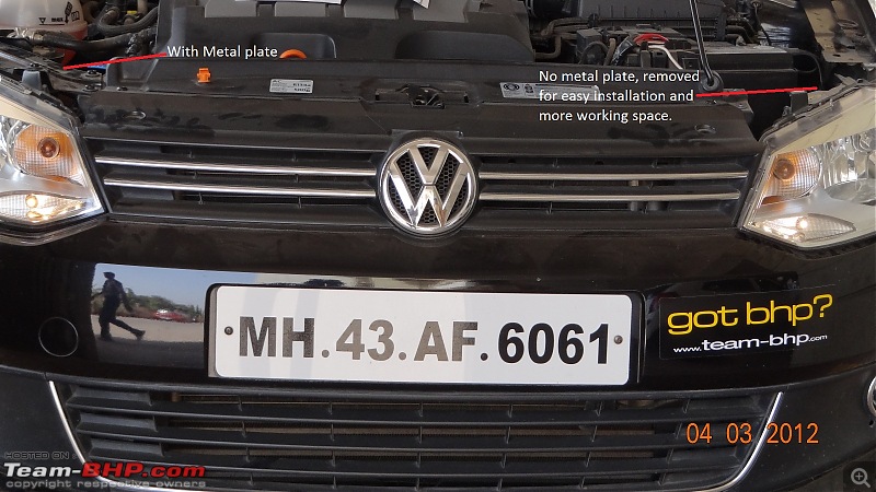

Metal plate removal, with and without for easy installation.
Dark Knight has arrived! VW Vento TDi Highline. EDIT: 5th Service done-dsc03171.jpg

New white light bulbs finally, with parking light too installed.
Dark Knight has arrived! VW Vento TDi Highline. EDIT: 5th Service done-dsc03174.jpg
Complete installation done.
Dark Knight has arrived! VW Vento TDi Highline. EDIT: 5th Service done-dsc03176.jpg

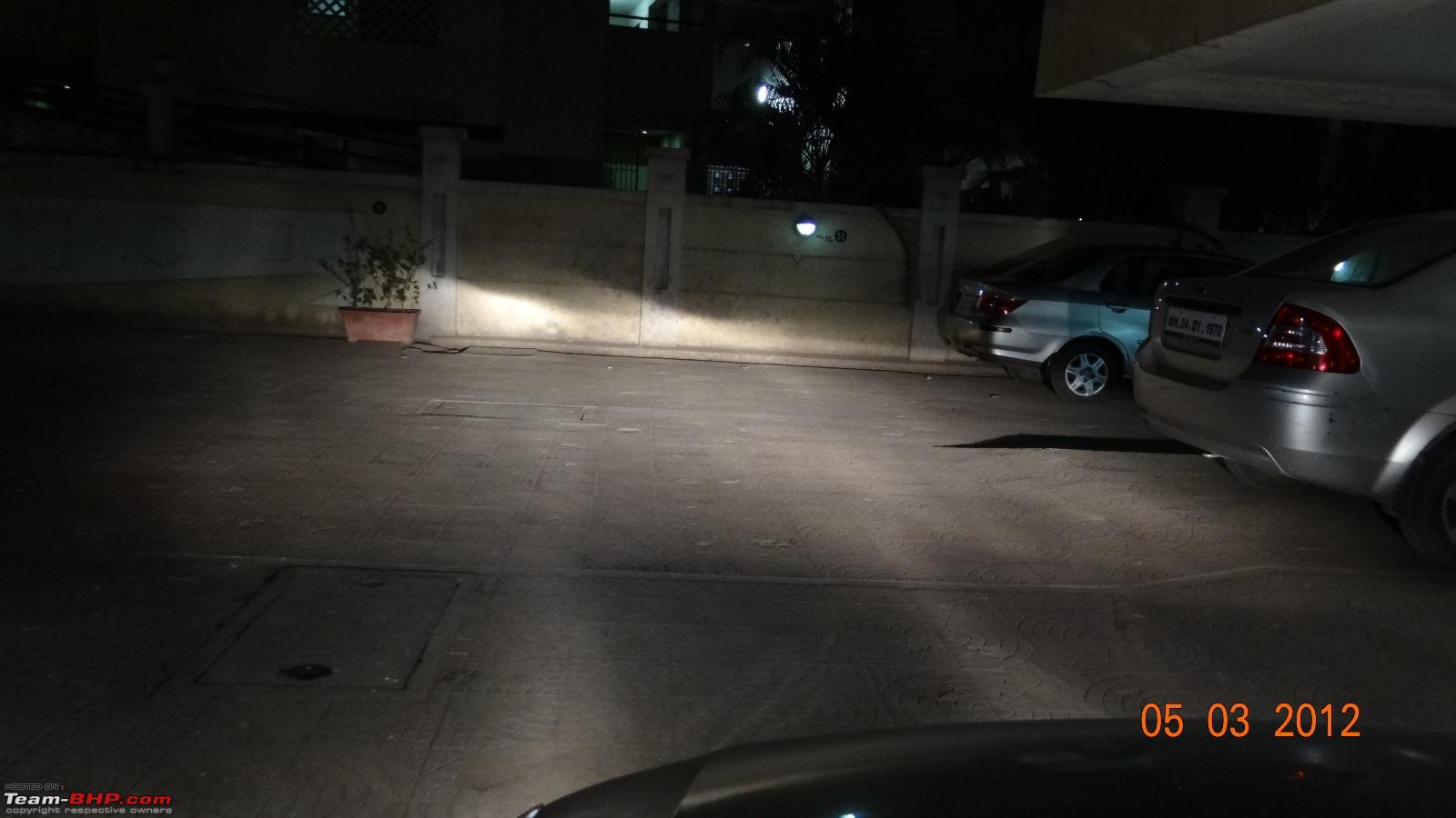

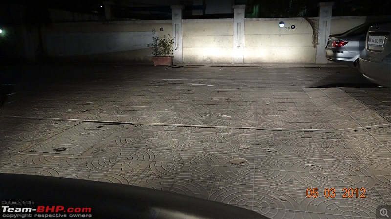

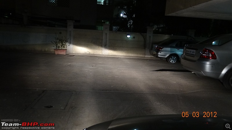

Low Beam Philips Essential Vision 100/90W H4.
Dark Knight has arrived! VW Vento TDi Highline. EDIT: 5th Service done-low-beam.jpg

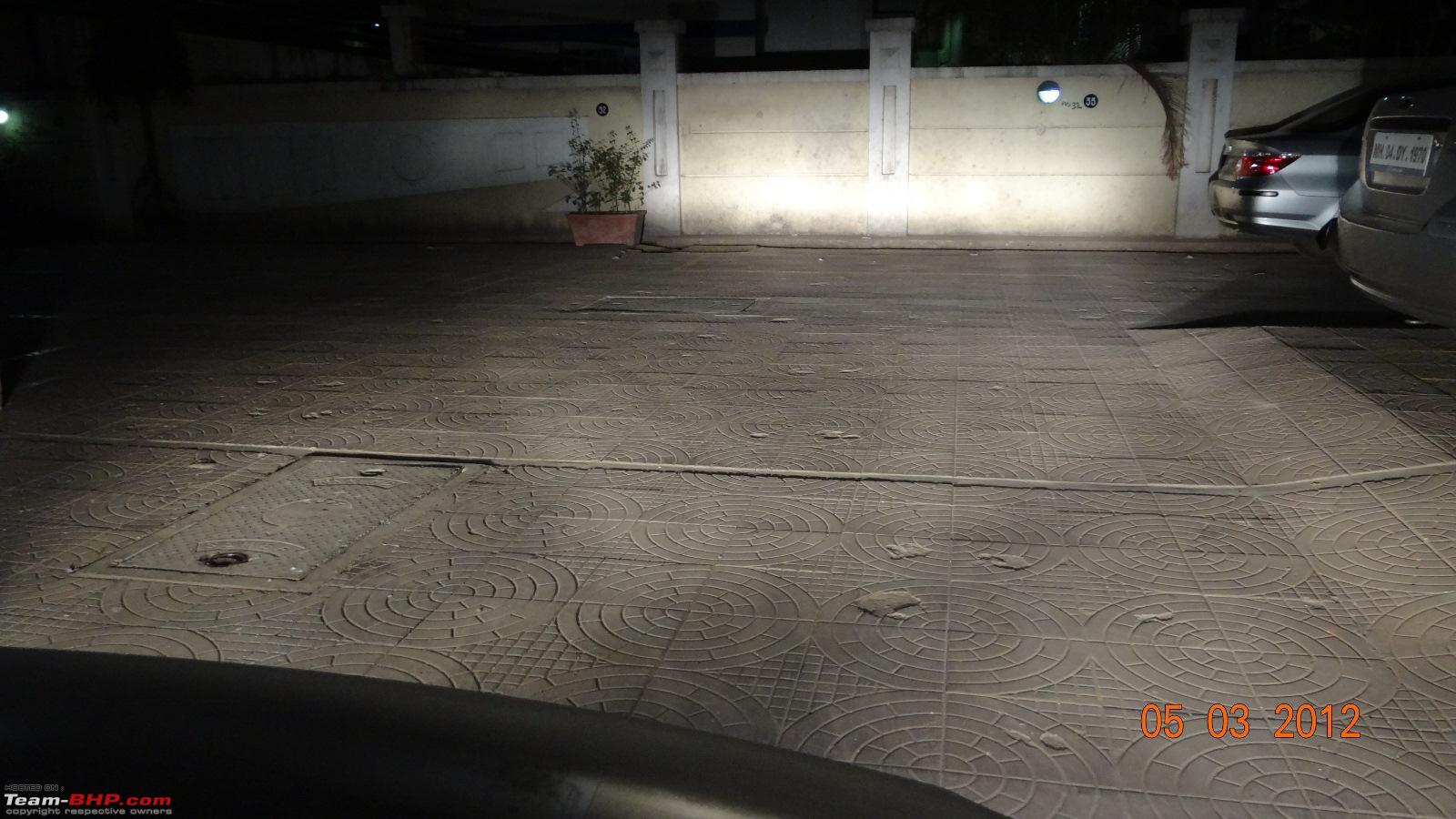

Low beam with good illumination.
Dark Knight has arrived! VW Vento TDi Highline. EDIT: 5th Service done-low-beam2.jpg

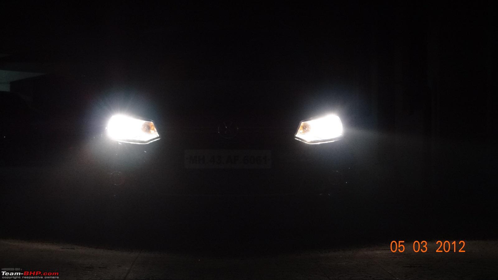

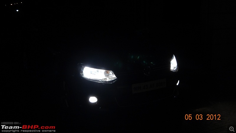

Low beam with fogs.
Dark Knight has arrived! VW Vento TDi Highline. EDIT: 5th Service done-low-beam-fogs.jpg
Low beam with fogs, another shot.
Dark Knight has arrived! VW Vento TDi Highline. EDIT: 5th Service done-low-beam-fogs2.jpg

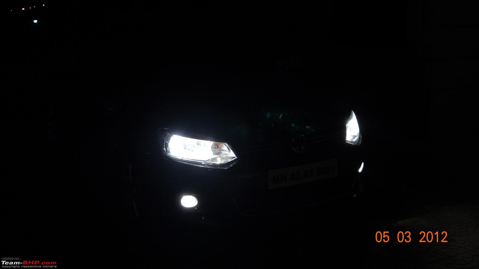

High beam Philips Essential Vision 100/90W H4.
Dark Knight has arrived! VW Vento TDi Highline. EDIT: 5th Service done-high-beam.jpg

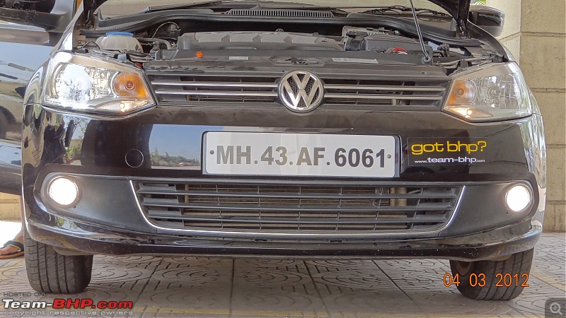

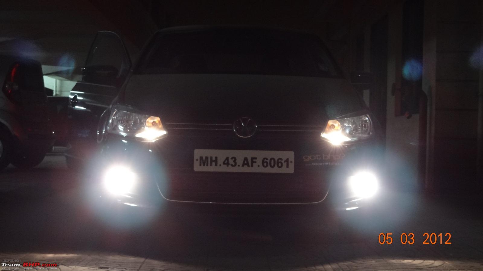

Just the fogs Philips Blue Vision HB4 9006 4000K.
Dark Knight has arrived! VW Vento TDi Highline. EDIT: 5th Service done-fogs.jpg
Just the fogs Philips Blue Vision HB4 9006 4000K, another shot.
Dark Knight has arrived! VW Vento TDi Highline. EDIT: 5th Service done-fogs2.jpg
Philips Blue Vision HB4 9006 4000K fog lamps with good illumination.
Dark Knight has arrived! VW Vento TDi Highline. EDIT: 5th Service done-fogs3.jpg

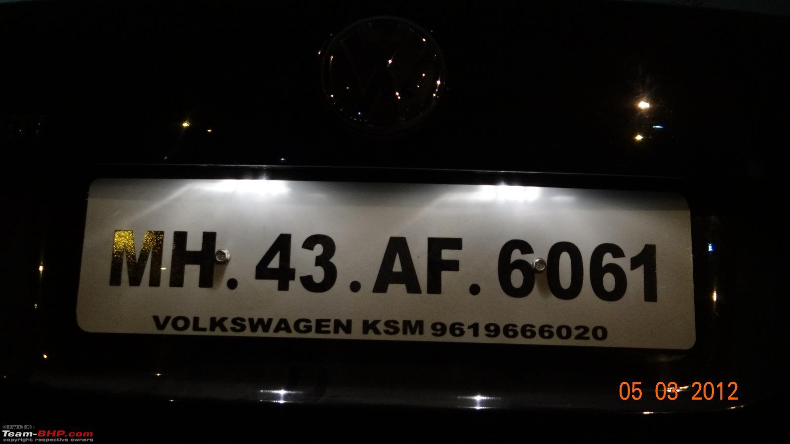

Philips Blue Vision W5W 4000K bulbs.
Dark Knight has arrived! VW Vento TDi Highline. EDIT: 5th Service done-parking-lights.jpg
Another shot with Philips Blue Vision W5W 4000K bulbs.
Dark Knight has arrived! VW Vento TDi Highline. EDIT: 5th Service done-dsc03190.jpg

Originally Posted by el lobo 6061 View Post
The night shots and the most awaited: The final set.
Attachment 897419
Attachment 897420
Low beam with fogs.
Attachment 897421
Attachment 897422
Attachment 897423
Attachment 897424
Attachment 897425
Attachment 897426
Attachment 897427
Attachment 897428
Thanks for reading, and hope it helps out everyone with the D.i.Y.
A Detailed and crisp review of D.I.Y. with nice set of pictures, Your Sony Camera did right justice to the pictures, they are exactly as i wanted them from my phone camera . Although your Sony is leagues ahead and cannot be compared with my mobile's puny camera.
You must be very happy finally managed everything by yourself.
Even i had a fascination for white light and i too use to turn around and keep looking the car with white light, the first one i saw was a Skoda Octavia and since then i was carving for white light for my black beauty. The purpose was solved when i joined Team-Bhp and Auto lightning thread was icing on the cake
I am sure this setup would serve your purpose for a long time.

Originally Posted by Rachit.K.Dogra View Post
Wow!! Lovely!! Was eagerly waiting for you make these changes to the car. You did all this yourself? Cool.
Thanks!
1) First being how is the light? For low beams the spread remains the same or it also increases with the intensity?
The spread remains the same, as earlier too I was using Philips 100/90W. Not much difference, high beam does feel tad better. Yesterday had done for grocery shopping, took the car out. There was a stretch which was pitch dark and at low beam the road was very well illuminated and it was pure white light. No tinge of yellow.
2) How big a hole in the pocket??!
As driving_smartly said, I have put up the cost in post #57. A copy paste further.
Philips Essential Vision H4 100/90W Rs. 300 per piece X 2
Philips Blue Vision HB4 9006 55W 4000K Rs. 675 per set. X 1
Philips Blue Vision T10 W5W 4000K Rs. 100 per set. X 2
All the prices are including Vat 12.5% with bill.
Total = Rs. 1475 with bill. But it is definitely worth it.
Great write-up & detailed explanation of the procedure supported by excellent pictures. Keep it up buddy
Thanks!.
Originally Posted by M124 View Post
Thanx for the detailed explanation. Is there any difference in the brightness of the fog lamp bulbs than earlier or is it almost the same ? Are relays needed for fog lamps too ?
The stock fogs are of a company named Sylvania 51W. I have replaced them with Philips Blue Vision HB4 9006 55W 4000K. There is certainly difference in illumination, the output is more and spread is better. Additional 4W did make some difference.
No relays used, as stock were 51W and the new ones are 55W. 4W wont cause much difference in heat and most companies use 55W as standard compared to 51W that were present in my Vento.
Thanks. Doing it all by myself was the best part as I was very cautious with every part. VW workshop was not ready to do it and roadside mechanics would have ripped the bumper to just create some space for working, which was not acceptable. Good to know that my Sony managed to take good pictures.
Same here, with inputs and photos of your Essential Vision bulbs made the decision taking easy as I knew what the bulbs would be like. Team-Bhp Auto lightning thread helped me out with inputs from many bhpians.
Yep, for long but if any day Philips introduces 100/90W bulbs higher than 4000K would definitely be tempted to change over again.
