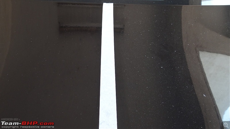

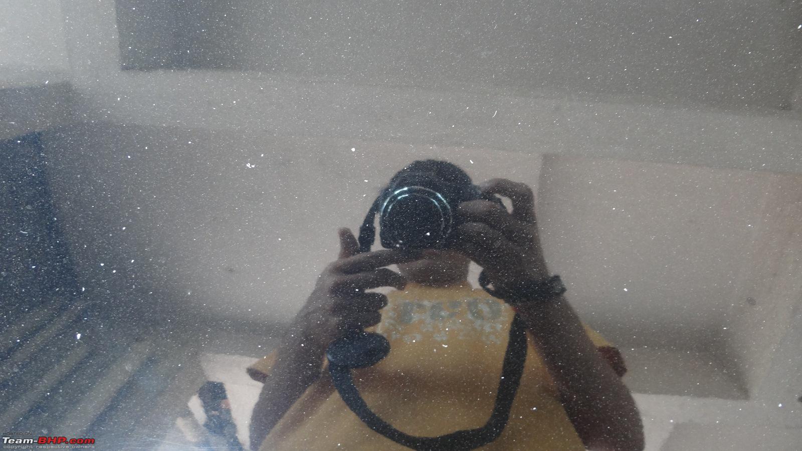

Claying is a process which removes the bonded contaminants onto the surface. Your question, but I just did shampoo which has cleaned the surface, why do I require claying?
Well car shampoo just cleans the surface but it does not remove bonded contaminants. Claying is a simple process which removes the contaminants that are stuck to paint which you actually cannot even seen by naked eye.
After claying the car, you would be surprised how much contaminants were there on paint surface. Another benefit is surface becomes absolutely smooth to touch.
As I said earlier, do small areas & keep progressing further. Take the claybar, spray the paint surface with quick detailer(QD) & clay bar too. Start doing in long strokes in flow of wind over the car be like. Keep spraying the QD as you progress. As the clay bar picks up contaminants, keep folding it inside & kneed it. No rocket science.
