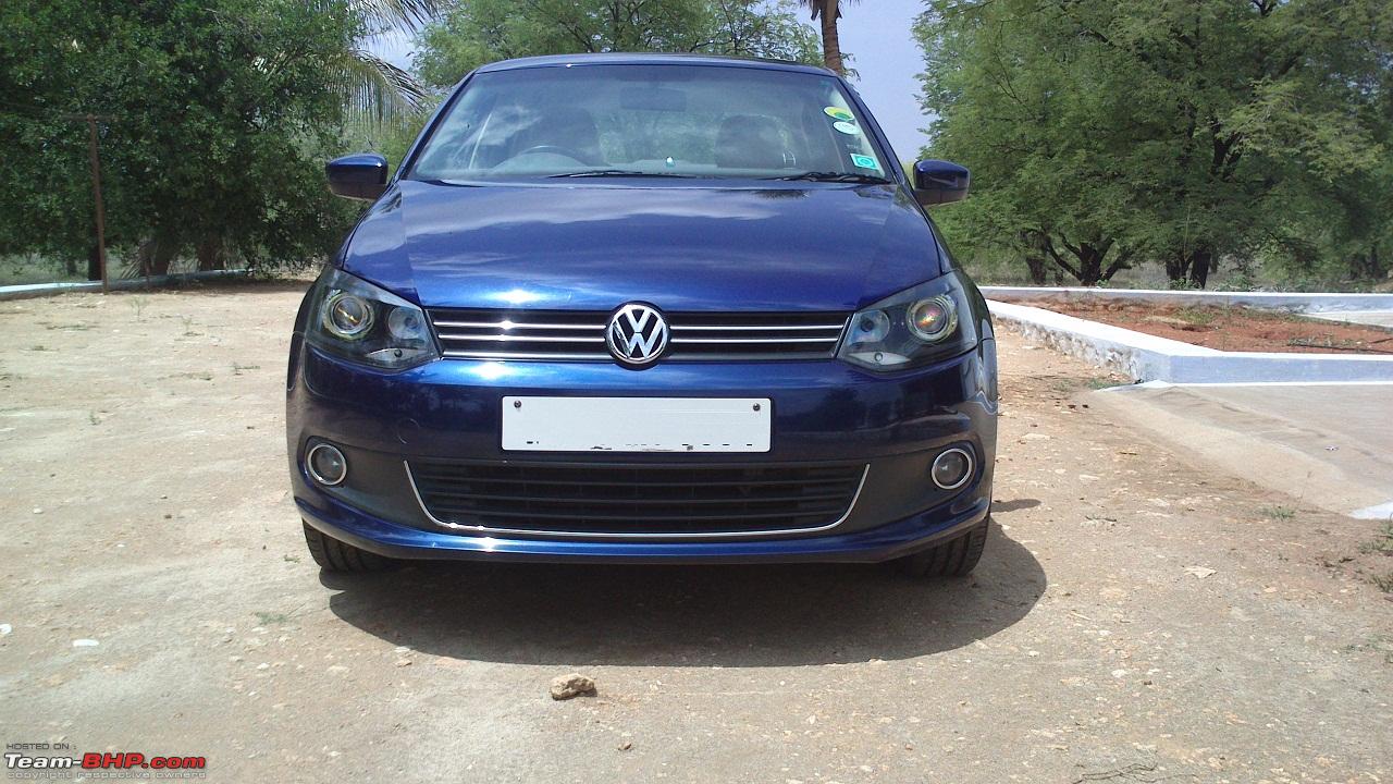

Sorry for the delay, Adding pics. Please let me know any questions.

Looks superb! Please do post pics of the beam patterns,high and low. Interested in the intensity mainly. Also, was the FX-R a DIY retrofit or you sought the help of a professional ?
Sure, I will add the beam pattern.
I did the drawing, paper model before going live.
All these from my DIY :).
Adding some more pics

FXR Final look

Whoa! Your Vento looks smashing in a menacing type with those projectors. Superb stuff TopSpeeder! Thanks for those cut-out ideas. After watching too many DIY's on youtube I wasn't very confident of doing it myself so i'm thinking of sourcing some el-cheapo headlights to experiment before I actually do it on my car.
