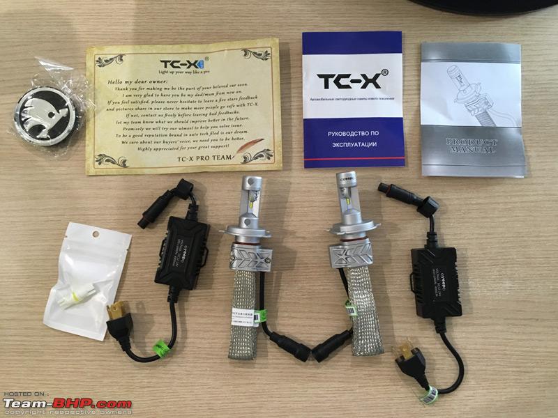

It came with its own set of driver component as separate from the LED bulb. The build quality is excellent.

This LED bulb has no fans or head sink at the base, rather have flexible copper cooling belt design (passive cooling) and plugs directly into the OEM socket.

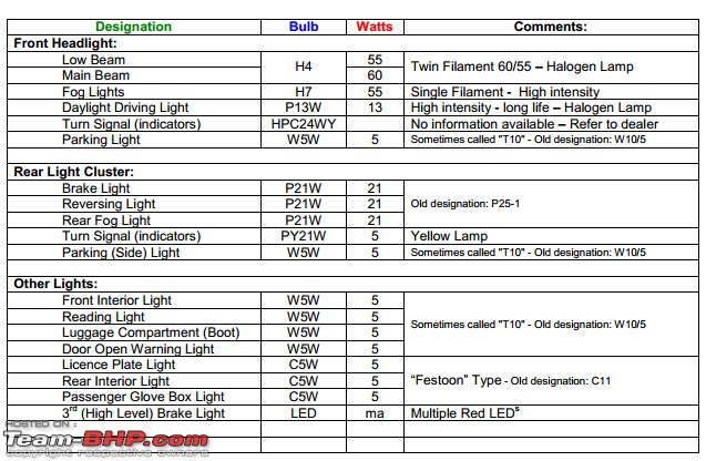

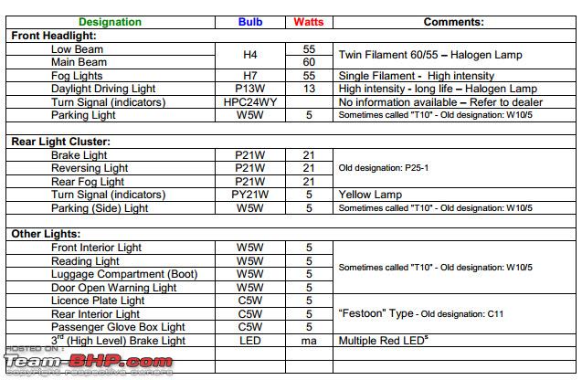

BULB Types used in Skoda Yeti (pre-facelift)
