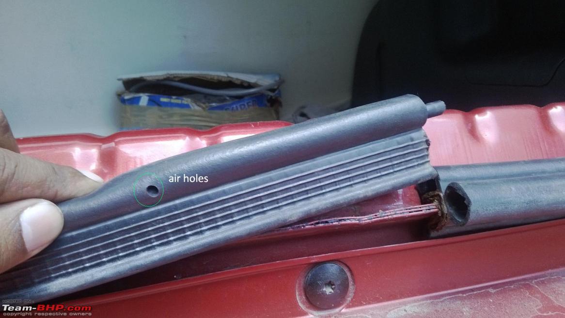

I first removed the entire beading from the body of the Duster. The term door beading is an oxymoron in this case since the beading is mounted on the shell. apply a liberal dose of talcum powder onto your hands and try to push the rubber cord into the outer hole of the beading as shown here.Remember, talcum powder on your hands should coat the outer contact surface of the rubber cord.
If you notice carefully, you will see small holes along the lining of the beading as shown here.
these holes allow for trapped air to be released when you close the door. at intervals of three holes, pry out the rubber cord inside the beadings using a screw driver to the desired length. Then, insert the rubber cord into the beadings into the opposite direction for the next three holes. With proper lubrication of talcum powder and application of intuitive presence of mind, inserting the rubber chord for the full length of the beading should take around 15 minutes maximum using 2 people.

Just fantastic, this is indeed a great find.
I don't think this will reduce the life of the beads.
With the noise totally gone, the ride must feels all the more solid as resistance will make the locks hold on to the body in a better way.
Hats off to that person and you. Enjoy the new fantastic, solid ride.
