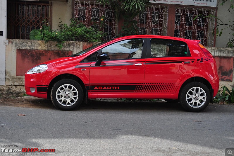

The side profile look
The Red Rocket - Fiat Grande Punto Sport. *UPDATE* Interiors now in Karlsson Leather-dsc_0032.jpg

The Abarth stripe. Note the 2 separate stripes
The Red Rocket - Fiat Grande Punto Sport. *UPDATE* Interiors now in Karlsson Leather-dsc_0650.jpg
Another few shots of the same stripe
The Red Rocket - Fiat Grande Punto Sport. *UPDATE* Interiors now in Karlsson Leather-dsc_0651.jpg
The Red Rocket - Fiat Grande Punto Sport. *UPDATE* Interiors now in Karlsson Leather-dsc_0657.jpg
The Red Rocket - Fiat Grande Punto Sport. *UPDATE* Interiors now in Karlsson Leather-dsc_0655.jpg
The front bumper stripe ends at the fog lamp
The Red Rocket - Fiat Grande Punto Sport. *UPDATE* Interiors now in Karlsson Leather-dsc_0661.jpg
The side stripe starts at the same level from the front fender and tapers away towards the end. This side stripe measures a whopping 1.8 metres in length!
The Red Rocket - Fiat Grande Punto Sport. *UPDATE* Interiors now in Karlsson Leather-dsc_0662.jpg

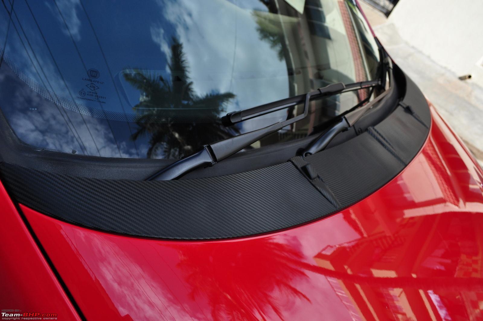

And the bonnet plastic panel housing the windscreen washer jets got the same treatment too. Goodbye to plastic polish now. Basically, every exposed piece of plastic outside is now carbon fibre wrapped. If you can't beat them (at fading), destroy all evidence that they exist!
The Red Rocket - Fiat Grande Punto Sport. *UPDATE* Interiors now in Karlsson Leather-dsc_0663.jpg
The Red Rocket - Fiat Grande Punto Sport. *UPDATE* Interiors now in Karlsson Leather-dsc_0664.jpg

The 3M guys have done a great job with the wiper plastic area, it looks carved out of CF.:thumbs up
