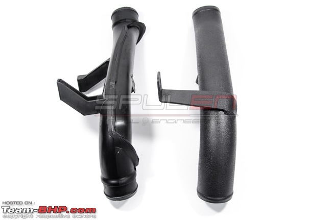

2. The turbo seemed to be struggling a bit on the track. Could feel it in the car, so decided to check the pipes from turbo to intercooler and throttlebody and what i saw amazed me. What a terrible piece of engineering.
Solution- Upgraded to Spulen Boost Pipes.

Comparison - Stock vs Spulen Turbo Outlet Pipe

Results is again amazing! The car has gotten even smoother. The power comes on instantly. Very little turbo lag. The turbo also seems to be working less harder to reach peak boost. Power levels also feel increased, and the boost is coming on earlier and smoother.
