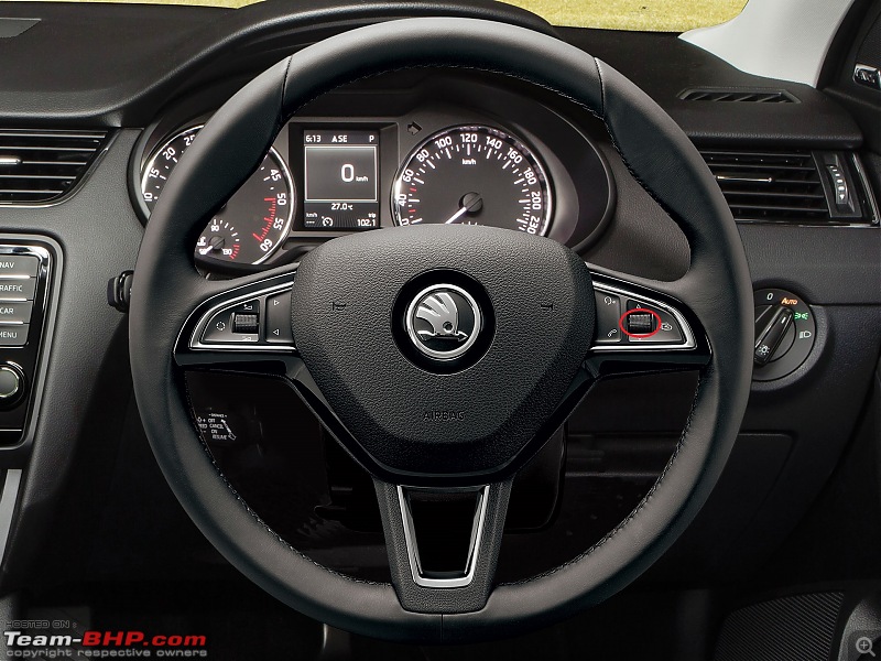

Good evening everyone. Need some help!
I recently damaged the selector knob(Right hand side one(as highlighted in the image) on the steering wheel of my Octavia. The knob seems to have cracked and am therefore unable to use it.
Is there anyway to replace only the selector knob? As in only getting the small knob replaced? I had a word with my dealer and he told me that the part comes as a whole assembly(for both the left and the right, along with the other controls), the price of which is 17950/-. Paying an amount like this for the replacement of a small knob doesn't quite make sense, considering I could go in for another steering wheel by paying an additional 10~20K (A steering wheel with paddle shifters).
Can someone please advise! Thanks

Unfortunately the dealer is right. Generally the left and right steering controls come as a set, and you will have to replace the full thing. Maybe its time to upgrade to a better wheel with paddles are you mentioned?
You can check for these parts on ebay, etc which may be cheaper than Skoda India. But then again that is a risk as you never know whether the part will work or whether it is the correct part.
Artem, myself and NewtonMeter seem to have variants of the same issue, and all requiring a major expense! We are lucky that the knob is working and only the black plastic base panel is loose.
My vehicle is going for its first service this month and I will check for warranty coverage if at all possible.

Hello itwasntme! Thanks for the post. Yes i completely agree with what you have mentioned, i personally feel it is not worth the price, but again, can't use a broken knob on the wheel. The selector knob is pretty handy for changing the display and switching between various data screens. Mine is however cracked and broken and therefore completely unusable. Considering the part shall cost me a substantial amount, I was thinking of upgrading the steering to a one with paddle shifts.
Members who have installed the MFSW with paddles in their Octy's, can you all please suggest dealers/ stores from where to procure the same. Thank you.
