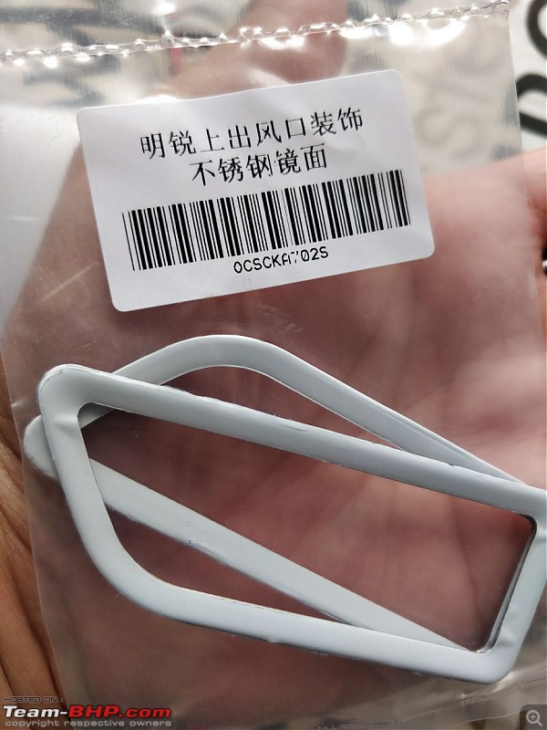

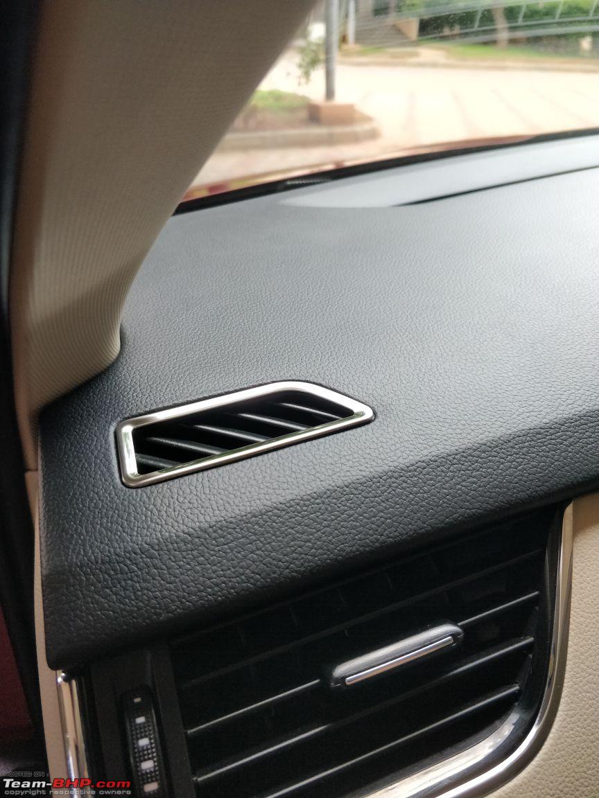

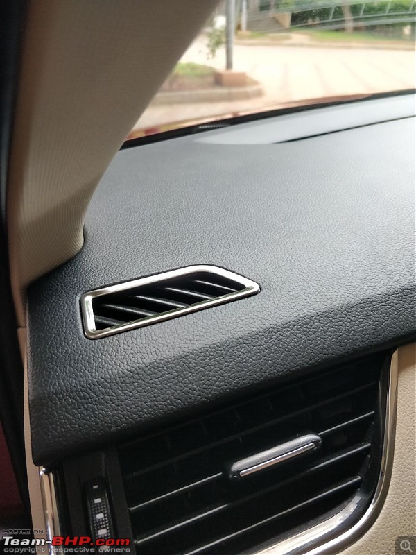

Bought a couple of Aliexpress chrome embellishments for my Octy . Total investment was 5$ with shipping.
Mixed feelings though:
