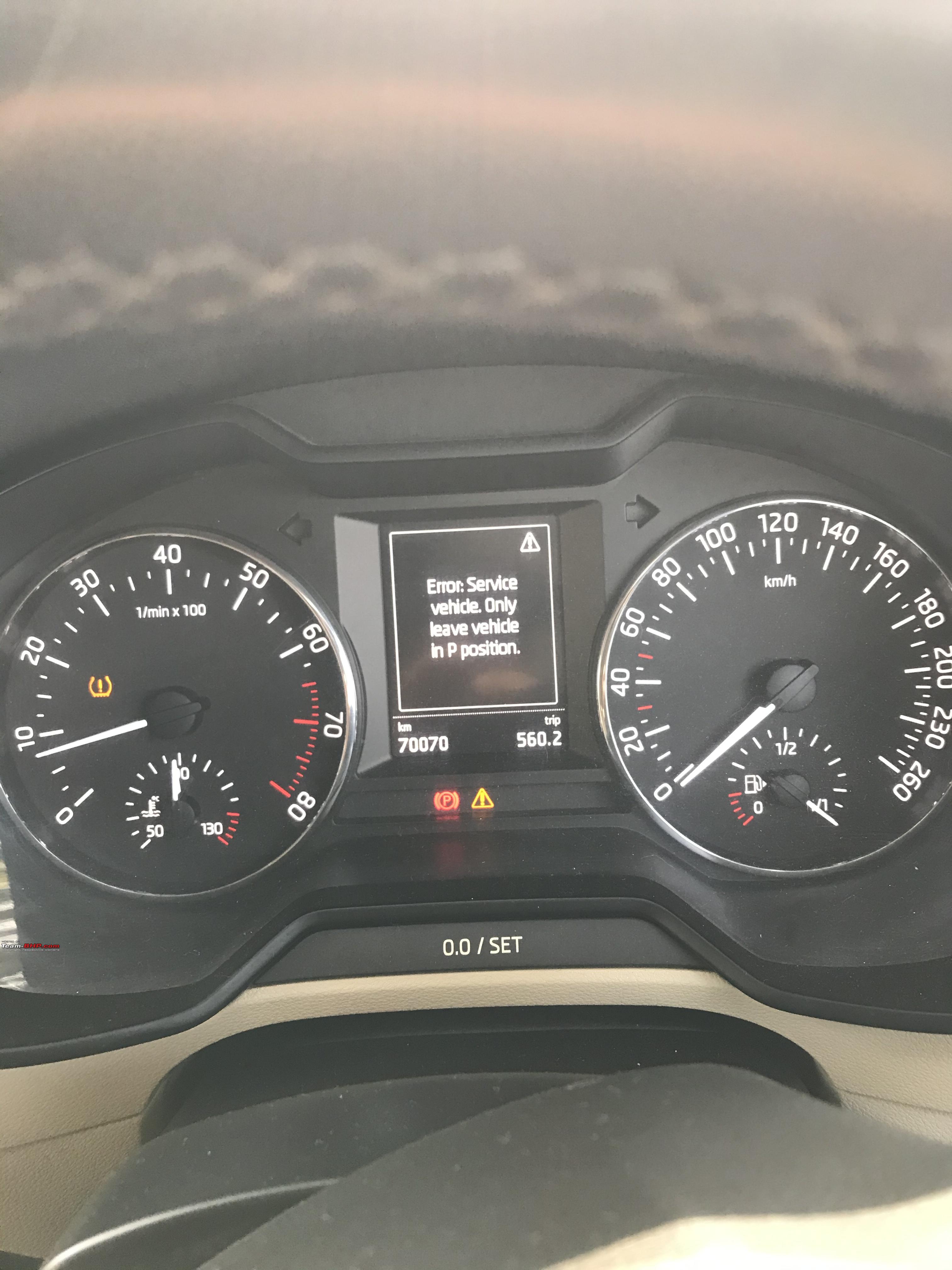

I’m having this warning pop quite often which disappears by itself almost immediately. This I have been experiencing since two years. I reported it while service but there was no indication of any issue by them. Al though I could not take screen shot of the exact error all these while.
Recently on long journey after many months, I could see this error stay for a while for me to take a picture. But again this disappears quickly and no issue what so ever. Any clue what this error means?
Review: Skoda Octavia (3rd-gen)-eaa3add9e6a449d0859059bdc48031c1.jpeg

It is a sensor in the shifter assembly that's either gone bad or has dirt accumulation due to which it gives wrong signals about the gear being in 'P' mode when it is not and vice versa. The only solution is changing the whole assembly I believe. Typical problem affecting many VAG cars that share this part.
Very correct! I'd strongly suggest a visit to the workshop and check if there are any technical bulletins etc. and how much the sensor assembly is.
Refer these threads:
https://www.briskoda.net/forums/topi...in-position-p/
https://www.golfmk7.com/forums/index....330339/page-4
You don't want it appearing when you're outstation somewhere with family et all.

we had the same issue in our car since it was around a year old. Every service i was told that is was checked a nothing to worry. Frequency of this kept increasing over the years.
finally just before the warranty expired, they replaced the shifter cable assembly which costs 70-80k.
Its been a year and half since the replacement and that error has not popped up again.
If your car is still under warranty, push for a replacement. Otherwise i think is should not cause any major issues other than that annoying error pop up once in a while.

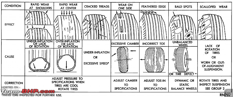

In my recent highway drive I started noticing this weird humming coming from tyres or somewhere else. It was very prominent at low speed and at high speeds, as the tyre rotation speed increases, it increase in frequency and hence not much noticed.
I showed it to a tyre dealer and the technician diagnosed it as step type wear of front tyres. As shown in attached pic, the wear is at multiple.places as patches and hence the humming. This is only there at the inside of front tyres.
However, the tyre technician says that it may not be an alignment issue and did not even push for for an alignment. He thinks that it could a suspension issue.
As of now, I have rotated the tyres and the humming has reduced a lot as the damaged tyres are at the rear now.
Has anyone faced this issue? Please advise if It could be a suspension issue and if I should urgently take the car to the service center.
You didn’t mention the mileage & year of your car, but something in your front end is worn & needs attention. Do not change your tyres before fixing the underlying problem or else the new tyres with suffer from the scalloping/cupping just like the previous set.
For your reference -
Review: Skoda Octavia (3rd-gen)-03b0566f1d994faaa07e2afcf48c2fb3.jpeg
Review: Skoda Octavia (3rd-gen)-6bde5c9242f2493a9b283033a6c945fc.jpeg
