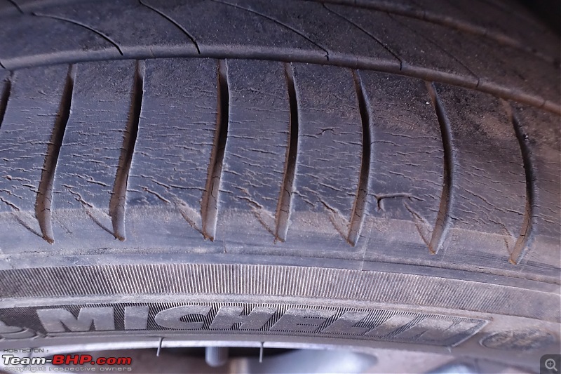

Took the car to the dealer and they removed the older tires and that is when I found that the tires were from 2015 lot. I asked the dealer if he could get at least 2016 manufactured ones, but he said that Michelin will only import further stocks after existing stocks are cleared. I wanted to make sure that getting old stock will not affect performance. I checked with a couple of friends who have good experience with tires and they said there is no problem with 1.5 year old stock if fresher ones are not available. I believe Chethan_BG also had to go with older stocks, but he was satisfied with the performance. So went ahead and changed the tires to 225/50/R16 Michelin Pilot Sport 3 ST. The tires have a slight bulge, as the stock alloys are 6.5j. 7.0j would have been ideal. But as I did not want to spend on alloy upgrade and as there are many fellow Jetta owners who have good experience with 225's on stock alloys, I decided to live with this. Post tire upgrade, I feel significant improvement in grip, cornering and braking. However because of the problem I mentioned about the suspensions, I have not been able to fully enjoy the new tires.
The cracks on the old P3STs. Though the tires had enough tread depth to last another 3K to 4K kilometers, these cracks made them quite dangerous to uuse.
Platinum Grey VW Jetta 2.0 TDI Highline DSG comes home EDIT: Sold!-cracks.jpg

The close-up shot of the P3STs is quite surprising. Unless I am mistaken, the tyre carcass seems show a lot of cracking and hardening / brittleness of the carcass.
I have seen such brittleness in old MRF ZVTs but always thought Michelin was much softer. When were these tyres manufactured?

I've observed the same on Michelin Primacy LC tyres as well, infact my set of LCs developed the same issues in 2016 (tyre was 26th week of 2012 make).Most tyre store owners told me this is to be expected with softer compound tyres after 3 years of usage.

I don't remember the exact week and year of manufacture. But I know for sure that they were less than 6 months old when I had them installed in April 2014. So, that would make it either late 2013 or early 2014 make.

That matches my experience then. These tires were 3 years old. So, I should expect similar behavior from the Pilot Sport 3 ST's as well!

I asked him the same question regarding P3STs and he told me these will not harden or deteriorate like LCs. However, your case shows they're no different!
I sincerely hope the Pilot Sport's are better.
Why don't you forward these pictures to Michelin India out of curiosity?

Actually PS3 is somewhat similar that's why I just bought a new set. It has micro cracks. Mine has run about 40-42k kms though in about two years. In this period I did the rotation on these I think three to four times. Worth every penny though. Not a single puncture to date, leech like grip in dry and even better in rain, yes trust me it's a magical tyre on wet roads. It will surpass many of our expectations from a tyre costing about 12K.
