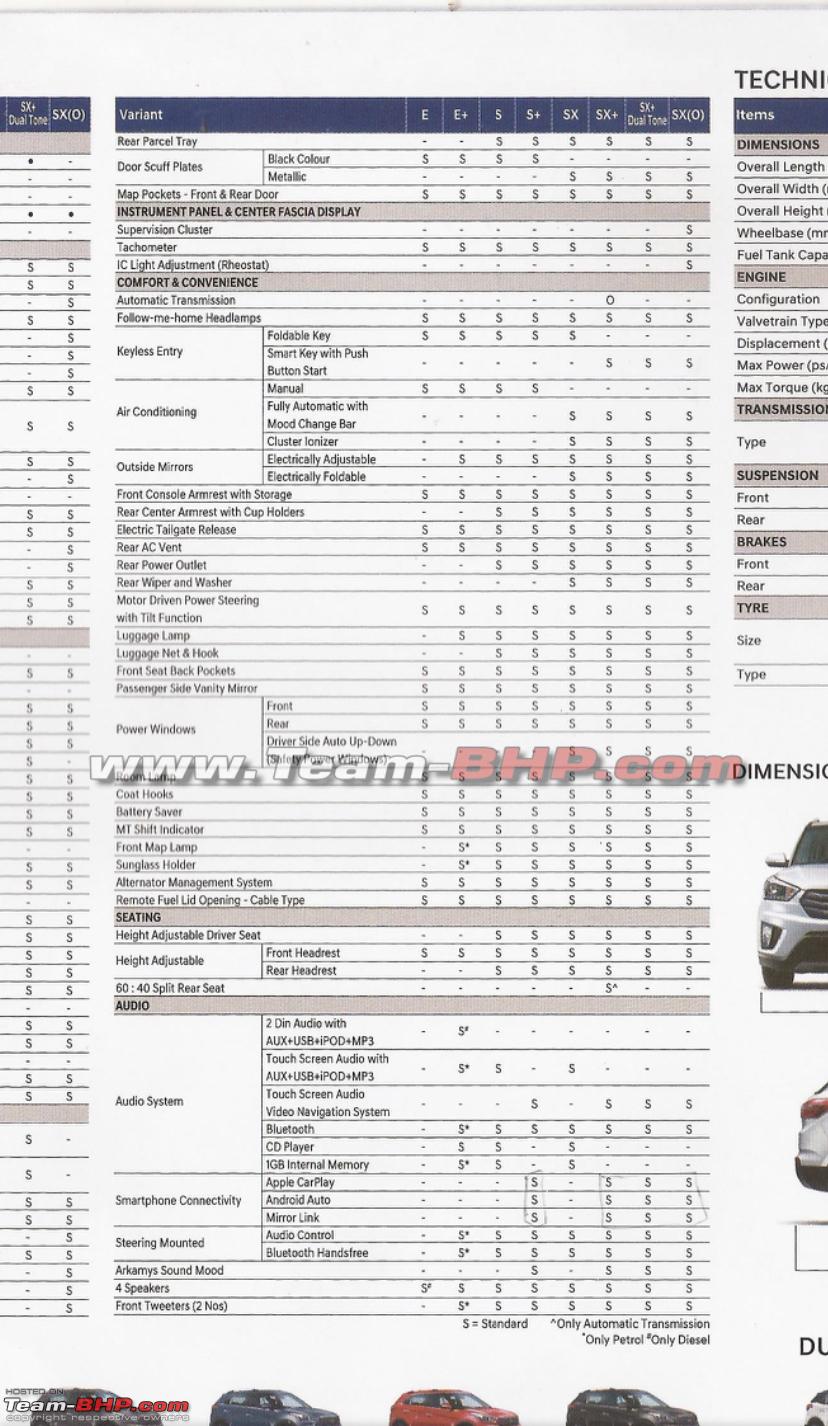

![]() | #2809 |
Senior - BHPian ![]() Join Date: Jun 2020 Location: Mumbai
Posts: 1,987
Thanked: 11,943 Times
It was there from launch itself! Here's the brochure for the 2015 Creta. |
![]() | #2810 | |
BHPian ![]() Join Date: Nov 2019 Location: Goa
Posts: 401
Thanked: 1,047 Times
| ![]() Quote:
![]() I am pretty sure, I had tried this in the past, albeit by keeping ONLY the parking lights in ON position; which eventually used to go off once you open the driver side door. However, I don't quite remember checking out with keeping the HEADLAMPS in the ON position, my bad. After you shared the brochure of the 1st-gen Creta, I did try this out today evening keeping the Headlamps switch in ON position and voila! It worked. The headlamps however, remain on only for mere 15-20 secs, even if you don't lock the car from the remote key. However, you can unlock the car and the lights come up again. I really can't believe how I could I miss such an important feature in my car for all these years. ![]() Anyway, thanks a ton mate! Really appreciate your posts in clarifying this for me. I'm glad I found this feature in my car today. And as they say, it's better late than never. So apt in this scenario. Last edited by ashvek3141 : 2nd September 2020 at 20:48. | |
