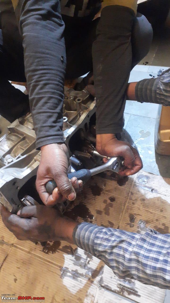

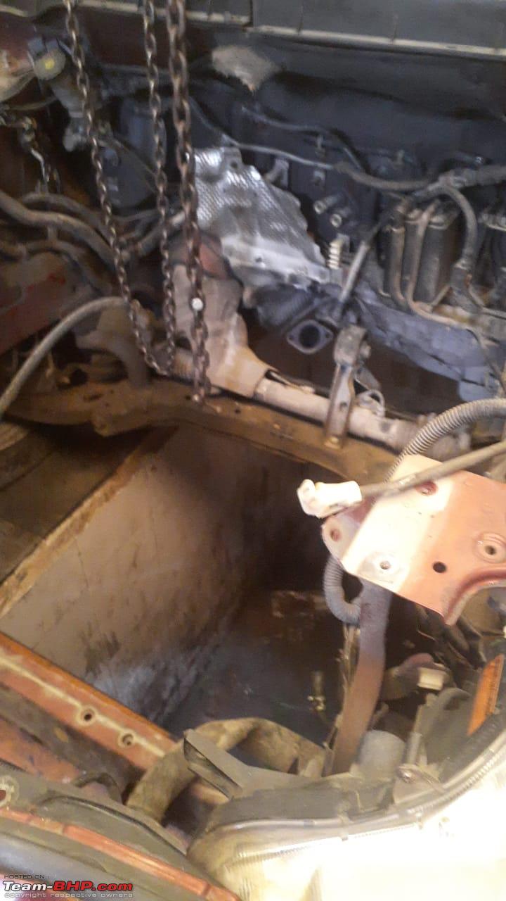

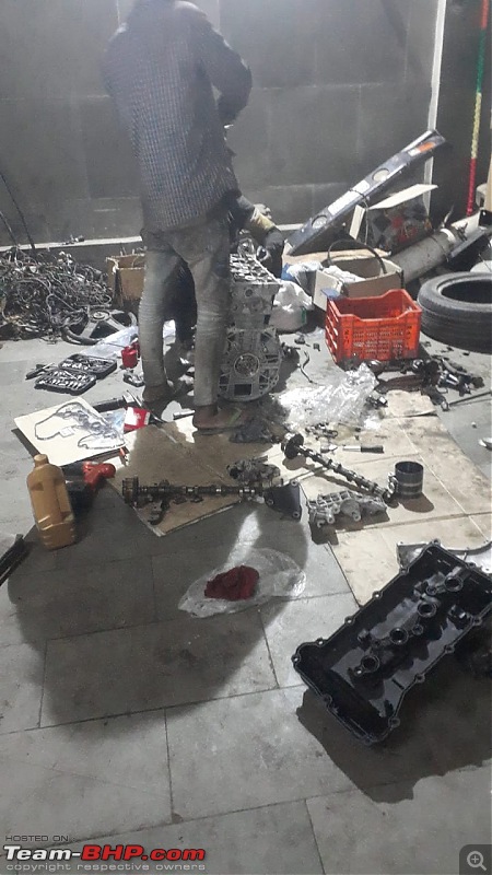

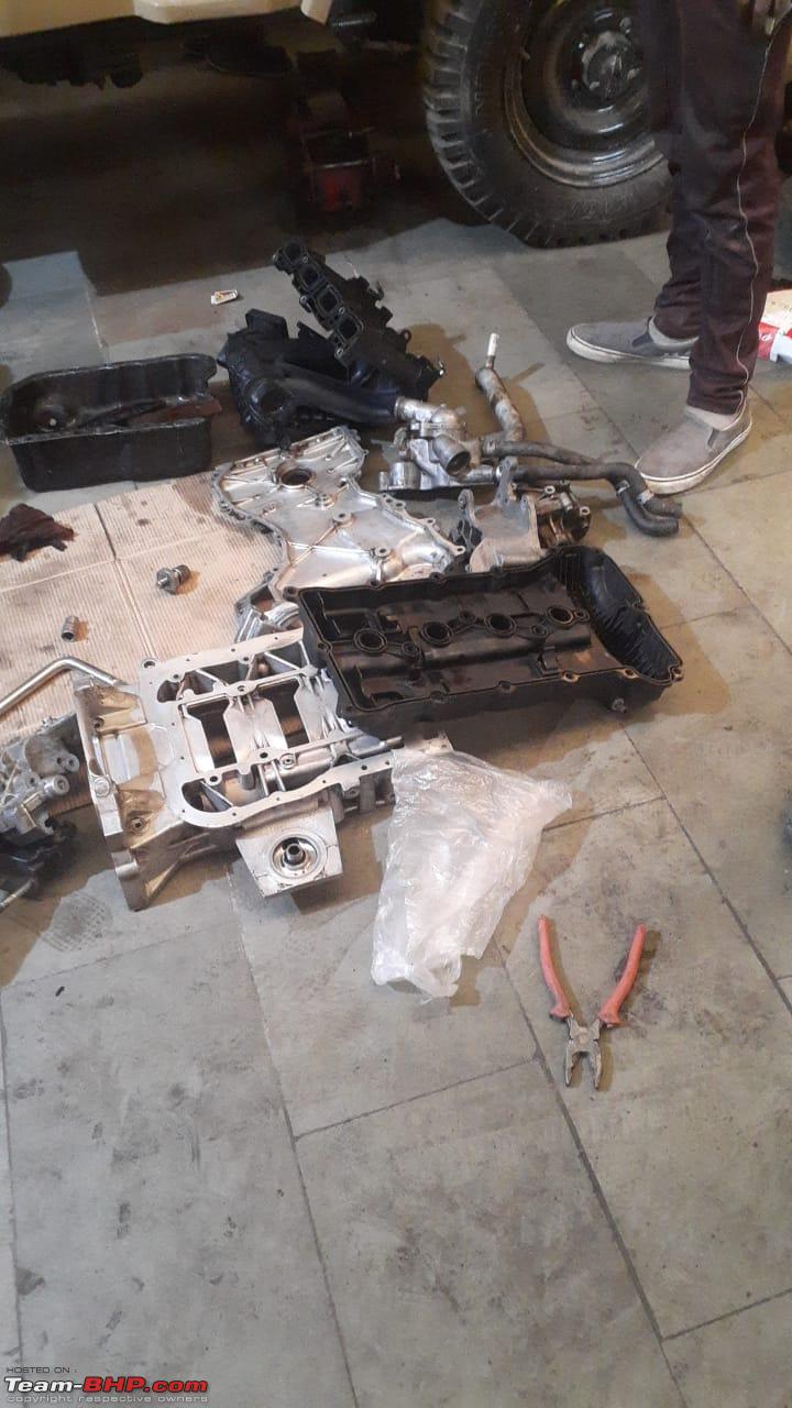

Final diagnosis – oil in the spark plug, coming from engine blow back at higher rpms, needs an engine overhaul. The lead mechanic was confident of doing the overhaul, but parts would be a problem since only once did they open the engine would they get to know what they would need. Then would take the parts to Kashmere gate for replacements.
Now an engine overhaul is a comprehensive process and hence before I took the plunge, wanted a 2nd and a 3rd opinion. Ask the Mitsubishi Service Centre (Faridabad), to have a look at the same. The Outlander has been to their service center once or twice, and hence they are familiar with the car.
Service centre team picked it up and ran a diagnosis. There was engine blowback as they call it due to piston rings and oil seals being worn out. Final diagnosis, engine overhaul. Estimate given was 2.5 times the FNG near my place.
A Tale of Outliers : Buying a used Mitsubishi Outlander & Maruti Grand Vitara-1.whatsapp-image-20220202-9.50.19-am.jpeg Oil in the spark plug
Engine Smoke on Cold Start
Blowback
Now what?
Now I was in a delimma. I had barely used the car since it’s purchase. Unlike the Grand Vitara, this one has run 50% in the same time, owing to the Pandemic. Anyway I looked at it, without repair, this would become a very costly ornament in my garage, good to look at, zero usage value. For repair, I had 2 options – one, put oversized piston rings, get the engine working and sell the car.; two – get the engine rebuilt, use for a couple of years and then sell it.
With my limited running, buying a new car seemed to be an overkill. Pre-owned options in Delhi NCR for AWD/4x4 are limited to petrol due to NGT ban. Buying a 5 year old diesel AWD was as good as buying a new Creta and hard to find. In the limited amount of money, there were almost neglibile contenders for a replacement.
After much though I decided to get the engine overhauled and keep the Outlander for another 2-3 years as per the NGT rule. Now came the question of where to get this done with surety that the workmanship will be good, adequate costs and transperancy of parts used.
Conversations with Mitsubishi did not inspire confidence. They started with very high quotation and then reduced the same by 50% when I wished to walk out with the car. Also, was not very sure on the engagement I would be able to get if I let them do it. There were no gurantees that they offered post engine rebuild.
Overhauled!
Spoke to Ashwani at Goodwill Motors. He has been my go-to guy for Grand Vitara and Outlander also. He was confident of sourcing parts, but said would take time. He gave a slightly lower estimate, also. The main aspect was that I was confident on him – I could pester him for updates, go and have a look at the build, and he has proven technical knowledge & parts sourcing contacts to get this done.
So the decision was made. I picked up the Outlander from Mitsubishi and deposited it to Goodwill Motors at Gurgaon.
Long story short, it took almost 30 days for the rebuild to happen. Parts sourcing was a challenge, plus labour delays. But I was in no hurry as I was more keen to get it done well then get it done fast.
Images of the overhaul:

As good as new?
Post the overhaul, I have driven almost 7000 kilometers. We did an oil change after the 1st 1000 kms. I feel a noticible difference in power and pickup. While the Outlander is no speed rocket, the build of power is slightly better than after the rebuild.
I took this to Chakrata with my family during May’22. There are some steep gradients and lots of twisties on the way and with a full load, AC on all the time, I did not feel any sluggishness or missing. Have kept a sharp eye on the engine temperature, but that has largely been steady.
