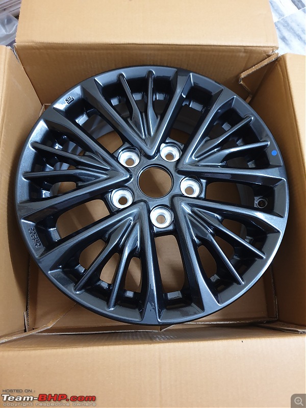

I have also planned to get rid of the steel rim and install an alloy there along with Michelin. I'm a firm believer of old school 5 tyre rotation.
Plan executed!
Had ordered the alloy soon after the delivery. They got the part within a week. However I couldn't go to collect it due to time constraints. Finally that happened last week, and I installed the spare tyre today.

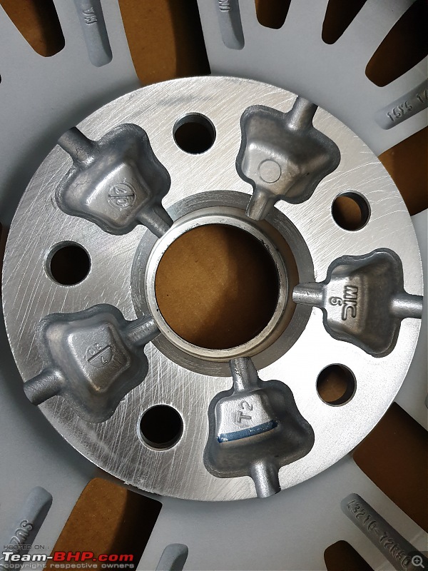

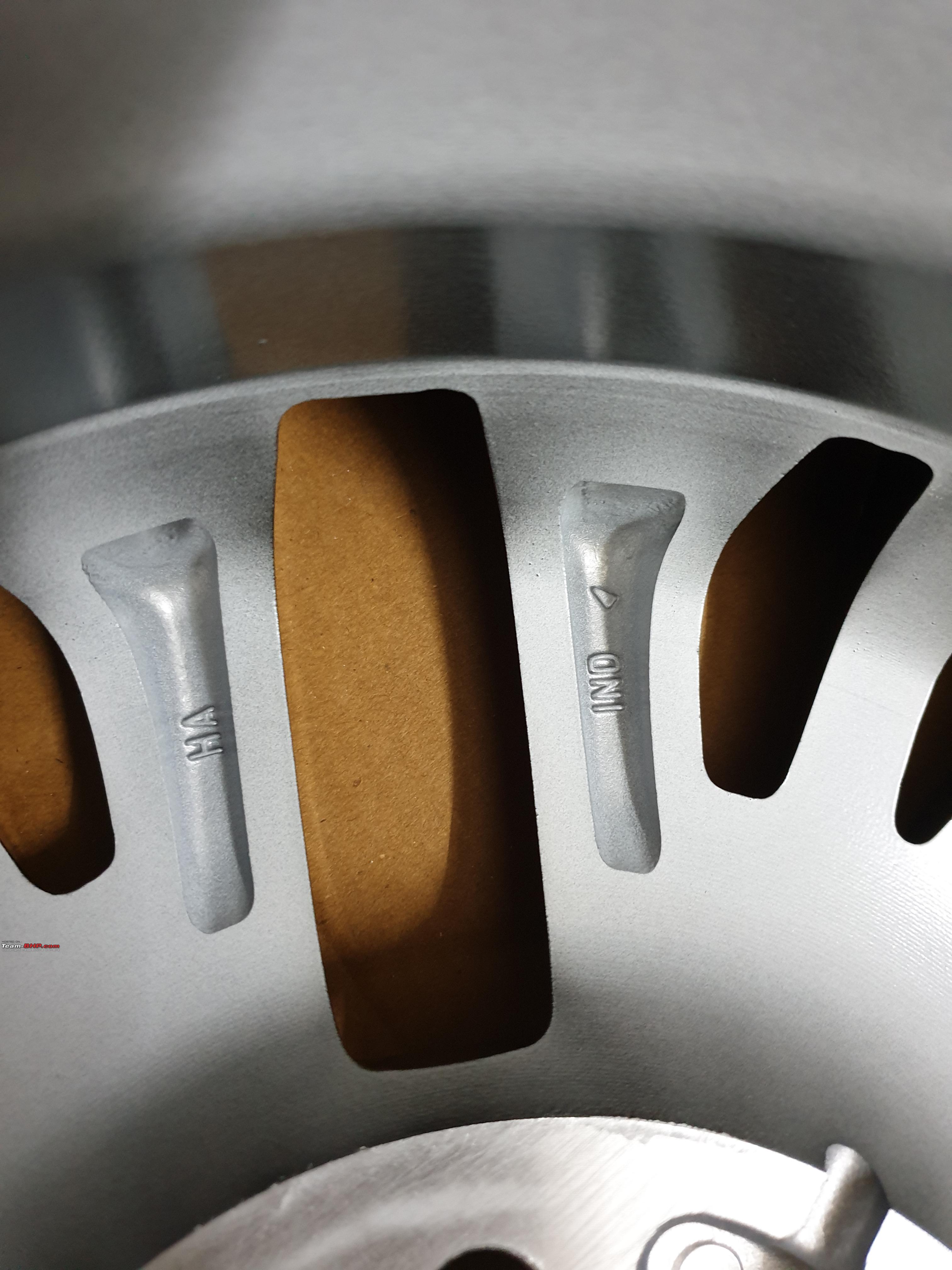

Closeup Pics: Can anyone tell me the manufacturer for this alloy?
My first car: 2020 Maruti Suzuki XL6 Alpha MT Review-4.jpg
My first car: 2020 Maruti Suzuki XL6 Alpha MT Review-5.jpg
My first car: 2020 Maruti Suzuki XL6 Alpha MT Review-6.jpg
My first car: 2020 Maruti Suzuki XL6 Alpha MT Review-7.jpg
My first car: 2020 Maruti Suzuki XL6 Alpha MT Review-8.jpg

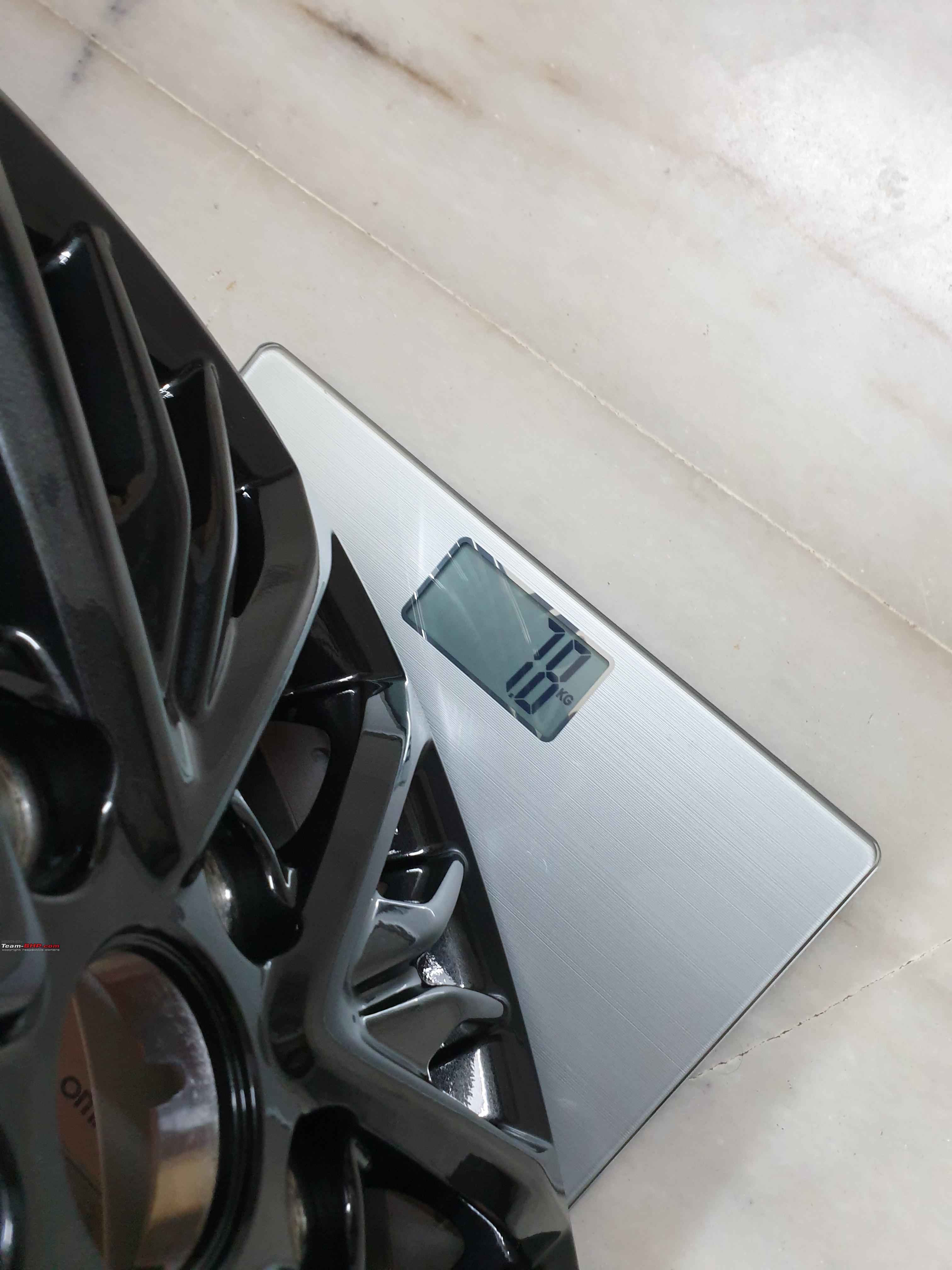

Weight of only alloy:
My first car: 2020 Maruti Suzuki XL6 Alpha MT Review-9.jpg
My first car: 2020 Maruti Suzuki XL6 Alpha MT Review-11.jpg

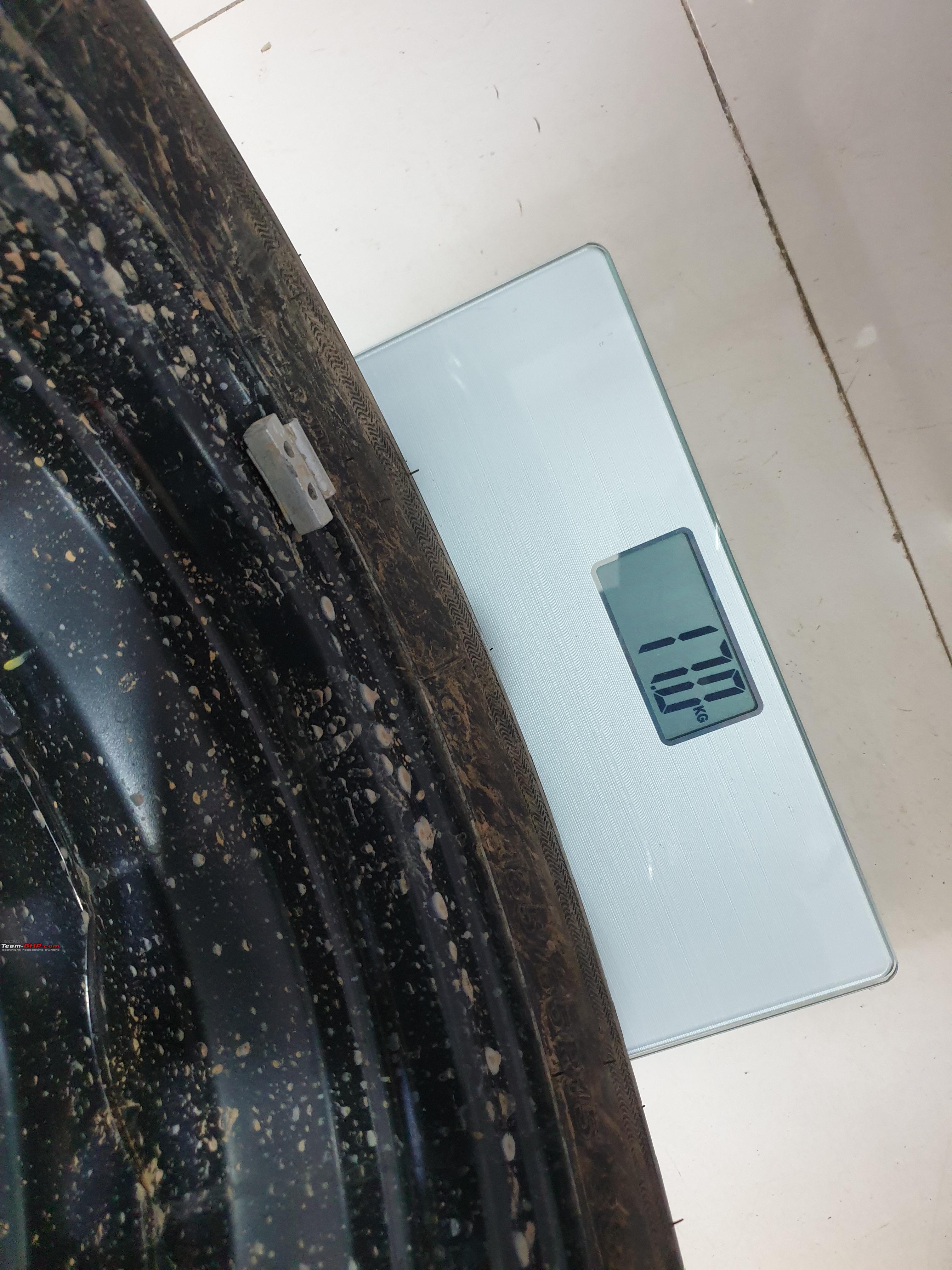

Weight of the stock spare wheel, steel rim plus Bridgestone Ecopias
My first car: 2020 Maruti Suzuki XL6 Alpha MT Review-12.jpg
Weight of the spare wheel with Alloy and upsized Michelins:
My first car: 2020 Maruti Suzuki XL6 Alpha MT Review-13.jpg

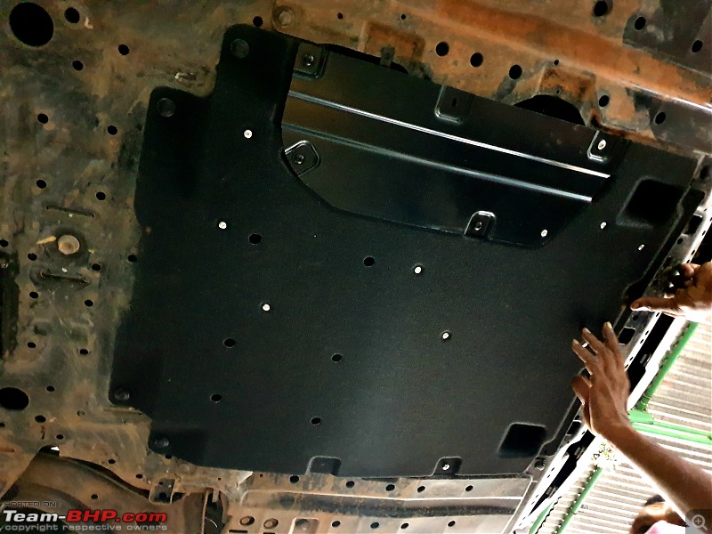

Guys, did a mod about which I am super happy and proud at the same time. The best part: No one in his/her senses would endorse this idea. But I had a theory and a belief, took a bit of risk and it all paid well. I'm feeling great because a company like MSIL with crores of resources, which is famous for sharing parts, didn't implement this. Well, MSIL can keep sharing the PW console, I'll think of something more useful!
Introduction: In all Maruti Official Reviews today, there is one statement which is common by our forum's reviewers.
Swift and Dzire's Review:
Shockingly, no underbody protection at all! Not even a plastic cover below the engine. Couple that with the unladen ground clearance of just 163 mm, and it does get concerning

Problem: The gaping space in the engine bay was an eyesore, and a potential hazard as well. One stone kicked from tyres and the filter and other aluminium components were at grave risk! My brain had started to work on it when my XL6 wasn't even manufactured! I had posted about this in the Dzire review.
My first car: 2020 Maruti Suzuki XL6 Alpha MT Review-2019marutixl603.jpg
The Silver lining: During my regular browsing, I found out that the New Dzire with Dualjet engine comes with a plastic engine guard, and two small covers below front footwell. Pics I took during my XL6's PDI:
My first car: 2020 Maruti Suzuki XL6 Alpha MT Review-img20200729wa0022.jpg
My first car: 2020 Maruti Suzuki XL6 Alpha MT Review-img20200729wa0023.jpg
A Screengrab from one of the Youtube Videos(notice how the heatshield lines up with the Dzire's Catcon and exhaust line):
My first car: 2020 Maruti Suzuki XL6 Alpha MT Review-capture.jpg
My theory: The platform is same. So the parts will vary in dimensions at the most. Still some holes will match at some point. I was anyways ready to make holes in the new engine guard if needed.
I ordered the parts via my old MASS. The owner said that if it doesn't fit, they can still be used in the New Dzire. So that was some assurance. I gave them the part numbers and they gladly placed an order. The parts arrived in about a week.
Engine Guard:
My first car: 2020 Maruti Suzuki XL6 Alpha MT Review-1.jpg
Floor Covers:
My first car: 2020 Maruti Suzuki XL6 Alpha MT Review-2.jpg
My first car: 2020 Maruti Suzuki XL6 Alpha MT Review-3.jpg
XL6 is looking majestic:

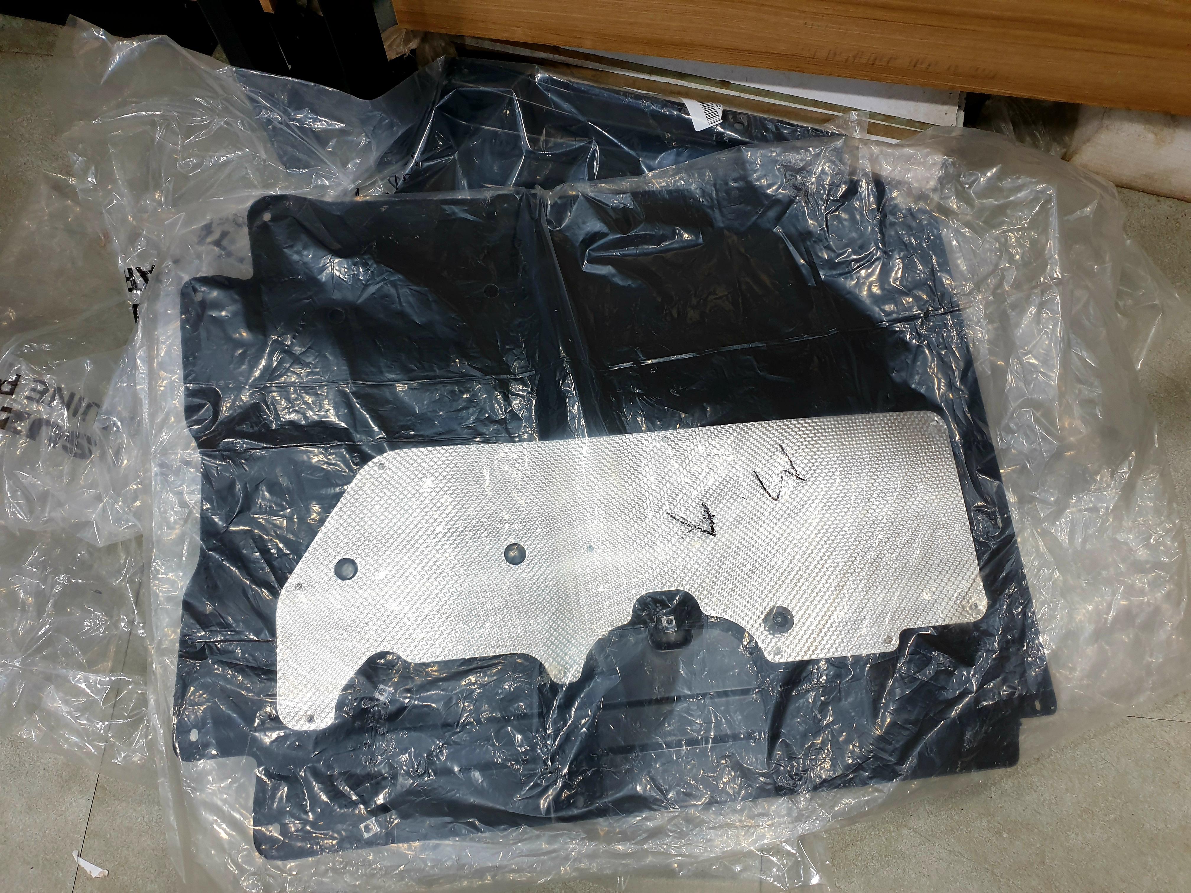

Trial fit using Screws and nuts:
Remember the "Number style" nuts which are there on our Bumpers? Well I used a smaller version of it. Part Number: 39461M73M00
The surprise: All Holes matched with the XL6's stock holes. That further boosted my confidence. However one shortcoming happened, and I had to resort to a minor Jugaad for the same. In Dzire, I think the front part of the engine guard goes under some other trim. In my car, there was a minor 2 cm gap even after the front clips were installed. Any kind of wind/water blast can cause the clips and screws to fail. They are all held together by plastics. To solve that, I used 4 screws with oversized washers, so that when screws go all the way in, the washers hold the plate from front and makes it snug from front. Apart from this jugaad, it was entirely plug and play.
Before I forget, another issue happened in my car. The left front apron cover had a minor tear right at the point where clip/screw had to go. So only at near point I had to drill another new hole in the plastic cover. This issue won't happen in your cars if the covers aren't torn.
Red Circles: Matching with stock holes on suspension subframe, used fender lining clips.
Green Circles: Used nut, washer and screw here on matching holes. Here you can use fender lining clips too.
Yellow Circles: Jugaad with washers holding down the front.
Violet Circle: Where I had to drill the only hole, due to torn stock hole in my existing part.
How the engine bay looks now(note, even here the stock heatshield has neatly matched):
My first car: 2020 Maruti Suzuki XL6 Alpha MT Review-10.jpg
View from Below(here you can understand what will happen if those four front washers don't hold the cover)
Doubts people may have:
1. Engine cooling: Enough gaps are still there for circulation.
2. Which material is this: This plastic lined with felt, and heatshield at some places.
3. Will I need to remove the cover for each oil change? No! The cover has a shiny openable cover if you see.
4. Which cars will it fit?
Direct fit: Swift, Dzire, May be the Baleno also.
Similar fit as mine: Ertiga XL6.
S Presso, WagonR and Ignis won't be able to fit this, probably, since they miss the side flank covers(notice the pics)
5. Will it make our cars invincible? No! A large boulder will still cause damage. It's only protection against small flying debris. Trust me, I have seen enough cases where gearbox/oil filters have been punctured by projectiles.
6. How much have I tested: Have driven for more than 1000 kms at high speeds and in heavy showers with large puddle formations on road. Happy to report that the cover is absolutely stable and hasn't moved even a millimeter.
7. What happened to the floor covers: They won't fit the underbody of the XL6/Ertiga. It will fit Swift and Dzire, while Baleno and other owners may check.
