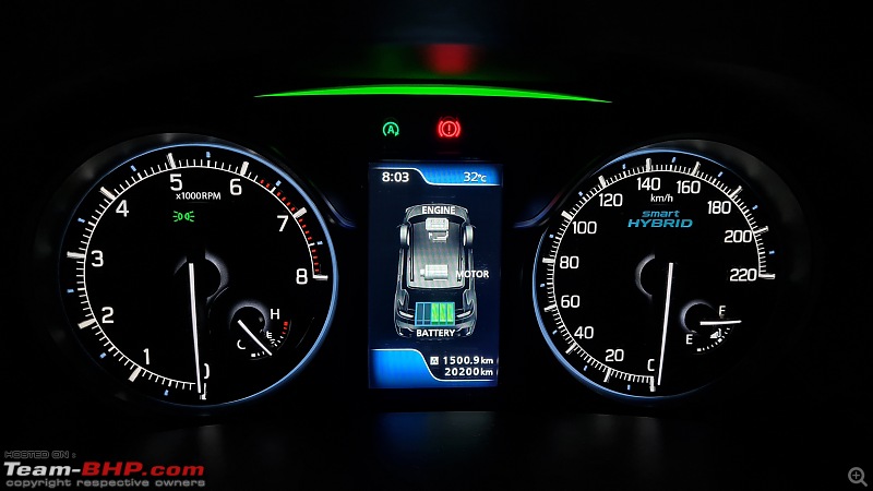

Current Odo reading:
My first car: 2020 Maruti Suzuki XL6 Alpha MT Review-20220402_200427.jpg

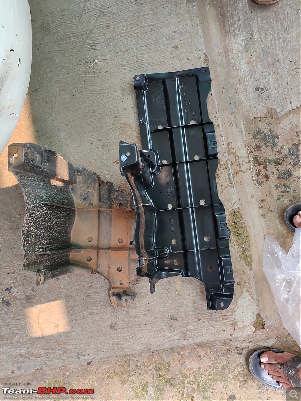

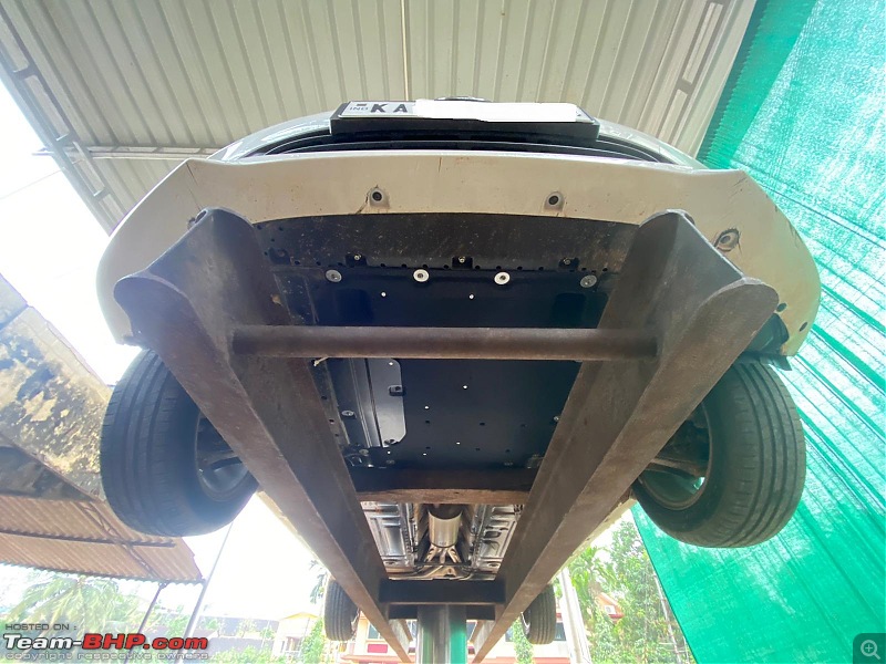

So I got the underbody cover fitted on the Glanza yesterday and it was as expected to see it be a direct fit. Huge thanks to Leoshashi for the post. I used Screws with washers all round and the number plate style clips which Shashi mentioned in his OP. Fixed new fender lining and new side flank cover on the left side. the right side flank cover was missing a part so temporarily used a cable tie to secure the underbody cover till the new part arrives.
Attaching some pictures of the same.
My first car: 2020 Maruti Suzuki XL6 Alpha MT Review-img_20220402_174505.jpg
My first car: 2020 Maruti Suzuki XL6 Alpha MT Review-img20220402wa0026.jpg
My first car: 2020 Maruti Suzuki XL6 Alpha MT Review-img20220402wa0027.jpg
Have a look at how much of the side flank cover had the dogs eaten. Gosh!
Old Vs New
My first car: 2020 Maruti Suzuki XL6 Alpha MT Review-img_20220402_164401.jpg

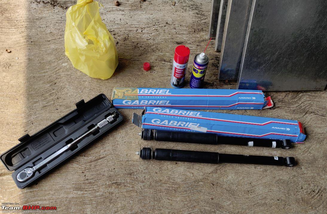

Taking advantage of the recent boodmo sale, I immediately ordered rear shockers while keeping Shashi in loop.
The new shocks were of Gabriel make. January 2022 manufactured.
My first car: 2020 Maruti Suzuki XL6 Alpha MT Review-new-shockers.jpeg
I planned to do the replacement as DIY at home with the help of my dad as we have all the required tools or so we thought ( more on that later).
My first car: 2020 Maruti Suzuki XL6 Alpha MT Review-tools.jpg

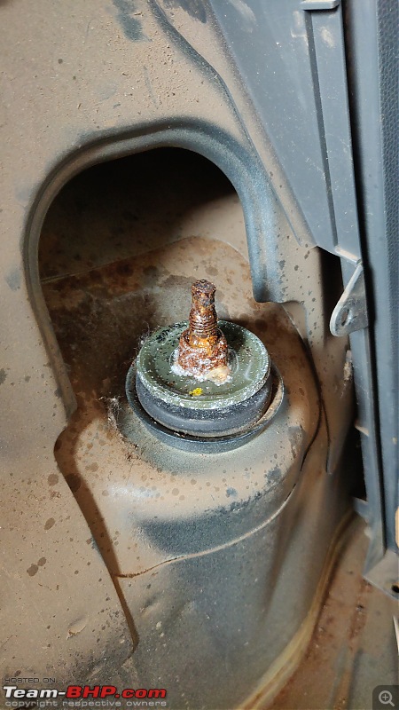

So yesterday we lifted the car at home, unscrewed the bottom nut of the shocker and proceeded to remove the upper one and BOOM, here comes the surprise.
Left shocker Upper Bolt
My first car: 2020 Maruti Suzuki XL6 Alpha MT Review-left-shocker.jpeg
Right shocker Upper bolt
My first car: 2020 Maruti Suzuki XL6 Alpha MT Review-right-shocker.jpeg
These are definitely the stock rear shockers which came with the car 15 years ago (2006). The nuts are basically seized, we hammered and did whatever we could but the nut would not even budge. Sprayed WD40 and left it to soak but still no luck. Yes it was that bad. At this point , we thought the only thing left is to remove it with heat. I did not want to follow this method as it would lead to further rusting around the surrounding area in the future.
Dad being the expert he is , told me to find a angle grinder to cut the bolt off. We did not have an angle grinder and It being a sunday, no workshops were open. Luckily for us , our neighbour is a carpenter , he had an angle grinder with him and we were so relieved when he gave us a confirmation.
So I started covering all the surrounding areas with wet rags and dad started to cut off the nut.
