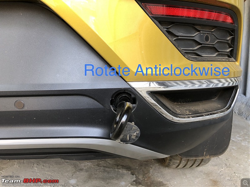

They also replaced the tow hook, which was not fitting into the groove.
Need to check it before 2nd service.

Originally Posted by tristis2008 (Post 4938618)
I suggest that you check if the tow hook fits into the slot or not. May it's already replaced in your tool kit. Better check at the rear one to avoid any accidental paint damage to the front one.
As per your suggestion, I checked the fitment of the tow hook at the rear end.
Fitment is okay

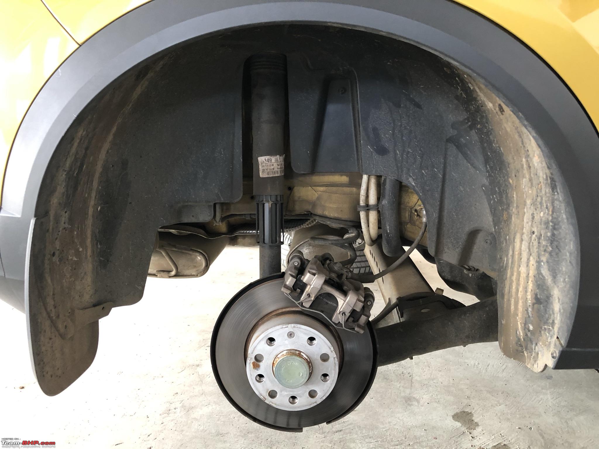

Car is making a very weird noise while reversing the car with brake pedal pressed gently.
https://www.youtube.com/watch?v=KnwU0QEJ4bk
Noise is more prone in the morning when I am taking the car out of the garage. I have read this issue on T Roc UK forum(VW described it as a cow 'mooing' https://www.trocforums.co.uk/viewtopic.php?t=299). It is a design flaw and changing the brake-pad and disc is the only solution to this problem. SA cleaned all the brake pads. I was shocked to see rust in many parts. I asked them to apply any rust remover solvent to remove the rust. SA could not find any solution and I refused to clean the rusty part with emery paper as the part is coated with some plating.

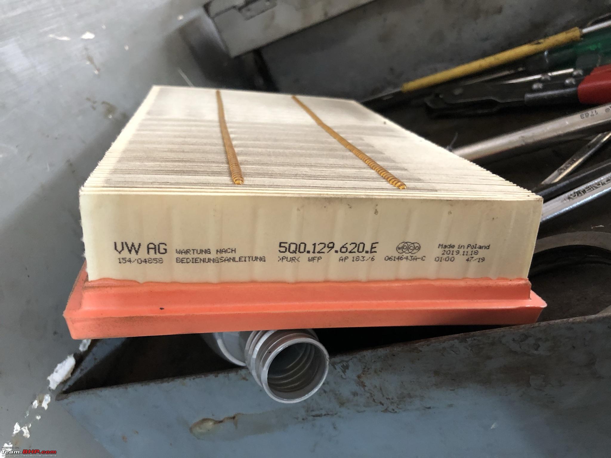

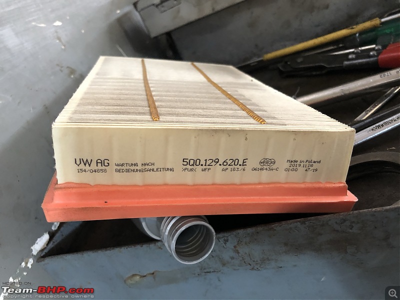

The air filter was cleaned.
Volkswagen T-Roc : Ownership Review-img_8480.jpeg
Volkswagen T-Roc : Ownership Review-img_8481.jpeg

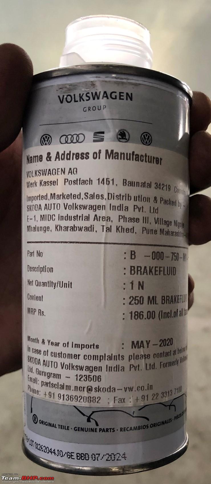

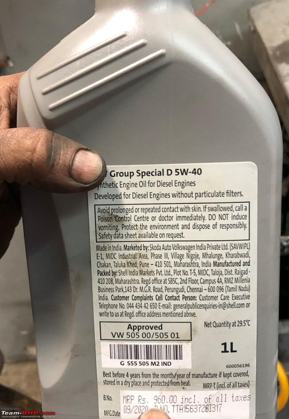

Brake fluid was filled.
Volkswagen T-Roc : Ownership Review-img_8508.jpeg
Engine oil SAE 5W 40 was filled. I don't know why diesel is written on it.
Volkswagen T-Roc : Ownership Review-img_8509.jpeg
Volkswagen T-Roc : Ownership Review-img_8510.jpeg

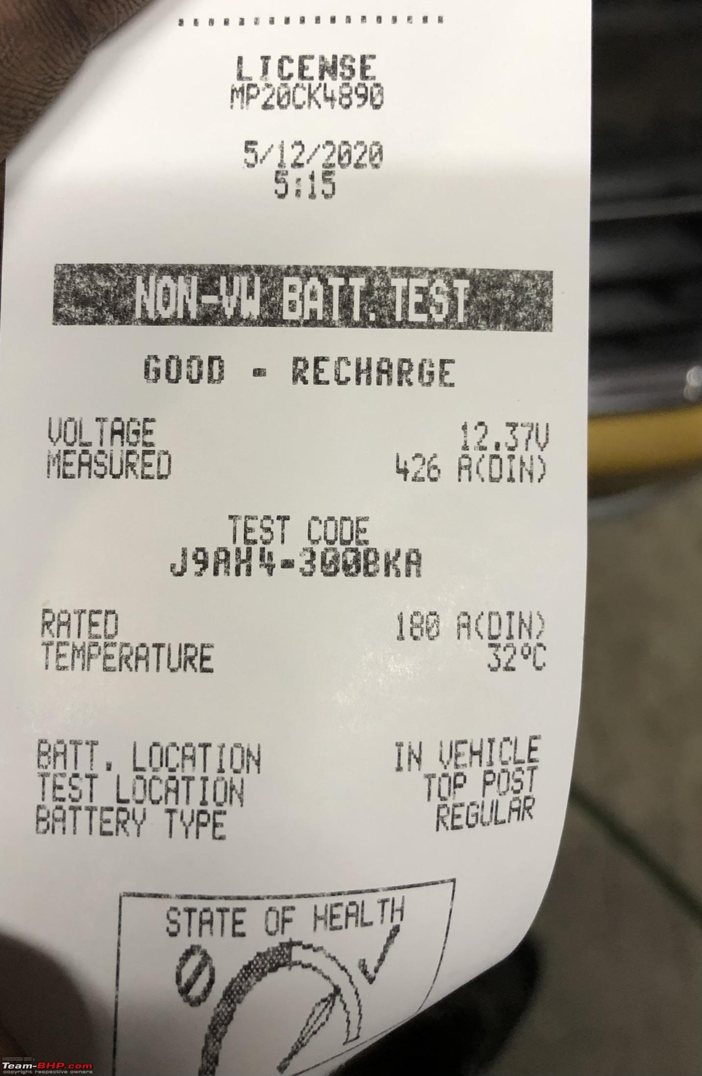

SA used VAS 6161 device to check battery health (Test Code J9AH4-300BKA )
Results
Battery Health >>> Good Recharge
Volatge >>>>>>>> 12.37 V
Measured>>>>>>> 426 A(DIN)
Rated >>>>>>>>>> 180 A(DIN)
Temperature >>>>> 32 degree celcius

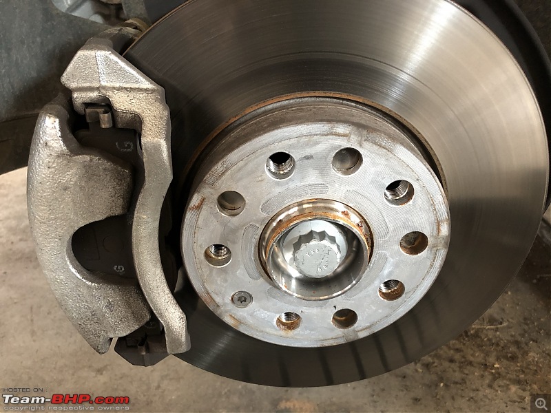

1. Brittleness in Rubber parts:
The cars were out in the sun during the entire summer in India. It is likely that the rubber parts have become brittle.
In my case, the front wipers were making noise and were replaced after checking. The rear one seemed okay then. I checked the beading of windows and sunroof as well which seemed to be okay. Given your experience, I checked the four tyres for any cracks. To my dismay, the front tyre on co-driver side has chipped off at two places. Not sure if it is due to brittleness.
2. Draining key batteries:
When I got the keys at the time of delivery, I expected that the spare one is protected from draining with an insulator tucked between the battery contacts. That was the case with Vento's keys when I had bought back then, but not in case of T-Roc. If I assume, that was the case with you and others as well, the batteries were slowly draining anyway during this entire period and also the fact that it has kessy, it will drain more than other fobs.
3. Noise:
Regarding the noise while reversing, are you getting noise similar to the youtube video you have shared ? While manoeuvring the car for reversing, I do get noise while braking as well as turning the steering. While turning the noise seems to come from some metallic parts. I do need to get this inspected. Thanks for this reminder ! I believe the auto hold was disabled in your case, otherwise the noise is much more when it disengages the brakes automatically on acceleration.

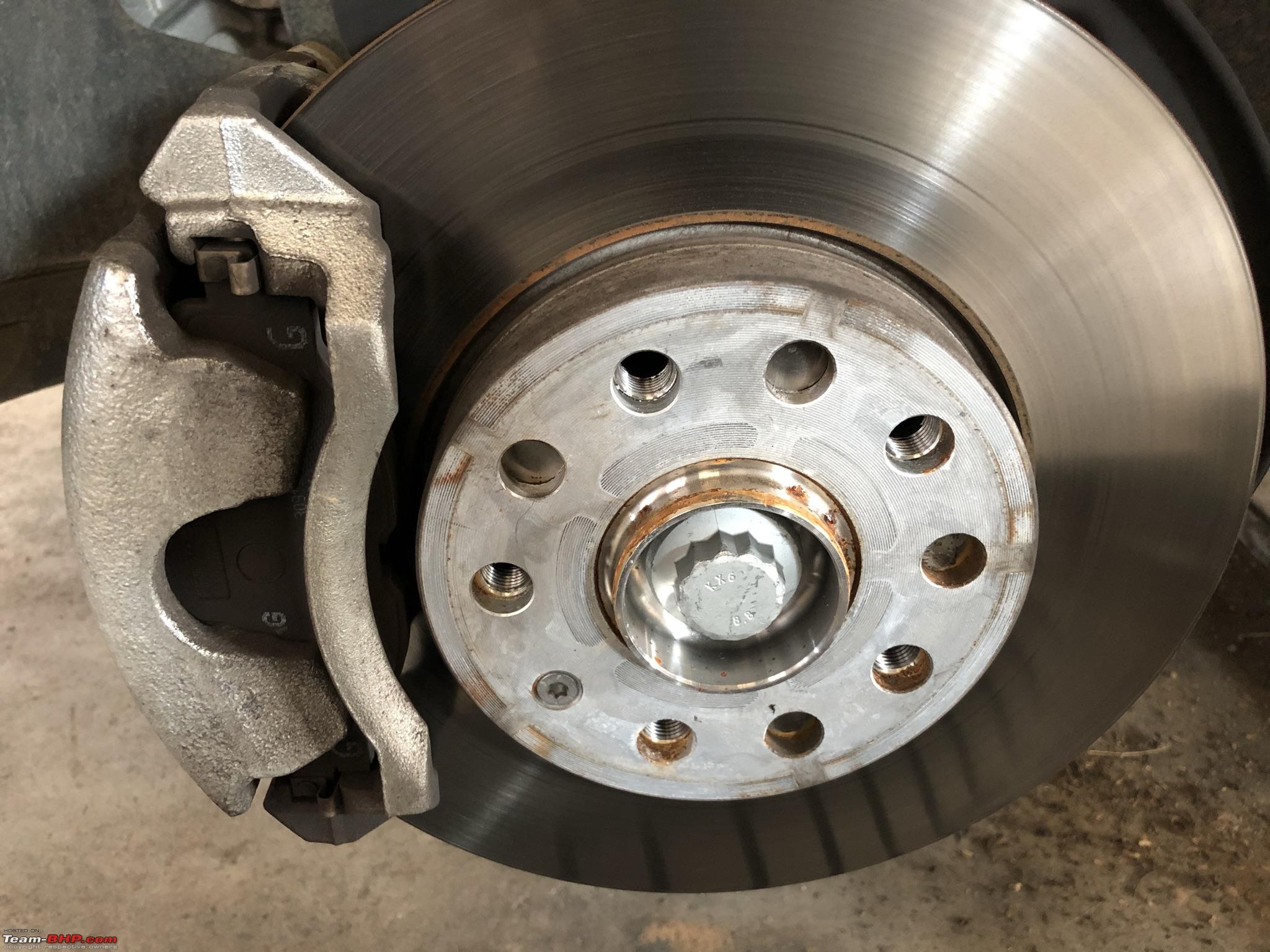

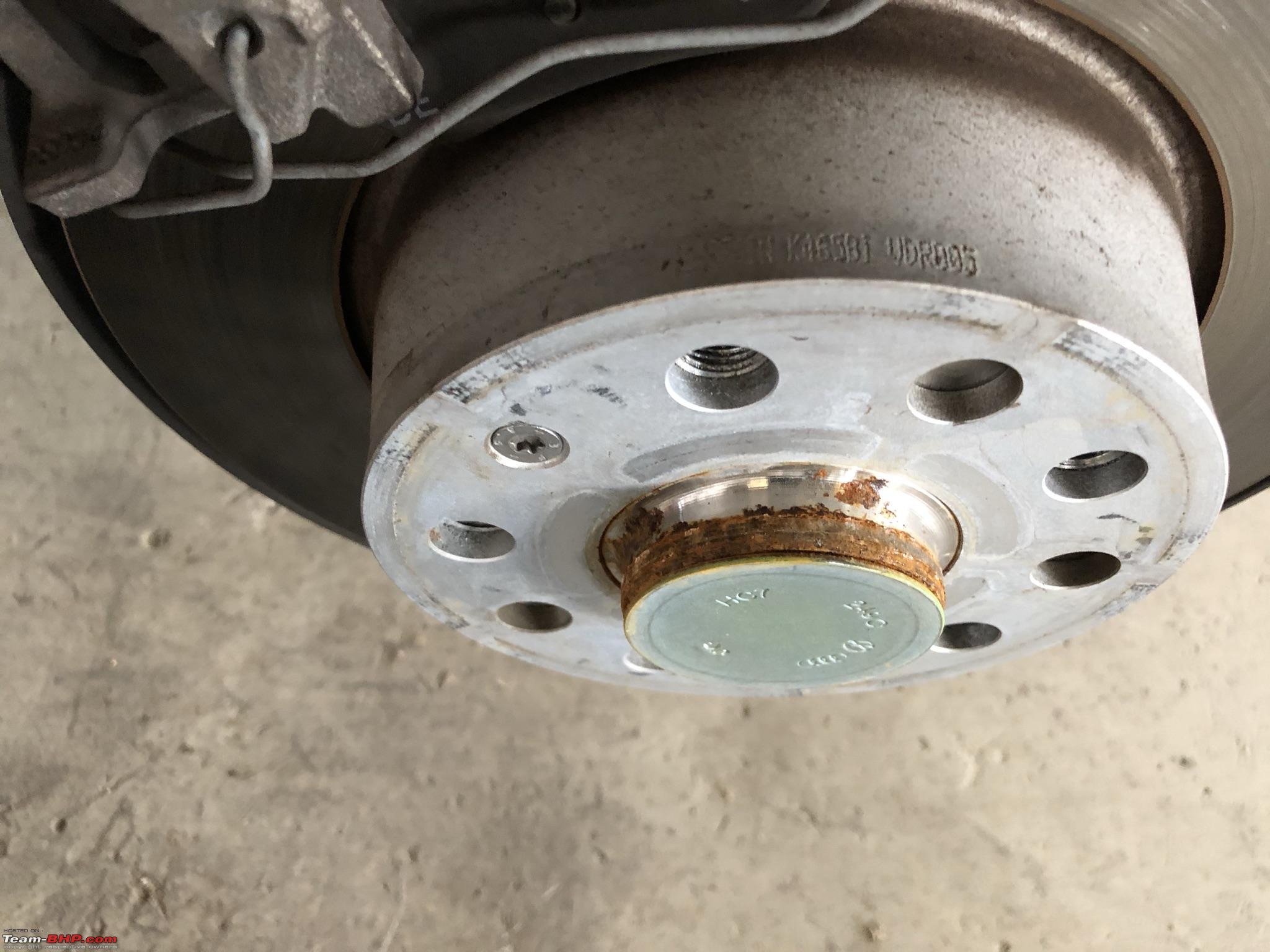

4. The rust:
The rust in the wheels seems to be due to the long journey they took via sea to reach India and possible exposure to saline environment. I will open up the wheels and check.
I wonder if T-Roc will set an example of what happens to a car if out in sun and unused for months together.
By the way the tyres are ContiEcoContact.
Volkswagen T-Roc : Ownership Review-screenshot-20210101-14.42.24.png
Name:  Screenshot 20210101 at 14.44.24.png
Originally Posted by tristis2008 (Post 4967545)
I congratulate you on completing 7500 kms.
Thank you so much Tristis2008
3. Noise:
Yes, the noise is similar to the youtube video and sometimes it is even louder.
This noise comes from rear brakes. Noise can be avoided while reversing if brakes are applied firmly so that there is no slippage between pad and disc i.e if car is moving back and brake pedal is pressed gently then noise can be heard. I usually get this noise in the morning.
Yesterday I took the car out from the garage at around 9:00 pm and it was making a very loud sound (the car was in the garage for more than 30 hours). I drove it for around 60-70 KM and parked it outside in open around 12:30 AM. There was no noise in the morning when the car was reversed.
So, It usually makes sound when car brakes are cold for a long time( may be more than 10-12 hours )
I have read about this issue on T ROC UK forum and was very happy that this issue is resolved by VW in Indian T Roc but one fine day I was reversing the car in office and heard some noise from the rear. I think noise started coming after 1 to 1.5 months from date of delivery or 3000 -3500 KM ODO reading.

Completed 7500 km on ODO on 28 Nov 2020.
I reached VW Jabalpur workshop by 12:30 pm on 5th December for 2nd free service.
Attachment 2099668
As mentioned by fluidicjoy, Engine oil for T Roc should be 0W 20. I have confirmed the same with Jabalpur Dealer. Please contact your dealer so that this oil is available with them during 2nd service if top-up is required. I got luck as only 0.5-0.6 l oil was filled.
Originally Posted by fluidicjoy (Post 4967930)
Thanks for sharing the Oil Change experience, but for the Polo and Vento TSI, VW 502 is the base spec and VW Special G (Gasoline) is the appropriate oil. Could you cross-check the Engine Code of your T-Roc for me? I believe the Engine found on the Indian T-Roc which I checked was DPCA. I hate to break this news, but as per Volkswagen's Official Repair manual, the most appropriate Oil Spec is VW 508, which is a 0W20 oil, which I had earlier read about from Prithwi Ray, when he was servicing his VRS and the dealership had no stock of this new 0W20 viscosity oil.
Attachment 2101520
On the flip side, the second page mentions that you are fine with using older VW Compliant Oils, but you'd not enjoy the same efficiency and emission compliance.
Attachment 2101519
T Roc Owner Manual says"To avoid damaging the engine, a maximum quantity of 0.5 litres of the following engine oil may be used until next oil change"
Volkswagen T-Roc : Ownership Review-engine-oil-spec-t-roc-online-mnual-2020.png
Once again thanks to Fluidicjoy for breaking this news.
I request others to please confirm the same with their dealer.
Regards
Sagwal
