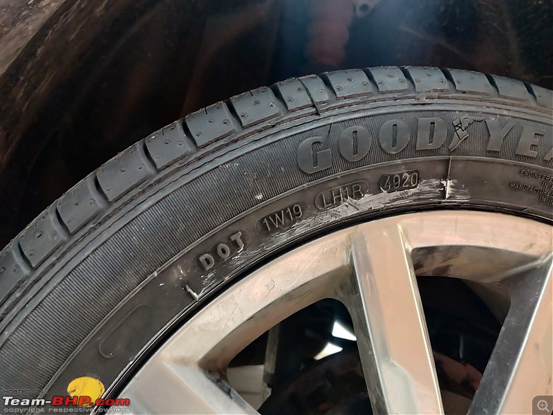

Unfortunate Tyre Burst
I was recording a few road driving shots on this car on a nearby isolated road and had roped in a friend for help. After a good initial shoot with some amazing shots, my car met with a slight accident and we missed a sharp crevice near the divider and lost our Rear Right tyre.
Since I was on the road, I immediately saw the incident and asked my friend to pull-over who thought he went over a moderate sized rock. We had unfortunately pricked the sidewall and the tyre was losing air fairly rapidly. The car was on a 20 degree incline, and using a jack to replace the wheel did not seem like a good option. I assessed the tyre leakage rate, and we decided to drive 300 metres to my trusted tyre guy, who exclusively deals with punctures and also has a nitrogen air filling machine.
Review: Driving home our Sunset Red VW Polo Highline+ TSI Automatic-tyre-puncture.jpg
From the moment I saw the tyre hit the cement obstacle, I knew the tyre was done for and would need to be replaced, and the tyre guy just confirmed this again. He temporarily patched this for Rs. 200 and said we could manage for a while around town. We fixed the puncture and drove home, and my friend was really upset because of this instance. I assured him saying it was an accident, and the good part was nobody was hurt and the vehicle was fine too. We started searching for tyres but finding a Goodyear TripleMax Assurance 195/55/R16 suddenly seemed like a challenge.
I called Volkswagen first to take a quote and was quoted Rs. 7300 for a single tyre + additional labour charges for tyre fitting. I had meanwhile also reached a trusted tyre guy, Lokmanya Tyres, Karve Road who said stock was an issue, but found me the same tyre, albeit in a slightly better speed rating at Rs. 5900, and the choice was clear.
Review: Driving home our Sunset Red VW Polo Highline+ TSI Automatic-new-tyre-code.jpg
In about an hour after the instance, the car was back on its feet, thanks to Lokmanya Tyres, and their prompt team. What is also worth mentioning that buying the same Goodyear Tyre outside, gave me a 2 Year Pro-Rated Unconditional Warranty, something which the OEM could have done as well. Shame on Volkswagen for such practices. I wouldn't have been this grumpy had they retailed the Goodyear tyre for lower.

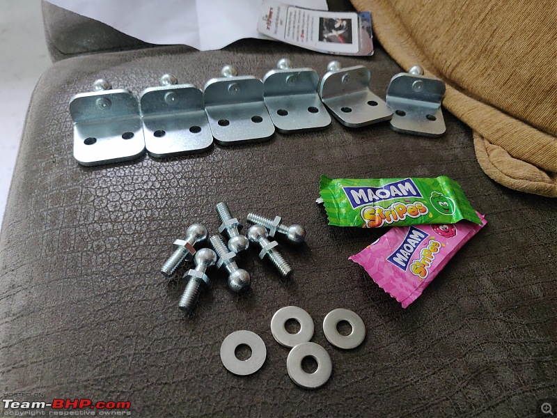

Bonnet Strut
I’ve always wanted a Hood Strut and it’s been installed on numerous Polos and Vento on this forum. But most of the implementations I recall were using two struts to support the bonnet. I found references to a near OEM implementation, courtesy Ciclo and a few Europeans, and wanted to tread along that path. I ordered the supporting hardware from Ebay and was excited to try this out. Also, contrary to popular belief, quite a lot of vehicles do come with just one hydraulic, gas-oil hybrid strut to support the bonnet weight, and this just shows that a well designed strut can also do its job alone, and needn't always be in a pair, provided its the right spec. Our Tiguan and Jetta MK5 is a testament to this fact.
I ordered 1J0823359D and this strut was documented to have a near OE functionality. It has enough force to safely support the hood and the bonnet angle is now a tad more than the stock mechanical bonnet holder. And it is also magically just right for dropping the bonnet down from a small height (the right way to do it as per the Polo manual). The retrofit was not without its challenges since the Ebay Bracket holes did not match the holes on the Polo Bonnet Hinge. So we had to drill it and file it. A friend of mine and I took turns to drill through the plate at The Mechanix Automotive.
Review: Driving home our Sunset Red VW Polo Highline+ TSI Automatic-hood-strut-bracket-drilling.jpg
I also thought it’d be a nice idea to coat the brackets and bolts to a near sunset red finish for consistency. I’m no expert with paints, but I found a fairly close spray paint shade on Amazon and tried it out, and the result turned out pretty good I think. I only wish I’d have suspended the workpieces from a small thread to prevent them from sticking to the cardboard I used to spray them on.
It was a joy to see everything work perfectly and this has been a boon when I need to work or check on things under the hood. The folks at the dealership were also amused to see this add-on and they made it a point to try it a few times each including a few side-way torsions on the bonnet to see if the strut would damage the alignment, but even they gave it the clean chit.
Some FAQs since I have already received a few skeptical queries
1. Will it bend the fender?
A) If you use a washer below the Fender ball stud, then no, there shouldn't be a burden on the fender.
2. Will it disturb my bonnet alignment since other kits have used two?
A) No, the force is just adequate to properly support and also let the bonnet drop down on its own weight. The problem usually arises if the bonnet is freed from the hinges to begin with, and it also depends on the strut and associated forces being used.
3. Difference in Chinese and Two Strut Kits?
A) Chinese strut kits are priced nearly half of the OE strut kit. They have different brackets and accordingly different struts. Kits from China use an entirely different bracket which sits on both of the bonnet bolts and the force is such which might dictate the need for two struts. From what I’ve seen from my friends, such pair of struts do not give the convenience of a drop close.
4. How much have I tested this?
A) I have been using this from the last few months, and I open the bonnet at least 2-3 times a day, for a minimum of 4 days of the week for some work, or checking vitals since I’m paranoid about my work sometimes. So I can safely say the bonnet strut has felt perfect without disturbing anything on the car.
5. Can I use two such struts?
A) Probably not a good idea, since it was tested and determined to work best solo. Using two might not give the result of drop close and soft open, because of excess force.
6. Will it work on Vento, Rapid, Ameo?
A) I have installed it on a Vento and an Ameo, but the same strut and mounting kit did not fit the Skoda Rapid since the fender is designed differently. We tried, and it wouldn't fit, and also ended up disturbing the bonnet alignment when we tried a few other mounting spots.
If you wish to assemble a similar kit, here are the links of products I used. I would have fabricated and arranged the first two objects locally, but Maharashtra was facing a strict lockdown with limited access to the industrial sector, and so I found it a good idea to import the parts instead.
Review: Driving home our Sunset Red VW Polo Highline+ TSI Automatic-hood-strut-hardware.jpg
Ball Stud Bracket :- https://www.ebay.co.uk/itm/111289292832
Ball Stud M6 :- https://www.ebay.co.uk/itm/111293093987
Gas Filled Strut : 1J0823359D, about 2500 at Volkswagen.
Net Cost :- Rs. 3000 or so.
Fender torque spec : 6Nm
Boot Hinge : 20Nm
Here’s a quick video to see the strut in its glory and to also breeze past the installation journey.

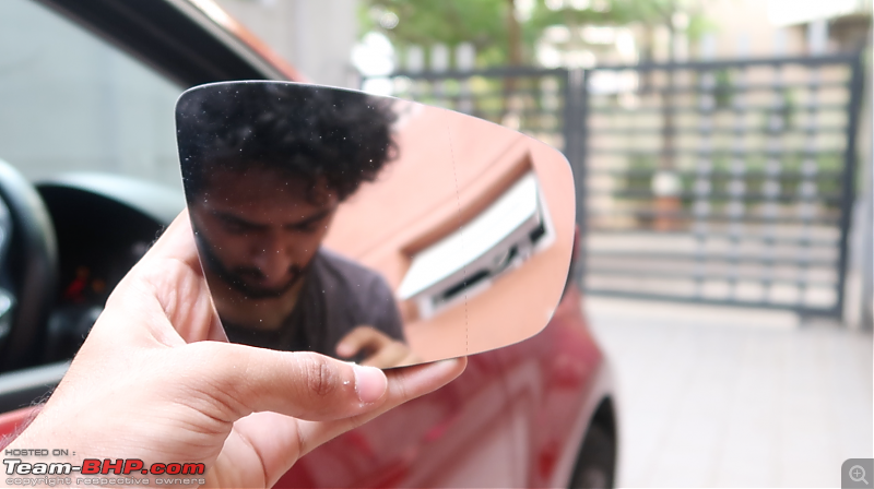

Driver Side ORVM Upgrade
On most European Right Hand Drive cars, the driver mirror is aspherical to reduce driver side blindspots and this has been something I’ve seen on both the Jetta and the Tiguan, but the Polo sold in India came without this ingenious touch and to add insult to injury, the mirror size has also considerably reduced from the initial Polo which was sold in India. I personally have been able to drive around comfortably, after adjusting the ORVMs to its extremes, but there are quite a lot of drivers who wished the Polo’s ORVMs offered a better view.
Review: Driving home our Sunset Red VW Polo Highline+ TSI Automatic-convex-mirror-selfie.jpg
Well, the good news is, you can swap out the Driver ORVM and replace it with an aspherical one. Replacing the mirror is fairly simple and all you need is a simple plastic pry or trim removal tool to release the stock mirror glass from the Mirror adjustment motor.
Review: Driving home our Sunset Red VW Polo Highline+ TSI Automatic-curved-orvm-hand.png
The aspherical mirror curves beyond the dotted lines, and offers a much better view of the side lane and this is especially usually to see objects in your blind spot. You can also find a Passenger side Aspherical mirror, but as per Eurospec, only the Driver side mirror is Aspherical from the factory.
Review: Driving home our Sunset Red VW Polo Highline+ TSI Automatic-aspherical-orvm-.png
I purchased this from Ebay and it landed at nearly 2000 rupees per side, courtesy shipping and duties. The mirror I have is now also a Heated mirror, useful if I lived in a frosty area and was considering a Heated Mirror retrofit, but this is something I don't think I'll ever do. The mirrors I purchased are a good quality glass but I believe the factory Aspherical mirror on European Polos could be a lot better but its priced 3x, and so I thought this one would suffice for now. What was an interesting revelation during this upgrade was that the stock Mirror glass was made by TATA.

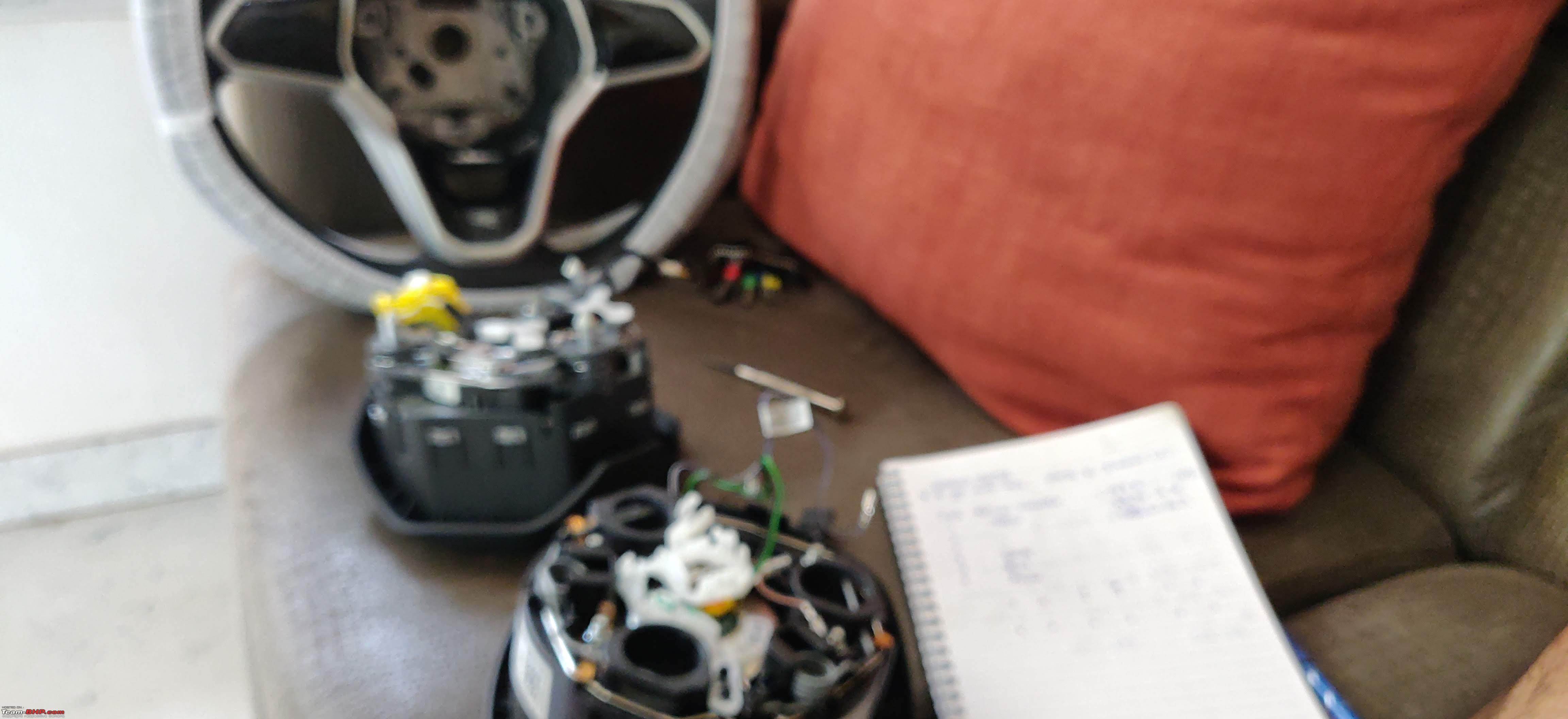

Steering and Paddling Around
When we got home our car, I was barely impressed with the shift quality from this AISIN 09G 6 Speed Torque converter. I went on record and said that I wasn't interested in a Paddle Shifter Steering, but a lot has changed on that front since February, as I've tried a plethora of Paddle Shifter wheels. Truth be told, other than the 3-2 and 2-3 jerk, I've accepted this gearbox now. Higher gears are remarkably smooth and downshifts from 6 to 5 to 4 to 3 are also fairly acceptable. However, it still isn't a DSG when it comes to shift speeds, but nevertheless, it is a very potent gearbox, with phenomenal in gear acceleration, and having a Paddle Shifter Wheel truly lets you juice the nuts out of the top-end. In 2nd gear, the car just falls shy of 90km/h (need to revalidate this claim, by rechecking my GoPro data), and it still needs that extra second to upshift, with full throttle so beware of the redline. To stay at the redline, I’ve tried quite a few steering wheels on the Polo in the last few months, and that gave me my first insight into the insides of a Paddle Shifter. I hate to admit, but I accidentally yanked the wires out of my three pin paddle shifter connector and they were all identical. Same gauge, same black colour.
Review: Driving home our Sunset Red VW Polo Highline+ TSI Automatic-paddle-shifter-inside-view.jpg
Replugging them back in resulted in a dead paddle and so I had to embark on a small detour which taught me quite a few things about how the Paddle Shifter electronics work. I had to take out the small cylindrical locking pin, and then ended up dissecting the paddle. I even got a chance to see the small elegant LED backlighting present on the paddle. What's interesting is that the Paddle LED is not intrinsically Red or White. It's either Red or White, depending on how it's wired, and swapping two out of the three wires allows us this switch. It's an utter shame that the MK8 Steering wheels have no lighting on the paddles and this is slightly more disappointing on the non-touch steering wheels, which could definitely have had a Paddle Backlighting. But other than that disappointment, the MK8 R-Line steering is another level when it comes to sportiness. It's so good to hold despite seeming a little large considering the size of the Polo. To get it to work, you need to use a decoder box, post which it starts to properly communicate with the PQ25 car. Once everything is set, it really changes the look of the cabin and makes it a lot more upmarket and tech savvy than it already is. This is the MK8 Steering with a Golf GTI airbag. Such MK8 steerings are available in quite a few more trim options with a few different types of Airbags. I personally liked this Volkswagen logo and this airbag design appealed to me a lot more than a few other options. The wheel also blended in my Highline+ Polo's grey interiors just fine, but it also looks incredible on Piano Black GT TSI interiors.
Review: Driving home our Sunset Red VW Polo Highline+ TSI Automatic-mk8-fjp.jpg
Review: Driving home our Sunset Red VW Polo Highline+ TSI Automatic-mk8-steering-wiring.jpg
Review: Driving home our Sunset Red VW Polo Highline+ TSI Automatic-mk8-strong-backlight.jpg
However, the backlight colour temperature on this wheel is a lot stronger than the Maxidot Cluster, and feels a little harsh on the eyes during night-time driving. On the MQB platform, the brightness of these can be controlled along with the Interior illumination from the Headunit. I subsequently, moved back to a White Backlight Paddle Shifter wheel, which is simple, yet elegant.
Review: Driving home our Sunset Red VW Polo Highline+ TSI Automatic-mk7-right-hand-button-bokeh.jpg
In the last few months, I’ve helped quite a few folks with a Paddle Shifter steering for their 1.0 TSI and all of them are loving the improved sportiness quotient on their cars, despite the initial disappointment for not having a quick DSG anymore. A Paddle Shifter wheel is a great plus and a must have for all Automatic cars and its not just for the thrill, but it is also a really handy tool for driving down ghats, considering the stock brakes on the automatic car have a tendency to fade real quick, considering the torque converter is also lazy to shift down and shed speed. Occasionally, you may also choose to shift the car to cruise in D6 to extract that extra fuel efficiency considering the boom in Petrol prices.

Pulling Issue
People often say numbers don’t lie, and I have to agree. I’ve driven quite a lot of 1.0 TSI Polos, both Manual and Automatic and me, and a few experts are convinced there’s a definite issue with the suspension on a few of these newer vehicles. There is something this vehicle which just makes it super road crown sensitive. I’ve had a left pulling from my first day of ownership, and there’s been considerable driver fatigue due to having to counter hold the wheel with my right hand. So during my last visit, the Volkswagen folks tried shifting the subframe to give the car more straight line stability. This reduced the pulling to quite some extent and now the car can track comfortably straight. However, this has made life horrible on banked rounds where the car just wants to drift off, and the issue is only worse with more passengers inside the car. At a point few months back, I had a daily interaction with at least 3-4 folks who were facing a similar pulling issue on their 1.0 TSI Polo. Some cars were pulling and veering right, even on roads inclined towards the left. This is something I still haven't gotten right, but I try to ignore it, but sometimes its just not possible to.
The subframe shift also caused a steering cross condition and a characteristic creaking noise when I sit inside the vehicle. I knew this beforehand, that the Subframe bolts are one time use stretch bolts and recommended to be replaced each time the subframe is loosened, but the service guys were confident of using the same bolts and I trusted them. But, the creaking noise was very evident. So, during this service, I requested them to replace them, but they insisted they’ll tighten them again. If it creaks again, I will insist on a new set of 4 subframe main bolts and will have then torqued down to 70Nm + 90 Degree turn. Then, the car was being taken for alignment and the tyre pressure wasn’t measured, so we reversed the car out of the alignment lift and had all tyre pressures calibrated and then the alignment was performed. The technician acknowledged a slight cross and accordingly the toe was corrected and now the steering is straight and not crossed anymore. However, the car still has a massive crown drift and never have I ever experienced this amount of insane counter effort on any other vehicle. There are quite a lot of theories and remarks by reputed readers and writers that I’ve read on international forums and, but there is a strong lack of the means to solve this issue, and I think I’ll make a separate post on this, with few more facts when I try some more things and uncover few more unknowns.
Review: Driving home our Sunset Red VW Polo Highline+ TSI Automatic-poona-tyres.jpg
In an attempt to fix the not so correct alignment and steering feel, I visited Poona Tyres, who have one of the best Hunter equipment and supposedly the most experienced tyre alignment technicians. The technician at Poona Tyres surprised me by starting off with the wrong Polo suspension spec. Then, I stepped in and opted for G33 : Rough Road Suspension for India, post which, the Toe was equalised on both sides. I have driven about 600 kilometres after this alignment, and the alignment seems to be done better than before, and the car is putting its power down better, but the steering still doesn't feel right. Even a gentle progressive braking manoeuvre (doesn’t help that I have a Big Brake Kit now) on the highway is turning the steering to one side, time and again, which makes me feel this is definitely an alignment thing. Sadly, we aren't in a setup where these minute issues are dealt with a very scientific approach to tackle the issue, and so for my own welfare, I refrain from bothering myself too much with this.

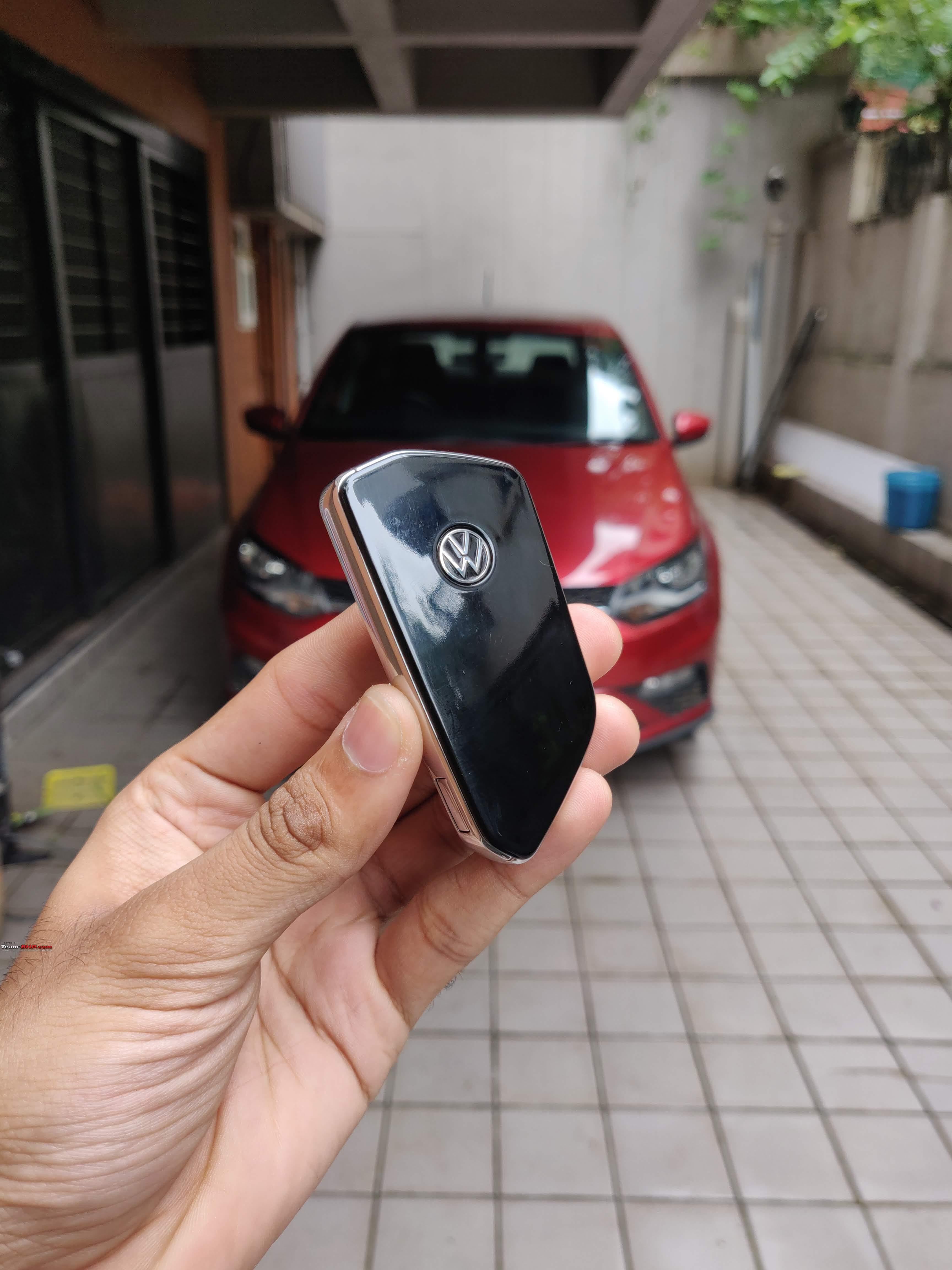

Golf MK8 Key
Got to lay my hands on the gorgeous glass sandwich Keyless MK8 Key meant for MQB cars. It’s gorgeous and is a huge step up in design language compared to its predecessor, and it stays true to the MK8 tradition of glossy digital panels. However, it’s still a very basic entity, compared to what the elder Germans offer on the BMWs. This isn’t a flip key, nor is it haptic as per MK8 standards. It’s just a more premium feeling offering.
Review: Driving home our Sunset Red VW Polo Highline+ TSI Automatic-polo-mk8-key.jpg
Now’s a good time to reveal that this key also can be made to work with Polo, and here are some pictures of my new key with a backdrop of the Polo. Just kidding, this key isn’t for me. I’d have loved to code this to my car, but it doesn’t make sense to cripple myself since it is not a proper flip key, and I don’t plan on retrofitting a KESSY (Keyless Entry) setup anytime soon.

Originally Posted by Shreyas_H View Post
Fantastic updates, as always. Really liked the Bonnet strut and the steering wheel! You mentioned the new ORVM is a heated mirror, how does that work exactly?
Basically the heated mirror has an electrical coil with a two pin connector behind it. If we do the Heated Mirror wiring and attach a suitable Heated Mirror ORVM switch, we can get these mirrors to heat up and clear the fog. I believe near OE implementation will require coding and support from the BCM. Some have also installed these by connecting them to the Rear Defogger assembly
