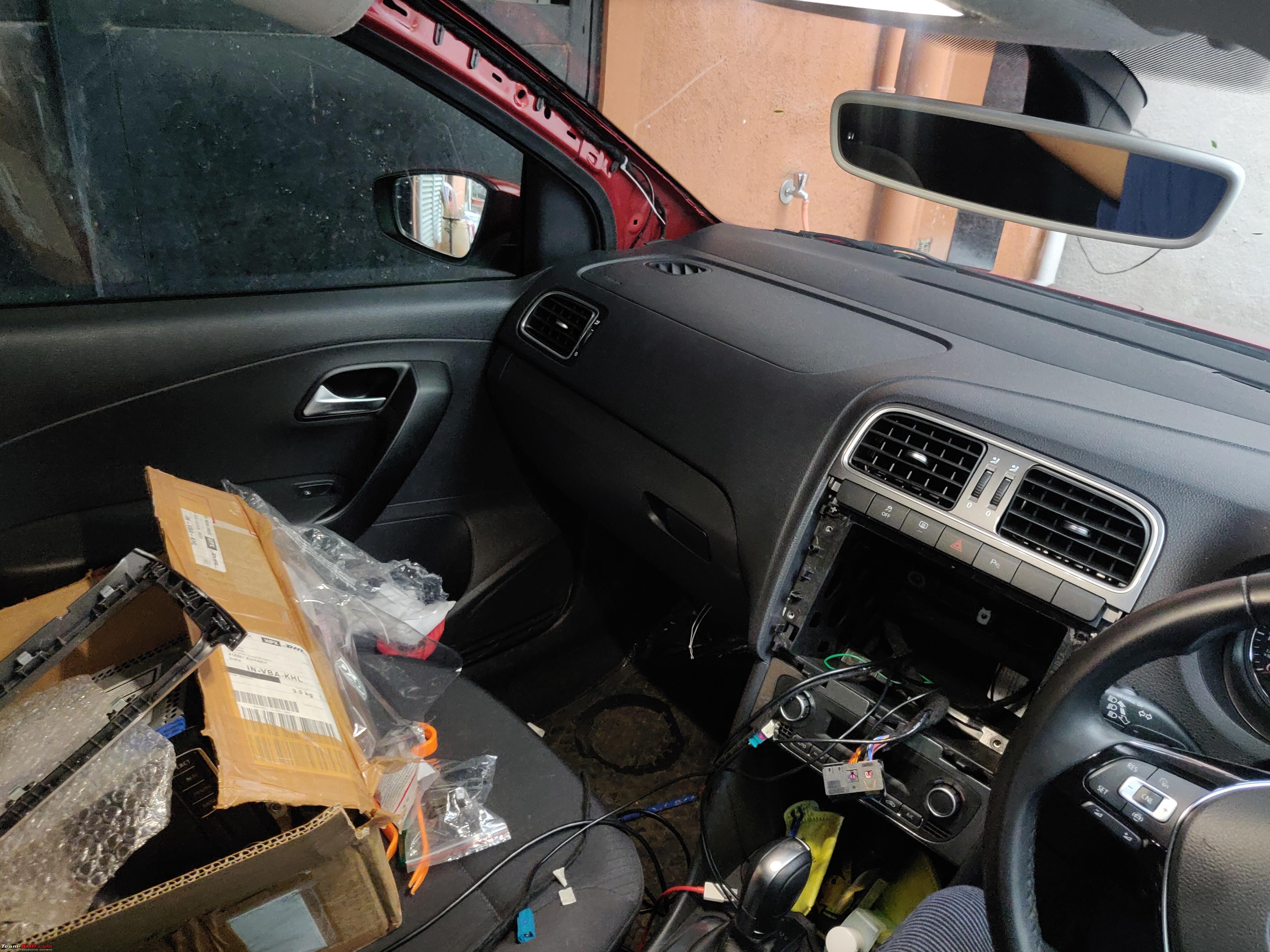

Radio Connector, Wiring
The connector on the RCD340 is a QUADLOCK Connector, but installing the MIB-2 requires a different quad lock. The USB and AUX port take a separate rectangle in the Quadlock. The microphone wire connects to the Blue Rectangle which has the Camera signal pins at 6 and 12.
If you plan on using a converter for the existing quad lock, there could be a space constraint behind the radio, but with a little adjustment, you can still manage to fit everything properly. The new microphone now sits in my Passat Style cabin light and is routed along the A-pillar, which is susceptible to breaking on removal.

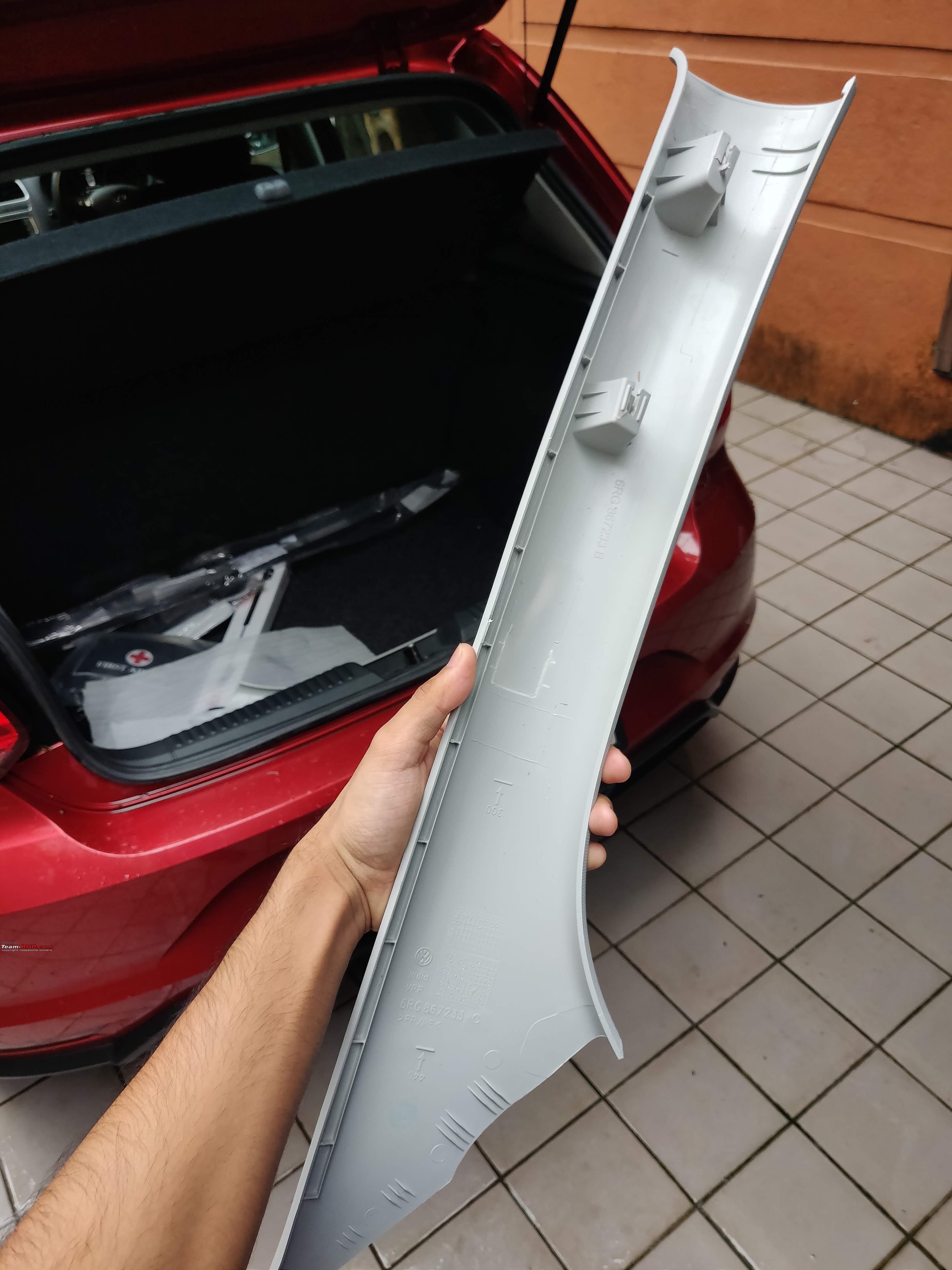

On removing the
A-pillars, I noticed how the A-pillars now had only two clips and plastic holders as opposed to three in the past.
Previous cars would also get an
insulation inside these A-pillars and I managed to procure these two grey foam inserts for insulation from a scrap car. Volkswagen just doesn’t fail to amuse when it comes to its
cost cutting skills.

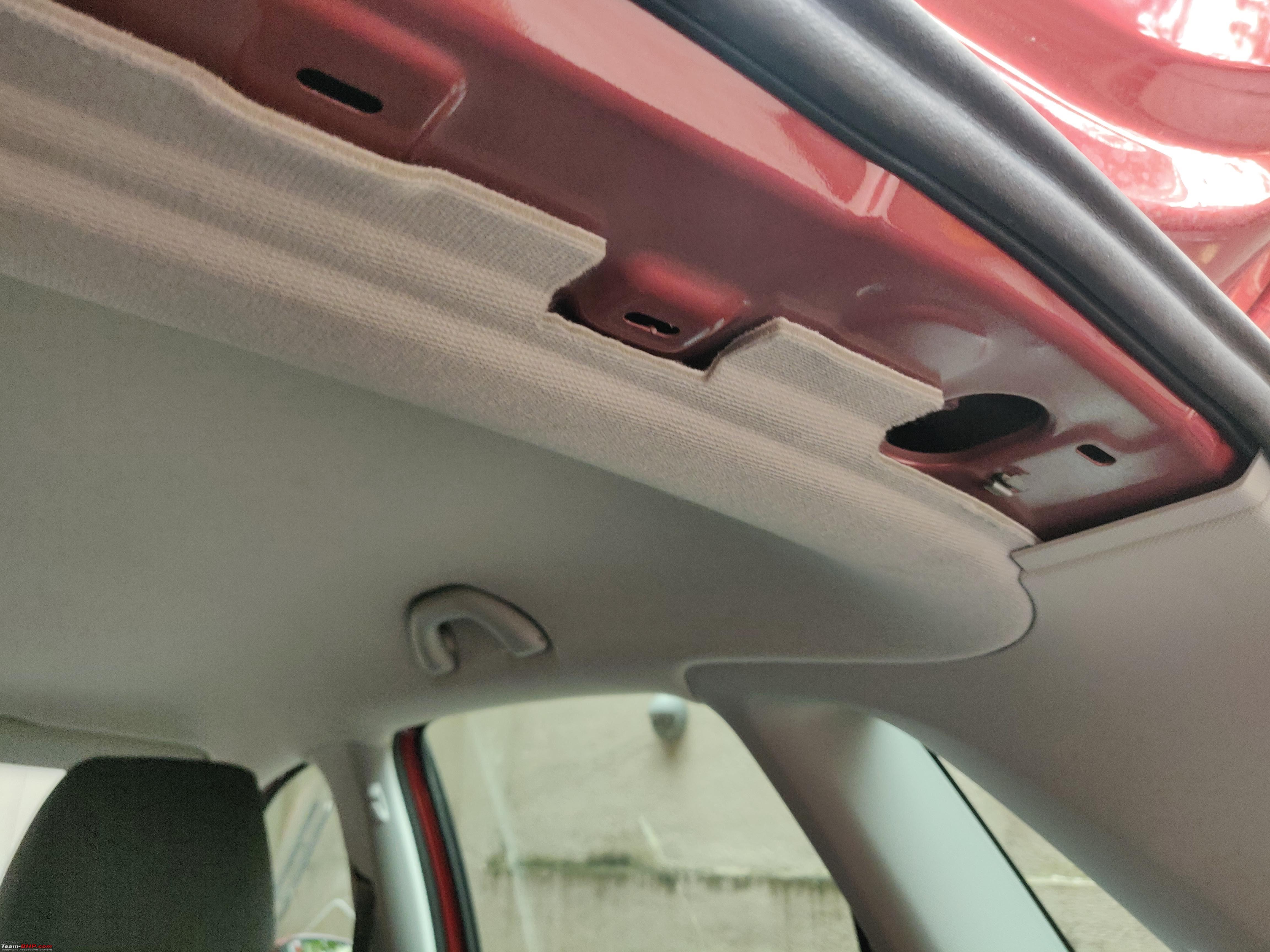

Removing the stock antenna requires removal of the rear-most headliner trim and the access could be slightly tight if you don't want to crease or wrinkle the headliner too much.
Using a 21mm wrench, I undid the bolt which holds the stock antenna base to the car’s roof and it’s a little tricky to undo without tugging and creasing the headliner too much.
Once this ring-bolt is loose, the antenna can easily be unscrewed and pulled out from the top. Don’t forget to disconnect the
White Antenna connector before removing the
old antenna out of the car.
This is what the stock base of the antenna looks like and this is where the rod screws in.

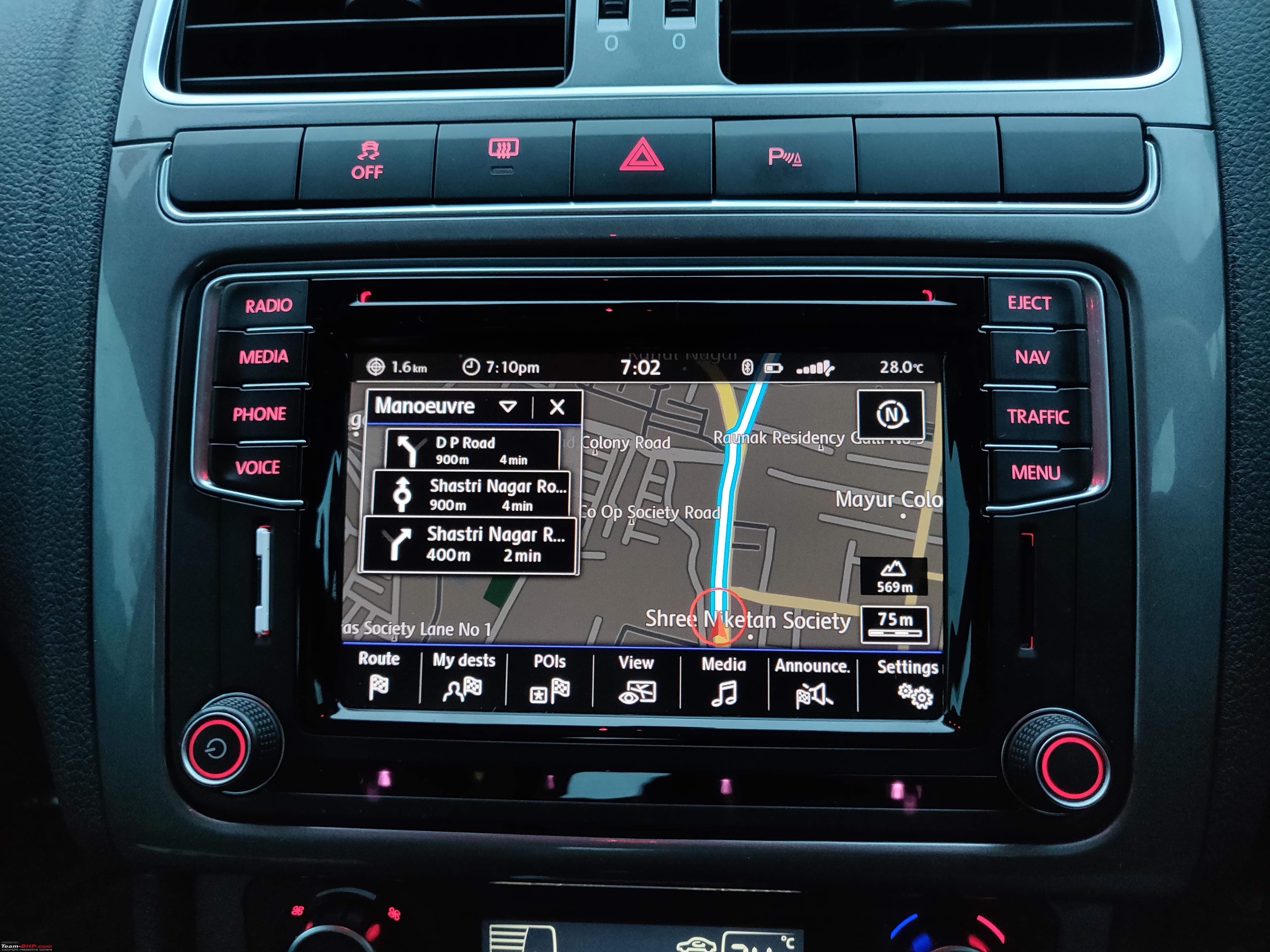

It really is nice to see how well the offline
maps work with the cluster. The turn by turn GPS navigation is nice and seamless and this is something I wish VW had offered with our Diesel Tiguan as well.
The map data itself is obviously not as good as Google Maps, but it has been getting crazy good. The last time I used a VW map was two years ago but the one I downloaded a few weeks back from the Volkswagen site seemed to be fairly in tune to my city conditions for most major roads. So it seems like Volkswagen is trying to make their local maps data better. The maps can be
downloaded from the Volkswagen Global website and need to simply be copied to an SD Card.
The navigation feature also brings in a nice
compass on the cluster which indicates with a letter the direction I’m heading in. There also exists a dedicated page on the Cluster for this Compass.

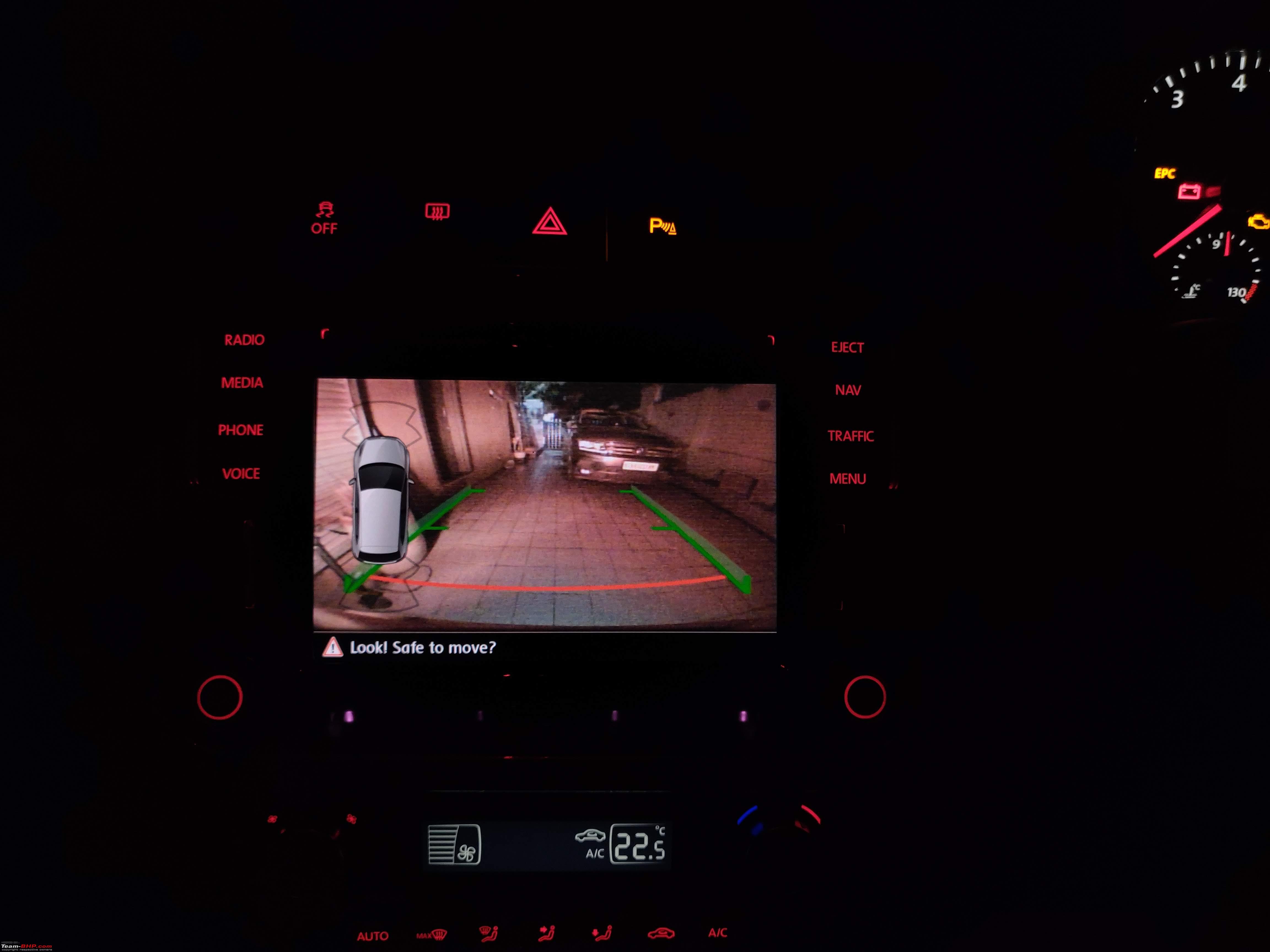

Another nice touch is the
combined OPS and Reverse Camera view. When in reverse, I can see the entire camera screen and if there’s an object approaching, then the OPS unit
overlays itself at the right time. This really is a boon and works like a charm.

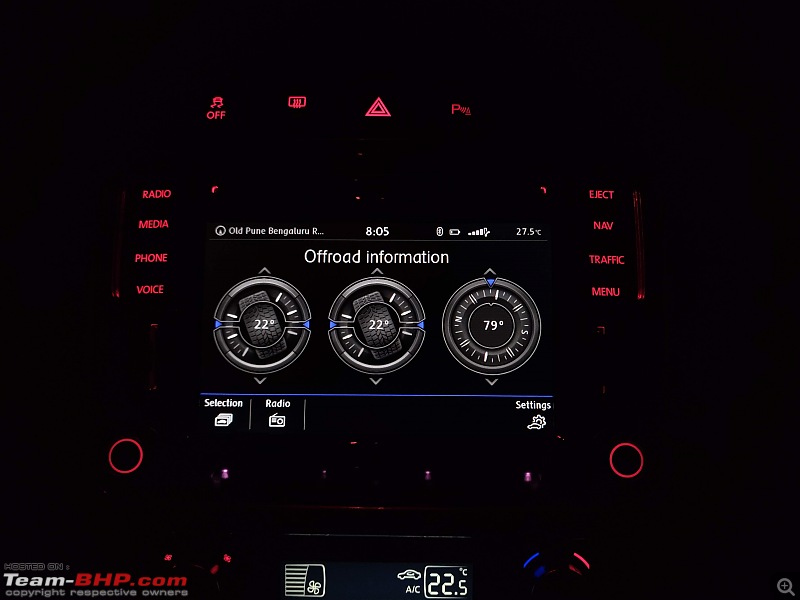

It also has a feature called
Off-Road Mode which shows the Steering Angle Sensor value, compass and engine temperature in three distinct gauges. It’s nice to have the Steering Angle but for most experienced drivers, it’s not really too tough to tell when the wheel is straight, but this could be something useful if the Polo were to go off-road. So overall I'd say this is not so useful in the city. The Discover Media also comes with support for skins and the
