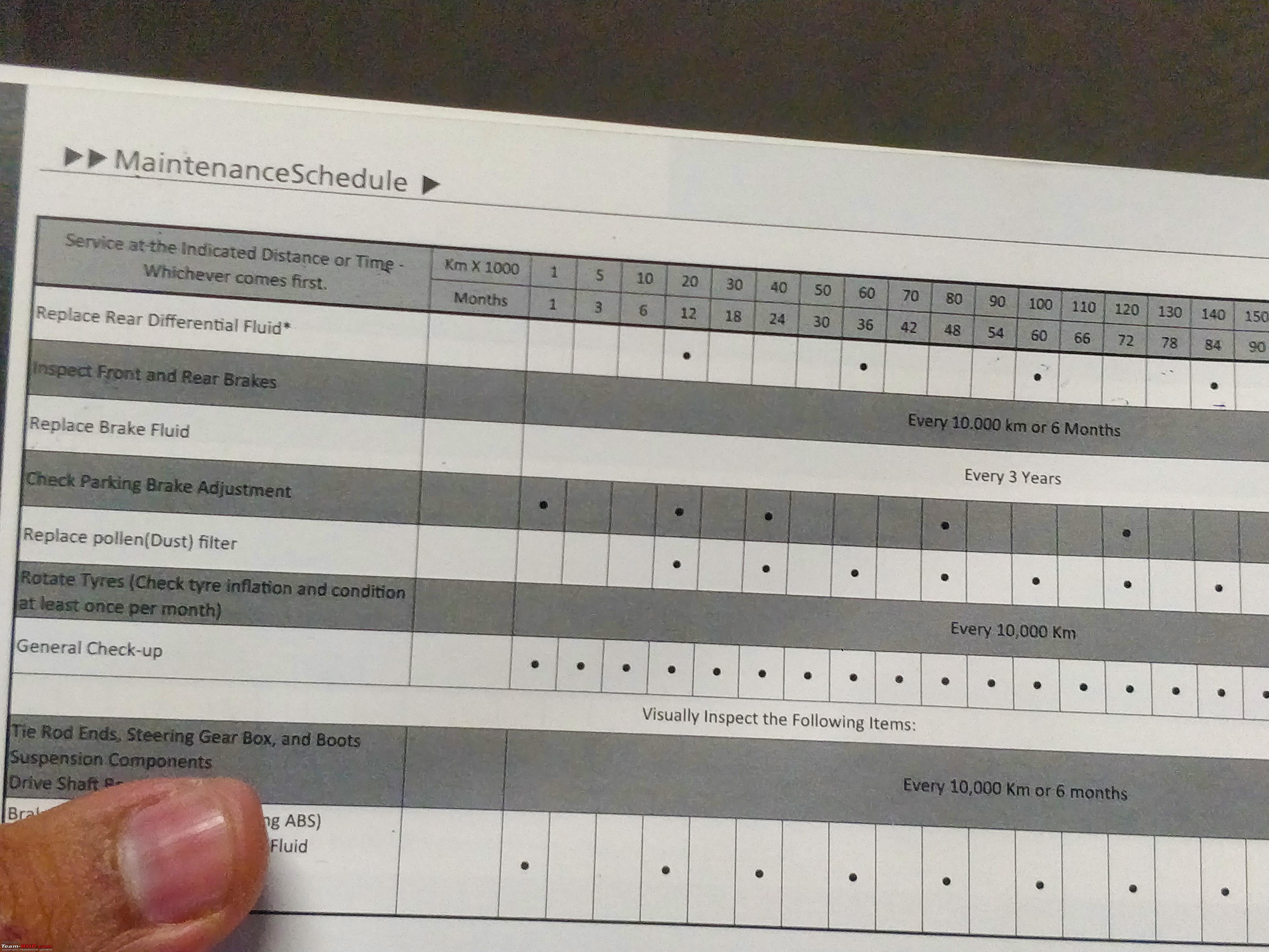

1. The very important (from a preventive maintenance perspective) 'Rear Differential Fluid' change, which was almost due @ 36K kms.

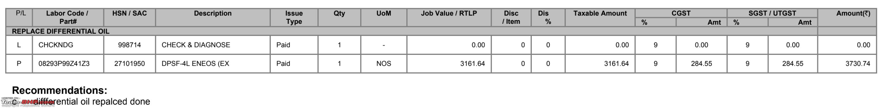

Some Honda dealerships quote atrocious pricing for this, however, there have been zero hiccups from Honda, post the tweet, touchwood!
Honda calls it DPDF-II, which comes in a 4 ltr. can, cost = 3730 for the can, zero labor charges. putting the screenshots for the part nos in case if it helps anyone.

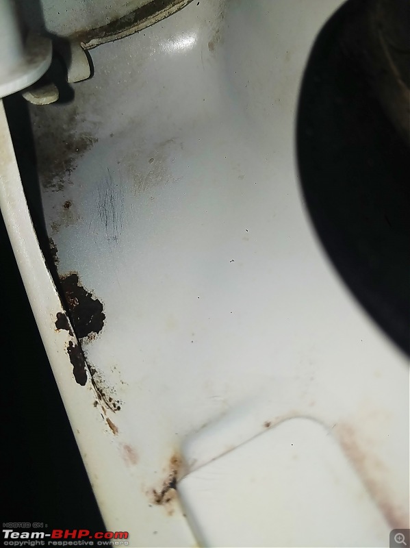

just last week, caught something on the fuel tank lid, and realized this needs a fix sooner before this becomes a menace -
have sprayed it with WD40 as a first line of defence, eventually will have it scrapped and touchedup whenever will give it for detailing next. Still wondering what could be the culprit here as this one is just on the inside area after you open the fuel lid. Is it the rain water not sliding off due to the grim that gets deposited?
