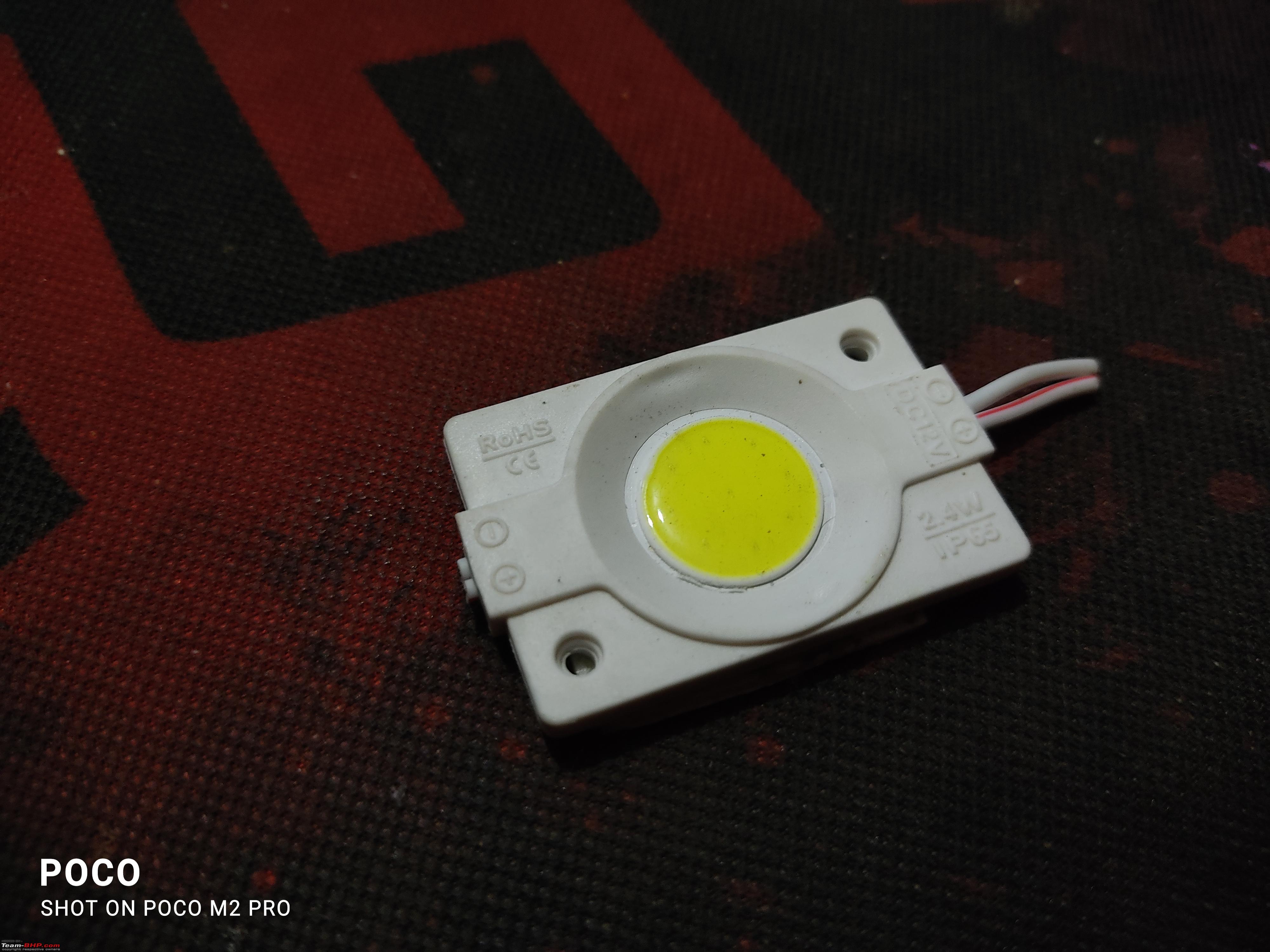

So I ordered a couple of LED dome lights and tested them before installation, here are the test results :
LED #1 :
Join the tribe! Renault Triber RXT AMT Review - 1 Year & 8,652 kms update-1621783915115.jpg
Join the tribe! Renault Triber RXT AMT Review - 1 Year & 8,652 kms update-1621783915083.jpg
Cost : INR 60

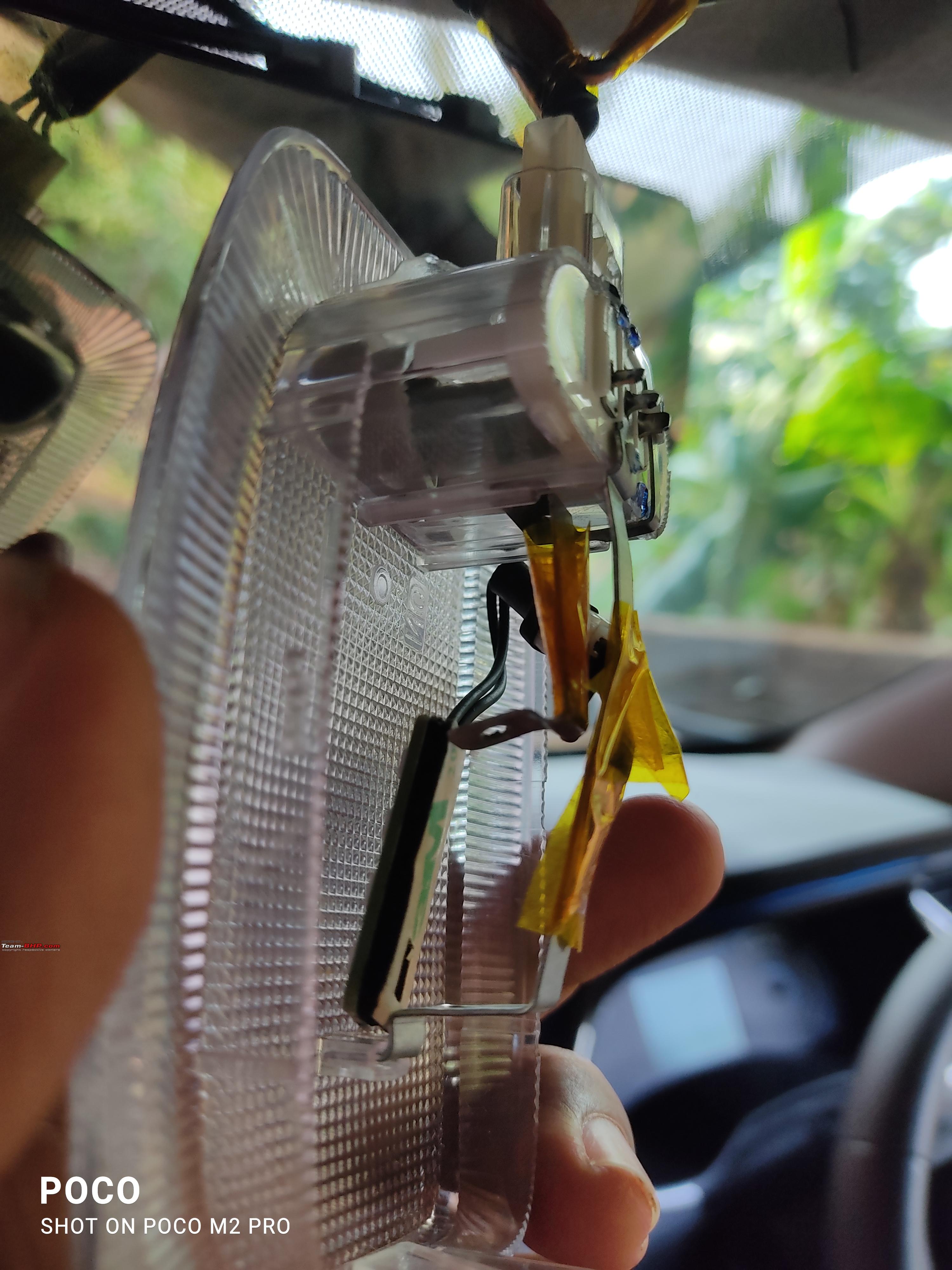

Had to stop the temperature test for LED #1 midway because of the very high temps. Personally I would never use a LED cob without adequate cooling; LED #2 did perform well but we have to consider that the test was performed in an open environment. LED #3 was the best performer with stable temps and power draw.
All of the attachments provided with the Philips reading light did not fit, so had to manually splice the cables; used polyimide tape to keep them in place. This is a temporary solution, will secure them with zip-ties later.
Join the tribe! Renault Triber RXT AMT Review - 1 Year & 8,652 kms update-1621786519830.jpg
Join the tribe! Renault Triber RXT AMT Review - 1 Year & 8,652 kms update-1621786399898-1.jpg
Never buy the cob-style LEDs as most of them won't have adequate cooling, the SMD-style LEDs should work for budget minded buyers; but again most of them are generic products with unknown reliability.
Initially I was looking for Osram but settled with Philips because of stock issues.

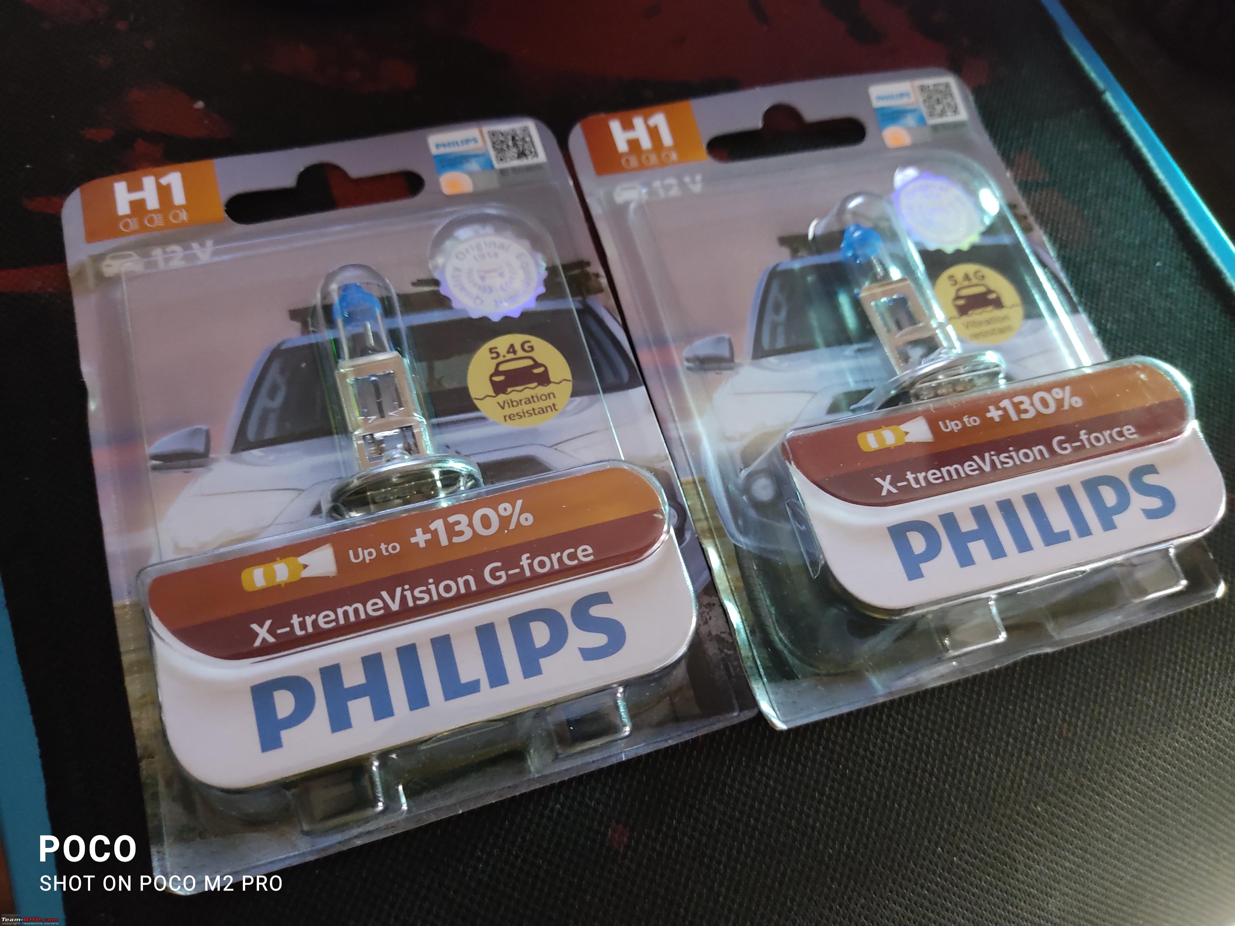

The stock headlights are not adequate for night driving on unlit highways, and as the Mumbai-Goa highway is a frequent route for me I had to do something about the headlights.
The HID and LEDs are not permitted to be used in halogen housing as per what I read, so sticking with halogen upgrades for now to avoid any issues with cops.
After a bit of research found out that the Osram Nightbreakers are more expensive and don't last as long as its Philips counterpart, so went with Philips Xtremevision G-force.
Both the pairs costed me a total of INR 2,459 including shipping.
Low Beam (Projector) : H7
Join the tribe! Renault Triber RXT AMT Review - 1 Year & 8,652 kms update-1623649961961.jpg
High Beam (Reflector) : H1
Join the tribe! Renault Triber RXT AMT Review - 1 Year & 8,652 kms update-1623649961996.jpg
The difference is noticeable and definitely improves visibility at night.

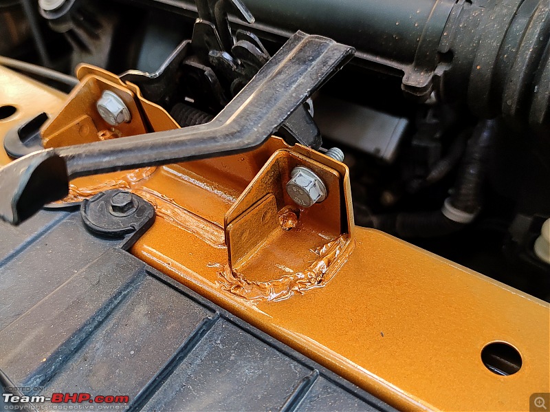

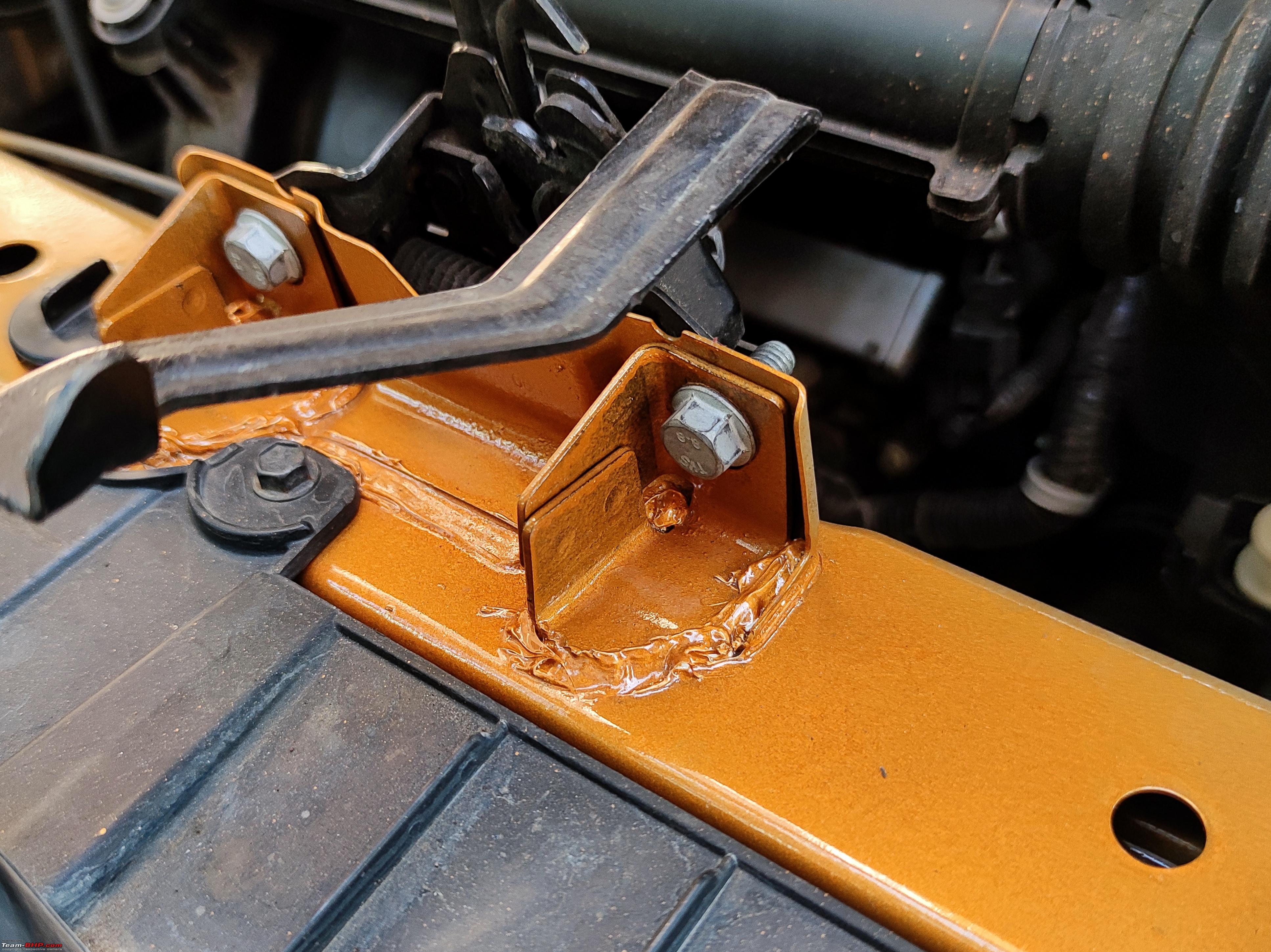

Last month received a message from Renault regarding the Triber recall. They strengthened the bonnet lock and returned my vehicle.
Attaching details of the recall & the before and after images.
Join the tribe! Renault Triber RXT AMT Review - 1 Year & 8,652 kms update-1633346156237.jpeg
Join the tribe! Renault Triber RXT AMT Review - 1 Year & 8,652 kms update-recall.png
Before
Join the tribe! Renault Triber RXT AMT Review - 1 Year & 8,652 kms update-1633345685257.jpeg
After
Join the tribe! Renault Triber RXT AMT Review - 1 Year & 8,652 kms update-1633345685249.jpeg
