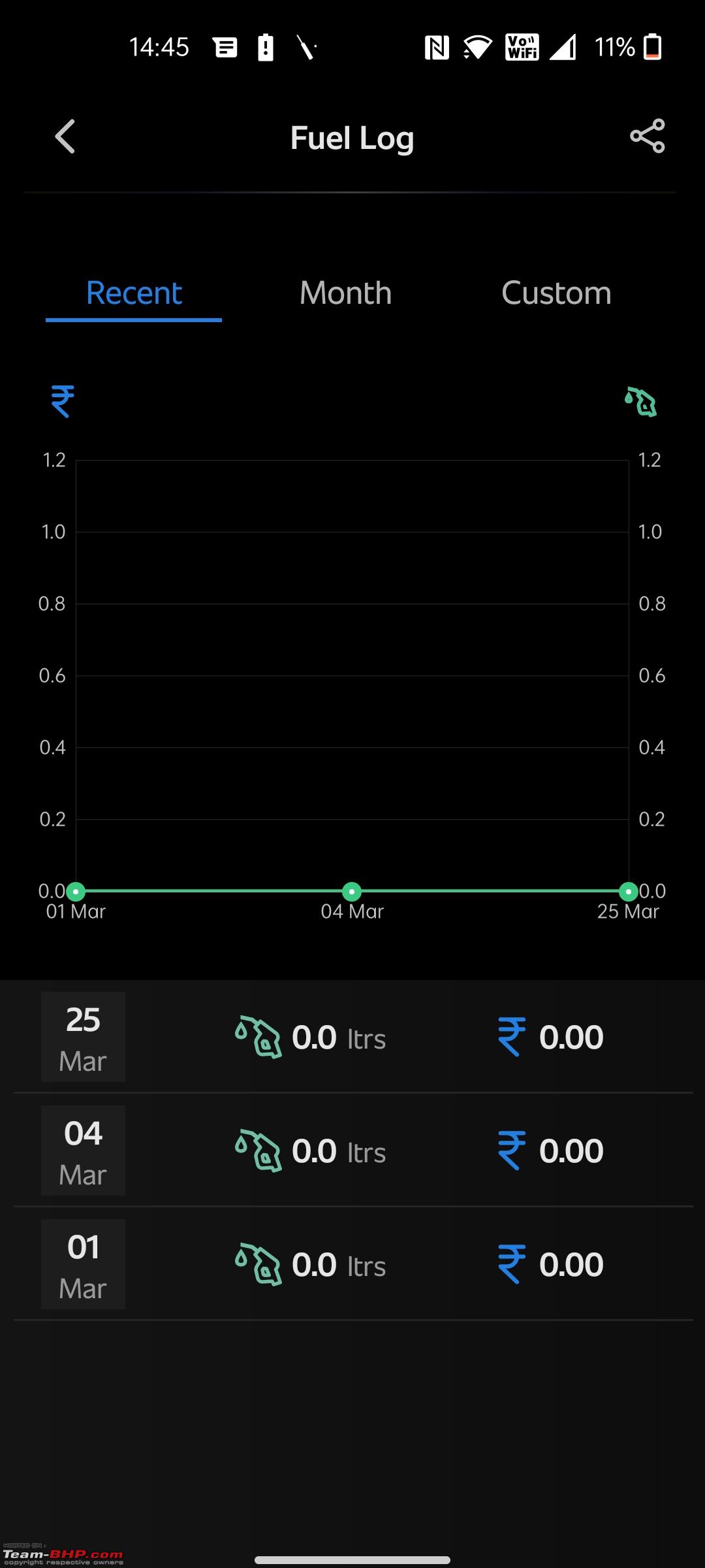

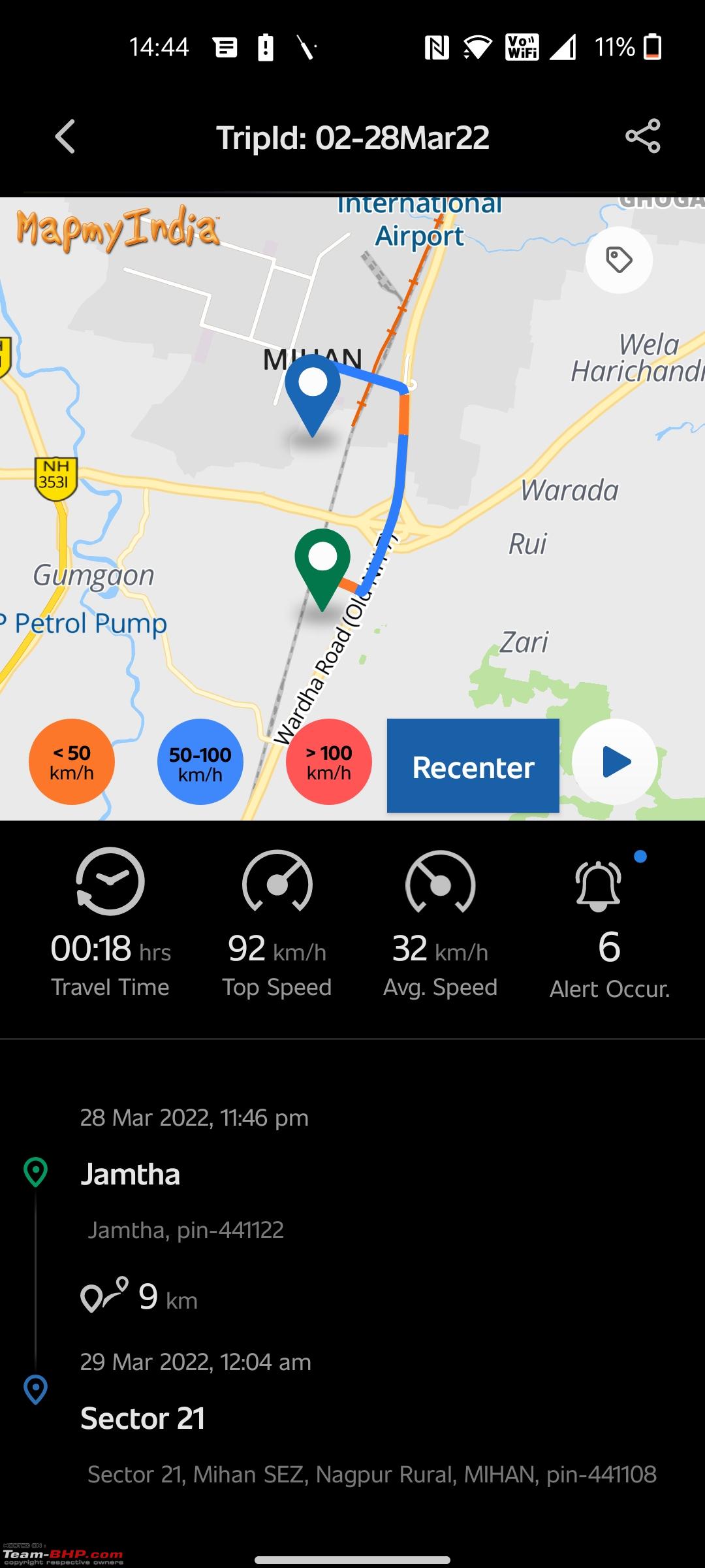

[*]The ADRENOX app is a little weird. Sometimes it shows that the headlamps are on, while there are not.[*]I paired my phone once, however there are two phones listed on the screen. Deleting one, actually deletes both and you sendup with nothing
Attachment 2231030[*] Even though my phone is paired and the phone phonebook download is complete, I don't get to see the call history, phonebook or any other useful information.
I am unable to see all details like yours in trip summary. Below are the only details I could see. Am I missing anything or is it because mine is AX5?
Also, we have to manually do fuel entry every time. Right?
Red Rage - Mahindra XUV7OO - Initial Ownership Review-screenshot_2022040214445782_67b948f2f86cc24313c3b18cabbad5d4.jpg
Red Rage - Mahindra XUV7OO - Initial Ownership Review-screenshot_2022040214450854_67b948f2f86cc24313c3b18cabbad5d4.jpg
Piyush_DT is offline   (2) Thanks
Yes I believe so. AX7 and AX7L get the remote functionality in the App.
And fuel log in the app is ,err, broken. I don't think, this is how it is supposed to work. It get the correct location, price (most of the time), but always indicates 0 and so yes it's manual. However the reason why I think, it's not working as it is supposed to, is because, there's no option to manually add a fuel record. There are at least 4 instances, where the App failed to indicate a new fuel fill event and I can't add it one manually.
