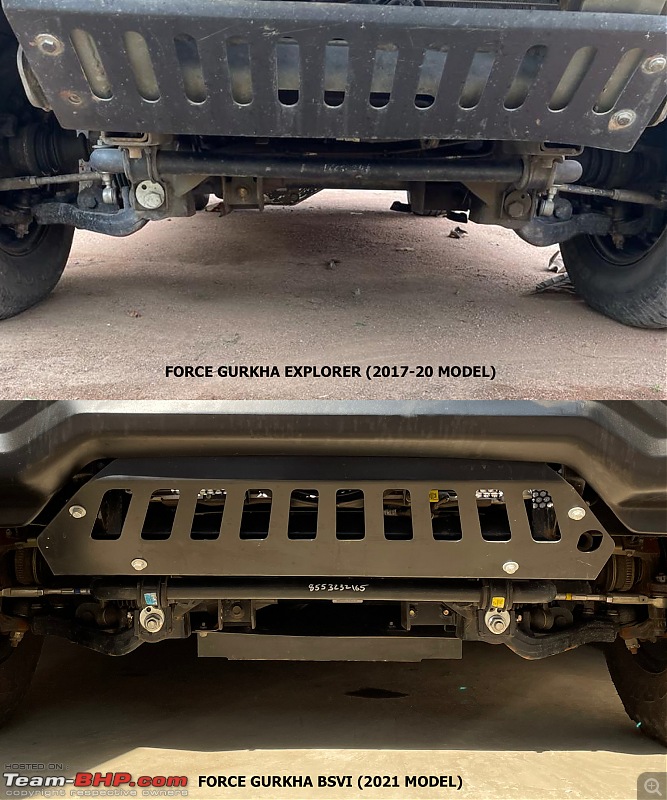

Thanks to Trojan's reference of his older generation Gurkha Explorer, I laid it out against my new BSVI Gurkha.
The Island Gurkha | My 2021 Grey Force Gurkha 4x4 in the Andamans | Ownership Review-90205.jpg
The lower arms in both the old and the new Gurkhas are about 205mm clear off the ground.
The Island Gurkha | My 2021 Grey Force Gurkha 4x4 in the Andamans | Ownership Review-img_1622.jpg

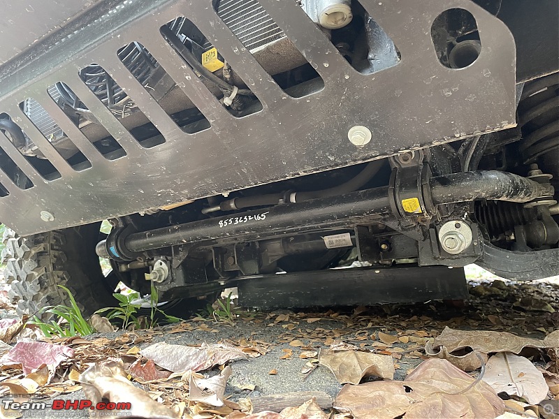

The additional bracket and the protection plate welded in the new model Gurkha is lower than the wheel arms and presents a challenge to underbody clearance. This one is about 175 mm clear off the ground.
The Island Gurkha | My 2021 Grey Force Gurkha 4x4 in the Andamans | Ownership Review-img_1620.jpg
I have driven my BSVI Gurkha over rock, slush and sand extensively, more than on tarmac, and I have managed to save bashing this bracket most of the time. But if one doesn't choose line wisely or if the terrain itself is too undulated or with deep ruts on either side, the plate does scrape the ground, and I have hit it hard a couple of times. And we all know that feeling that rattles your heart and your brain together when you hear that 'thunk' sound. It is a bash plate and it is doing if its job protecting transmission components if it gets bashed, but if this scrapes against rock and the paint comes off, that's a rust inception point for this island Gurkha and that's a big worry.
The Island Gurkha | My 2021 Grey Force Gurkha 4x4 in the Andamans | Ownership Review-img_1072.jpg
The Island Gurkha | My 2021 Grey Force Gurkha 4x4 in the Andamans | Ownership Review-img_1128-4.jpg
There is sufficient gap above this plate and I am trying to understand the design ethos or the safety precaution that might warrant this gap. If I do not find one, I would consider replacing this with a custom made stronger angled bash plate or slider frame.
The Island Gurkha | My 2021 Grey Force Gurkha 4x4 in the Andamans | Ownership Review-img_1201.jpg
I will update you guys what I end up doing based on how intruding this gets.

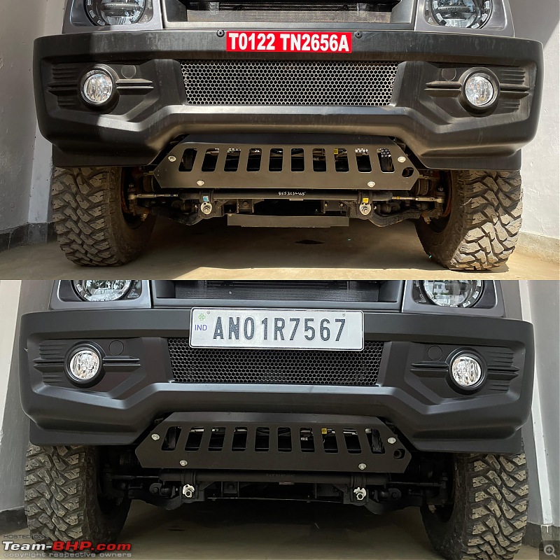

The Gurkha is very capable, even in stock form. As I wrote, it’s a plug and play off-roader from the get go.
For extreme stuff, it’s up to the owner to understand the vehicles capabilities and limitations and spruce up the vehicle accordingly. For eg, for those who need it, a proper bumper with recover points may be a requirement .
I would not judge the capability of the vehicle just by this one low plate. I am already working on a solution for it and would update you by tomorrow.
The Gurkha is potent and extremely capable once you know what you’re dealing with. A lot depends on how well one can exploit its capabilities. My respect for the vehicle grows with each discovery of its off-road prowess.
My Django is getting his underbody treated to withstand the salty air and salt water onslaught here in the islands especially since his favourite hunting grounds is beach sand.
I’m modifying the bash plate also to liberate more space, while still retaining protection.
Give me a day and I’ll show the full underbody.
Teaser image prior to full report: -
The Island Gurkha | My 2021 Grey Force Gurkha 4x4 in the Andamans | Ownership Review-277d9196e19f432bb4a076a33708e012.jpeg

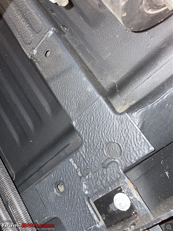

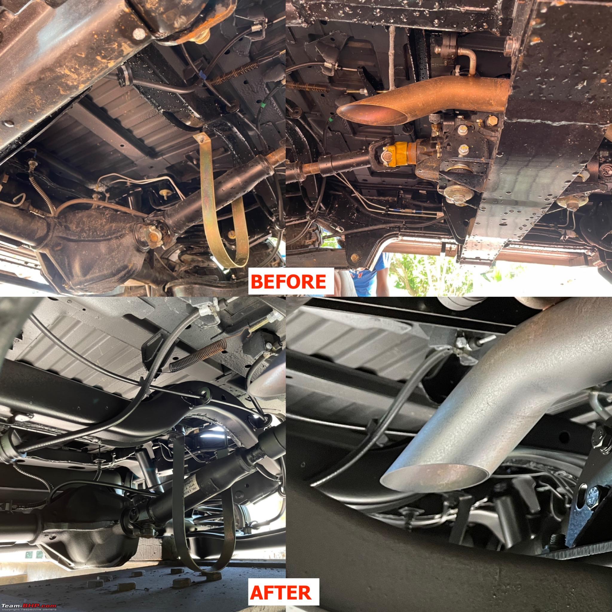

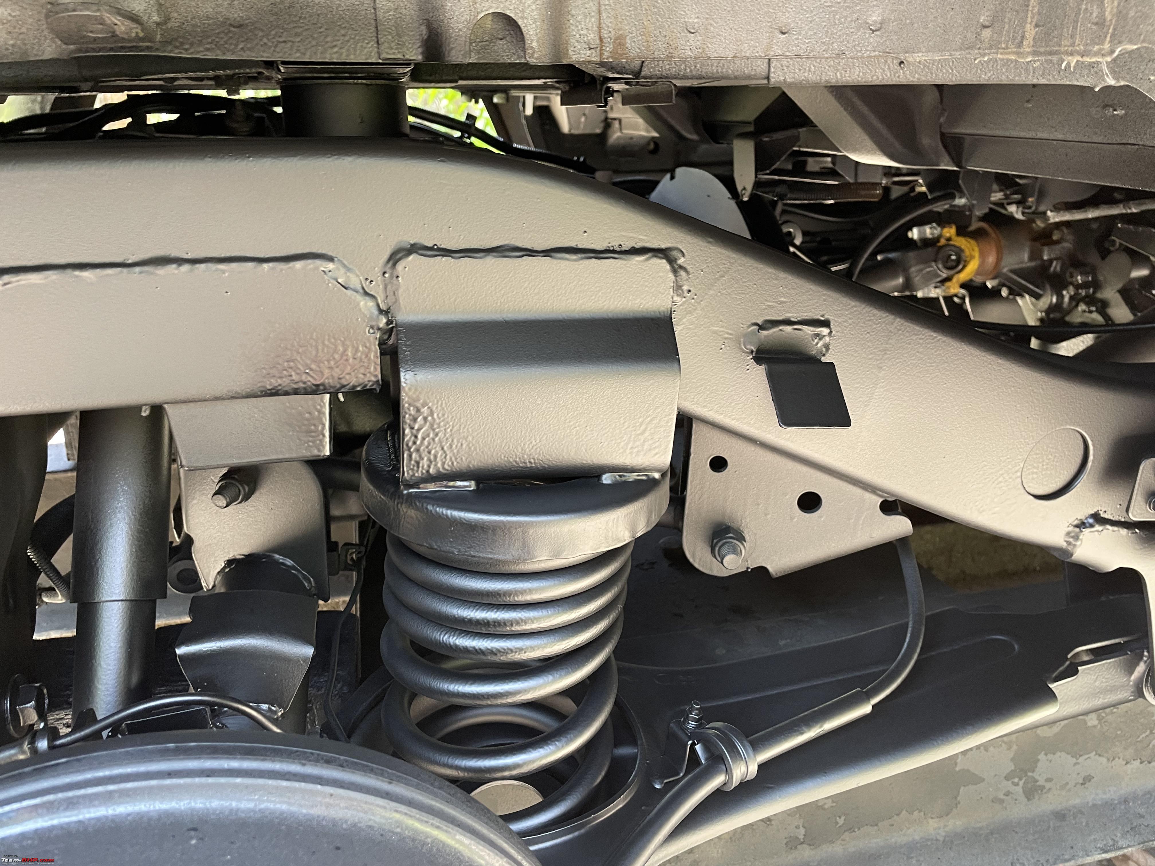

You're absolutely right Riju.
My Gurkha is getting these two solutions done precisely as we speak. I am trying to protect the underbody against corrosion which is Django's main enemy. On closer inspection, I can appreciate how the company already has done a pretty decent job, compared to the older model, of properly bundling and running the hoses through protected conduit routes. Some rubberised paint coating has also been provided on chassis underside for wear, abrasion and corrosion resistance. But there are other components which are ripe for rusting once we scrape the paint off or touch sea water. Some electrical connection boxes underside also need some water proofing/ insulation.
Within the available means and resources in the island, I am getting Django's underside completely done up and will give a report once I'm done tomorrow.
The Island Gurkha | My 2021 Grey Force Gurkha 4x4 in the Andamans | Ownership Review-img_1634.jpg
The Island Gurkha | My 2021 Grey Force Gurkha 4x4 in the Andamans | Ownership Review-img_1654.jpg
Underbody now:-
The Island Gurkha | My 2021 Grey Force Gurkha 4x4 in the Andamans | Ownership Review-img_1636.jpg

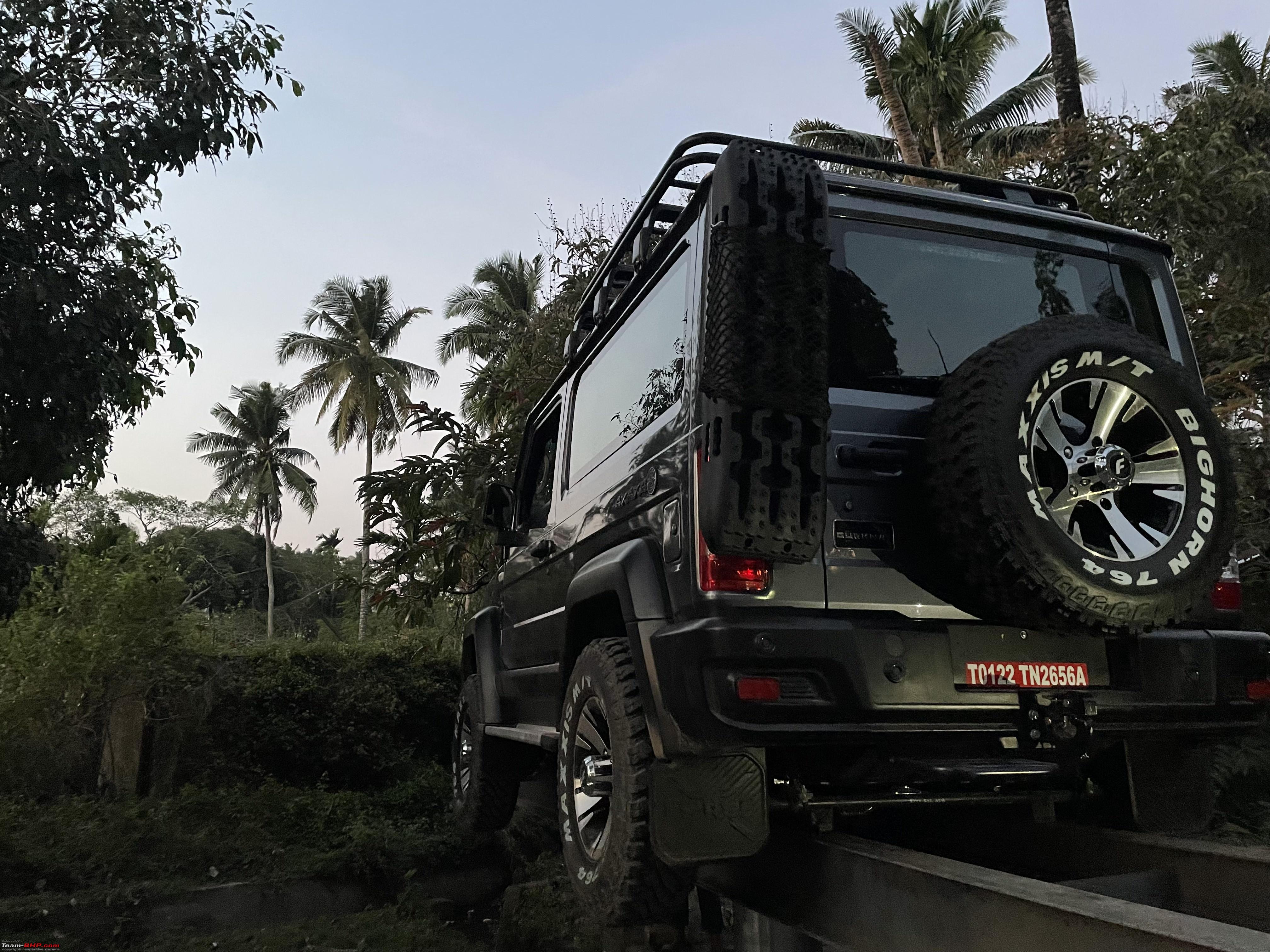

Tried to catch the sunset again yesterday, but the sun quickly dropped like a ball and all I got was a glimpse of burning red dot against the Island Gurkha.
The Island Gurkha | My 2021 Grey Force Gurkha 4x4 in the Andamans | Ownership Review-img_1626.jpg
Since Django is on the jack getting the underbody work done, my standby vehicle is the good old Explorer. And I'm quite enjoying the old boy. (Full story later!)
The Island Gurkha | My 2021 Grey Force Gurkha 4x4 in the Andamans | Ownership Review-img_1664.jpg

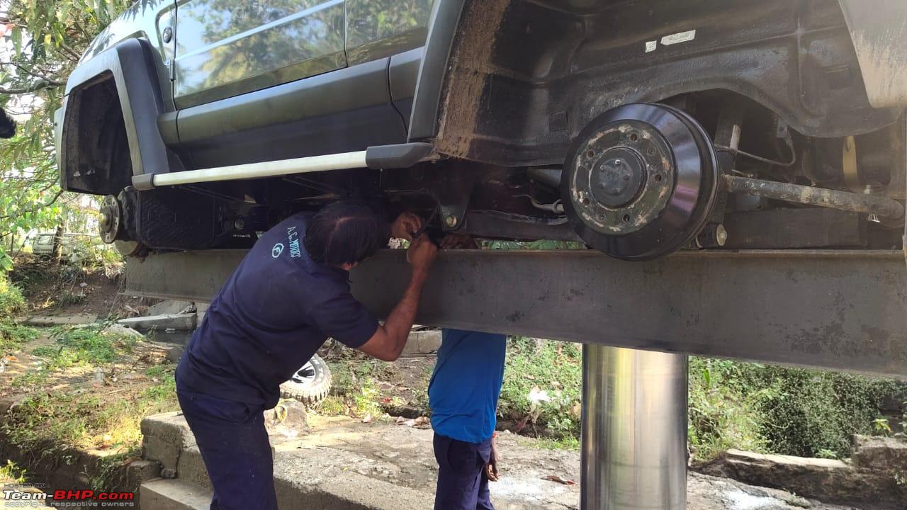

I bought the paints and the coatings required for the execution and so started Django’s first workshop visit.
The Island Gurkha | My 2021 Grey Force Gurkha 4x4 in the Andamans | Ownership Review-under_boxofgoodies.jpg

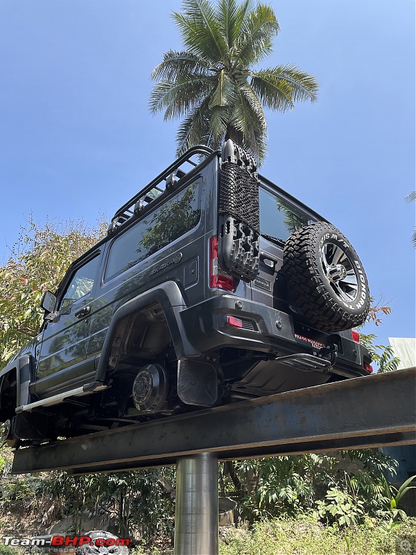

The crew also excitedly huddled around to see the first BSVI Gurkha and what’s new in and out.
The Island Gurkha | My 2021 Grey Force Gurkha 4x4 in the Andamans | Ownership Review-under_exxcitedcrew.jpg
We lifted Django on the large capacity lift which has only seen the likes of TT vans and minibuses before this. (What a beautiful sight of a lift against backdrop of a small stream and coconut trees.)
The Island Gurkha | My 2021 Grey Force Gurkha 4x4 in the Andamans | Ownership Review-under_liftstream.jpg
Our initial observations compared to the undercarriage of the older Gurkha.
Force Motors has provided decent underbody coating right out of the factory. There is rubberised coating on the mainframe chassis for wear and corrosion resistance. This was provided in the older model as well to suit off-road duties.
The Island Gurkha | My 2021 Grey Force Gurkha 4x4 in the Andamans | Ownership Review-under_rubbercoating.jpg
The management of the cables and hoses running underneath is vastly improved. All hoses and breathers have been neatly organised and routed through safe conduits tucked along the body to prevent any fouling or disconnection.
The U bracket provided to ‘catch’ the drive shaft if it breaks and falls down. The bracket is decent strength and hangs under, providing some protection to the shaft also against direct hits.
After a thorough wash and degreasing, the Gurkha was left overnight to dry. Then we used 3M Underseal and PPG UnderCoat to coat the underbody fully. All moving parts were greased and all nuts were tightened. We used Hammertone Black paint for the wheel wells and covered the underside of the footwell and rear foot step as well. The finish is robust and looks like it can take punishment. All electrical connections were sealed and insulated to prevent damage due to water ingress.
The Island Gurkha | My 2021 Grey Force Gurkha 4x4 in the Andamans | Ownership Review-under_coating1.jpg
The Island Gurkha | My 2021 Grey Force Gurkha 4x4 in the Andamans | Ownership Review-under_coat0.jpg
The Island Gurkha | My 2021 Grey Force Gurkha 4x4 in the Andamans | Ownership Review-under_coat2.jpg
The Island Gurkha | My 2021 Grey Force Gurkha 4x4 in the Andamans | Ownership Review-under_breathers.jpg
The Island Gurkha | My 2021 Grey Force Gurkha 4x4 in the Andamans | Ownership Review-under_coat_before-after.jpg
We needed to address the low bash plate and improve it for better clearance. The bash plates and the brackets were removed and the plate was cut and re shaped to suit the contour of the undercarriage. This moved the new plate higher and closer to the body thus liberating a whopping 235+ mm of ground clearance now, befitting the Gurkha. No more scary bone jarring, heart wrenching clangs when you hit a bump the wrong way.
The Island Gurkha | My 2021 Grey Force Gurkha 4x4 in the Andamans | Ownership Review-under_beforeafterclearance.jpeg
The Island Gurkha | My 2021 Grey Force Gurkha 4x4 in the Andamans | Ownership Review-under_clearance.jpeg
The coatings and the plate work required the the truck was at the workshop for 2 days. Mr Shibu offered his own old Gurkha Explorer as a standby vehicle! I quite enjoyed my time with the old boy and appreciated the improvements in my new model better.
The Island Gurkha | My 2021 Grey Force Gurkha 4x4 in the Andamans | Ownership Review-img1665.jpg
The Island Gurkha | My 2021 Grey Force Gurkha 4x4 in the Andamans | Ownership Review-img1666.jpg
The solution may not be perfect and will need re-touch periodically, but we have done the best with the available resources in the island. I'm happy with the work and can't wait to take Django out on his next offroad adventure.
Just some time back, I mentioned in my thread about some changes needed for the bashplate and there there... you have already implemented this much needed solution Awesome
This will certainly give a huge amount of piece of mind while driving while securing the underparts appropriately.
That 5 door Explorer was our vehicle of choice and each time we see one, we reminisce how things would have been!
Lovely execution with the underbody coat too, great gesture by the local FM dealership, not about the money but the actions itself which go a long way in building customer confidence.

Yes, It’s surely peace of mind and kudos to local workshop.
It’s a game changer off road and 235mm is great relief.

Great efforts by the team to facilitate your requests. I just hope you address the insides of the chassis members too.
Leoshashi mentioned on his M800 thread a product (Cavity Wax) they use for such areas which are boxed-off. Please get in touch with him for details.

This is the ‘Before’ picture of the stock Gurkha.
We addressed all these crevices particularly and made sure we coated inside them because this are the favourite hiding spots for sea water to start rust pockets.
We used hammertone combination specifically because it’s thin consistency and helps us fill these nooks and crevices nicely.
