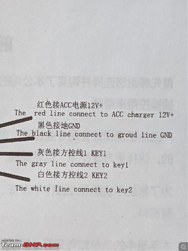

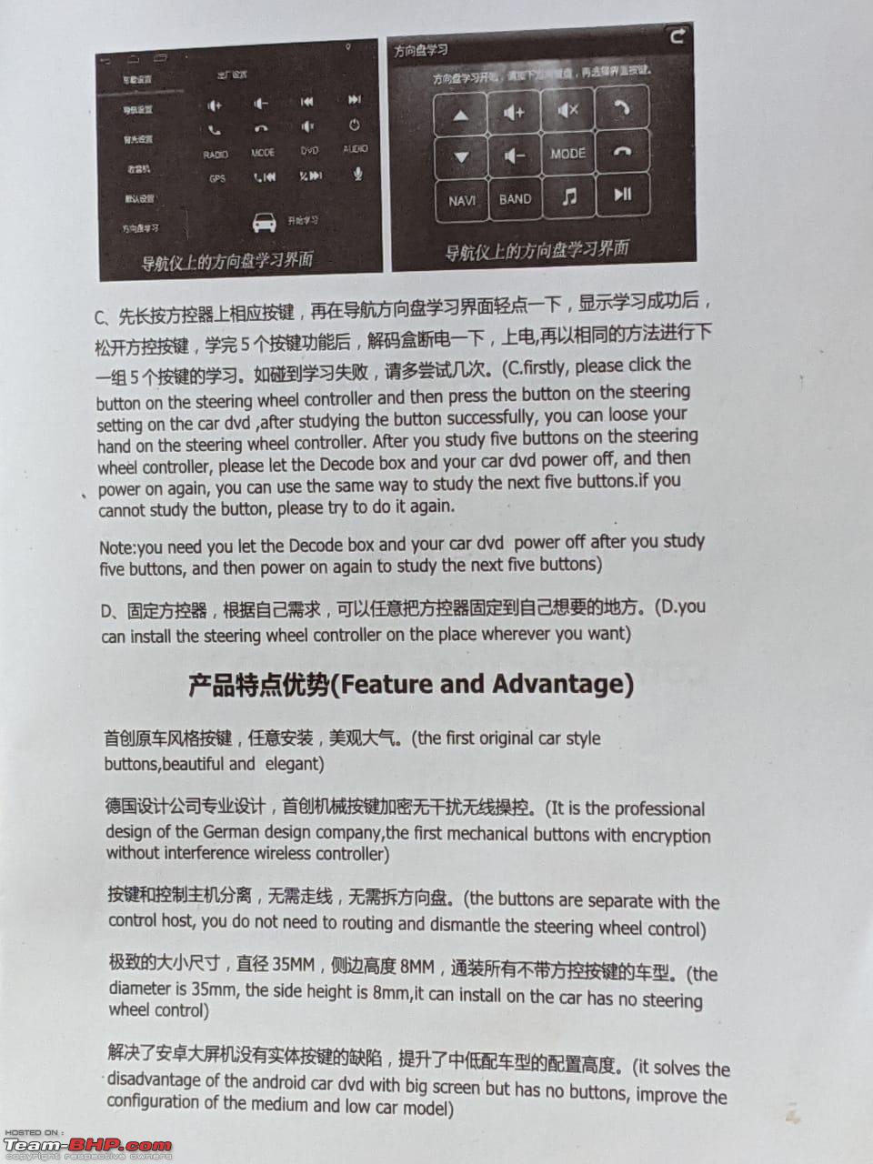

Originally Posted by greenhorn (Post 5323275)
Hey I have the same remote, I was trying to figure out how best to connect it.
The remote comes with a 3 wire (12v, gnd and signal) wires, but my HU has 3 steering control inputs - can you share how you connected it ?
Same in my case, I think I only used 'INPUT 1 & 2' can't remember, below is the manual screenshot.

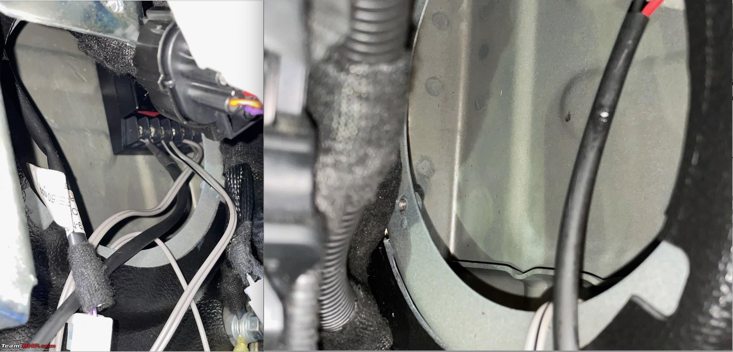

Front Speaker slot is in foot-well, even though access is pain, the slot is well made. It's shallow, can't use deep speaker like STADIUMGTO620, but DB6502 fits like glove. There is even slot which looks just made for component crossover module(see left). Speaker slot actually tunnels and vents into A pillar, sound play is good considering speaker is near the foot.
Uploading missing Front Speaker Slot picture.

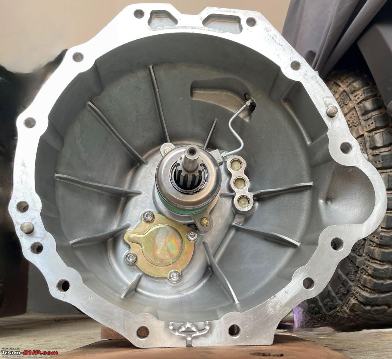

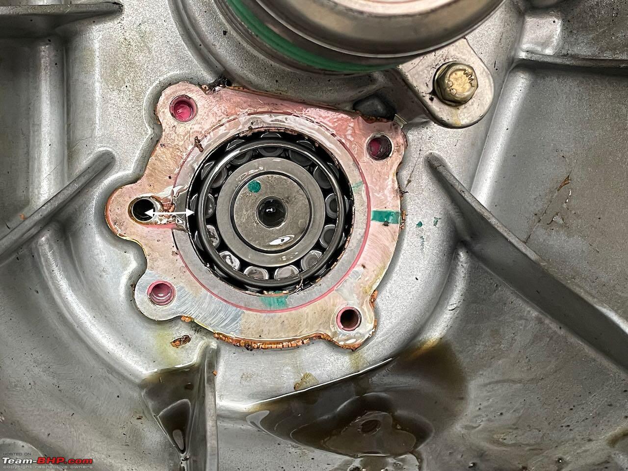

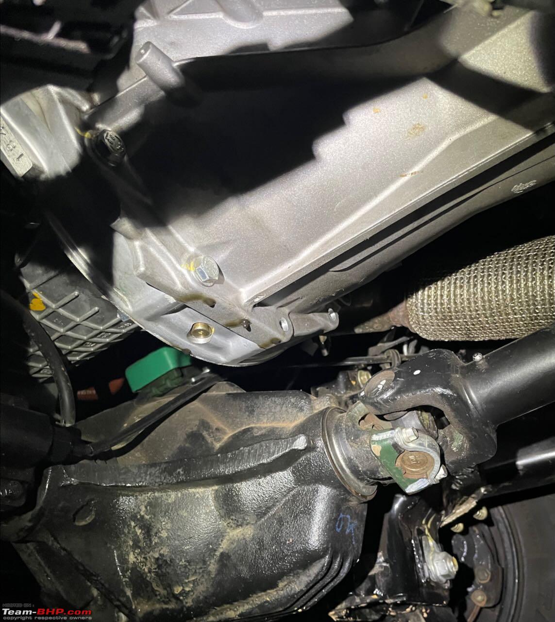

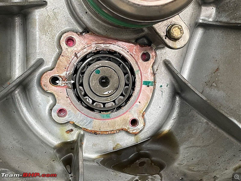

Finally was hit with Gearbox oil leak issue. While returning from road trip on a hill climb clutch started slipping, this I guess is same RPM increase issue reported by some owners. It was not bad only happened in 3rd gear and above at peak torque RPM only if pushed hard. After reaching destination I noticed clutch smell, there was no doubt clutch was cooked. I think I had this slip from day one, after long drives there was some odd smell near bonnet, since it was mild I thought it could be oil from previous leak getting burnt.
This is same issue as what Manuuj reported earlier. In my case initially there was oil leak via breather hose located above gearbox(over filled transfer case). Gearbox was wet with some oil but I ignored it as related to leak from breather hose, since drain hole(Blue Arrow) did not have oil drip. If you want to verify if your Gurkha has same issue, just remove plate marked in green and insert a paper towel.
After loosening the bolts oil started dripping.

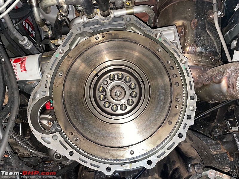

Fly wheel fry, puddle formed by oil leak is picked up by flywheel and circulated to clutch pack.
Clutch Cookie, Cooked pressure and friction plate.
You can see that drain channel needs some porting, channel is too thin and edge is raised a bit, small dirt can block it.

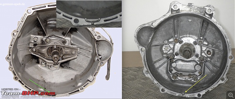

Here is example of 124's GearBox, you can see proper drain channel, which is deep and has raised tongue to prevent oil stagnation like you see in Gurkha (Right side is old straight hole design from W115).
Root cause is loose bolt that is not loose :-), actually bolt is longer by 5mm. Proper fix is to use shorter bolt, parts catalog lists it as M6x20, it should be M6x15.
Looks like Permatex flange sealant is used, which is correct for the purpose but gap should be small. Notice the oil channel(white arrow) partially blocked by excessive sealant. Make sure correct bolt length is used or at least washer is used to correct the excess length, avoid using excessive silicon sealant here.

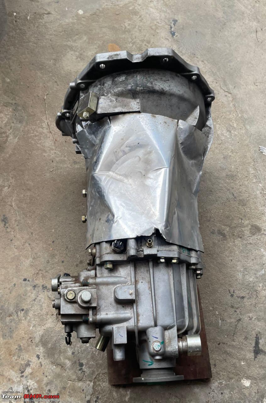

There is sound and heat insulation on gearbox, not sure of its purpose, it is of good quality though, sound damping part inside looked like one used inside door panels on EU cars.

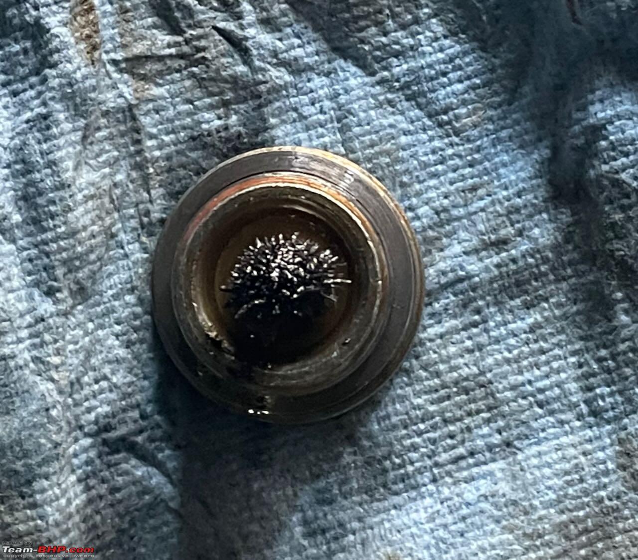

All drain bolts on Gurkha have magnet
Insulation had some damage and collected lot of dirt, so removed it and cleaned the gearbox.
New Clutch plates: Clutch plates were replaced under warranty, the release bearing boot had a cut and had collected oil, so that was replaced as well.
Fly wheel cleaned and clutch assembled.
Cross member on which Gear box is mounted had to be removed, cleaned and painted it as well. GB mount forms a cup(green arrow), it collects dirt and water so drilled a hole for easy cleaning.
Ready for assembly, did some porting so that oil does not stagnate, didn't make channel deep, was not sure if shallow channel was on purpose for off-road use. Anyway next time you see any oil wetting in this area, GB has to be pulled. After assembly shifted TC into neutral and dry ran the GB for 10 min shuffling between gears.

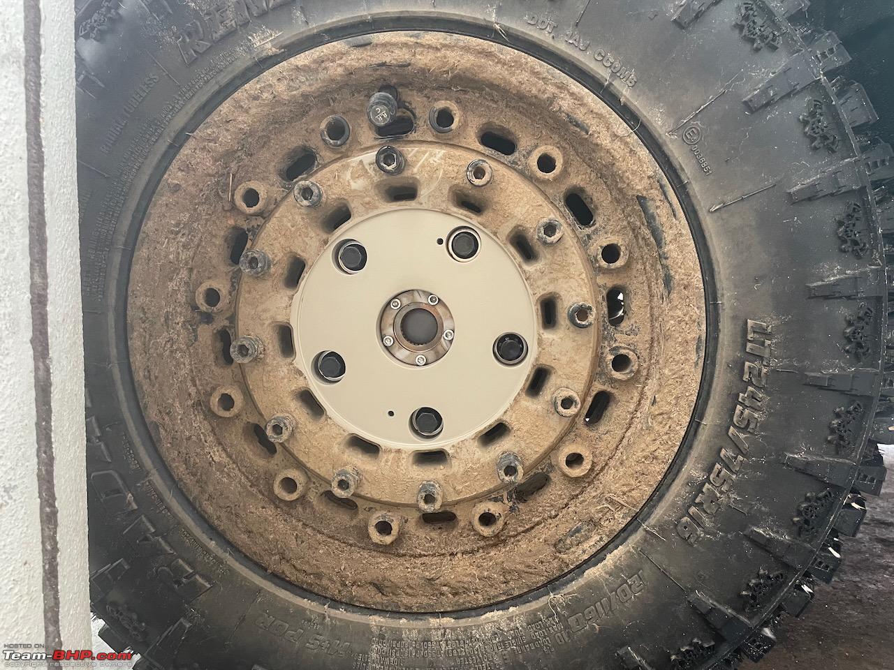

Rear Wheel Carrier Bolts: These bolts need periodic inspection for rough usage, was lucky to catch it when I saw wetting around axle joint.
Symptom: None

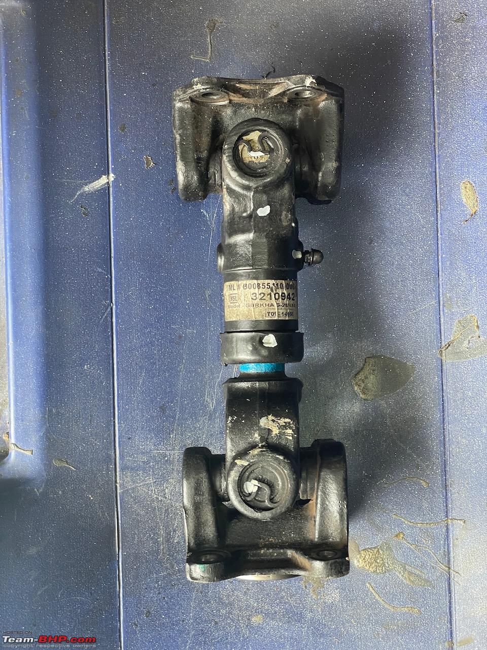

Propeller Shaft: Transmission to transfer case, these too need periodic inspection.
Symptom: Metal Clanking noise when hard shifting or lugging.

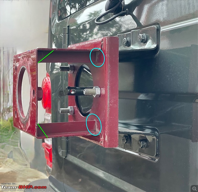

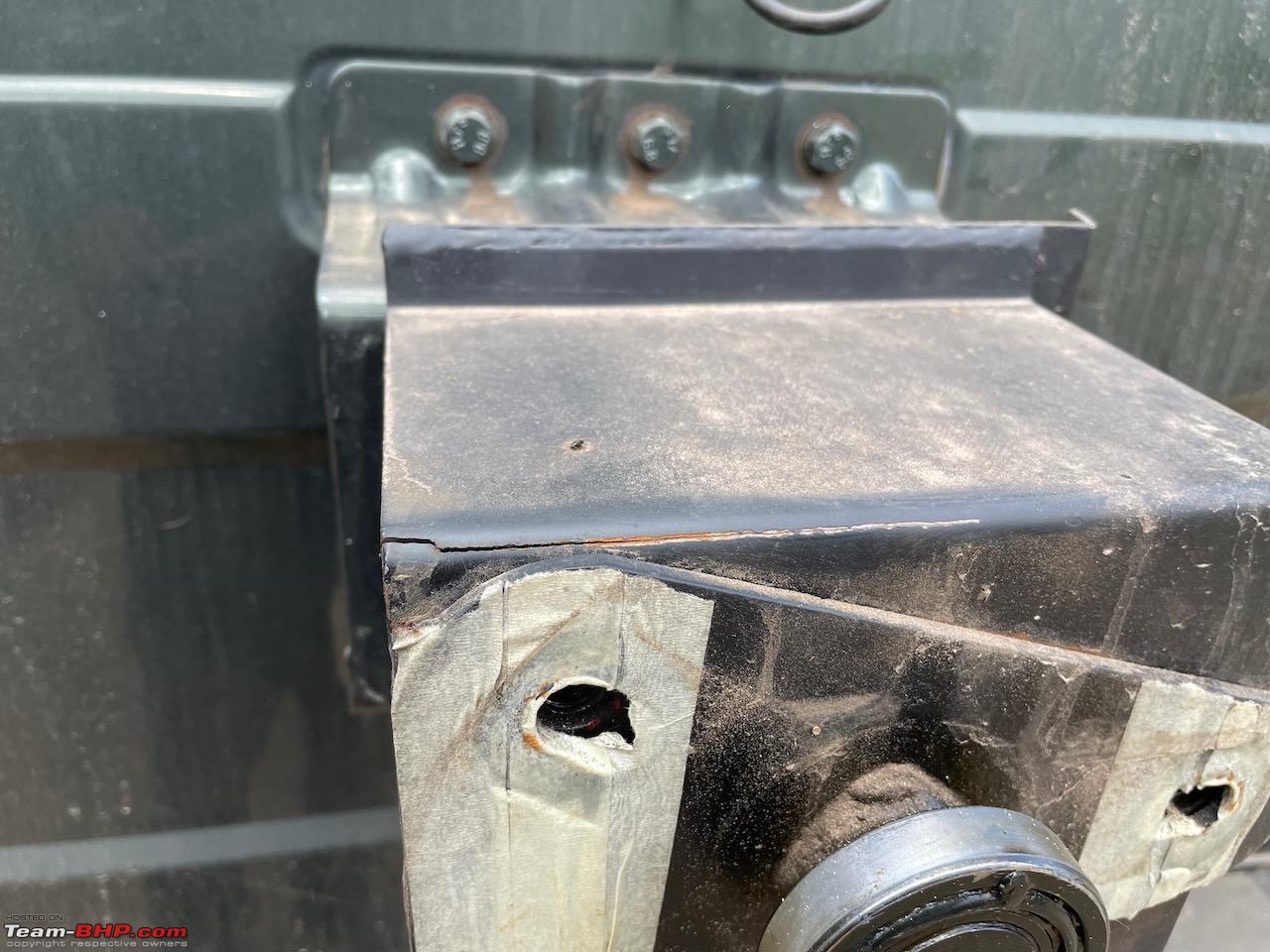

Spare Wheel Mount: Spare wheel mount had cracked, this is stock mount used for stock alloys. I just modified center bore to match my wheels. If you are using heavy tires and drive on rough roads then keep a watch. Mount itself is well made but it has reinforcement on only one side.
Symptoms: Creaking noise from rear door on rough roads
Fix: Welded the crack and added triangle web reinforcement on all corners to prevent the spread.
Cracked clamp
Mount Design: Marked in blue circle is stock reinforcement which is present on one side, its excluded on other side(crack location) to accommodate mounting bolts. Green line shows the triangle reinforcement I added.
Wheel Mount Take 2

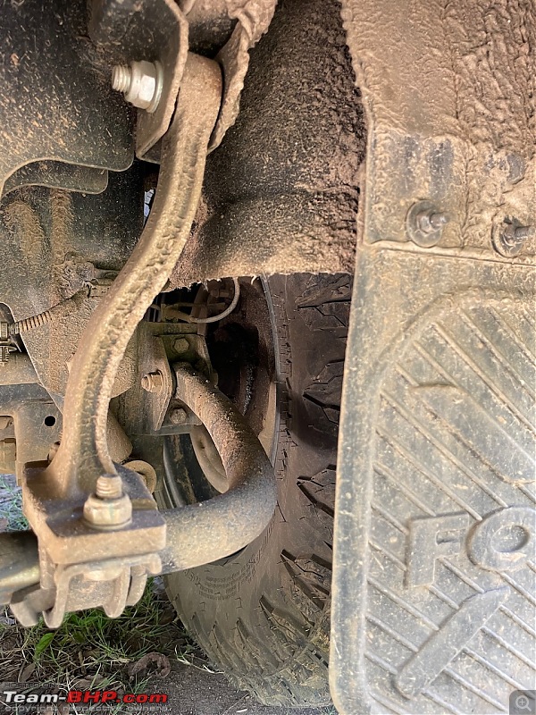

Rear stabilizer bushing: Once you get hang of Gurkha's steering and know where the weight is, you can sweep it like a hatch on smooth corners. Keeping this heavy cage planted takes it toll on stabilizer bushing.

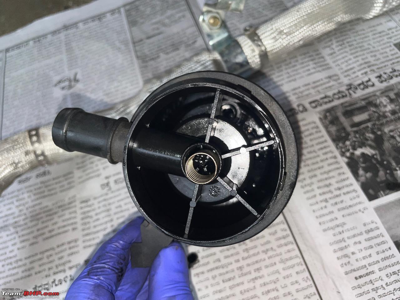

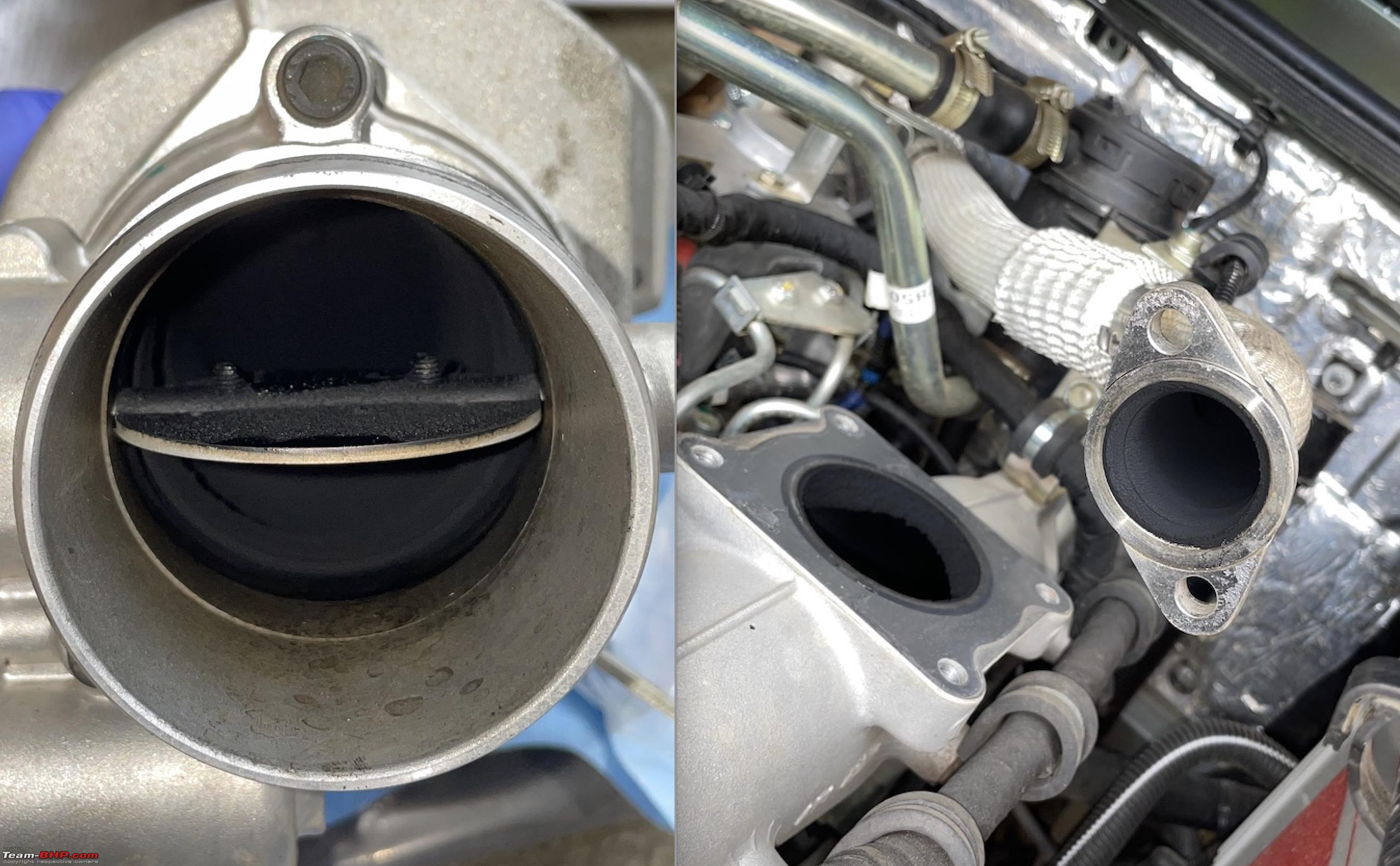

Occasionally when driven in stop go traffic idle RPM would stick at 1000 RPM instead of 750-800 till next restart. I suspected air leak so peaked under-hood to find there was oil leak in turbo circuit.

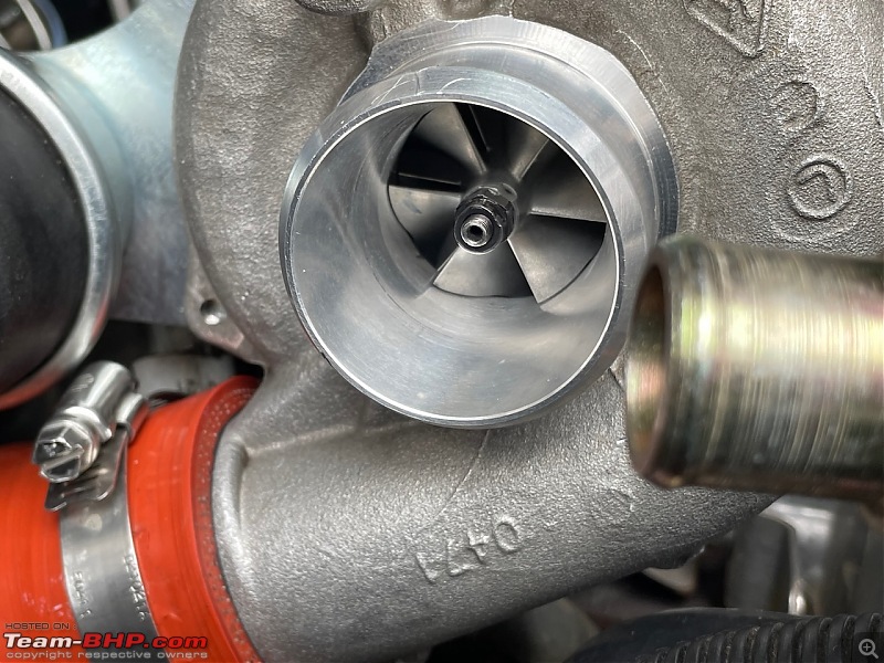

Initially thought it could be turbo, but after opening I saw it was from catch can.
Root Cause: I filled 7 Ltrs oil during oil change, it sat bit high in dip stick marking. I have changed oil and kept oil level lower than dip stick max marking, for now I am keeping a watch to see how it goes.
Fix: Most of the oil was in turbo and inter-cooler, removed and cleaned whole intake circuit.
Sooth in Throttle Body & Intake: Not much oil made into throttle body, sooth in intake and throttle body was from EGR, I guess it's good to clean this every 10K.

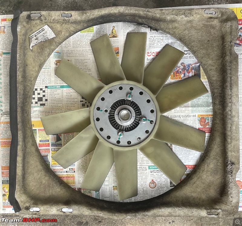

Fan Clutch: Shroud build is poor with cracks here and there.

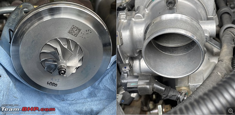

Cleaned Intake: Cleaned throttle body, connector and EGR pipe.
Cleaned Tubro & Throttle body:
All Done

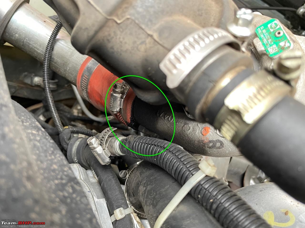

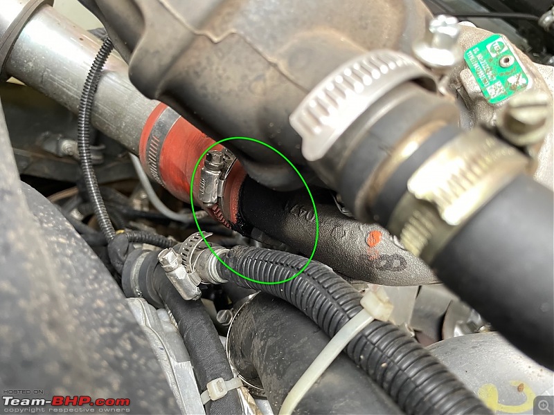

Note: Pipe from Turbo outlet to inter-cooler is bit sensitive to length.
I had pushed it 10-15mm more on inter-cooler side, and there was air leak at hose connected to turbo outlet at full boost.
On trial run was pulling in 4th gear and suddenly Gurkha lost power, it started knocking badly and it was not drivable, check engine light came on.
I keep Veepeak OBDCheck in car, plugged it and ran a scan, error code returned was P0299.
Connector hose was popping out a bit on bottom side only on boost, it was fine with no load(parked), so I could not find the leak.
With no option except for towing, tried unplugging the Map sensor and car was drivable, kept it under 2000 RPM and reached home.
I think if you are stuck in remote area with turbo issues, above can be used as workaround.
