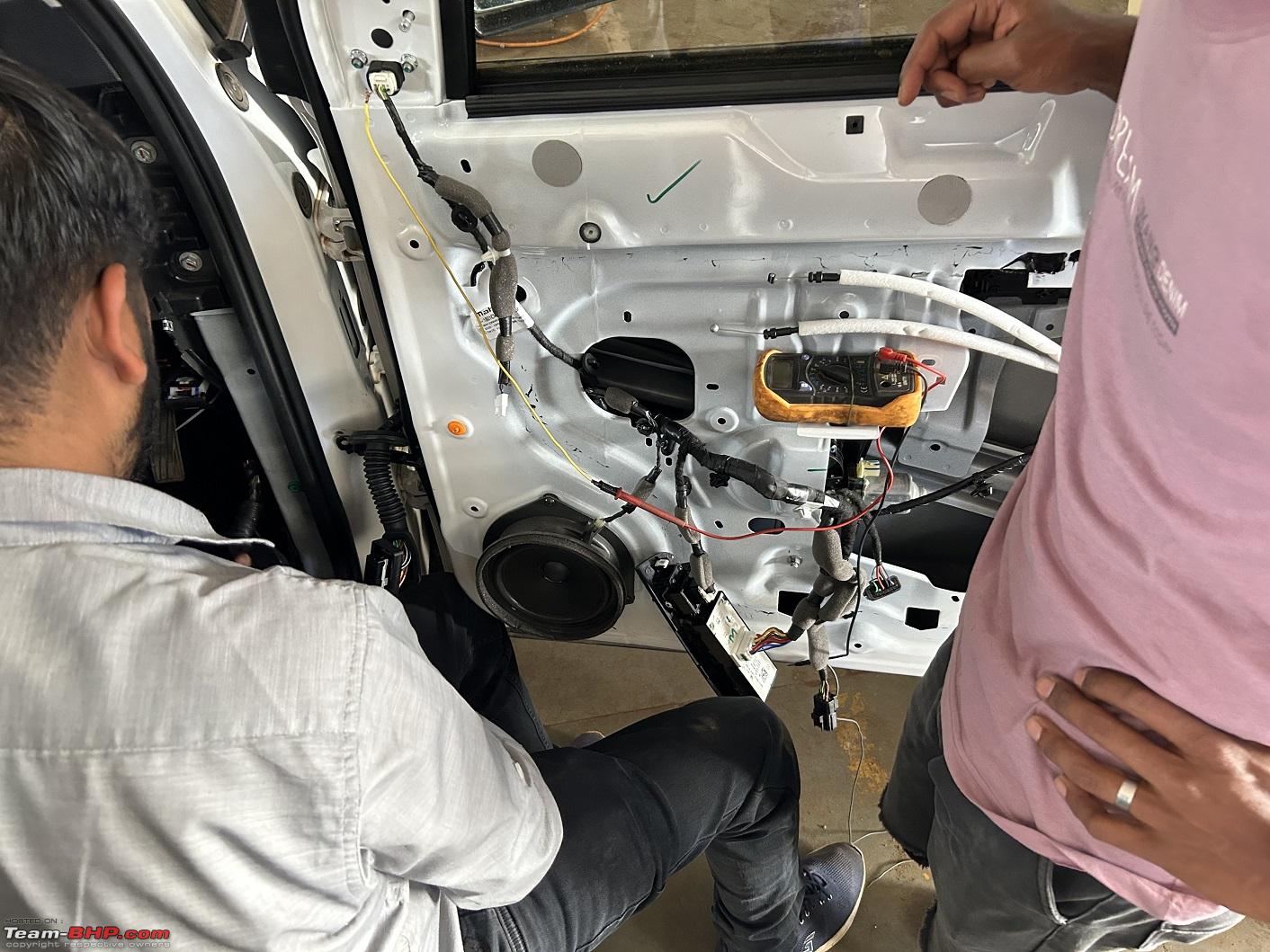

They started with the ORVM work while I made myself comfortable in the customer lounge. Both front doorpads were removed and the harnesses were replaced, but the auto-folding didn't work. The Co-Tek came over and pored through all options in his laptop but couldn't find any for enabling this. Finally, they did some extra wiring work and added a relay to the setup, and it started working. Smoothly, like a charm!

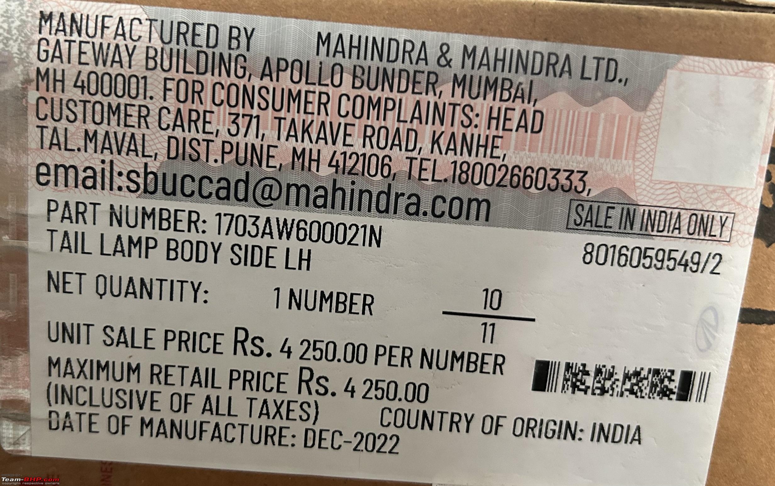

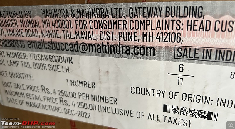

At 3:45 PM in the afternoon, other boys came over and replaced the rear tail lights. All four sections of the tail lamps were replaced and we all said hello to - the new rear sequential indicating tail lamp blinkers!
Finally, a long wait of more than 8 months came to an end. Thank you, Mahindra!

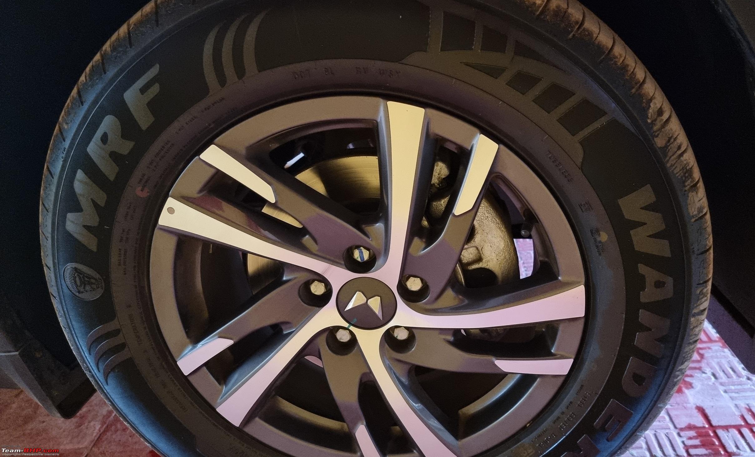

They started on the TPMS installation next. Wheels came off one by one as they were re-fitted by the tyre sensors and filled with nitrogen, before fitting them back into their respective wheel wells. I asked for a sensor for the spare tyre also. The TPMS had been enabled in the morning itself via laptop - it was just a question of completing the sensors' learning process now. Unfortunately, while the rear two tyre sensors learned pretty quickly, the front two tyre sensors plus the spare tyre sensor couldn't learn till it was closing time, even after a short run through the roads outside the service center. So that had to be kept aside as a pending job, together with the AdrenoX software update.

ORVM work begins.

Tyre removed for sensor installation and nitrogen filling.

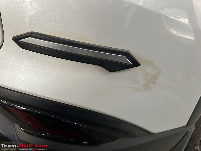

Got the extra glue of the corner protectors removed by a rubbing compound.
Surprised to see a paint chip!
All tyre sensors fitted.
Learning process, unfortunately, was incomplete. Next time!
Part numbers of all 4 tail light sections - two on the boot lid and two on the body.
