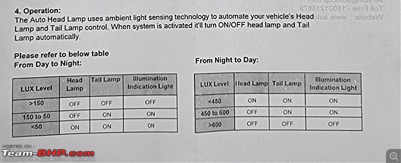

The procedure to enable Auto Headlamps via the OEM accessory kit is simple, as long as you find the two couplers (one for the feature, other for the power supply) behind the dashboard easily and quickly!
When they are not found/well-hidden from view despite continuous, desperate efforts, this is all that happens:-
Part number and price details of the Automatic Headlamps kit.

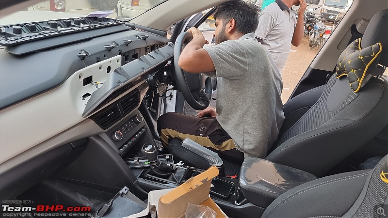

The Flights of Icarus | Our Mahindra XUV700 AX5 Diesel MT-20220514_131501.jpg
The lower plastic cover of the steering assembly, duly removed.
Dated 21st March 2022.
The Flights of Icarus | Our Mahindra XUV700 AX5 Diesel MT-20220514_155856.jpg
One whole hour of searching after removing the front right AC vent too and no cables found.
Guy decides to dismantle the top parts and look directly behind the dash!
The Flights of Icarus | Our Mahindra XUV700 AX5 Diesel MT-20220514_160244.jpg
The two tops of the display cover come off.
The Flights of Icarus | Our Mahindra XUV700 AX5 Diesel MT-20220514_160510.jpg
And, the display comes off too! Previously held in place by 8 screws.
The Flights of Icarus | Our Mahindra XUV700 AX5 Diesel MT-20220514_160723.jpg
How it all looks from the driver's side. Heart in mouth!
The Flights of Icarus | Our Mahindra XUV700 AX5 Diesel MT-20220514_160845.jpg
Central beam's VIN number matches some other XUV7OO,
manufactured on the same date from the same Assembly Line.
The Flights of Icarus | Our Mahindra XUV700 AX5 Diesel MT-20220514_162203.jpg
Finally, the first bunch of cables are found. And what a find those are!
Almost all of the AX7's features are here, disabled and well hidden.
The Flights of Icarus | Our Mahindra XUV700 AX5 Diesel MT-20220514_162741.jpg
Power couplers not found for the next hour and half, even with the passenger side's dash portion below dismantled.
Accessory guys give up and a senior tech from the Authorised Service Center is called over to search and identify powered sections under the dash.
The Flights of Icarus | Our Mahindra XUV700 AX5 Diesel MT-20220514_180323.jpg
He finally finds a source to power up the Auto Headlamp sensor touch switch.
The Flights of Icarus | Our Mahindra XUV700 AX5 Diesel MT-20220514_181420.jpg
One more hour of fumbling for the correct connection continues, and in the end this blue wire becomes the final power source.
The Flights of Icarus | Our Mahindra XUV700 AX5 Diesel MT-20220514_192420.jpg
Fitting everything back neatly and in it's place takes another full hour (and in complete darkness, with the torch sections in our cellphones being the only sources of lighting).
All removed screws and packings duly fitted back, including the glovebox which takes nearly half an hour.
Finally, 5 full hours later, the task is completed.
Good things out of the experience - No rattles from the dash/display observed till now, and the Auto Headlamp touch switch works like a charm!
Bad thing out of the experience - Don't let a heart patient be subject to this, ever again! The closest I came to a second heart attack in the span of one year.

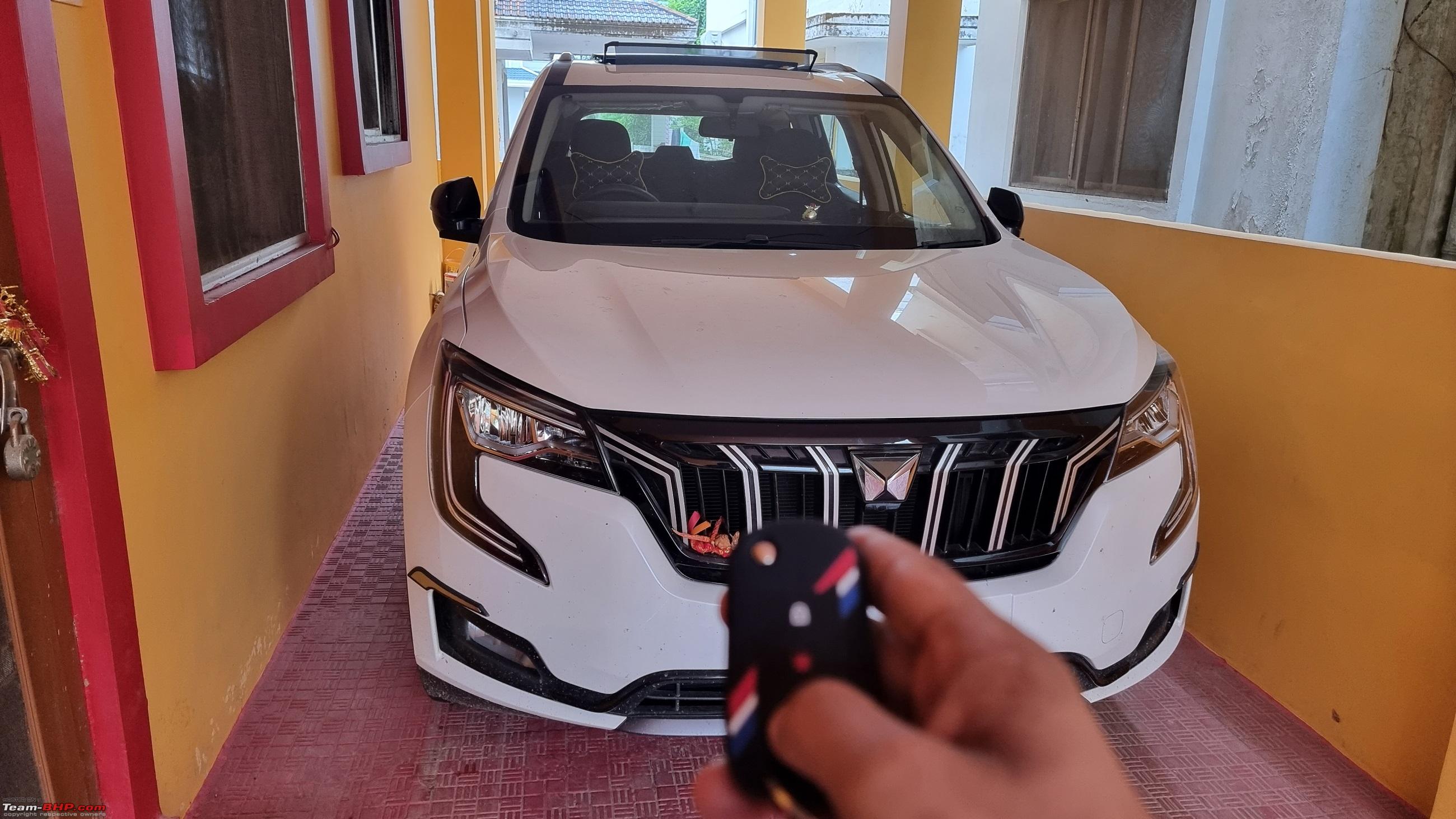

So, in the period where me and Icarus are getting to know each other a lot better, I keep finding new and exciting things about the 7OO, specially in it's AX5 iteration, which makes me a lot happier.
This is one of them:-
Select "Selective Unlocking" in the AdrenoX Setup in the HU, and when you unlock your car the first time, only the driver side and the boot doors are unlocked, with a single blink of the front sequential turn indicators and lighting up + 2 successive blinks of the DRLs.
Press Unlock a second time, the DRLs blink again, and the 3 passenger doors unlock.
This is immensely helpful for situations when you are the sole occupant of your 7OO and you need to toss in some everyday things into the boot while on a trip.
That's not all.
Keep the Unlock button pressed for a few seconds when you unlock your 7OO for the first time, and together with the selective unlocking of the driver door and the boot door, the skyroof also slides back to open fully!
Never thought Mahindra would give this very useful feature in it's mid AX5 variant! Bye bye, hot air inside the cabin when the car is parked under direct sunlight in summers.
Keep the Unlock button pressed.
The Flights of Icarus | Our Mahindra XUV700 AX5 Diesel MT-20220601_145916.jpg
Skyroof opening.
The Flights of Icarus | Our Mahindra XUV700 AX5 Diesel MT-20220601_145952.jpg
Skyroof glass sliding back.
The Flights of Icarus | Our Mahindra XUV700 AX5 Diesel MT-20220601_145956.jpg
Skyroof fully open. Neat!
The Flights of Icarus | Our Mahindra XUV700 AX5 Diesel MT-20220601_150008.jpg
There's more.
Press the Lock button once and the 7OO refuses to lock with 5 continuous angry horn beeps, obviously because the skyroof is open!
In this situation, keep the Lock button pressed for a few seconds and with two swipes of the front sequentials, the 7OO locks itself back with 3 horn beeps and the skyroof slides back shut.
Skyroof glass sliding back inwards.
The Flights of Icarus | Our Mahindra XUV700 AX5 Diesel MT-20220601_150113.jpg
Skyroof closing.
The Flights of Icarus | Our Mahindra XUV700 AX5 Diesel MT-20220601_150120.jpg
Also, press Lock once to lock all the doors of your car with a single swipe of the front sequential turn indicators, then press Lock again to enable the Find-My-Car/Follow-Me-Home feature with the headlamps turning themselves on.
