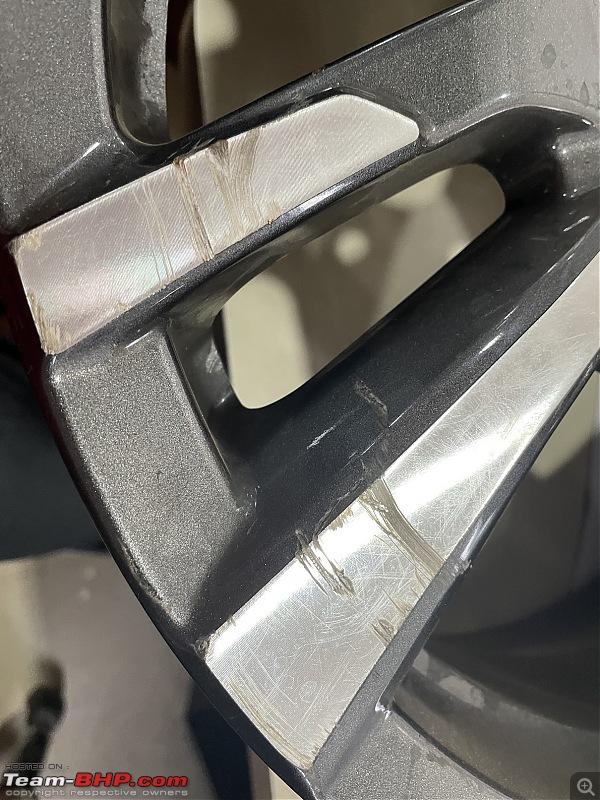

Met the Paramount Automotive Workshop Manager, Tufan, who showed me the alloy which was left in his cabin. I checked it out carefully and closely and found no cracks across the rim anywhere. Just scratches which had spoiled it's original new looks. At the price I had quoted, it seemed like a very good deal. Gave it a thumbs up.
Scratches on the spokes.

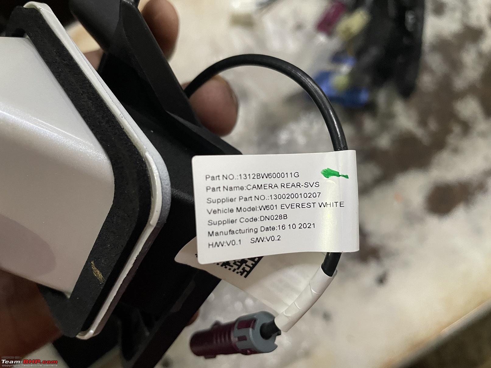

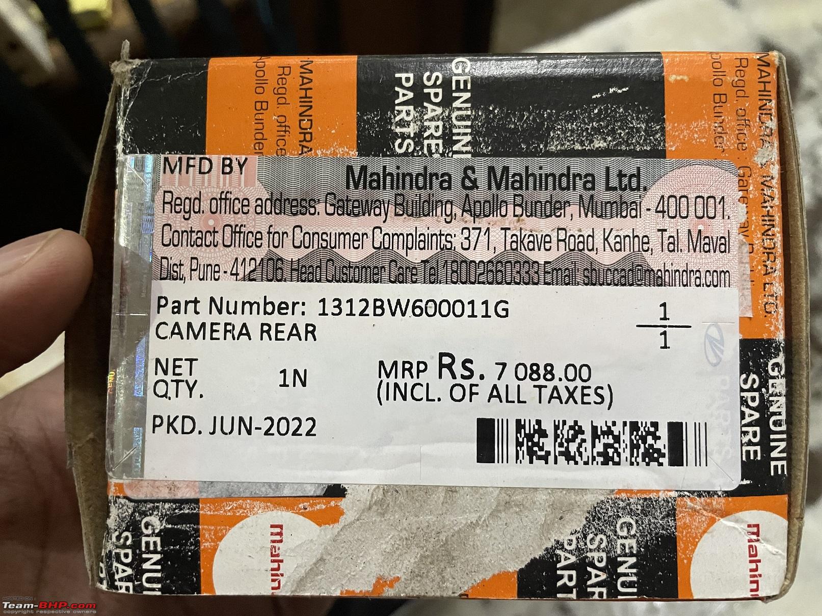

OEM Reverse Camera spare part details.
The camera unit.
Details.

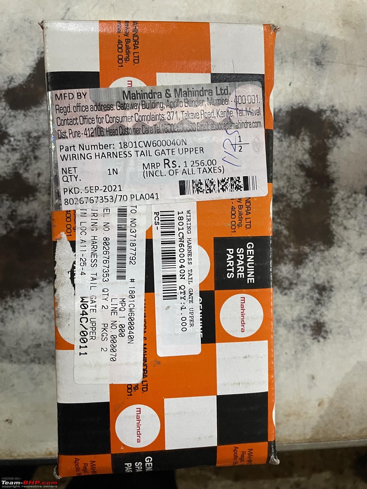

Harness part number.
The wiring harness.
The other harness's details.
Little did we know then that we were in for a surprise and a disappointment. Both.

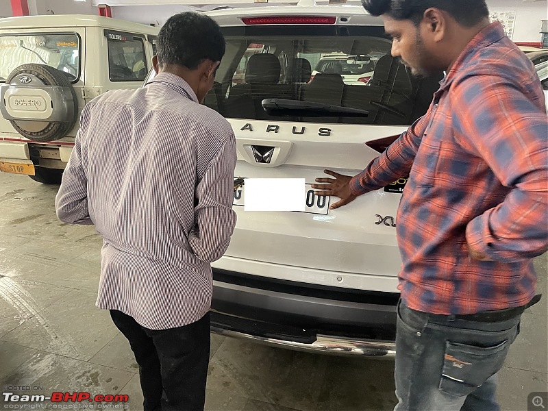

Sonal had sent over two guys with the HSRPs and finally Icarus got his dog tags fitted on both sides.
HSRPs fitted.

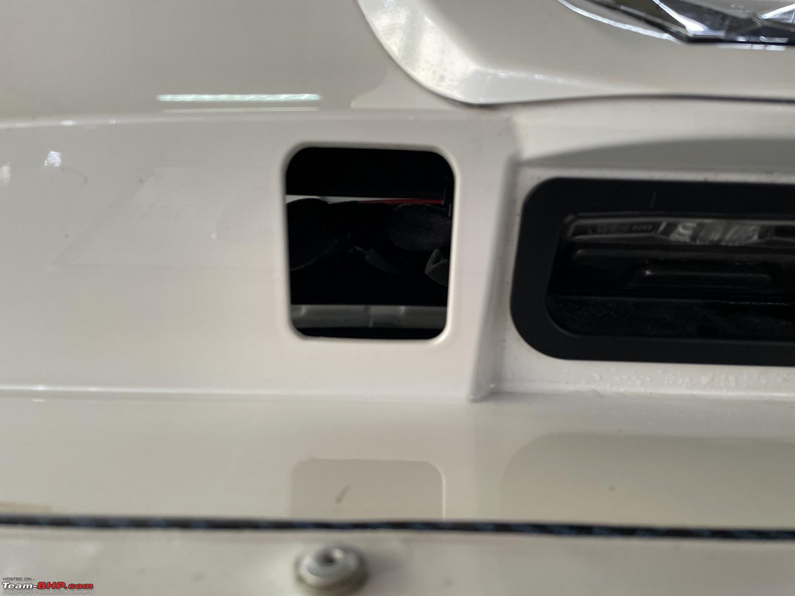

The detachable section now removed beside the rear numberplate housing.
The blank plate where the reverse camera will reside in.

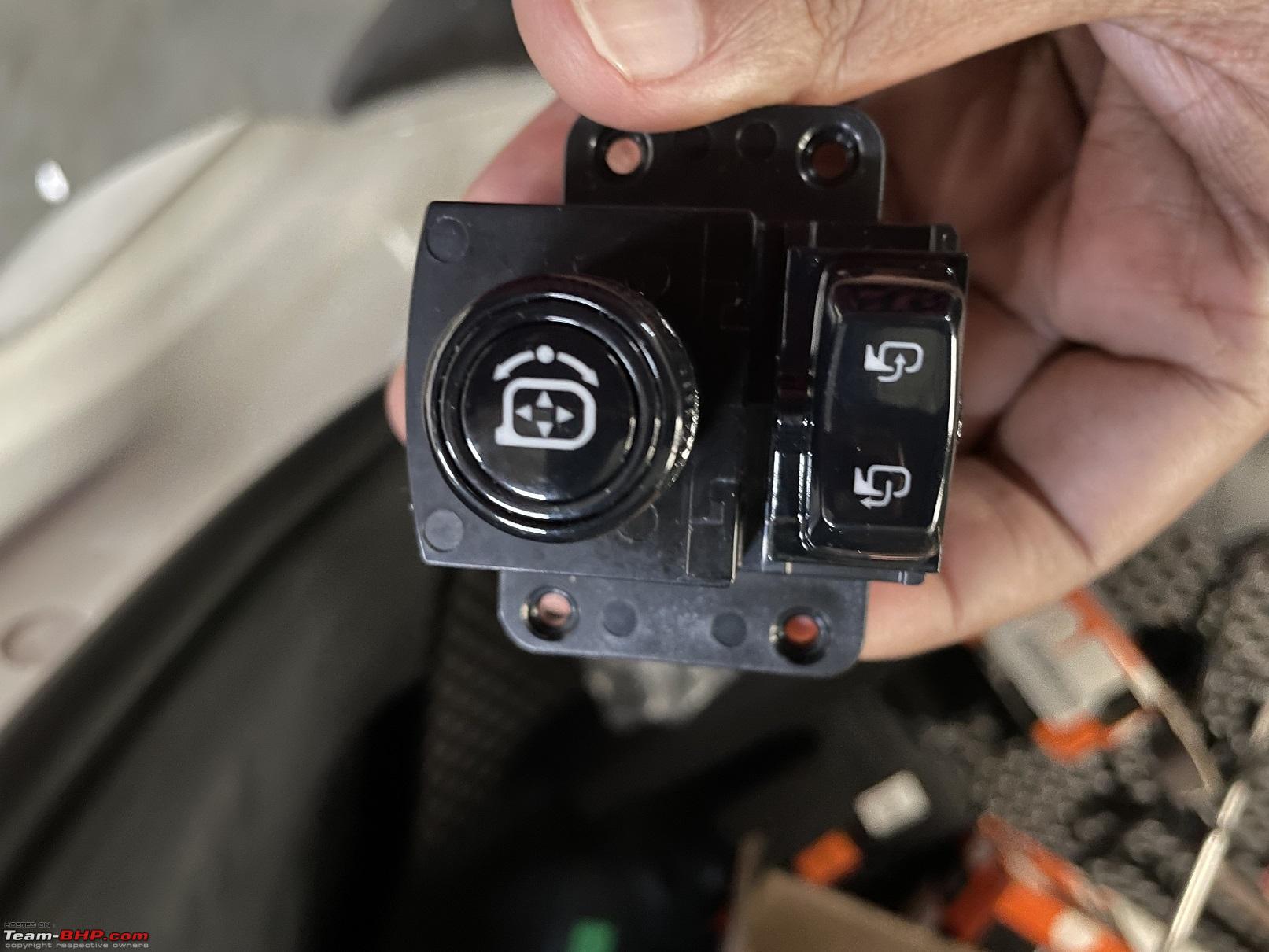

At this point, the power-folding ORVM switch had arrived and Tufan sent the whole set over - the 2 mirrors of either side and the switch itself. Once the packs were opened, I was surprised to see that the ORVMs were equipped with cameras under them, which indicated that they belonged to the AX7L (with the 360-degree Surround view), and not the AX7. The driver-side ORVM was mounted, the switch was fitted but the couplers there didn't match. Ergo, the power-folding button didn't work. But the knob to rotate the glass in all directions inside the ORVM worked perfectly, similar to the earlier one on Icarus.
ORVM part numbers and details.
Power-folding ORVM switch details.
The switch.

This made me think. I went back to the reverse camera and checked it carefully. I told Rizwan that this spare part camera belongs to the AX7L and that's why it wasn't a match for the couplers inside the AX5. Apparently, the 360-degree Surround view 4-camera system of the AX7L had completely different wiring and coupler layout than the AX7 or lower variants. Once this idea hit us, Rizwan, me and Tufan went to access the inventory and check the part numbers again.
Sure enough, the part numbers for the AX7 camera, it's related upper and lower harnesses and wiring, the auto-folding ORVMs and it's switch, all were different from the ones which had arrived. The set which had come belonged to the AX7L, and wasn't compatible with the AX5. No wonder none of them fitted or got enabled!
Remember this:
Part Number for the XUV7OO AX7 in Everest White shade is M1312BW600011N.
Mind you, in the pic it showed the last letter as "G" for Everest White. Not sure what coding changed in-between and why.
This is why the shipped OEM part had a different last letter - it belongs to the AX7L. The one for the AX7 has "N" as it's last letter, not "G".
Once this realisation dawned on Tufan, he looked sheepishly at me. He said he would order the actual AX7 parts on Monday first thing in the morning.

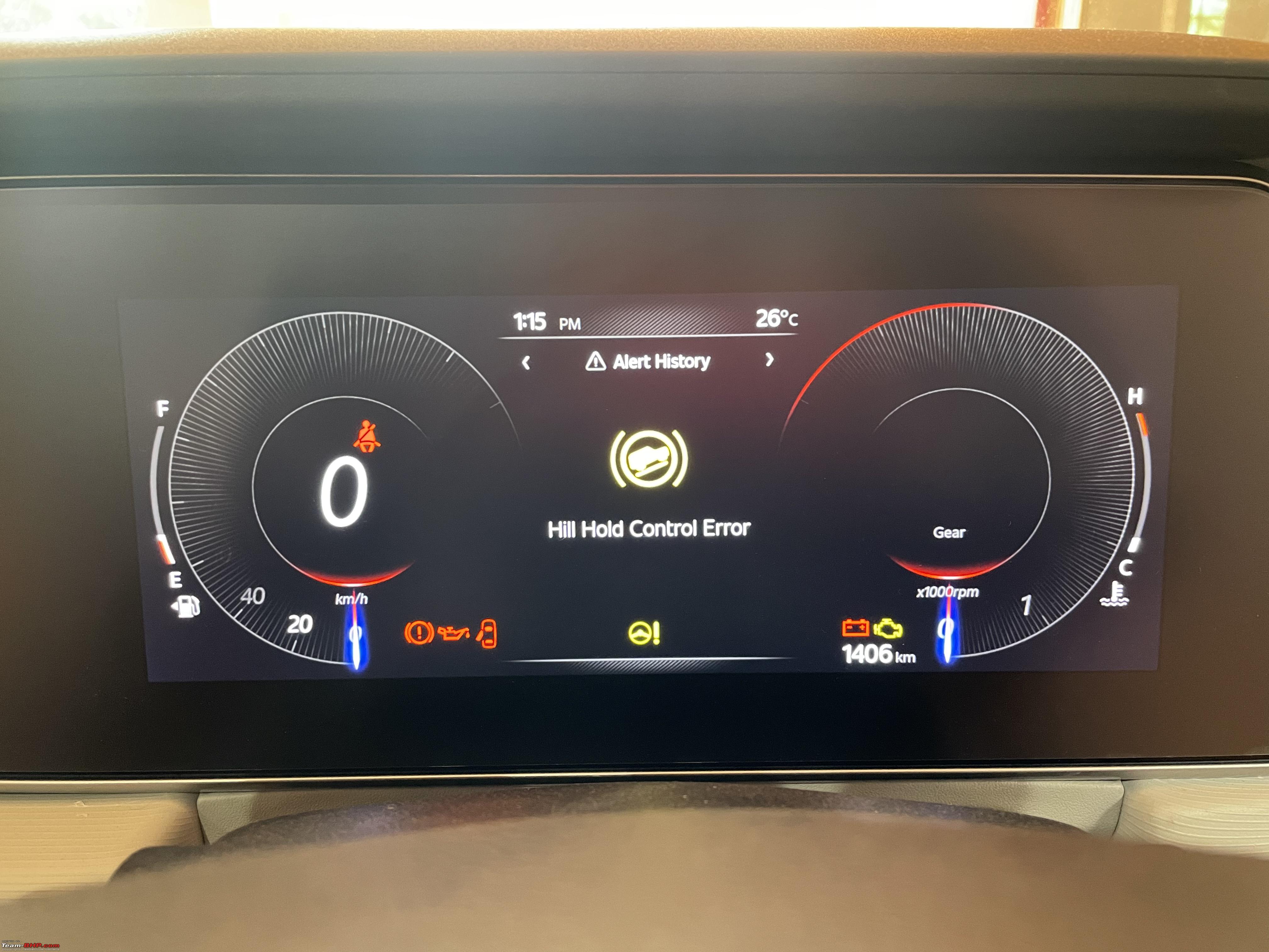

About time I had it too - the now infamous "Hill Hold Control Error" alert.
Unlocked Icarus in the morning and opened the driver's door and as soon as I slid into the seat, there was some jarring noise and a thud from the speakers while the startup screens booted up very slowly. The opening animation of the 7OO racing across both screens was not displayed. Instead it went directly to the Drive Info menu display after the twin dials booted up. I had the Fuel Info menu enabled last.
And then, this popped up:-
The Flights of Icarus | Our Mahindra XUV700 AX5 Diesel MT-8beedd4f41464ca582c02b204fa19a67.jpeg
Turned off the ignition and turned it on back again and was greeted with the same alert yet again. Enabling and disabling the Traction Control System or the Hill Descent Control via their respective buttons on the right side of the steering didn't make it go away.
This is the current software version:-
The Flights of Icarus | Our Mahindra XUV700 AX5 Diesel MT-19847a3ad06c4f0fbc6bb7d84c6c9e1d.jpeg
Only the reverse camera display was activated via laptop on Saturday, so I am pretty sure the software wasn't updated. Called up the service manager and asked him to get this clarified from the tech.
Could be an OTA update caught in the middle, or the AdrenoX software being glitchy? We shall find out soon.

The HHC error came on my car, and that too, on the first day when a friend stalled the car in 3rd gear. It went away after the car was restarted.

Yesterday went by with all sorts of suggestions from the two service centers I was in touch with all day regarding the infamous "Hill Hold Control Error" alert which popped up in Icarus's MID - Paramount in Jeypore & the local Balaji Motors. Some of them were completely mind-boggling and only managed to raise my alarms further, until I checked with my friends in the TORC (Tribe of Royal Cheetahs) Telegram group & our Team-BHP official review of the XUV7OO and calmed myself.
Sample this - ABS sensor acting up, rat bites, faulty sensors in front wheels, upgrade in progress, front wheels hit somewhere during my journeys, reverse camera display shouldn't have been enabled, battery drainage, HDC module faulty, TCS module faulty, modules need replacement, sensors need replacement, mandatory software update required, silver box needs to be replaced, vehicle to be towed - you name it, the service center listed it. They even cited low tyre pressure as one of the possible reasons!
In the end, all it took was a long pause after shutting down from when the error had popped up and turning Icarus back on. Back to the dull humming followed by the fast bootup, the 7OO racing across the screens, MID booting right into the Fuel Info menu, "Zap Mode Activated", four boxes lining up from the right in the AdrenoX display, etc.
First thing I did when the bootup was finished was access the Alerts History in the MID. It was blank. No Alerts found, said Icarus to me. Cranked up and he started with a roar and a clatter and settled down nicely.
Much ado about a software glitch?
Big thanks to our official Team-BHP 7OO review thread where I got to know that this is a known software bug in the AdrenoX system. If I wasn't a Team-BHP member, God knows what the service centers would have done to my Icarus to "fix" this "huge problem".

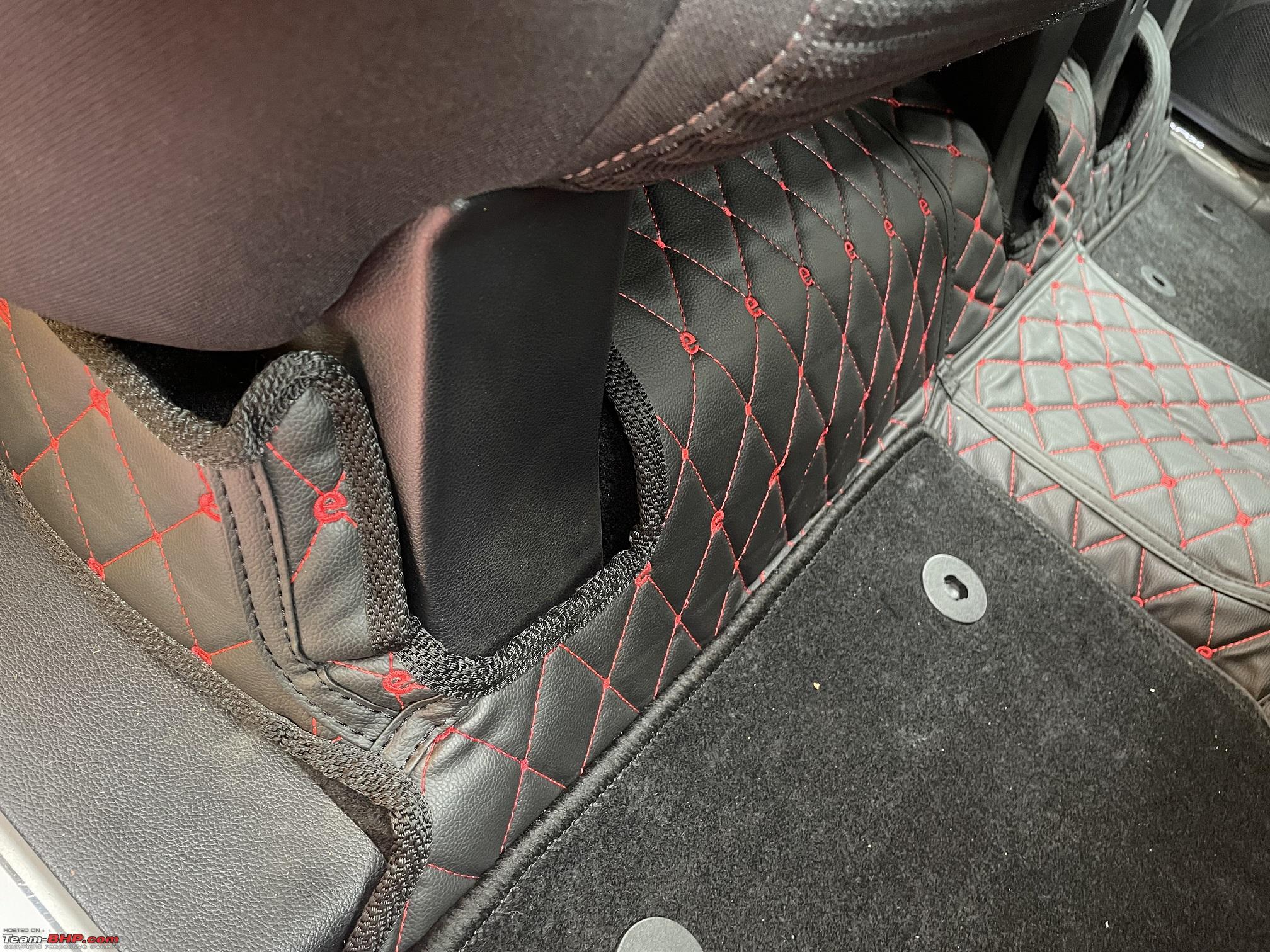

In other news, the Royal 7D mats I had ordered from Elegant India arrived from Dehradun yesterday. Made for the XUV7OO 7-seater, these premium mats have 2 layers - a PVC soft-touch, diamond-quilt pattern base & a detachable carpet mat on top. It comes with a free door mat too. Cost me Rs 6,000/- and looks absolutely fab!
Details.
The base unwrapped.
Driver side with the carpet mat fixed on top.
Passenger side.
Stretches all the way to the top.
Second row.
Snug fit.
Wraparound on both sides.

I too started getting it only after 1st service, I never faced it in the first 1000km. I've faced it 3 times so far and each time my ADAS settings and info display preference got reset. It's definitely a bug that Mahindra needs fixing. I see that you're on an older software version but this bug exists even on the new v8.01.41.
The tech with the laptop insisted that the new v8 is only for those who are facing blank screen and HU freezup issues. It's not issued for those who are having AdrenoX systems working normally. I am guessing there is a cutoff for the VINs who are listed for this software update and since Icarus was manufactured in the last week of March 2022, it's not listed in their schedules.
I also thought it might be a virus which got carried over from the tech's laptop into Icarus's AdrenoX systems. First time I faced this and right after the first service.
Anyway, all's well that ends well.

The tech with the laptop insisted that the new v8 is only for those who are facing blank screen and HU freezup issues....since Icarus was manufactured in the last week of March 2022, it's not listed in their schedules.
That's strange, I was facing 0 issues before and mine is an April '22 manufactured vehicle. The technician during my first service simply said there's a new software update and nothing much. I did notice some minor UI changes related to blind spot monitor and the camera interface as well so it's definitely not just a bug fix release (most major version increments aren't). Maybe it is limited to AT and/or luxury variant.
About the HHC error, yeah, it goes away after a restart. Another issue I was facing before 1st service (no eSIM network) was also resolved with a restart (albeit requiring battery disconnect for 2 mins). I think when a computer controls most of the advanced tech in the car the first thing you should do to troubleshoot is the same you do with a computer.
