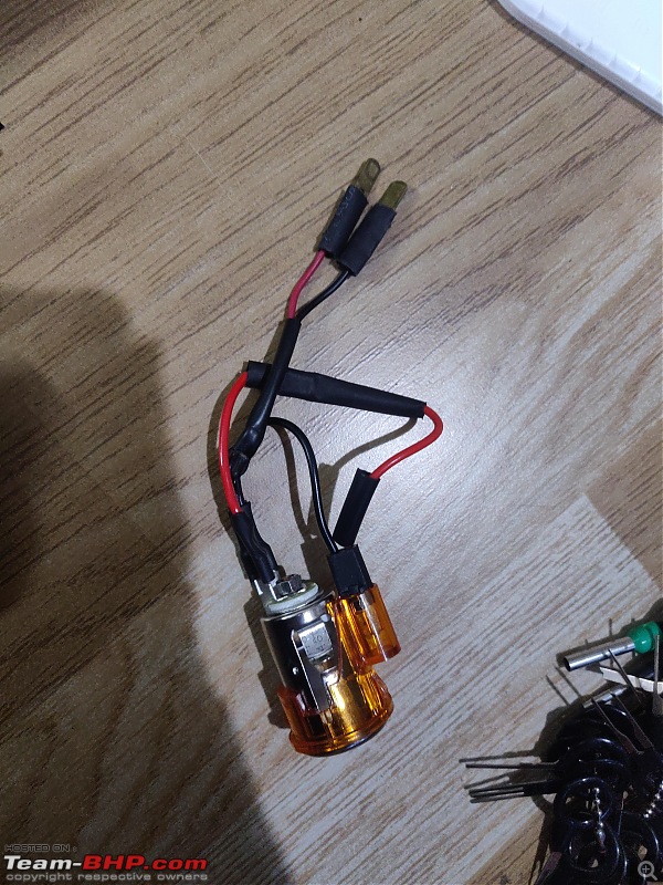

Swift and Dzire ZXi/ZDi variants got the Illuminated 12V Socket from factory. I wasn't aware about this until I spotted it on BHPian ChiranjitP's Swift. On scouting Boodmo, I found the Suzuki 12V Illuminated socket but it is priced at ₹1,831 since its a Suzuki Genuine Part (Imported).
Photo courtesy: Boodmo
Part Number: 39400-75J01
Name: LIGHTER ASSY CIGARETTE
Link
Now, no way was I spending such an amount on a 12V socket. I checked for alternatives on the internet and found two alternatives.
Mahindra's Illuminated 12V socket and Tata's Illuminated 12V Socket
But the issue was the color choice, Mahindra's was green and Tata's was white. Since my car has an orange backlight tone I wanted the socket illumination to match the orange. A close relative was coming from abroad so I scouted AliExpress and got the 12V socket with orange illumination for just ₹200.
Regarding the wiring, I wired it directly to the power such that the socket is always Illuminated when it receives power. I removed the center console trim and removed my old 12V socket and plonked the new one in. It was a perfect fit

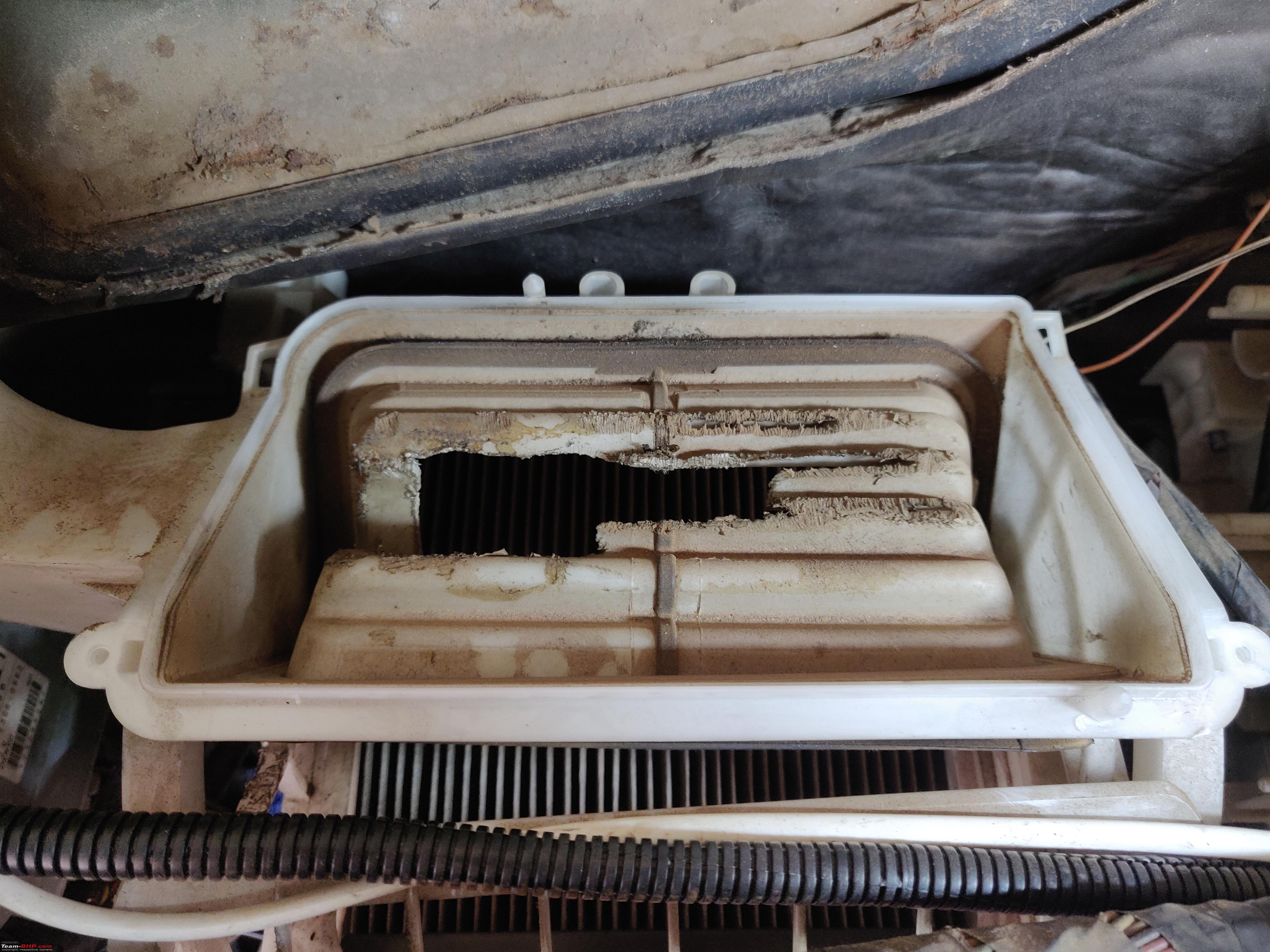

The top of the line swift came with a unique feature which was the Electromagnetic tailgate opener, me having the itch to perform DIYs were never settled and it was long overdue that I try to find a solution to make the Electromagnetic Tailgate opener work perfectly.
One day Dad and I visited the scrapyard to get a few connectors and I spotted a ZXi swift which was a total loss car. The damage was complete to the driver's side. I checked if it had its BCM (Body Control Module) still attached, and to my surprise it was present! Now the main part is that this swift was having the K12M Engine and I was not sure if the BCM will work on my G13B engine. Anyways, I and dad started to remove whatever we wanted from the ZXi and once done, started to bargain on the price. I managed to take its rear door wiring harness, BCM, switches, and connectors. At last, the price was brought down to peanuts thanks to dads bargaining skills.
Now you may ask why swap the BCM?
My existing BCM did not have the circuit for the electromagnetic tailgate opener in it. I tested the BCM using a multi-meter but it proved to be useless as no power output was shown at the tailgate opener pins in the BCM when the car was locked or unlocked. I also wanted to install the Dzire Monitor Clock which displays the ambient temperature sensor and time. My existing BCM again did not have the circuit to take in the temperature sensor readings.
The BCM which I picked up from the scrapyard being a ZXi, I knew it would support the tailgate opener and the Dzire clock mod which I wanted to do.
So I started to study the service manual on what all inputs the BCM takes and gives out to the other components. Swapping the BCM will require the whole dash to be opened and also I wanted to fix a few wires which were attacked by the rat permanently. After a month, I was ready to swap it.
I started making custom wiring harness myself using the wires which I picked up from the ZXi, Referred to the Service manual, and made sure I used the same color-coded wires as I wanted it to be exactly same as the ZXi and in the future, it will be easy for anyone to diagnose. Drew diagrams of the BCM mentioning what pin is to be put where so dad and I could refer to it and get the job done faster.
So on a Sunday, started off at 7 am and managed to remove the whole dashboard in under an hour. We took power from our security room in the parking lot for soldering and illumination.
Kept all the trim pieces safely and there was a surprise waiting for us,
The recirculation flap was EATEN OFF! Now being Sunday MGP was closed so we kept that work pending.

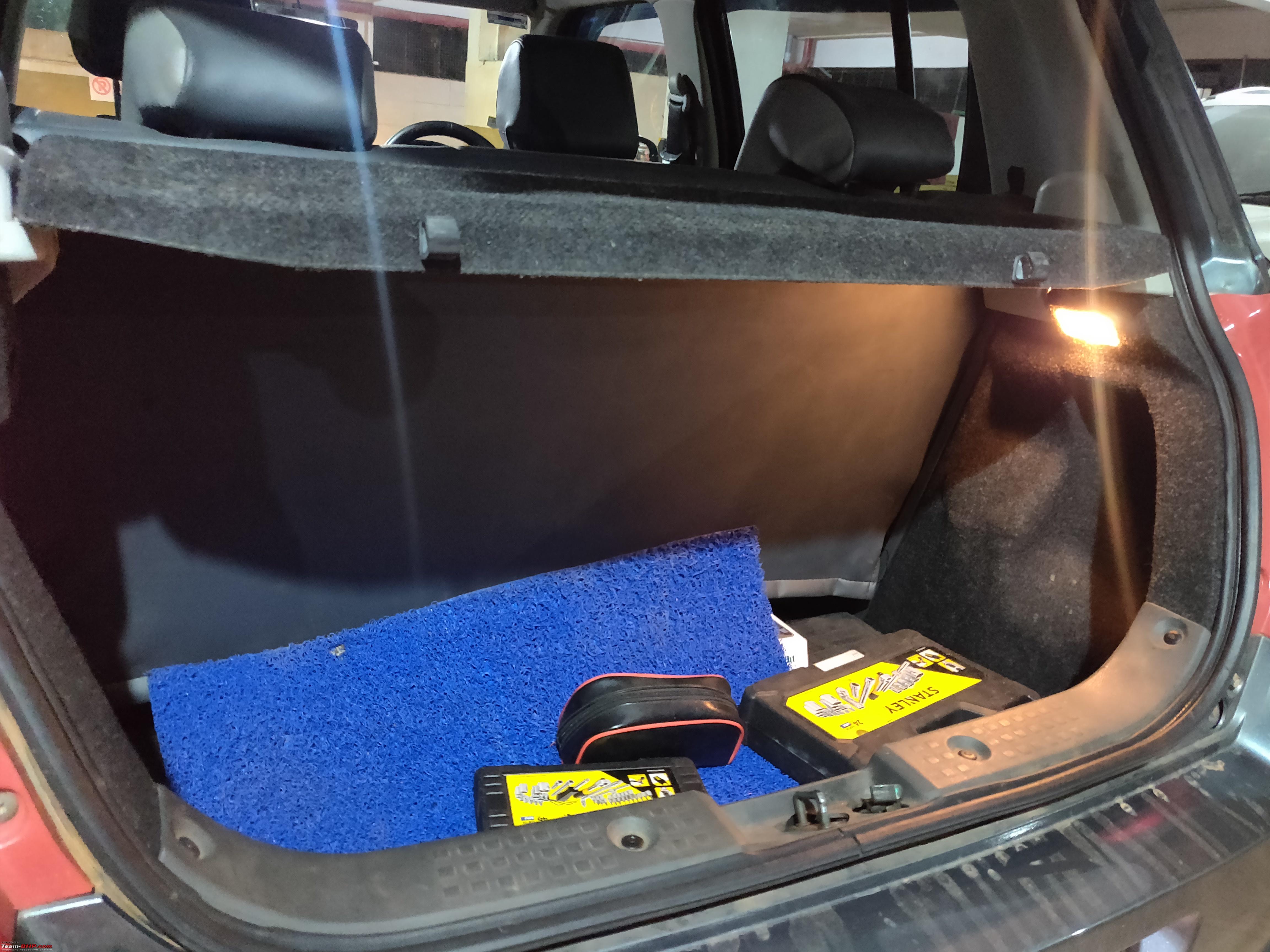

Azure Grey 2006 Maruti-Suzuki Swift VXi | Ownership Review-boot-lamp-wired.jpg
We did not even realize the time fly and it was almost dark. The project couldn't be completed that day due to the non-availability of the recirculation flap. I did not want to open the whole dashboard again just to replace the flap. Eventually, the car had to be grounded because we decided to work on it during weekends, we wanted the job to be done without any time constraint so work continued the next weekend. The Recirculation flap was sourced from Boodmo because MGP said it would take them 10 days to source it.

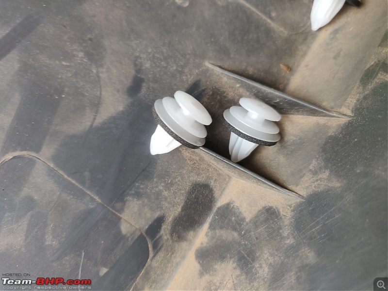

we were much quicker now and I made sure to replace each and every clip of the dashboard to get rid of the freebies made available by Maruti ( RATTLES !!)
used new clips with foam around it similar to Kizashi / S-Cross clips.

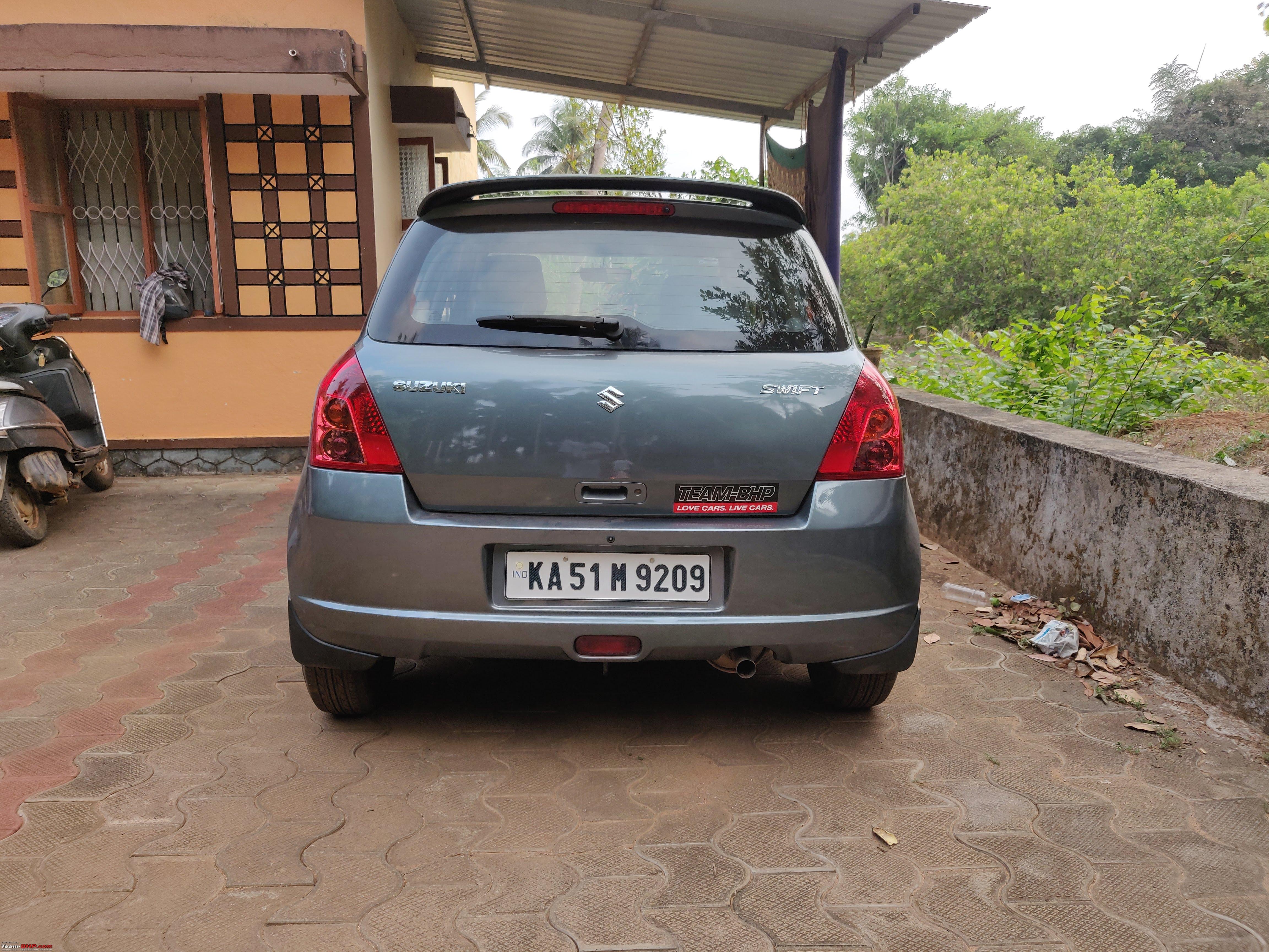

Replaced the Boot latch and the handle to the ZXi

Azure Grey 2006 Maruti-Suzuki Swift VXi | Ownership Review-nightbootlamp.jpg
The Boot lamp illuminates the boot really well, I might think of replacing the halogen bulb with Led in the future.

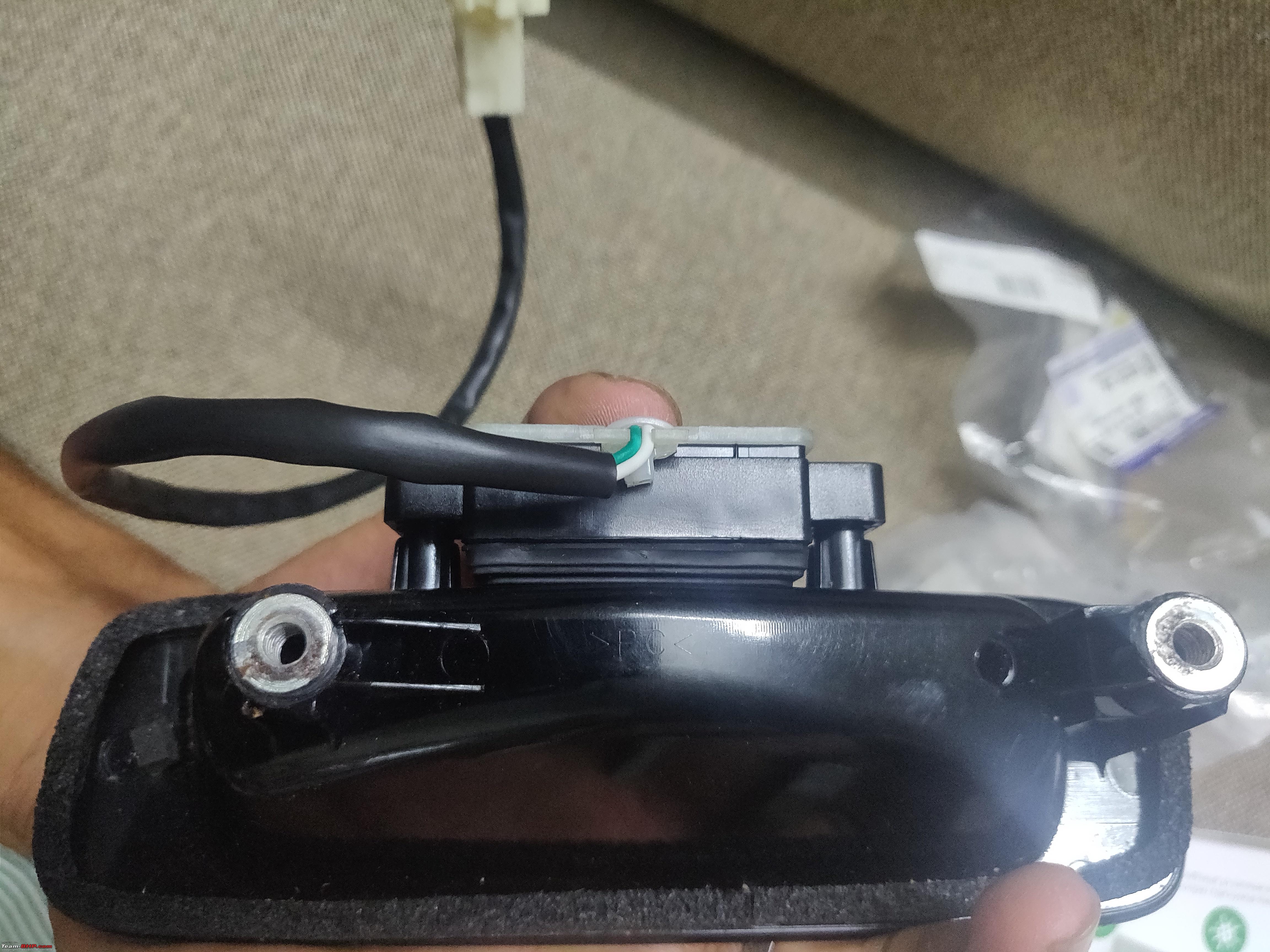

Replacing the Boot opener Switch
The Switch which allows opening the Boot was not in good shape, the rubber had cracked and moreover, I felt it would be better if changed since its exposed to water during washes. Checked Boodmo and found out the part number for the switch.
Part number: 37178M75J00
Price: ₹425
Link: https://boodmo.com/catalog/part-swit..._door-6773985/
Kept browsing Boodmo and I found that even the Second generation Swift Boot switch also looked similar in shape and also the connector looked the same, assumed it would be a direct fit, Moreover, I placed an order for the second-generation Swift because it was priced less at ₹290
Part number: 37178M74L00
Price: ₹290
Link :https://boodmo.com/catalog/part-swit..._door-9775261/
Within 3 days the switch was delivered and I replaced the switch and it was a direct fit even the connector was the exact same .

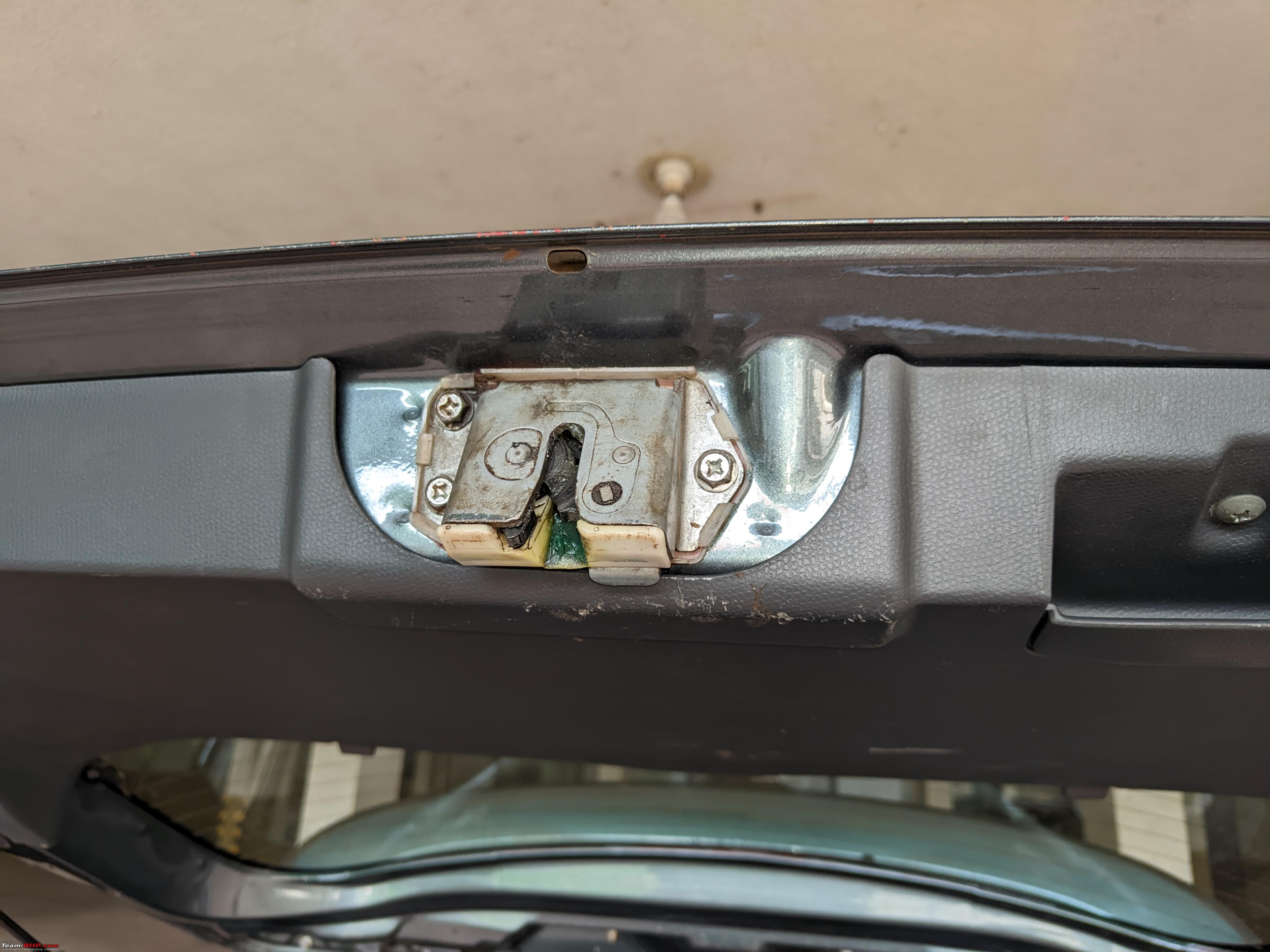

Electromagnetic Tailgate Opener Latch

Replacing the AC Filter
Now that the recirculation flap was fixed, it was about time I replaced the AC filter since the old filter was in a disgusting state. I had already cleaned the AC blower motor last year at my leisure and checked it again and found it clean luckily. Checked Boodmo and ordered a ZIP AC filter.
Part number: ZC-6002
Link:- https://boodmo.com/catalog/part-cabin_filter-6823986/
Old Cabin Filter VS New Cabin Filter

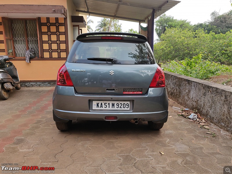

Looks of the car after sticking the Suzuki monogram.

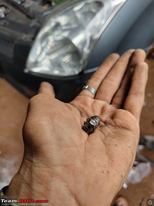

I was scared that if i try too hard, the bleeder nut would break off, which would mean the caliper would have to be taken to the lathe if it has to be removed. I called up my Mechanic who came to assist me happily free of charge
Attachment 2378106
Azure Grey 2006 Maruti-Suzuki Swift VXi | Ownership Review-old-broken-bn.jpg
The Stubborn Bleeder nut
New Sliding Pins
Part number:55850M75J11
Price: ₹150
Link: https://boodmo.com/catalog/part-slid..._set-39763767/
He whacked on the bleeder nut and at last after multiple tries that sucker broke free. I managed to get two new bleeder nuts and also changed and greased the sliding pins of the caliper. Job was done perfectly !! The pedal feel was much better than before and the brake bite too increased since we sanded the glazed brake pads.

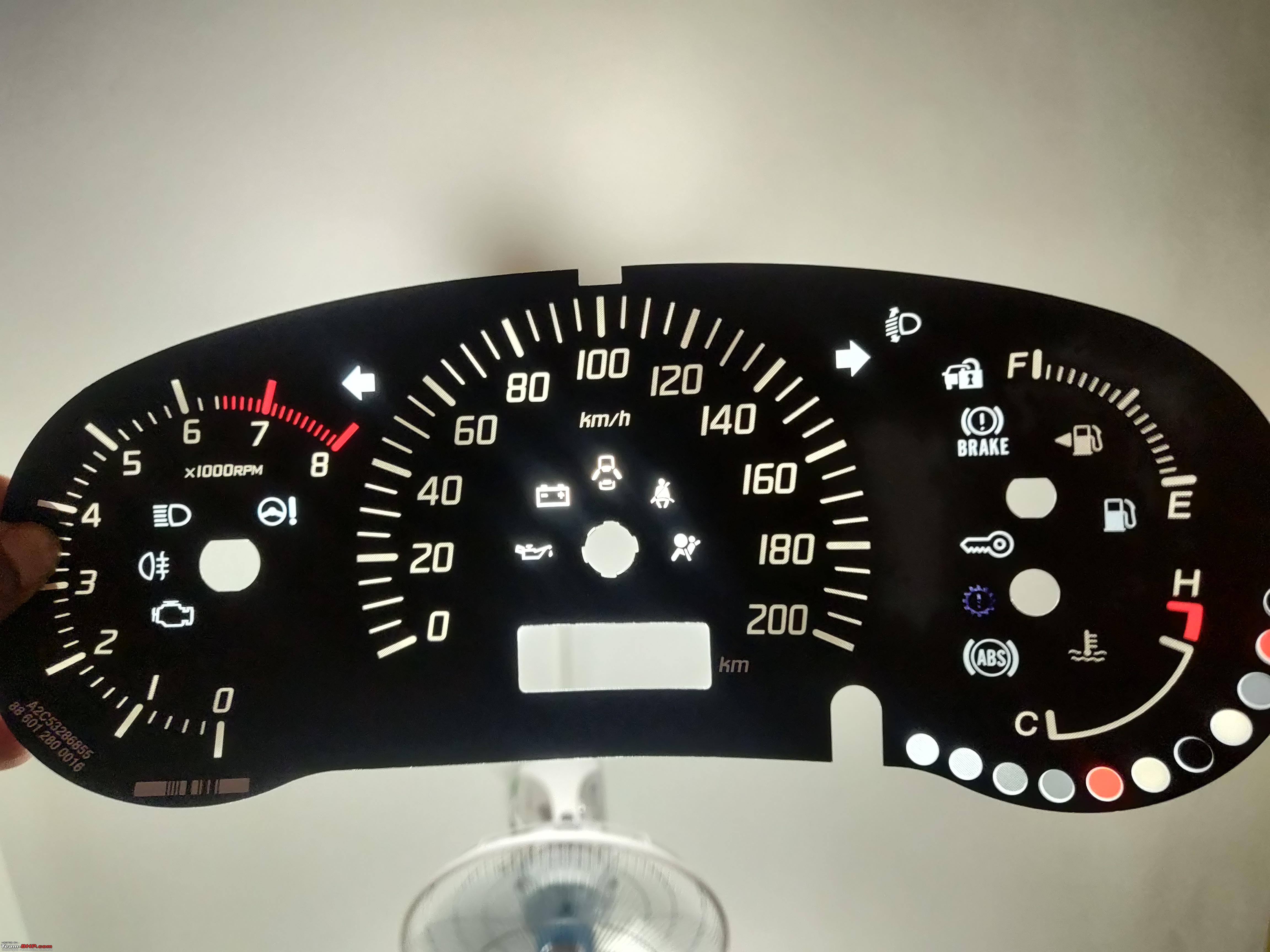

To begin my experiment I managed to get a ZXi Swift Speedometer with its connector from the scrapyard.

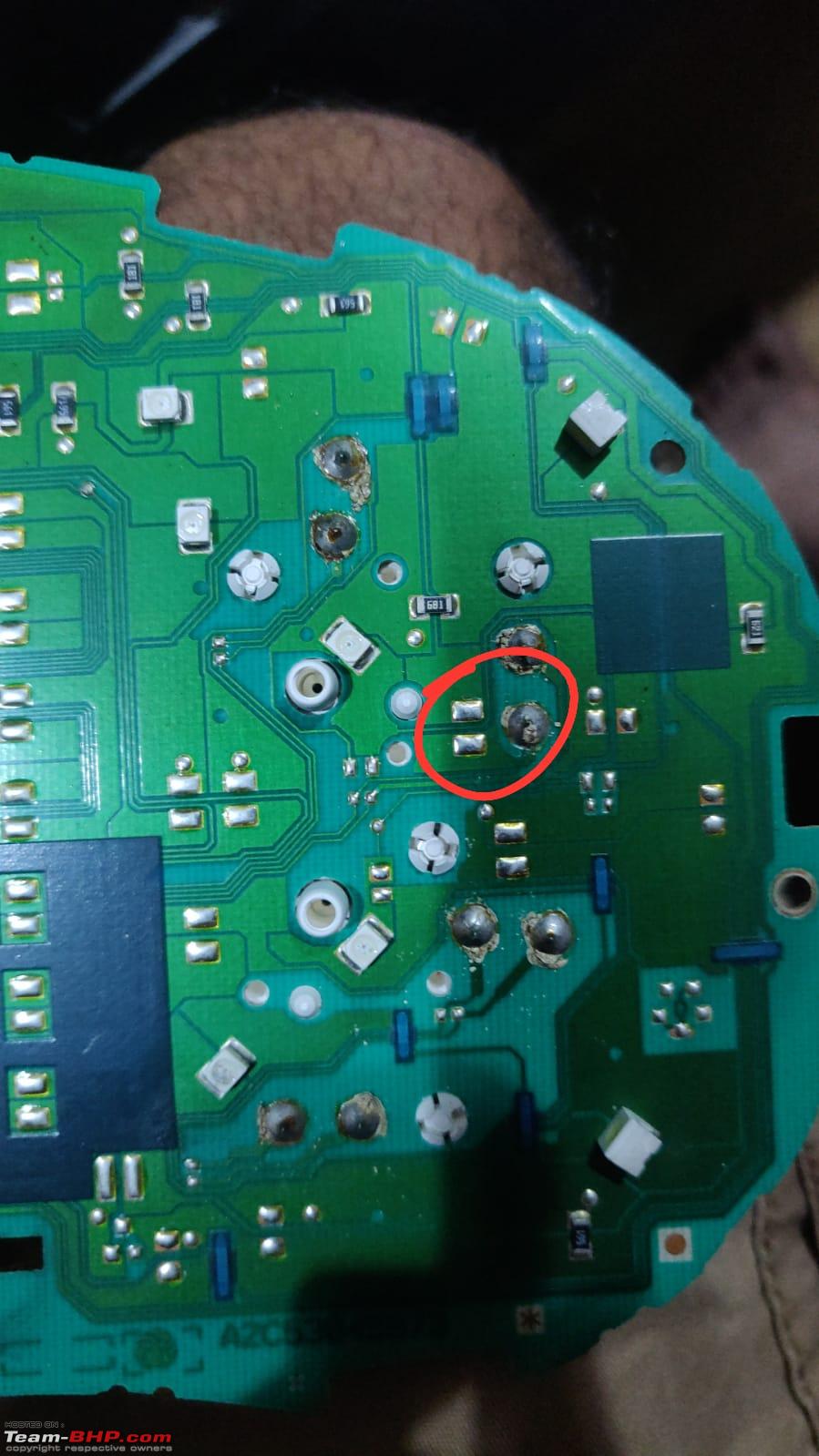

I removed the glass and the needles to see the Circuit Board. I also compared the International Swift Speedometer diagram and Indian Swift Speedometer Diagram and it was the same. I noticed on the Motherboard there was no led light to illuminate the low fuel light symbol.
Azure Grey 2006 Maruti-Suzuki Swift VXi | Ownership Review-img_20220529_191750.jpg
All the Warning Light Symbols available on the Speedometer

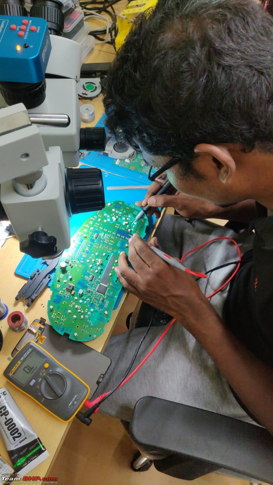

Thought why not take a led and solder it to that point and see if the low fuel light comes on if fuel Gauge is at E?
With the help of my friend who is into electronics, we soldered the led onto the motherboard. Powered up the Speedometer but to our dismay, it did not light up Friend told me to try it on the car with the tank at E. Tested it on my car with tank at almost E but still no Light. After asking few other friends who are into electronics, they mentioned the micro-controller and LED Output driver might not have this feature even though the circuit is present. Sadly due to this the experiment had hit the wall.
How cheap of Maruti to even think about cost cutting with the micro-controller and LED Output driver when the Circuit Board has it supported? Though this is albeit a small requirement, it could have been integrated beautifully as this is the only small difference between the international swift speedometer and Indian Swift speedometers. In the future if I come across a International Swift Speedometer, I might swap the Circuit board.
