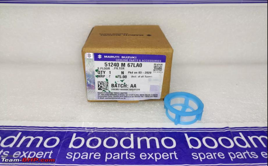

Small Part added from the Maruti Parts Bin !
I noticed in the Glanza that on the brake fluid reservoir there is a small filter to prevent dirt and debris from entering into the reservoir. Scouted on boodmo for this part but was not sure if the sizes are the same. Placed order for it anyways during free delivery.
Part Number: 51240M67LA0
Link:
Price:₹75
Azure Grey 2006 Maruti-Suzuki Swift VXi | Ownership Review-img_20230327_081557536.jpg
Azure Grey 2006 Maruti-Suzuki Swift VXi | Ownership Review-img_20230327_081524184.jpg
Installed it on the swift without any issues, A Direct Fit !

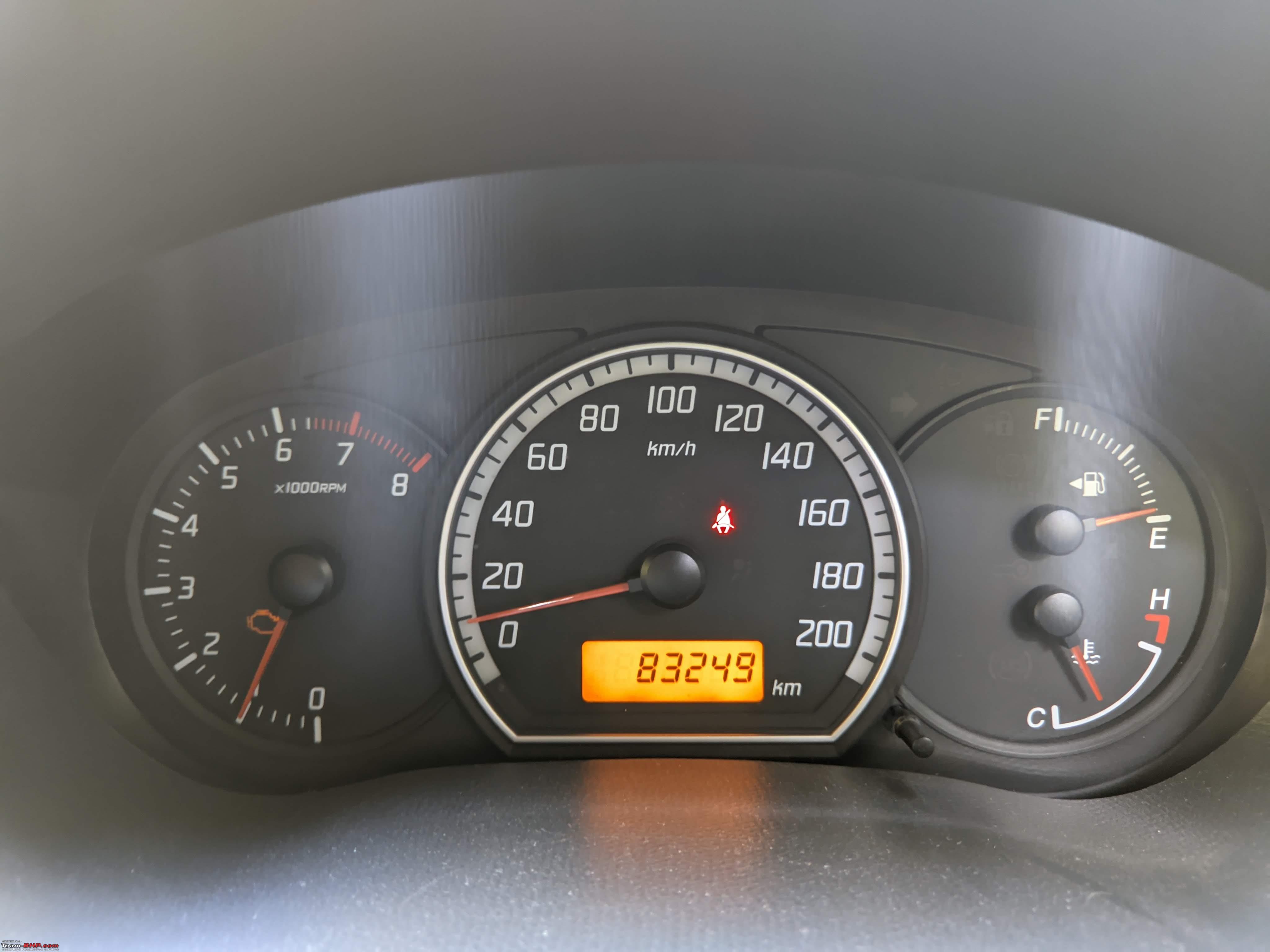

Speedometer Issues
First generation of Swift/Dzire is notorious for having speedometer issues. few of the issues would be
  • continuous clicking of the dials when the car is put to ignition
  • Slight glowing Check-Engine Light even with engine off
  • Faulty Temperature Gauge
I Myself have seen atleast 6 Swifts/Dzires with the above issues. My car is no exception. I'm facing the Slight glowing Check-Engine Light issue, It glows slightly at ALL TIMES. Took it to MASS and they straight up told to replace the Speedometer. I also noticed it was mentioned in the service history about this issue.

Another issue which is face once in a blue moon is the temperature gauge acts weirdly. It goes upto the H mark and then stays there.
Azure Grey 2006 Maruti-Suzuki Swift VXi | Ownership Review-img_20211019_132907.jpg
When I turn off the car it rests at the Half mark, If it turn the ignition on again, it stutters and comes all the way down to the C mark and then goes back up to the engines true temperature reading. Weird !
Azure Grey 2006 Maruti-Suzuki Swift VXi | Ownership Review-pxl_20220917_140856381.jpg
Notice both the issues mentioned above in this photo
Anyways I've managed to make peace with it since it hasn't created a very big issue so I've left it as it is.

You need to get to the root of this issue Ashton. The temperature gauge is a vital instrument and cannot be left to behave as it pleases. This is as good as running the car without a console. It looks to be a signal/supply issue. Please have the dry points soldered and the coupler pins cleaned/ checked.

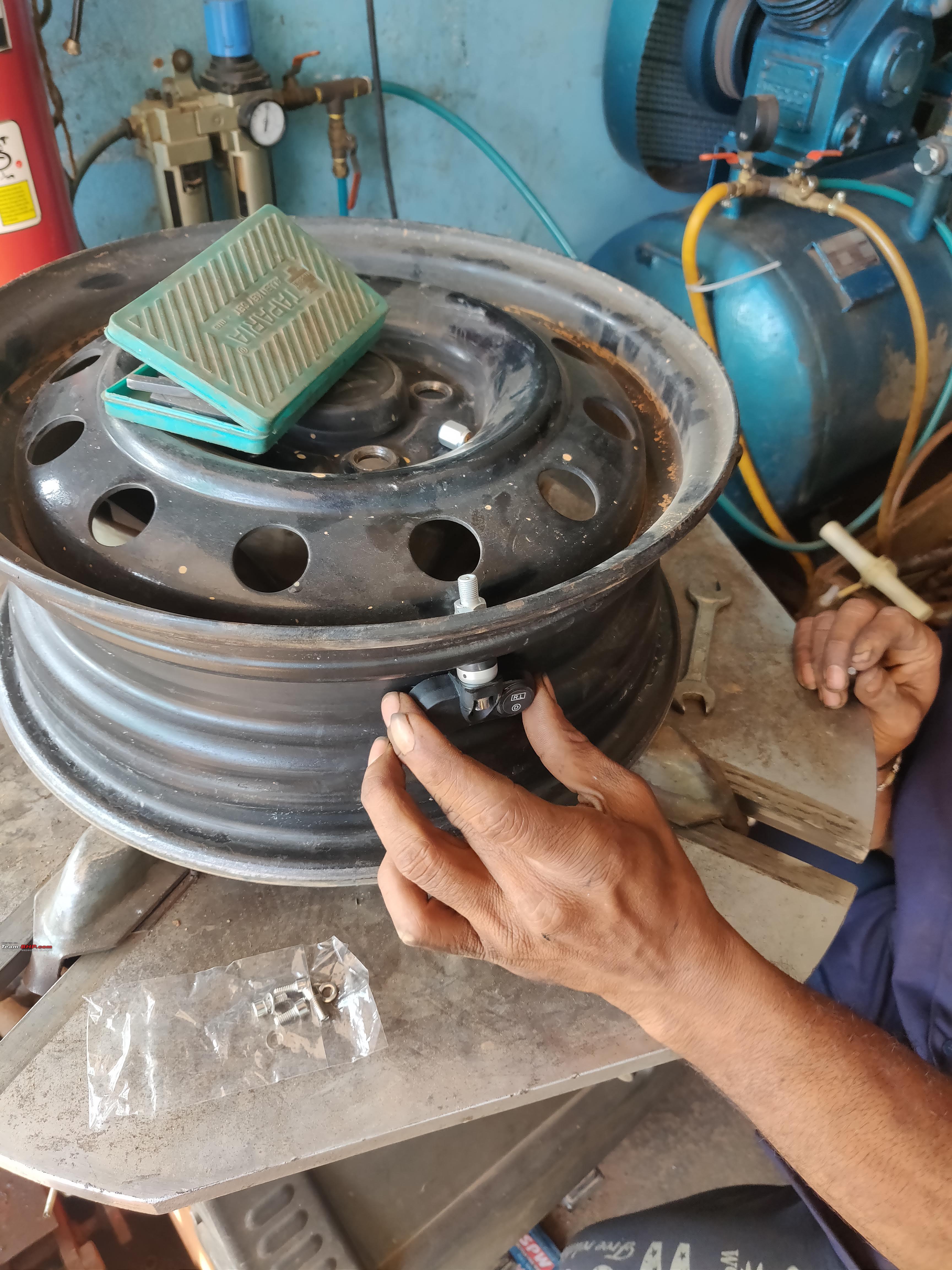

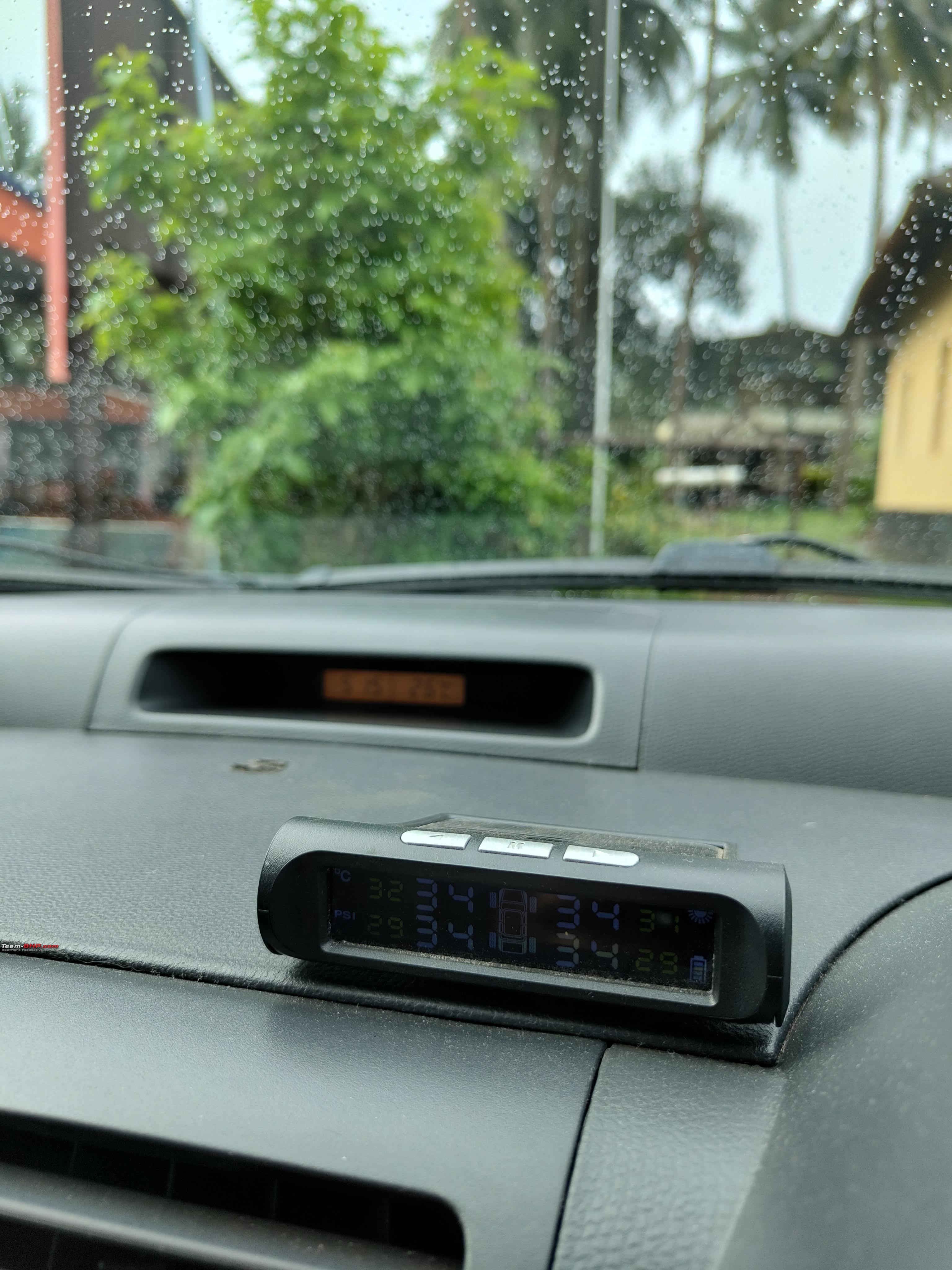

  • Tyre Pressure Monitoring System (TPMS)
A friend of mine recommended getting TPMS since I do a lot of drives and in these times it is crucial to have TPMS which displays tyre pressure in real time and warns of abnormal or sudden changes in tyre pressure.
Finally bit the bullet and got a economical one from this seller named SKYSHOP. LINK. My friend Ashish had recommended getting TPMS from the above seller since he has had good support for the TPMS. Got the Internal Sensors Set of 5 and it arrived in 5 days.
Seller called me and instructed on how to go about the installation and pairing which was fairly easy. Took the car to my tyre guy in my town. Asked him to remove all the 5 tyres, one by one I installed the sensors and then made sure it popped up on the display one by one with accurate tyre pressure psi. Took the opportunity to rotate the tyres as mentioned in service manual and placed the TPMS Display on the Dashboard. Job well done and I was out in an Hour.
Azure Grey 2006 Maruti-Suzuki Swift VXi | Ownership Review-fitting-tpms-car-lifted.jpg
Been almost more than a year since I've been using this TPMS and its been an absolute Champ ! The pressure readings are off by just 1-2 PSi Max other than that no complaints. The Display was last charged with cable in 2022 Feb and till date hasn't required charging since it charges using the tiny solar panel on itself. It has helped quite a bit during long drives.

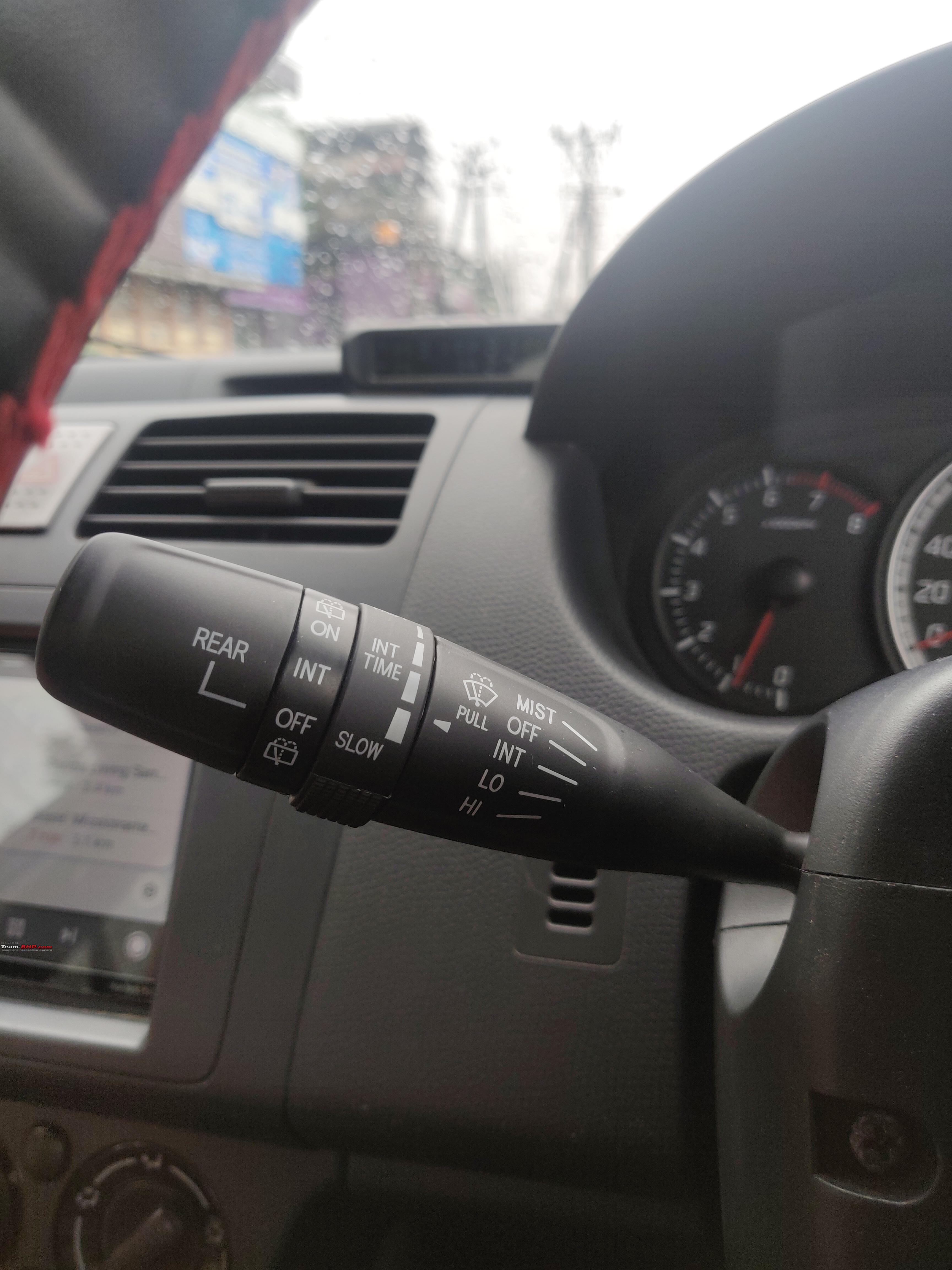

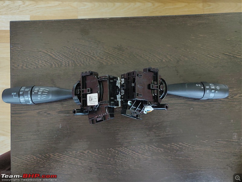

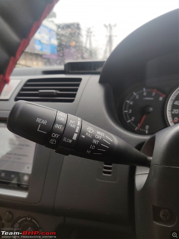

  • Added Variable Intermittent Wiper Stalk
Got the S-Cross Wiper stalk from Boodmo and it arrived in 3 days flat. To match the symmetry, ordered a 2nd gen Swift Lighting Stalk from boodmo as well.
I ordered the Lighting Stalk from Minda and not MGP since Minda was slightly cheaper and had free delivery at that time.
Name: SWITCH ASSY LIGHTING & TURN
Price: ₹610
Part Number: S12080-000M00
Link
Name: SWITCH ASSY, WIPER & WASHER
Price: ₹930
Part Number: 37310M74L40
Link
New (Top) VS Old wiper stalk (bottom)
Both New Stalks
Azure Grey 2006 Maruti-Suzuki Swift VXi | Ownership Review-new-stalk-fit.jpg
Installed the Headlight Stalk
Azure Grey 2006 Maruti-Suzuki Swift VXi | Ownership Review-new-wiper-stalk-fit.jpg
