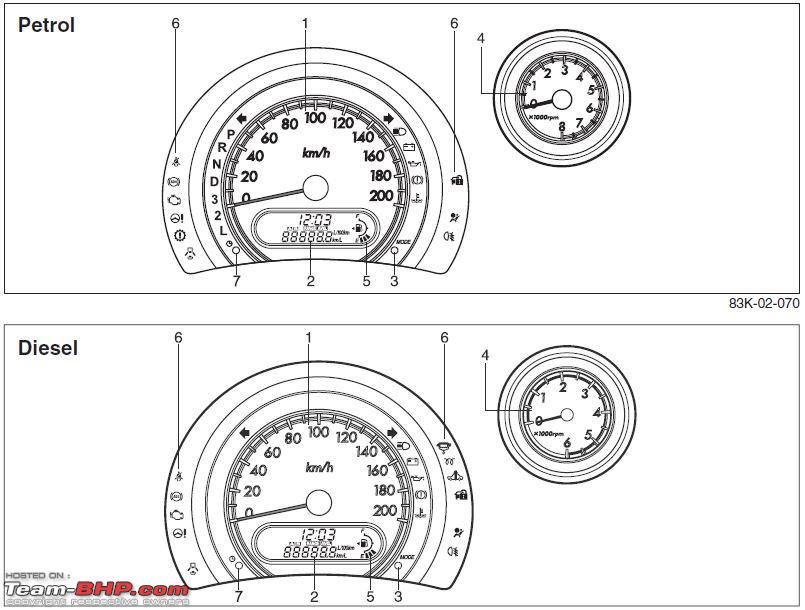

Guys, i am seeing this Warning Light since yesterday even while Driving. The Cabin light also stays ON even in the middle position. And the Car is not responding to the Central Locking Buttons of the Key. Have to Lock & Unlock manually. Can anyone let me know what this Symbol means and what is the problem? For some reason, i am getting a permission error when trying to add attachment from my fone. It is the bottom 1st warning sign on yhe left side on Ritz Instrument Cluster.
Maruti Ritz : Test Drive & Review-capture1.jpg
I assume you are talking about this warning lamp:
Maruti Ritz : Test Drive & Review-capture2.jpg
This seems to be the problem (Problem No.4), as per your description, and the Owner's Manual. One of the door lock switches seems to have malfunctioned - hence causing the cabin light to stay ON, and the remote NOT to work. Get it checked at M.A.S.S.?
Maruti Ritz : Test Drive & Review-capture3.jpg
Viju is offline   (1) Thanks
On all doors where the striker is located, there is a switch that gives the sensing whether door is open or not.
Check if any of the 4 are jammed or not?!
Also if the door lock actuators are moving freely or not.
a4anurag is offline

Originally Posted by Viju View Post
Attachment 1601693
Attachment 1601694
Attachment 1601695
Thanks Viju for the Diagrams. It is the bottom most sign to the left of number 7 in the instrument cluster pics u have posted. It is not the Car Door Open Symbol. Thank you.
Looking closely, that might be the door open sign. I am not sure though.
Will check these. Thanks Anurag.
