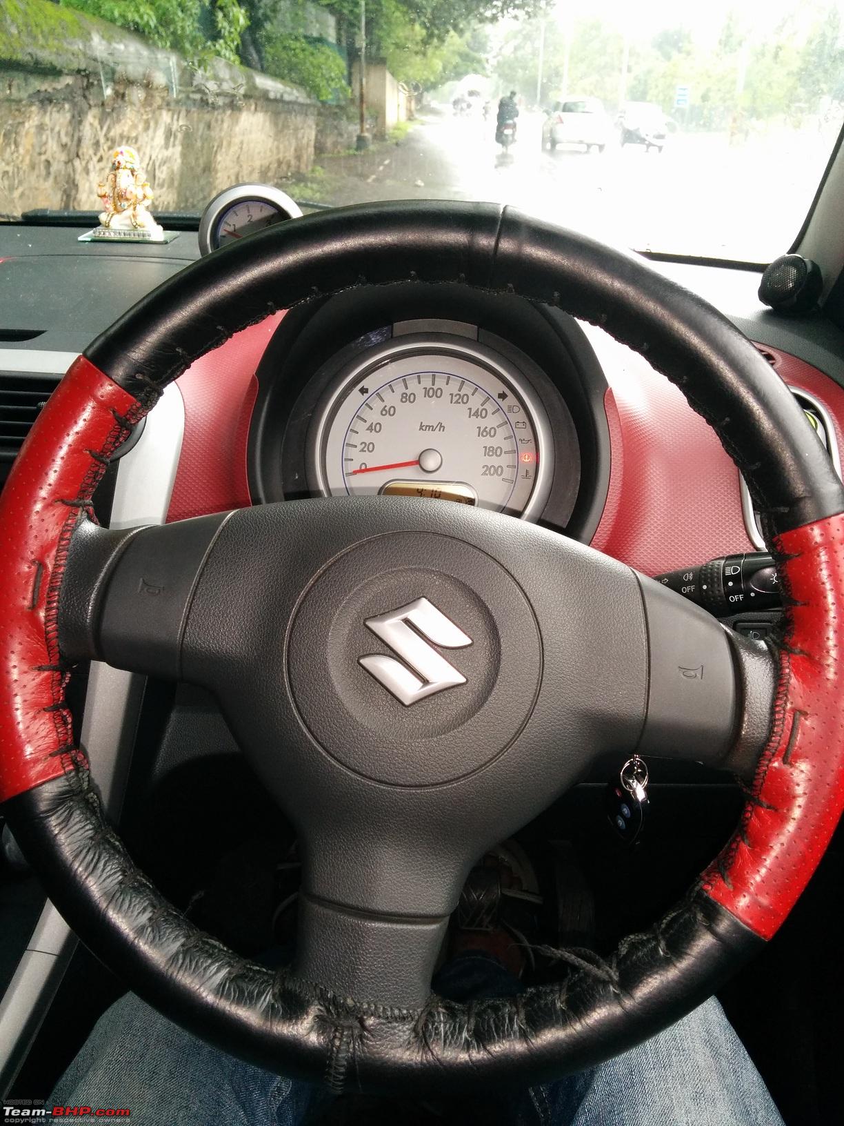

Guys, I want to report an Issue. Need some advice if it is a Major Issue or if i am just making a mountain out of a molehill.
Nearly since the time i have taken delivery of the car, i have noticed that when the steering wheel is kept exactly straight, as in the Suzuki S on the Steering Wheel pointing straight, the Car moves to the left. The Steering has to be tilted slightly to the right for the Car to move in a straight direction. I thought this might have to do with Wheel Alignment but does not seem like it. I have been overlooking this since i can live with it. No big deal. But thought of posting here to check the seriousness of the Issue.
I am attaching a couple of Pics that might help. The first one is when the Steering is straight and the Car moves to the left and the 2nd one is the one in which the Car moves straight forward.
Kindly advice.
Thanks.

During alignment specify that the steering is off center. They will make the required correction. If MASS cant solve it, try a shop with a 3D aligner. In my case it was slightly to the left and the machine itself showed the offset during the initial setup. Later it was corrected since once the machine detects an off center, it will automatically suggest corrective action. At least that's what happened in my case.

Not an issue at all. Will be corrected during an alignment job.
IIRC, the tie rods need a minor correction to get the steering wheel straightened. Get it done outside and NOT at MASS.

Thanks Audioholic and Anurag. Will get it checked soon at my regular Wheel Alignment Shop.
