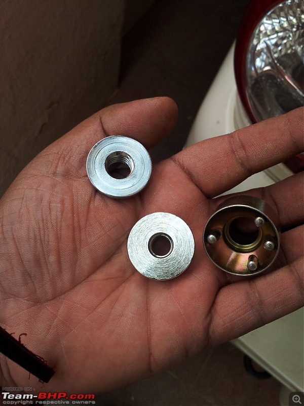

Now comes the bad news. The Bari security nuts were M12 whereas the bolts were M10! I contacted the dealer and he wanted me to send the oversized nuts back. Not happening. Did the next best thing. Made a drawing of the nuts, went to an industrial area nearby and got a few turned on the lathe. I then got them chromium plated in Peenya. End result, bad review for the ebay dealer for goofing up and not willing to send me a new pair unless I returned the oversized pair. Of course sending them back would mean spending more than the cost of the nuts in shipping charges. Getting a new pair in India costs 2400 a pair.
Pics of the Bari nuts and the Bangalore nuts

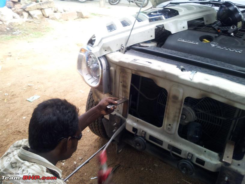

His workshop is in Kasturinagar, just off the outer ring road. I went there with a book, prepared to read something in case I was left alone with the car till the work started. It happens all the time at the ASC. But he quickly removed the bumper and the grill, took measurements and showed me exactly where the lights would be fit. I agreed on the position and we took off to the welders nearby. They first created a clamp based on Keshav's measurements. it was a basic 'L' clamp with reinforcement at the joint and a whole to mount the light. The grill was mounted and the position of the clamp was marked and a temporary weld was made. We then checked if the grill could be mounted and taken off without any obstructions because of the clamp. We also ensured that there was sufficient place to mount the lamps and adjust once the grill and bumper was in place. Once satisfied that everything was perfect, Keshav removed all the wires around the area as sparks from the weld may damage and burn these. After checking again, the clamps were finally permanently welded.
I must say, Keshav comes highly recommended. Not once did he switch over to another vehicle, though there were several that came and went. He gave my brute his undivided attention. Right from making the clamps at the nearby engineering shop, to mounting, wiring and testing. It took him almost 3 and half hours to complete the job. And at the end of it all, when I asked him the charges, he quoted a reasonable Rs. 450. I paid him Rs 600, thanked him and drove off delighted that after almost 2 months, I finally got the lights installed.

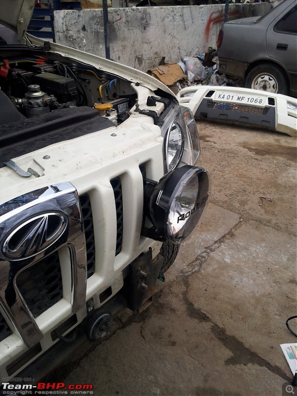

The output is brilliant. I now need to find a dark spot and do some focusing on my own. I plan to keep one light with a good throw and the other one with a wide spread. Something in between the high and low beam.
Waiting to test this setup on the next long trip.
