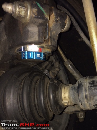

The front is at 10
Yet another Skoda Laura 1.8 TSI on Team-BHP. EDIT: Now sold!-b16front.jpg
The rear at 8
Yet another Skoda Laura 1.8 TSI on Team-BHP. EDIT: Now sold!-b16rear.jpg

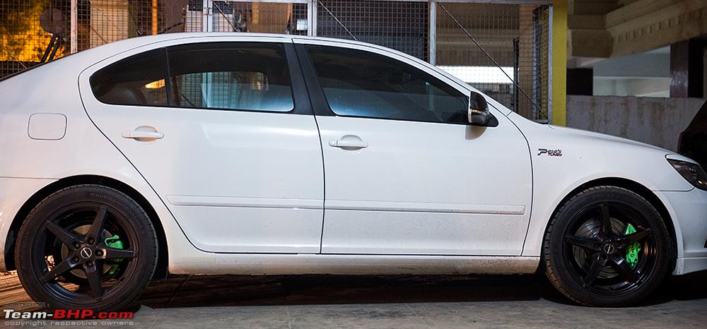

The stance was awesome especially when compared to a stock car
Yet another Skoda Laura 1.8 TSI on Team-BHP. EDIT: Now sold!-photo3.jpg
But had to raise it a little to make it practical for daily use in Bangalore city
Yet another Skoda Laura 1.8 TSI on Team-BHP. EDIT: Now sold!-b16height.jpg

The setting from 1 to 10 is for the damping and not ride height. Check this link for further details.
http://www.bilsteinus.com/products/p...b16-pss9pss10/
Yes it is possible to change from a softer to a stiffer setup in a minute. Just need to rotate the dial (which makes a click each time it is rotated) clockwise for stiffness and counter clockwise to make is softer.
Originally Posted by akshay1234 View Post
That's a good exchange Robi. Interesting that its not bone jarring on 10 too. Now about the height, you can adjust it without jacking up the car or removing the wheel or anything?
Well after a 400 Km drive with some spirited runs, I found the front(8) and rear(7) better suited for me. In slow speeds 10 was tolerable but it felt too stiff while doing good speed over slightly uneven surfaces.
In order to adjust to the height, you need to remove the wheels after jacking up and use the spanners provided with the kit.

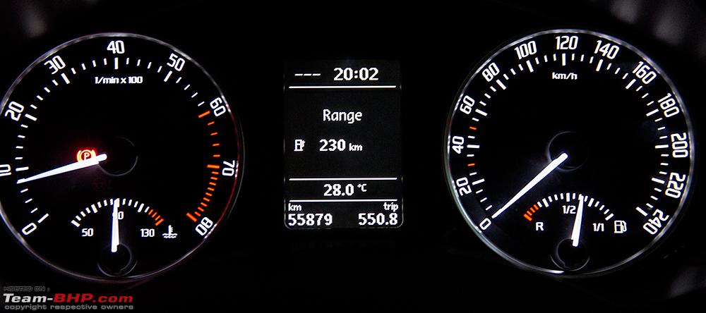

The music system, front parking sensors and the maxidot cluster was installed by Sugesh at Vagtune. The installation is pretty neat and error free.
The quality of the system is much better than CASKA and even Blaupunkt Philadelphia 835 (which does not support front sensors as well). I wanted to get OEM Bolero system but it doesn't support the rear camera and navigation.
The Maxidot even has the Navigation option. Just need to find the right maps.
Yet another Skoda Laura 1.8 TSI on Team-BHP. EDIT: Now sold!-_dsm9829.jpg
The text is sharp and clear

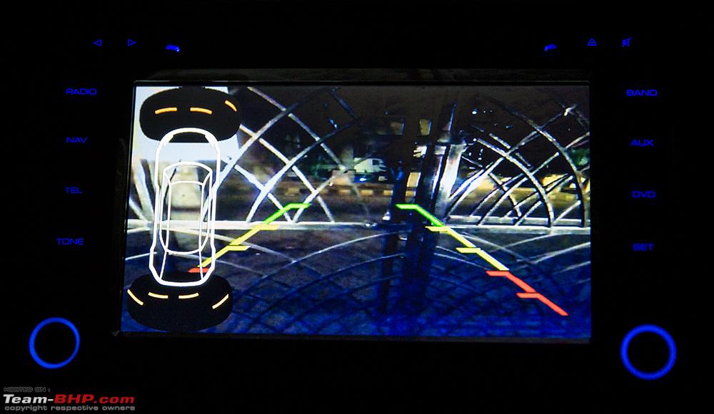

The sensors integrating with the camera on reverse
