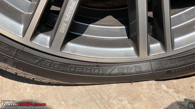

| ![]() I have experienced RFT only for 4800 kms so far in my 630d GT M sport and the experience hasn't been good so far. The ride is very harsh compared to Michelin Pilot Sport 4 (205/50 R16) and had my first incident with them. Pirelli P Zero 275/40 R19 suffered with a big bulge on the side wall when the driver was driving. I asked him if he hit a pot hole at high speed? He is maintaining that nothing of that sort happened, brother was him all through and he also din't notice any particular instance. Driver has been with us for over a decade and does baby the car on bumps. Cannot explain this though? ![]() Taking the car out on long drives will always have the "what if something goes wrong" thought lingering going forward. How has been the experience with other RFT guys on long drives with relatively bad indian roads especially right after monsoon.?? Same thing happened with my cousins 530 d M Sport good year run flats. Low side wall height the only explanation? |

| ![]() I have suffered from RFT's since ages now. You should switch over to Michilens P4S or P4 depending on the budget/ availability. This happened last week, the donut spare tyre saved my trip and I could reach back home. I drove around 100 kms with speed limiter set to 80Kmph. Don't buy Pirelli, they make noise after 10-15 K. Do invest in a space saver if you don't already have one. |
