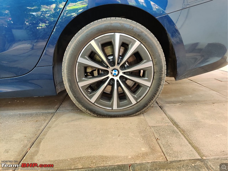

Okay folks, last week my 330i Sport with 225/50/17 Bridgestone Turanza T005 RFTs ran over a massive metal spike barely 1.5 km from my house. Was doing good speeds, and the spike destroyed my rear LHS tyre and deflated it within 500 metres.
The Unused Tread Depth (UTD) of the damaged tyre (run ~9K km) is ~3.5 to 4 mm averaged across multiple center-of-tread readings. The rest of my tyres are in the same state of course.
Please refer pictures below:
Damaged tread:
Run-Flat Tyres : All you need to know-1.jpeg
Run-Flat Tyres : All you need to know-2.jpeg
Run-Flat Tyres : All you need to know-3.jpeg
The perp:
Run-Flat Tyres : All you need to know-4.jpeg
My options:
1. Claim BMW Secure but BLR dealers have only the same crappy Turanzas. MRP is ~23K with GST and I can maximum expect 50% to be borne by Secure as my UTD is >3 & <5. I estimate ~16K out of pocket including deductible of 2K + mandatory wheel alignment / rotation charges.
Run-Flat Tyres : All you need to know-utd.jpg
Caveat: This is my first claim with Secure so please correct this understanding if wrong.
2. Buy a single Michelin 3ZP in the open market as stocks have started to come in now. Cost ~18K but tyre shops are saying they ideally need to sell at least 2. Trying to work around that. Advantage of this strategy is that I can replace the other 3 after 5-7K km, as the UTD is already low and the ride is getting harsher. Ideally, the 4ZP would have been great but Michelin India says it is unlikely in India soon.
3. Buy a single Pilot Sports 4 normal tubeless tyre (~13K) and fit on the same rear axle. This would let me 'upgrade' the other 3 to tubeless later on BUT BMW and all forums strongly warn against mixing RFT & non-RFT on same axle as ride/handling characteristics are totally different.
4. Change all 4 now itself to PS4 tubeless (13x4= ₹52K). Upside is brand new modern tyres, but downside is the unplanned spend with zero resale of the 3 remaining T005s.
5. Try and get the tyre repaired which is very dicey given the damage.

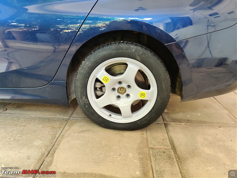

The 3 is currently on the Space Saver Tyre (SST) and is a hilarious sight: Show this picture to your better half, and they will freak when you plan your next long drive with a full family + fully loaded car :-)
SST vs regular RFT:
Run-Flat Tyres : All you need to know-sst.jpeg
With deflated RFT:
Run-Flat Tyres : All you need to know-sst1.jpeg
With SST: Pressure was at 42 psi which I bumped up to the recommended 60 psi. My local fuel bunks could manage only 50 psi max so found a truck stop.
Run-Flat Tyres : All you need to know-sst2.jpeg
Thankfully, given the terrible infection spread, I don't expect much driving for some time now, plus have a second car as a backup. I CAN wait for some time is the good news. The bad is I don't WANT to.
Any advice would be highly appreciated!
File a claim the BMW secure. 2K deductible, I am not sure if this applies to secure or not as this is normally for regular insurance. Ask for the policy fine prints. Same way, tell them to just mount the tyre and No, you don't need alignment/ rotation just because the tyre is damaged, If they insist, ask them to show you where it's mentioned on the policy or the BMW manual.
I hope, you know that any claims on the BMW secure, do not affect your NCB on the main Insurance policy.
So, I will not bother about anything else and go for a claim unless, you don't mind the loose change and want to swap all of your tyres to PS4S

File a claim the BMW secure. 2K deductible, I am not sure if this applies to secure or not as this is normally for regular insurance. No, you don't need alignment/ rotation just because the tyre is damaged...
Thank you Turbanator. The 2K is mandatory from the clause itself. WA & WB I will avoid.
I will proceed similarly - just waiting to see what lockdown measures KA imposes from midnight.
I would suggest you following
Option 1: See if the damaged RFT can be repaired like normal tubeless tyre. Looks difficuly given the diameter of foreign object.
Option 2: Since tread left is only 3.5 mm on most tyres, you would anyways be replacing the tyres before rains since 1.8 mm is minimum tread depth.
So it would be advisable that you replace both rear axle tyres with new tubeless tyres.
New 1 Nos RFT is Rs. 16,000.
New 2 Nos Tubeless Rs. 26,000.
For extra 10,000 you have two new tyres.
Lastly RFT wear faster and are expensive to replace with availability an issue with ongoing tyre import restriction.
Plus tubeless give better ride quality in comparison to RFT.
If you go ahead with option 2, you could also do following; install the 2 new tubeless tyres on front axle and move the front old RFT to rear. Since 330i is RWD, you may enjoy them to last bit of tread and get new tubeless later.
This would be my choice. Its better than having a single tyre 9k kms newer than the rest, and also not too much more expensive than changing 2 tyres to new RFTs which would be the other ideal thing to do. With this you get better ride, better grip and a better driving experience overall.
Option 1: See if the damaged RFT can be repaired like normal tubeless tyre. Looks difficult given the diameter of foreign object.
Thanks, took it to a couple of big shops - they declined to try and fix it saying even mushroom patches may not be able to handle the stress from a powerful car like the 330i.
Option 2: ...install the 2 new tubeless tyres on front axle and move the front old RFT to rear. Since 330i is RWD, you may enjoy them to last bit of tread and get new tubeless later.
Am seriously exploring this as I have clarified with BMW, and the Turanza is 21,113 + 28% GST making it an astronomical 27K. Even if I get 50% off and add the 2K deductible, I will still need to pay 15.5K out of pocket after insurance.
Even if I buy 2 x Pilot Sport 4 tubeless for the rear axle, I will spend ~26K. This sounds better and I can even retain the undamaged RFT as a 'spare'.

Overall, I am not enthused with Secure - in my opinion it's great only for tyres within 5-7K km only and /or for alloys. For me, even with only 9K km & 9 months, I am effectively getting only ~43% of my new tyre cost.
