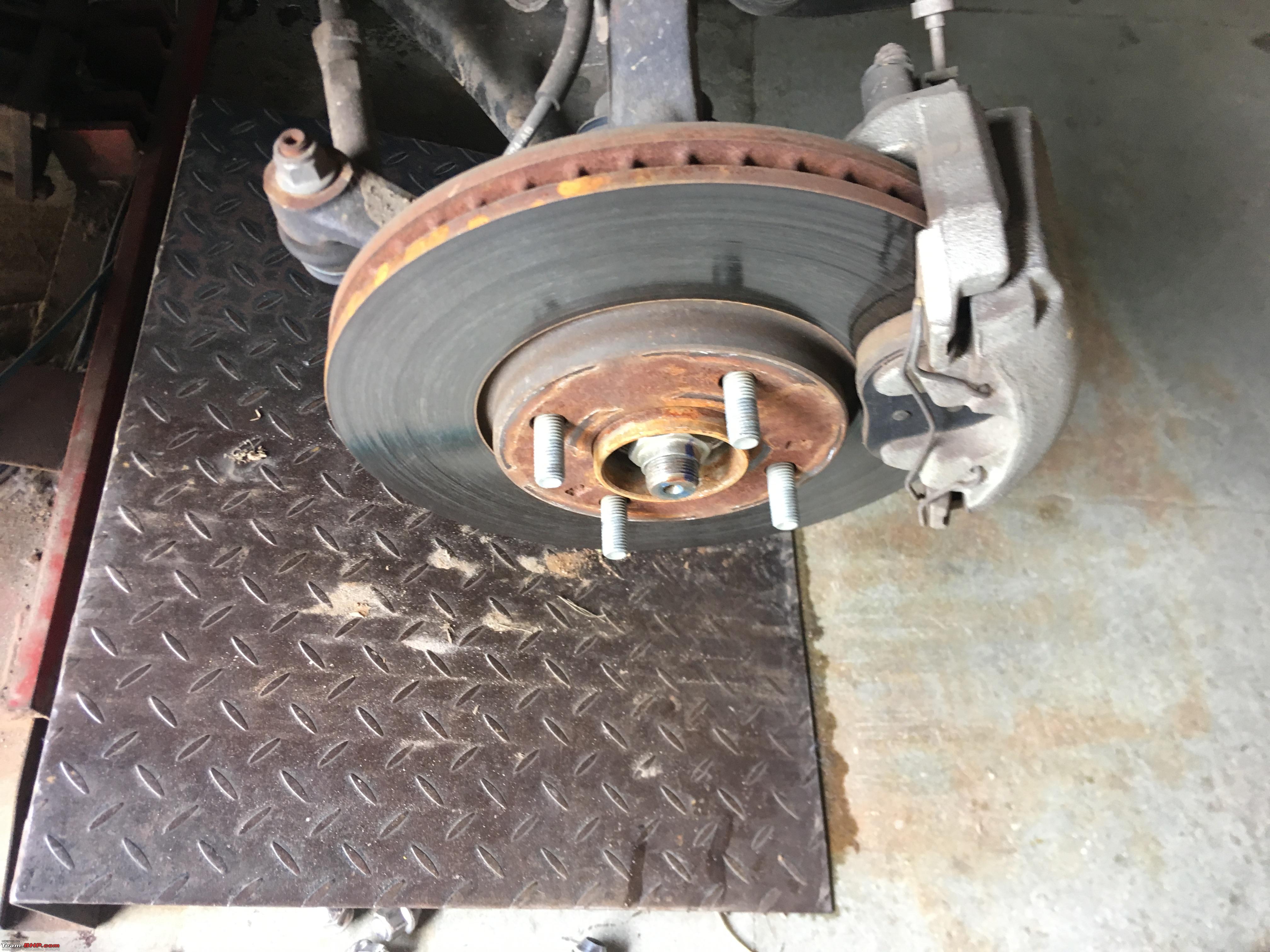

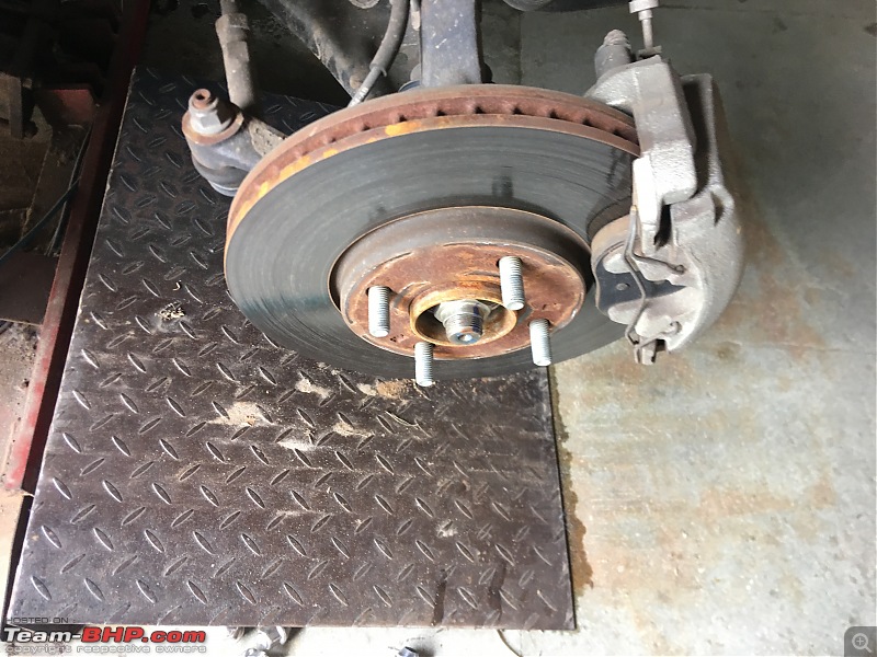

Don’t know if this is the right thread to post this.
Have attached pictures of my Ecosport disc/drum area, taken while I went in to get alignment done today. There seems to be too much of rust on these parts, is this normal? Have other Ecosport owners faced this issue?
Ford Ecosport : Tyre & wheel upgrade thread-5eae604c2c1a4c0aa01e470fd4ba99b8.jpeg
Ford Ecosport : Tyre & wheel upgrade thread-a145521793f44f7d9d9951cadb77f9b5.jpeg
Those parts (mating face, brake disk) are cast iron, hence rust is normal, nothing to worry. This is similar to how certain parts of the turbo are of iron and would have rust.
My EcoSport was 2 weeks old (i.e. 2 weeks after manufacture), when I went to change my tyres, and I found rust on the mating face of the wheel hub
That said, it is best to clean off the rust on the mating face of the wheel hub, since rust can cause the wheel/alloy to bind to the hub (making it harder to change during a puncture). Use a cloth, WD-40 and some pressure to remove as much of it as you can.
Thanks mate! Saved me quite a bit of worry there. Will make sure to take rags and WD40 along during next alignment.
