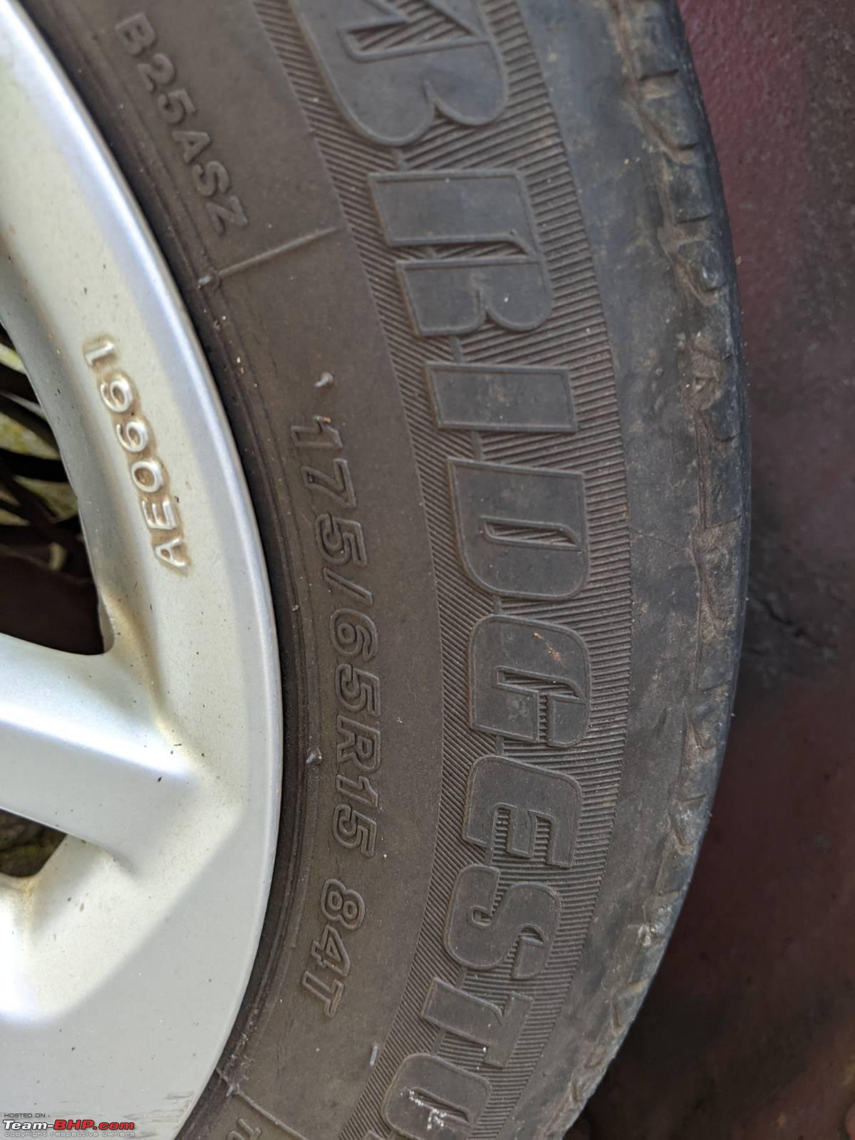

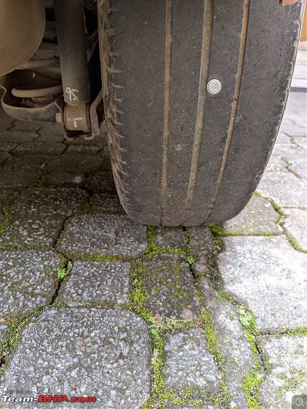

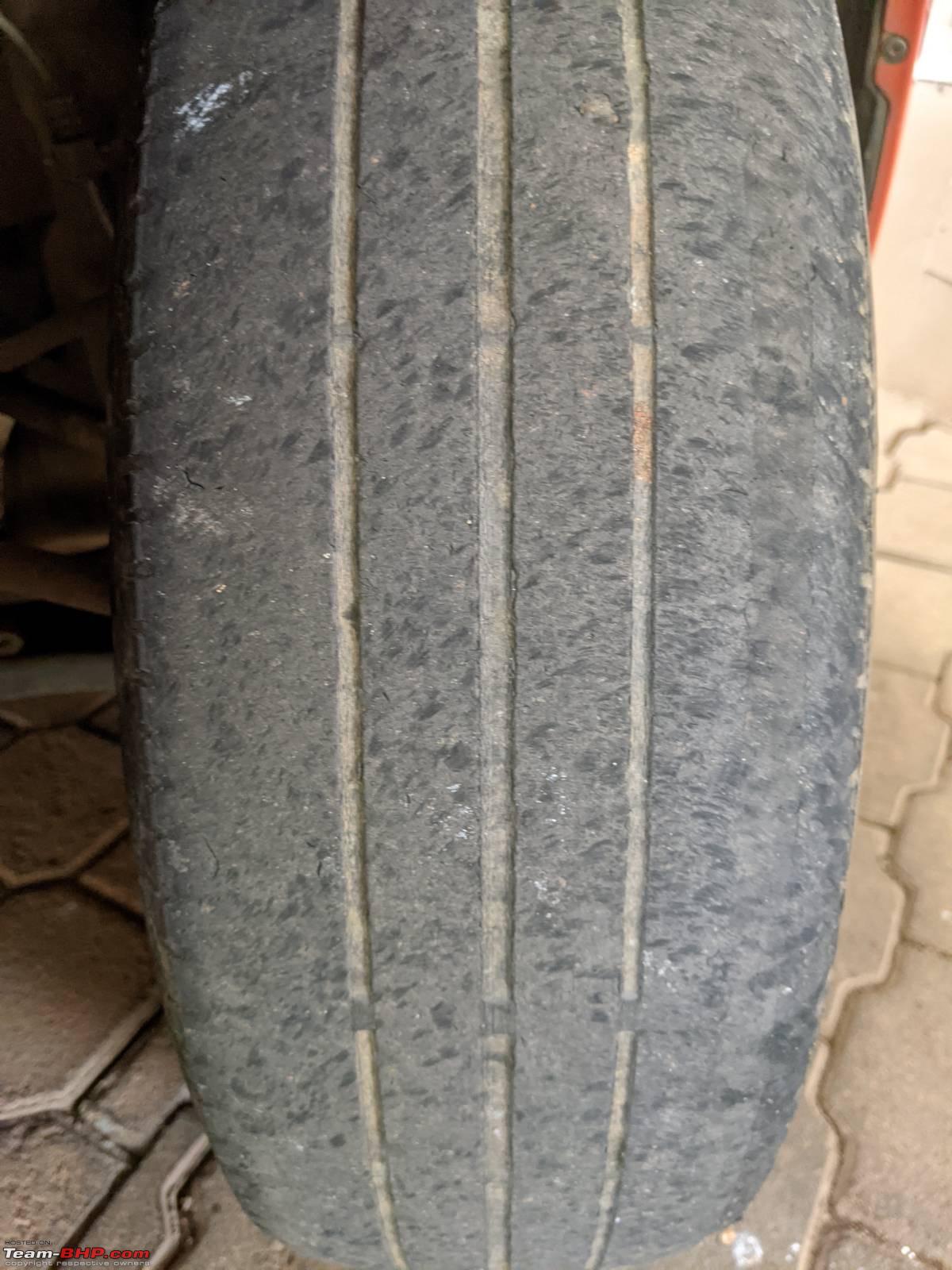

I finally got around to upgrading the tyres on my Jazz. Six months too late, thanks to the second wave and general tardiness on my part. . A special shout out to Neil.Jericho for his advice.
Honda Jazz : Tyre & wheel upgrade thread-66074eb7e0794f4aaaa5abcc8f1069db.jpeg
As one can see, the tyres were really tired (At 27,000km).

The stimulus to change the tyre ASAP. The presence of the screw did not cause the tyre to loose pressure though (Fortune, thou art a fickle mistress).
