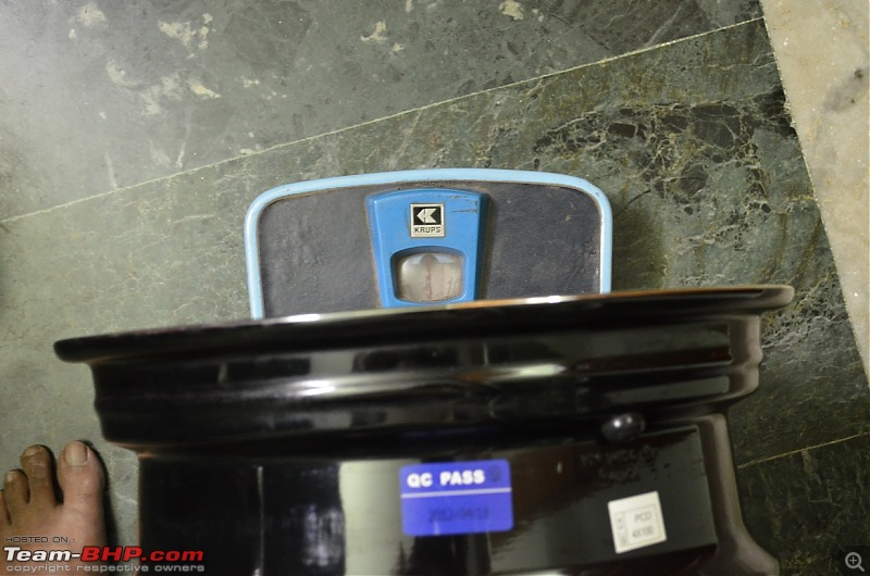

Today i weighed the Neowheels Urban alloys (which is now un mounted and put up for sale) on a bathroom scale and each wheel registered 5.5 kilos approximately. The scale not being a digital one won't read to the last gram but the needle always stopped at the same point with all 4 wheels.
