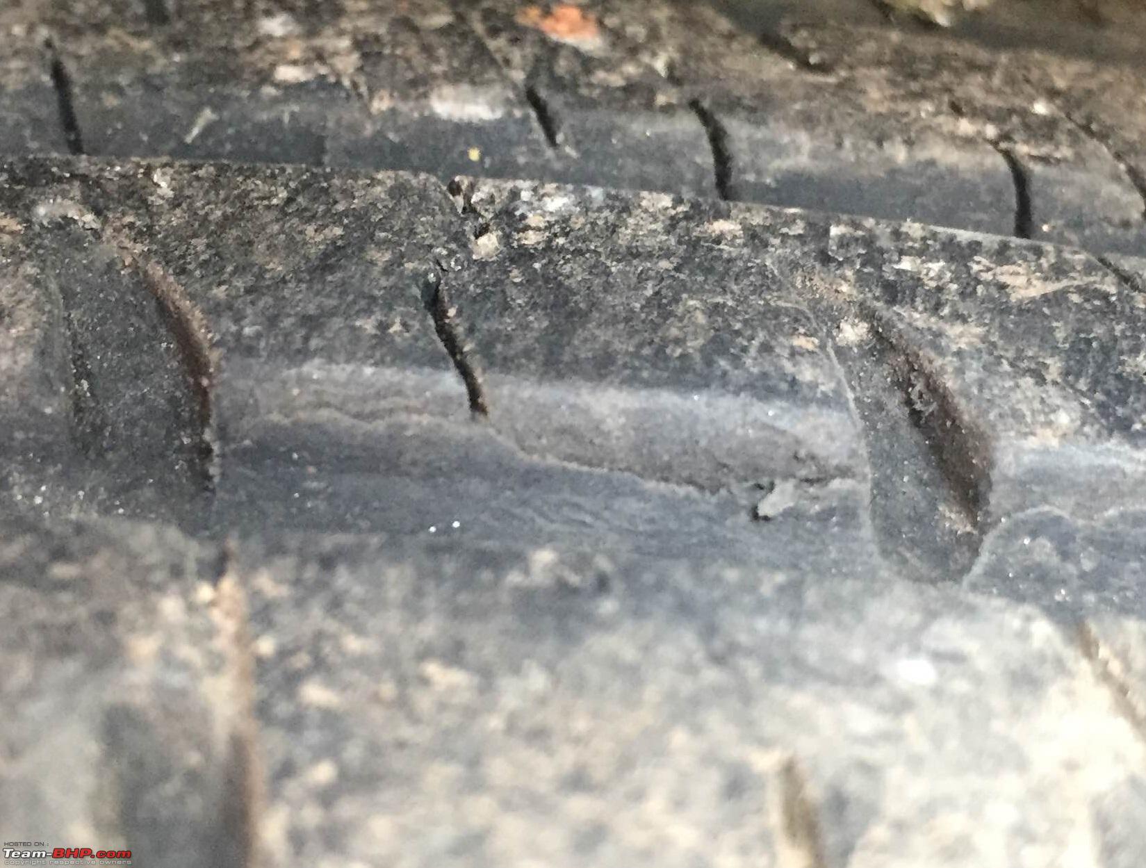

Ok, so here is a pic of 2 mould lines:
And here is the line on tread pattern:
To my eyes, this bears absolutely no resemblance to the mould lines. You can also see a small piece nearly dislodged from the tread. They are present at multiple joints of tread pattern with rest of the tyre. This makes it even more unlikely that they are mould lines. It clearly looks like tread pattern separating from rest of the tyre. I am sure it will intensify with time.

I would request you to take another factor into consideration - the tyre's age. These might be normal for a tyre which is say 3-4 years old. But is this normal in just one year? These cracks will definitely go on worsening with time. By the time they are deep enough to pose serious threat, the car & tyres will be out of warranty! I think this should be reported under warranty.

The cracks that you see on the treads are not much of a concern as it looks today. If these cracks were on sidewall, it would have been some thing which needed immediate attention.
What you can do is observe these cracks on a routine basis. Just see if this cracks are growing in nature. (Increasing the length / depth of cracks). If they are not growing, not much concern.
Do not worry. These kind of tread cracks will not result in tyre blow out. At the same time, please give attention to side walls and even if a small hairline crack appears on sidewall, get it inspected by an expert.

As per the 1st picture, the crack looks quite normal, like driven on a bad road. However, the third picture is a concern. There seems to be an overlap over the thread that is coming out.
A crack on the tyre caught in time can save your life. If left undetected, a crack can cause the tyre to burst at high speeds. As a tyre ages, bulges on the sidewalls are common but at the early age a strict no.
You're right about that, but my guess here is that:
a) The "pic of 2 mold lines" is just as you say
b) The line on the tread pattern is more of something to do with a vulcanisation process and the attachment of the tread.
