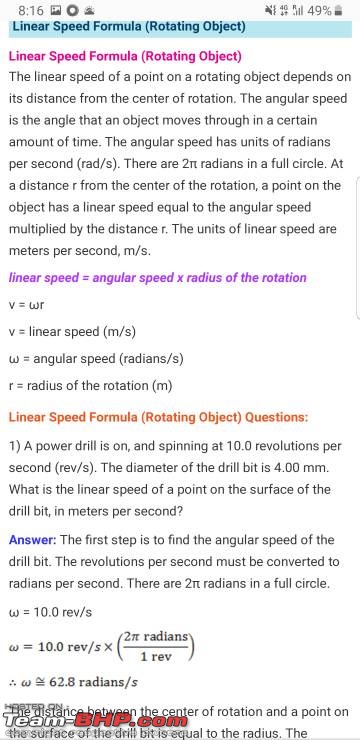

I believe you are correct. Here's the real physics behind it:
Theory:
Problem:
Link to page:
http://www.softschools.com/formulas/...t_formula/151/
IMHO, in theory, if everything else remains constant, as Brits say, 'it will not make fig of a difference'.:)
