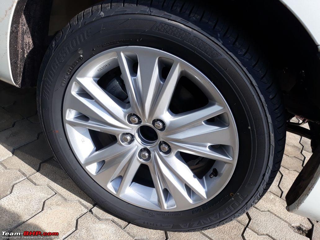

Hello BHPians,
These days, there are many factory fitted wheel sizes to choose from in the same car. Normally, lower variants get wheel with taller side walls (More rubber) and smaller alloy/steel rims whereas higher variant gets shorter sidewalls (Less rubber) and bigger alloy wheels.
Taller side walls + Smaller rims:
Tall tyres & regular wheels versus low-profile tyres & large wheels-img_2149.jpg
The picture shown here is the 16" alloy wheel of the Innova Crysta. It would offer better ride due to more rubber and taller sidewalls.
Due to increase rubber, the bump soaking capabilities of the wheel gets better. Even though the major role is played by the suspension, the size of the wheels do give that last degree of finesse to the ride/handling. In this case Ride quality would be much better but the overall handling of the car would be compromised.
