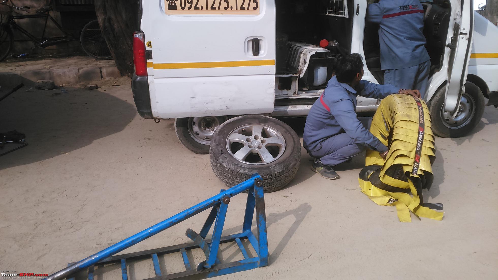

At-home Tyre Change & Balancing - TyresNMore.com Review
Stumbled upon this website https://www.tyresnmore.com/ while finding a good nearby workshop for a tire change for my Santro
As the prices offered were very competitive, called them and asked them on Sunday to see if I could drive in and get my tires replaced. I was looking at the Apollo tubeless at 2375/- per tyre after exchange of the old ones
The guy at the end was polite and explained how they work. They have 2 EECO vans and come anywhere in Delhi,Gurgaon and Noida to change tires at home. If you buy more than 2 tires, the delivery, balancing and tire change is complimentary. Otherwise IIRC it was Rs 200 for a single or two tires.
He told me he would check if the tires were in stock and call me back in 10 minutes. He did call back and told me he needed 2 days to procure the tires. I placed the order and today afternoon I got a call that they had tires in stock. We fixed an appointment for 5:30PM at my residence and the van showed up promptly.
The two guys knew their job and changed all 4 tires in less than an hour. Mind you they dont have a ramp and lift one side of the car at a time and the balancing and tire changing machine is in the car
Pros:
1. Very punctual and prompt
2. For the tires I was looking for, cheaper than any other shop
3. I had my doubts about the manufacturing dates after reading reviews about Snapdeal. But I was told the manufacturing date of the tires before the appointment was fixed today. And you wont believe it, I got 072015 (7th week of 2015) manufactured tires
4. Convenience
5. Cash on Delivery after the job has been completed.
6. Have a genset. No power outlet needed
I don't know if this is a standard practice or not: Changed the nozzles on the rims for no additional cost. The neighborhood shop asked for Rs 300 more for the 4 nozzles
I for some reason was under the impression that they do the alignment as well. But they do not. Wont blame them, fitting an alignment machine in a car will not be easy along with a balancing machine and a tire changer.
Overall: 5/5
Disclaimer: Not commercially associated with these guys. Just impressed with how eCommerce is growing.

How do they stabilize the machine inside the van so that it can balance the tires properly? Is the van raised off its suspension to do the balancing? How is it kept level? Such balancing machines usually are meant to be mounted to a level and solid floor for them to work as designed.

Will the wheel balancer be able to balance the wheels properly as the machine is mounted on an unstable platform and possibly un-level platform (depending on the surface the vehicle is parked); i.e., a regular van without any additional stabilizers.
Ranger wheel balancing says the following in their manual:
The balancer MUST be located on a flat floor of solid construction, preferably concrete. The balancer MUST sit solidly on the floor. If the balancer is not level, or is placed on an unstable floor, the balancer will not function properly and will produce inaccurate balance readings. The balancer
MUST be bolted down. It will NOT function properly if operated on the pallet.
The machine can be installed on any firm and level ground. It is recommended that the balancer is securely anchored to the floor. For this purpose holes are provided in the base of the machine. Mount the machine to the floor using 1/2" anchor bolts.
Sankar is offline   (3) Thanks
I did not think this through. But now that you mention it, it makes perfect sense. I for one did not check if the machine was even bolted to the floor of the car. Forget leveling and all. I am guessing I should go to a nearby tirewaala and get the balancing done when i drop in for the alignment.

Here's the blown tyre:
This is the wheel balancing machine in the van. I anyway have to get it balanced and aligned, all the wheels, so I dont really care about it being ok. If the replaced wheel does not need balancing, I will update:
Some random pics of their operation:
