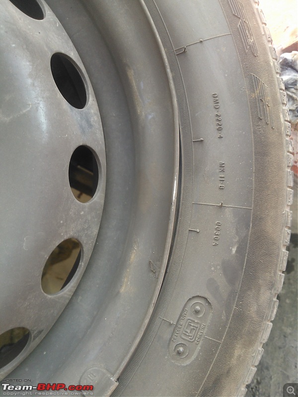

Fiat Punto : Tyre & wheel upgrade thread-wp_000024.jpg
There appears to be a bend in my steel rim when i went in for a puncture. Will it cause a difference in any form be it steering wobble or stuff like that. Can this be repaired?

It can be repaired, please try and do it as soon as possible. This is dangerous since there is a chance of air leaking out of the tyre.

Oh yes, it might cause some balancing problem along with tyre pressure loss.
It can be repaired easily and you can swap the same with the rim used in the stepney tyre .

At Salem I have seen a wheel bending rectifying machine available in a Wheel alignment center " Star Tyres" exactly opposite to "Central Tyres - Bridgestone Dealer" on Salem National Highway Byepass....
Hope the same will be available at Mumbai too in some tyre center... kindly check up. Until then use the wheel as a spare one with tube, so that you will not have any air loss
